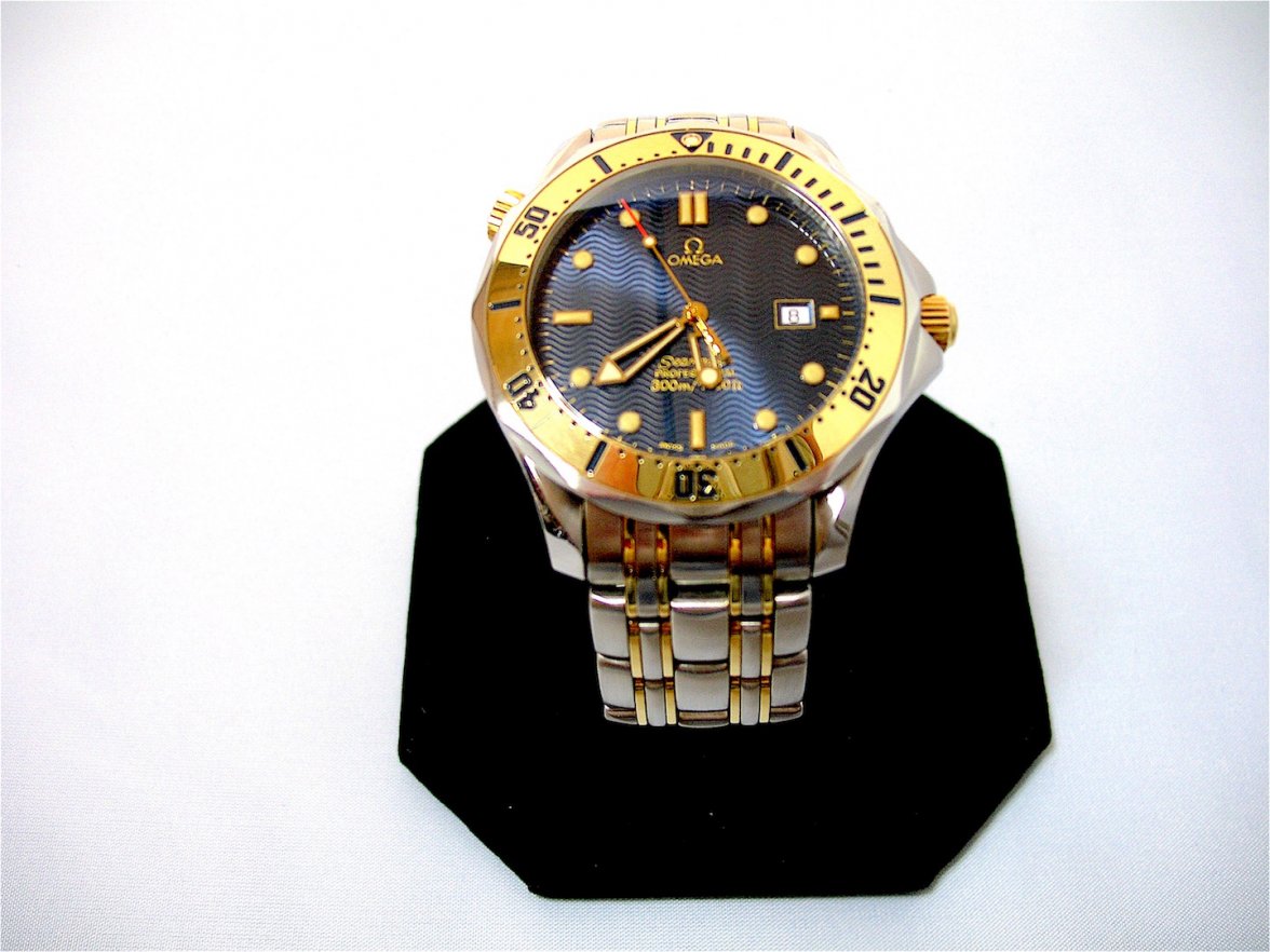

    Here is my almost one of a kind SMP because they only made the 1438 cal model for 1993. This watch is
    SR# 54xxxxxx desiganating a 1993 manufacture. Omega had originally designed the New James Bond Model SMP Quartz with the 1438 cal. movement but it was also suppose to have the 1441 cal. dual oscillator and thermo-compensated timing board. My watch has that combination and runs consistently in the 4 SPY accuracy range. It is really rare because of the 1438 6 jeweled movement and being S.& 18K Gold two-tone. Beautiful example of a 24 year old watch. What do you all think. A.jpg Omega #2.jpg Omega #4.jpg Omega #5.jpg Omega #6.jpg

    looks good! [emoji1303]

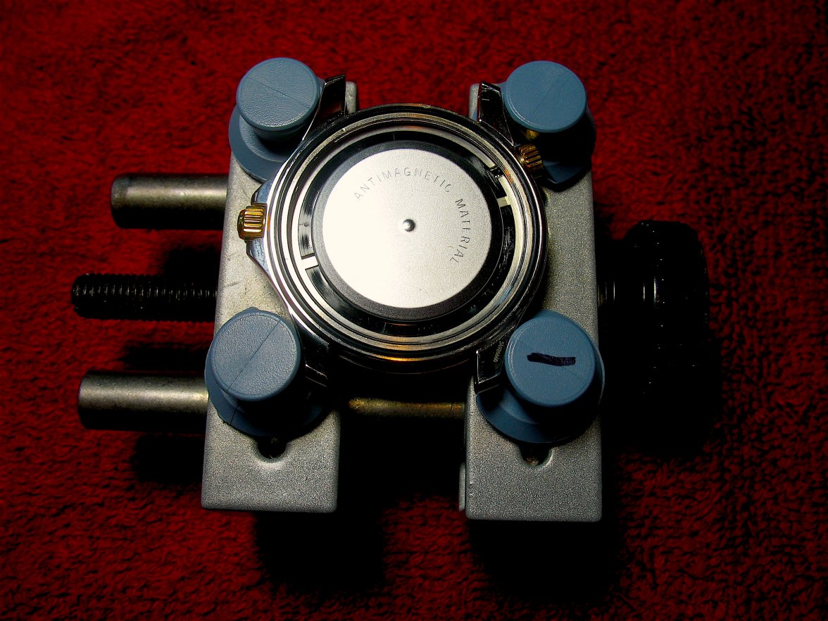

    That is the 1438 cal ETA 255.461 module in the watch. (notice that number in lower left hand corner of the pic showing the movement.)
    Only year they put the Omega 1438/ETA 255.461in the New Seamaster was for year 1993. It is also the only module other than the original 1441 cal. module that was made to accept the 2nd. quartz oscillator.

    I bought it new with the 1438 cal. ETA 255.461 movement in 1993. I found out from an old Omega watchmaker, about why the 1438 cal. movement was supposed to have had the 1441 cal. timing module. I changed out the 1438 cal. timing module (6) screws with an "NOS" 1441 cal. timing module that I had bought new from a Swiss watchmaker. Simple 1/2 hour operation, and the 1438 cal. base indeed had the machined cut out for the 2nd oscillator that the 1441 module had.
    According to the old Omega watchmaker, a few actually left the factory as I have my watch now. It was the way it was intended to be, and it is still all Omega.
