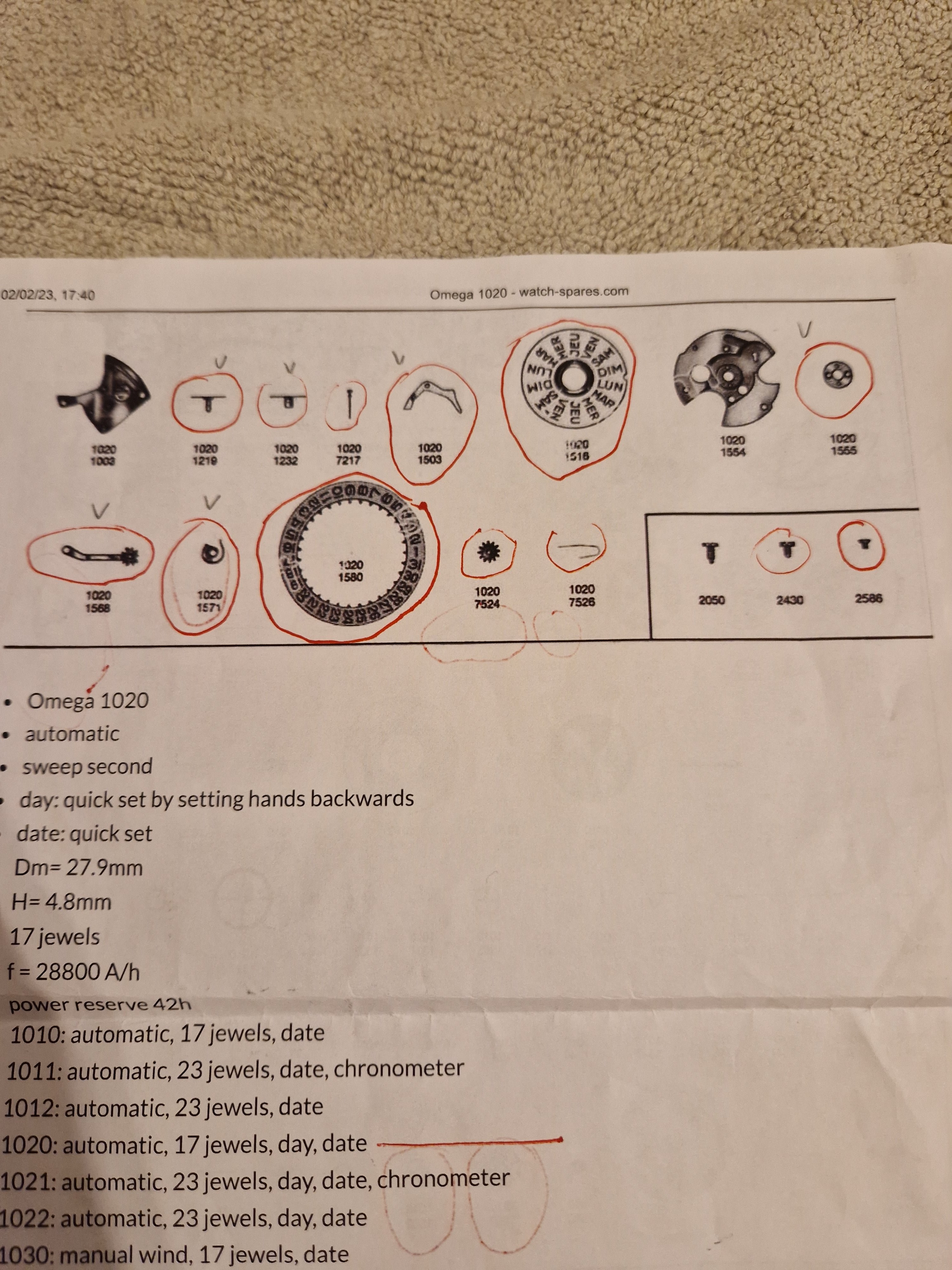

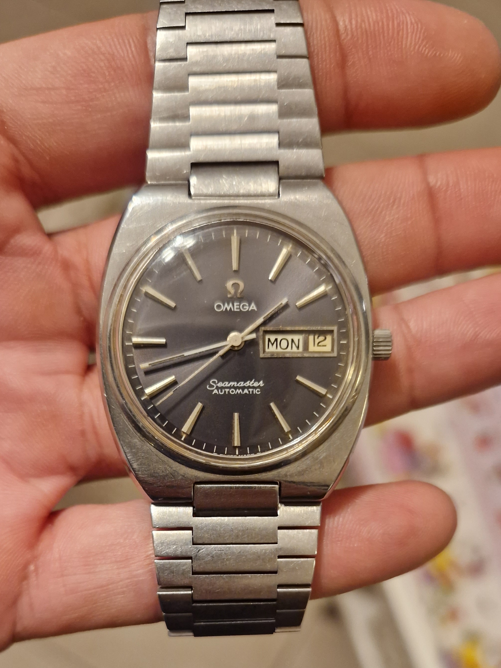

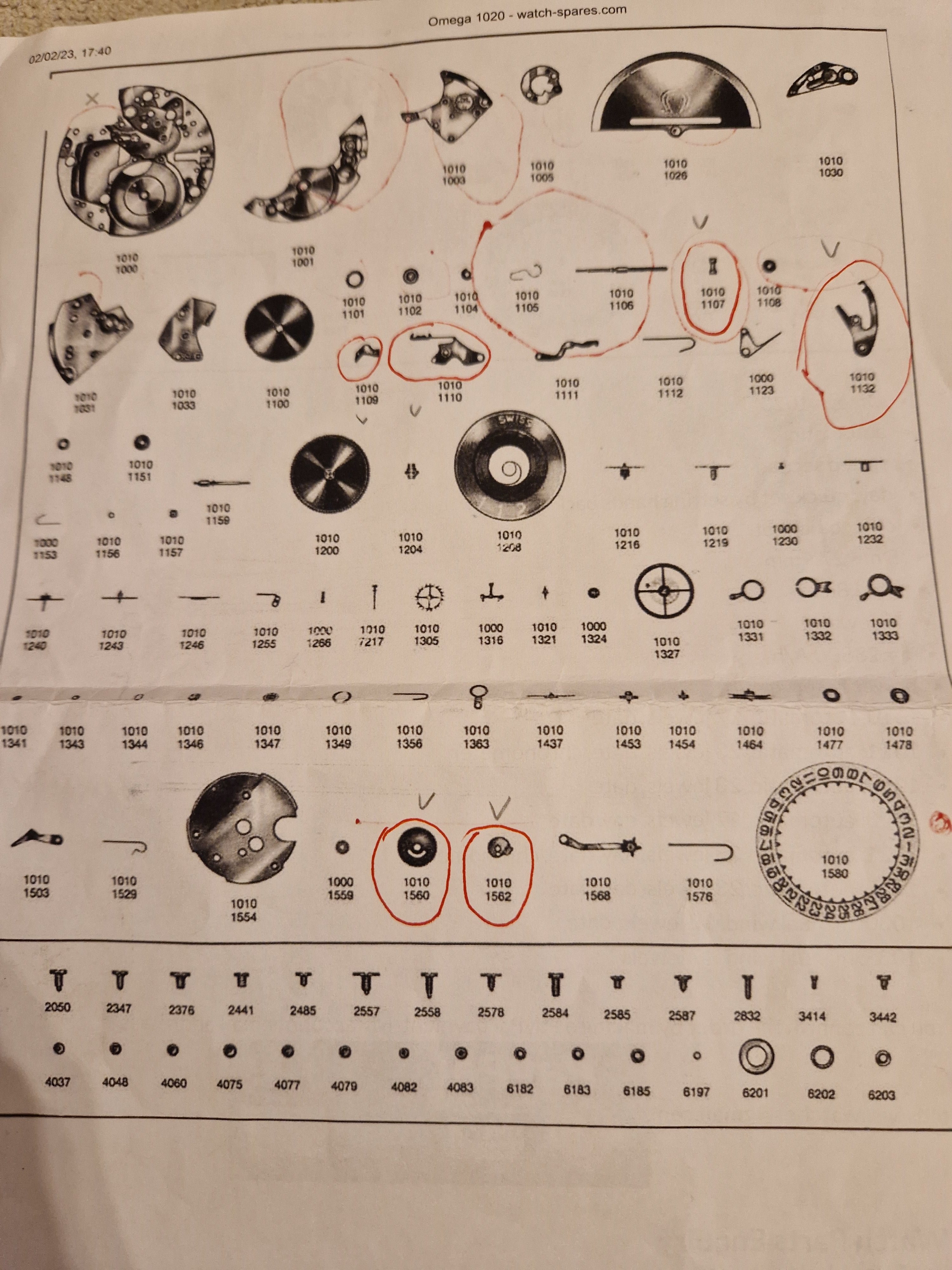

Hi all, i need an help from expert, i need to change these parts of my Omega Cal 1020. Date parts is complete broken. I think is better to search complete movement for chenge all. Someone can help me to find a decent spares? Thank you. I'm based in Italy.

Start searching eBay.
Find a watchmaker with an Omega parts account.
Remember that unless you know a replacement movement is fully functional you may be buying one with similar issues to the one you have.

I think if you will order all those parts to Omega you will make a very expensive watch. Best solution will be to start searching on ebay for whole mechanism.

The problem is that when you get the parts watch you still need these parts to fix that watch as having a watch missing part is a watch that needs parts.
This then becomes a sysophean rabbit hole where you are always pushing the rabbits up the hill.

BENE..i look many cal 1022 with better price than 1020....if i buy one of these and use only a data part?

Parts are available from similar Omega movements. Don't have to run to a watchmaker with an Omega parts account. Many parts are still available for this caliber.
You might need to decide if it's worth repairing though
3 parts are close to $110 new, but can buy them new and used off Ebay. You need two bridges, but have to find two that match the condition of the rest of the movement (unless you don't care)
Sometimes watches can turn into money pits when the parts and time cost far more than the watch is worth
I would figure out the parts cost before buying + watchmakers to time to clean and repair before spending any money

With 1020/1022 donor movements, gold plating is your friend. If you find one with a nice clean dial and a case destroyed from wear through it’s going to be the best candidate for salvage.
Earlier models in gold cap or golf filled cases tend to only lose edges with polishing or wear while gold plate just gets ruined easily.

l'orologio che voglio aggiustare è un cal 1020. è già stato pulito e revisionato, il meccanismo funziona abbastanza bene. la parte del datario, invece, è troppo consumata. Ho trovato un cal 1022, con datario funzionante a buon prezzo. quindi potrebbe essere una buona idea farlo?
