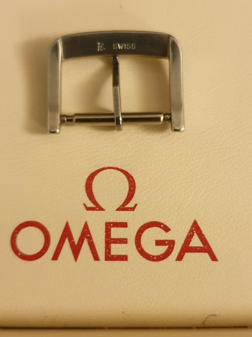

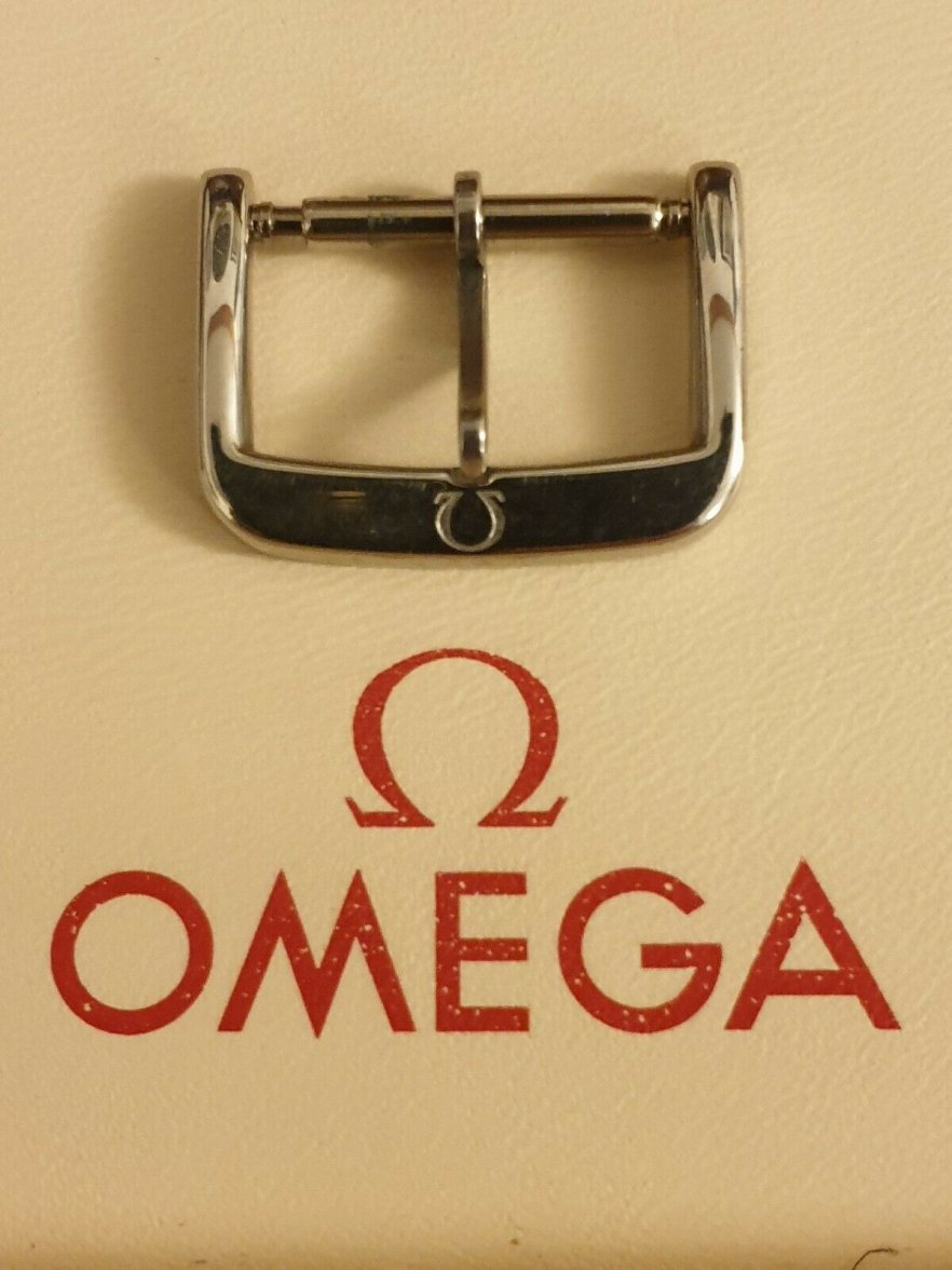

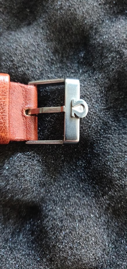

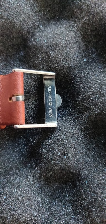

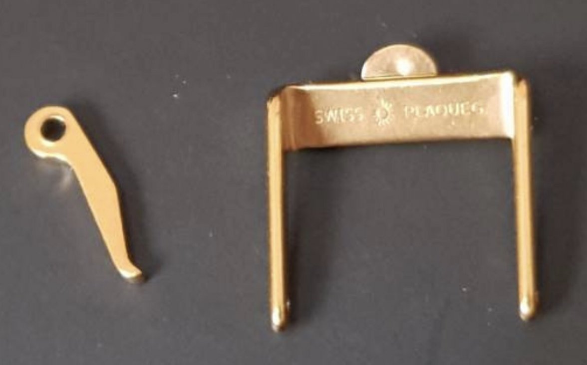

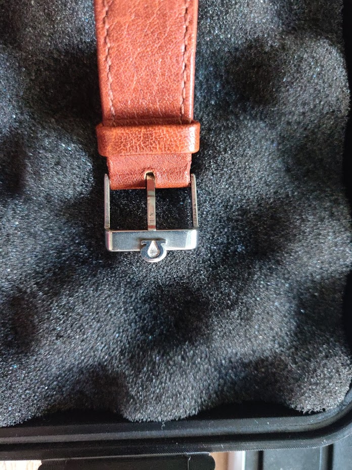

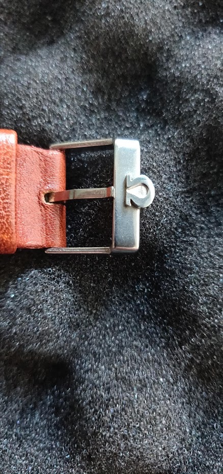

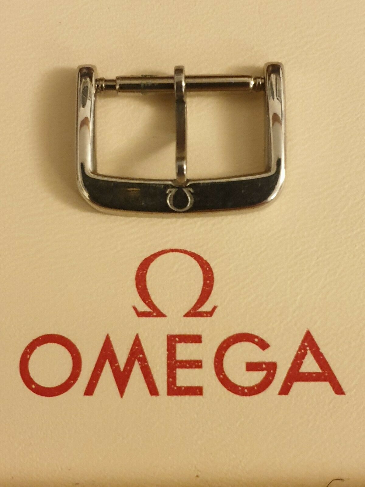

Dear Forum,
I have a 1968 Seamaster, 165.002 and have been researching Omega buckles, I have read the threads a couple of times and wondered if the experts could give their opinion on whether the below looks genuine? Prices around £60. Not sure if the "B" is in the same direction as the Omega.
As always manby thanks in advance,
Dave
2,326
1,887
Looks fine to me. The B is for Banda, the contract manufacturer. Fairly typical.
Tom
323
1,135
Tom
Thanks for the input Tom does the price of around £60 sound reasonable too?
2,326
1,887
It's not bad. As mentioned, it's more 80s than 60s.
Tom

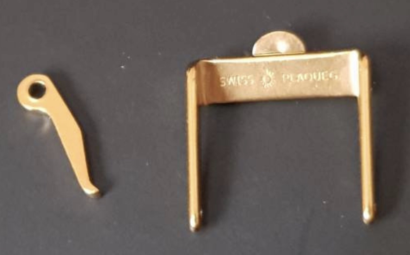

383
349

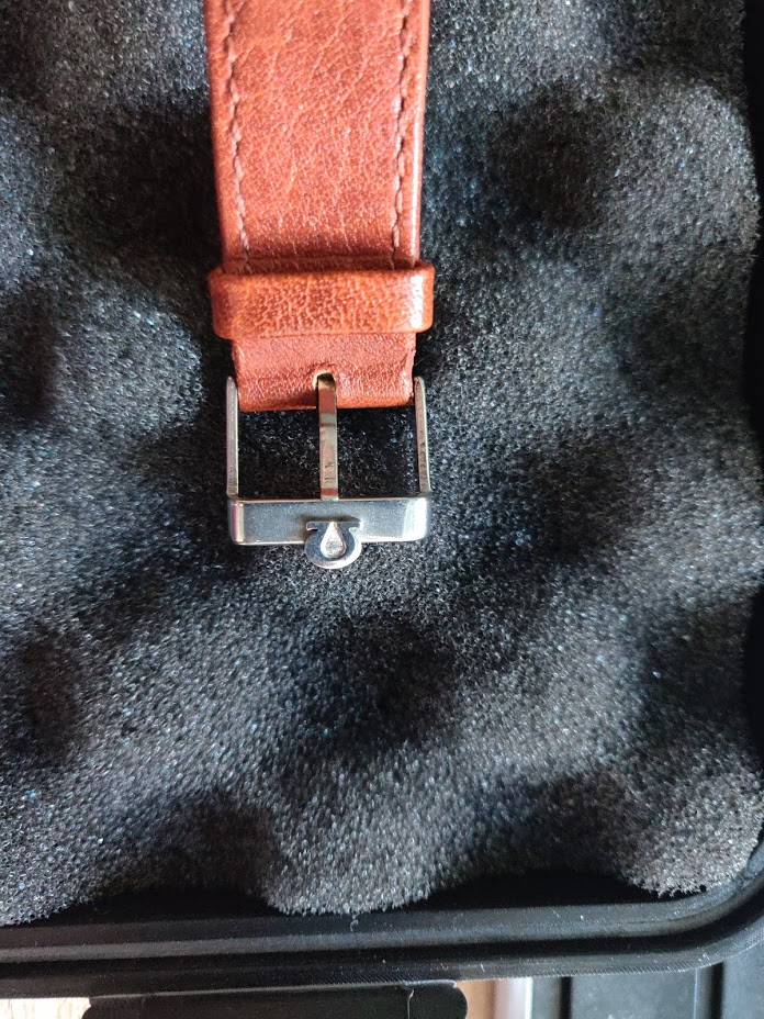

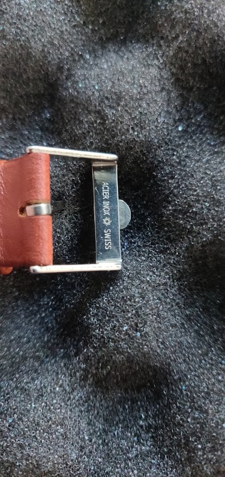

I ended up buying the one below. Also same measurements. It is for my 1944 bumper. Not period correct but the best I could do in gold with nice Omega logo.
2,326
1,887
1944 buckle would not have a logo. Those weren’t used until approximately late 50s.
Tom

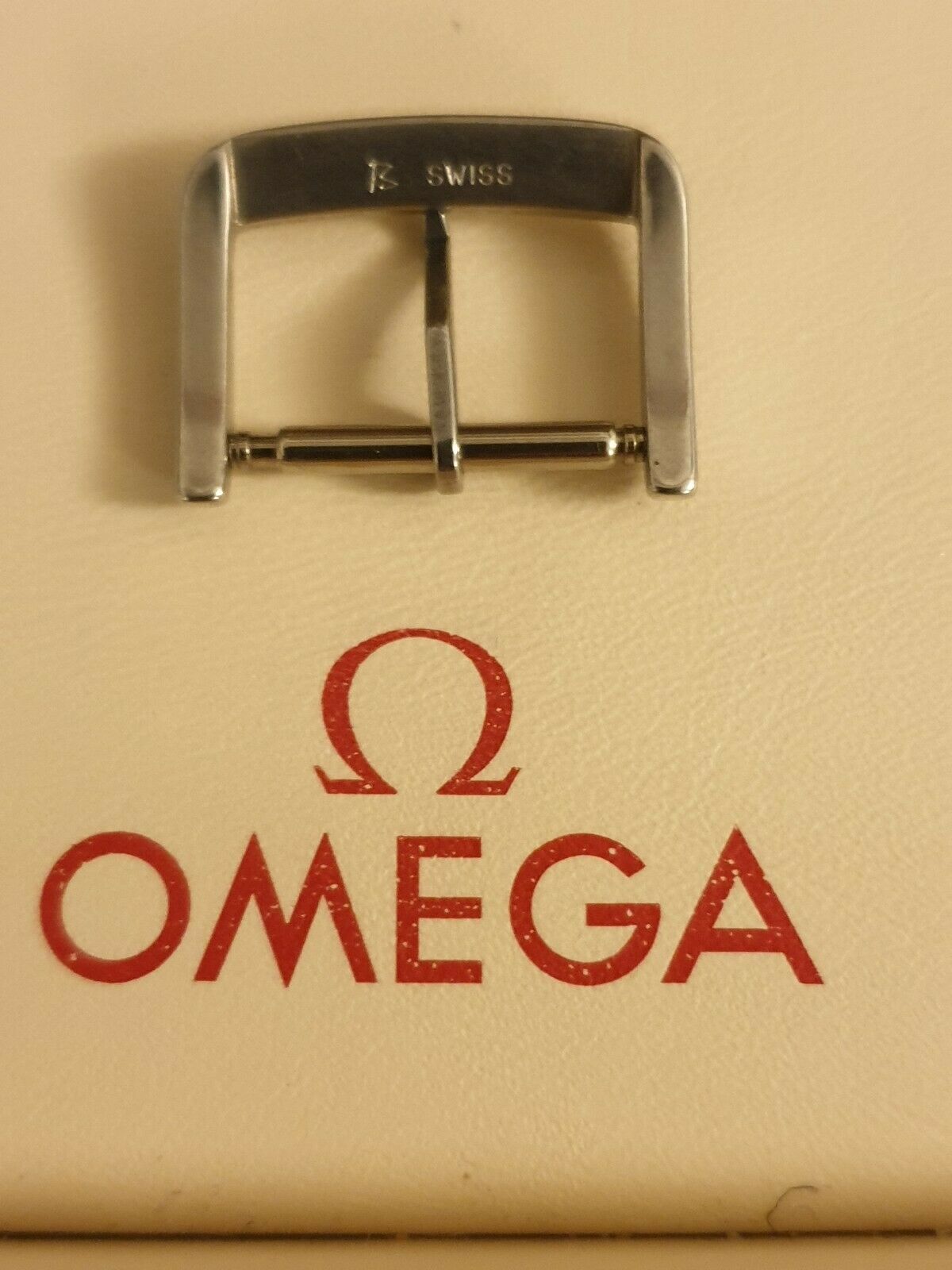

323
1,135

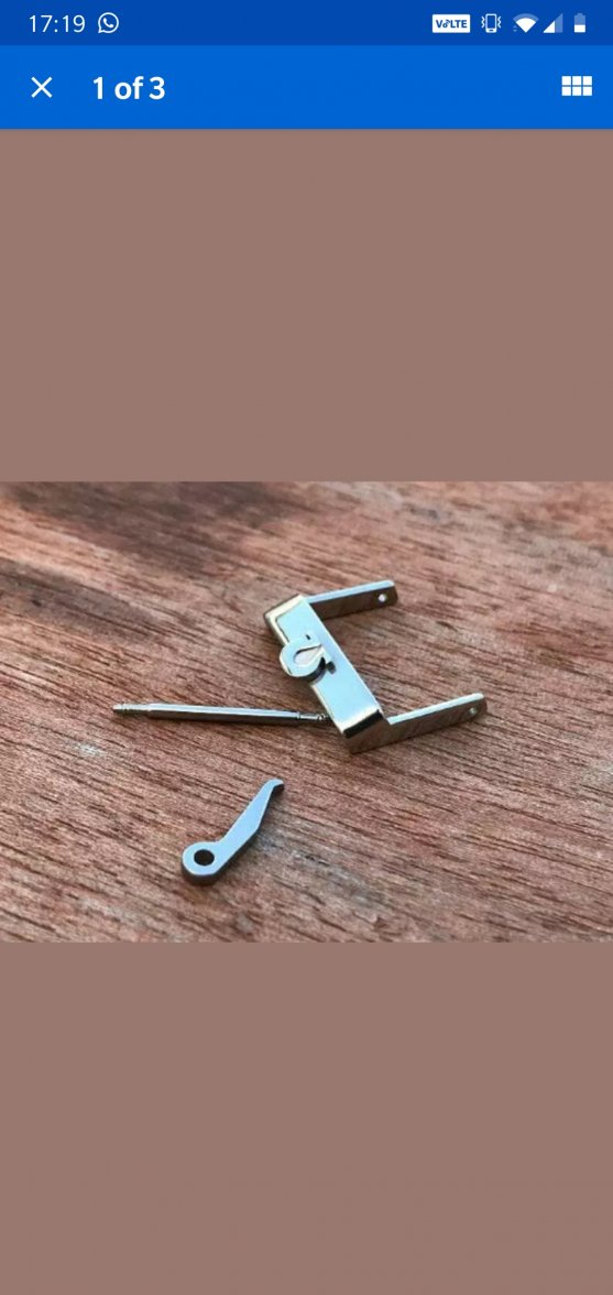

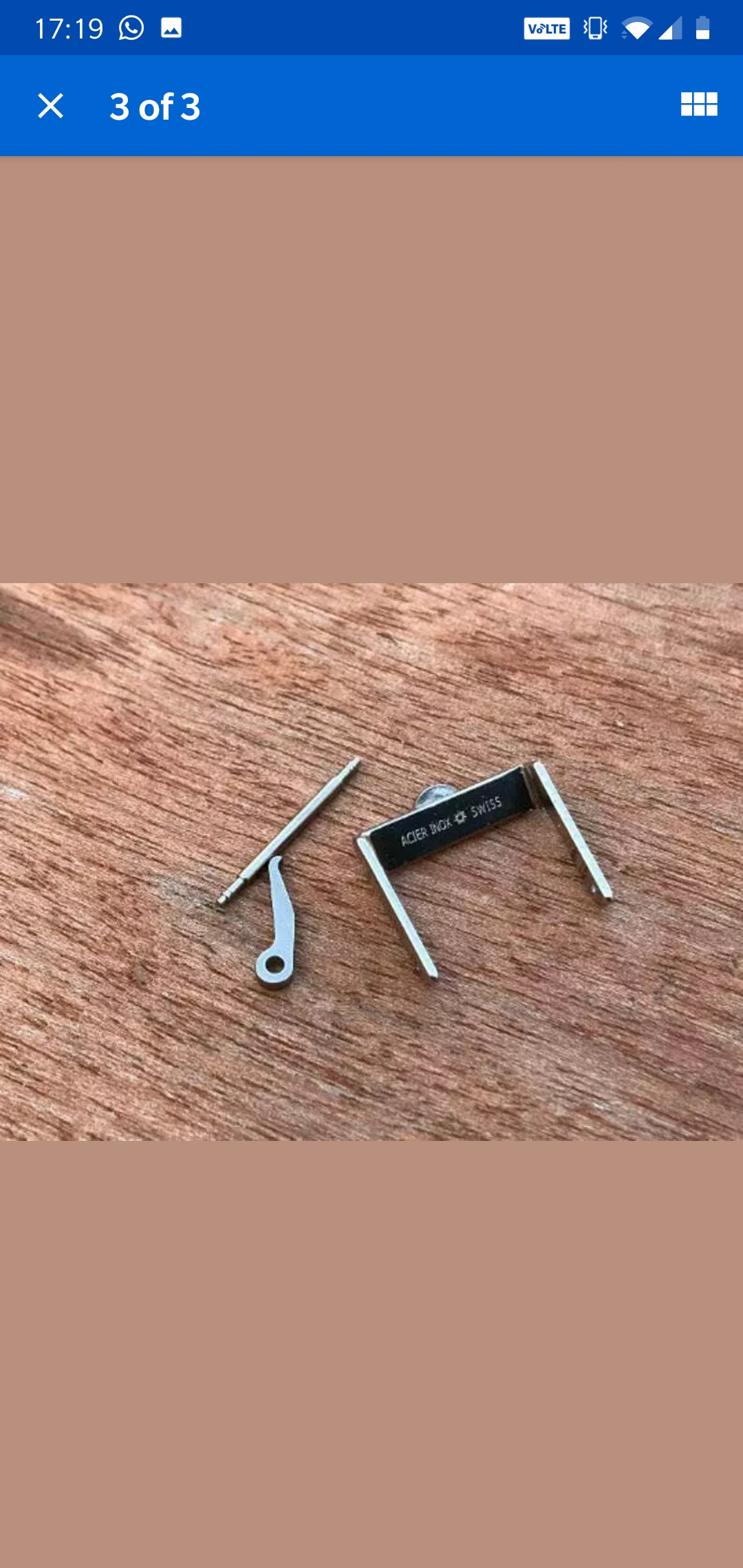

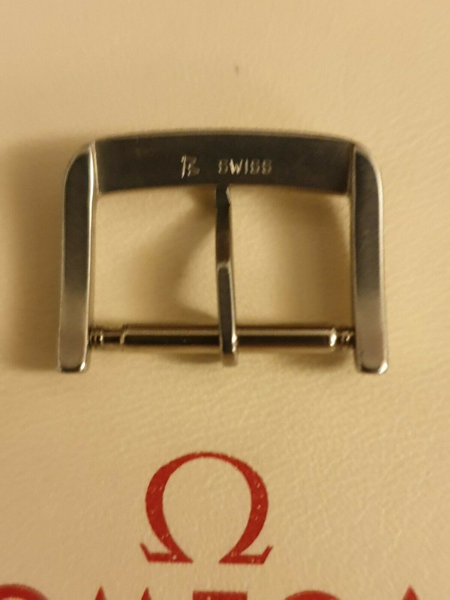

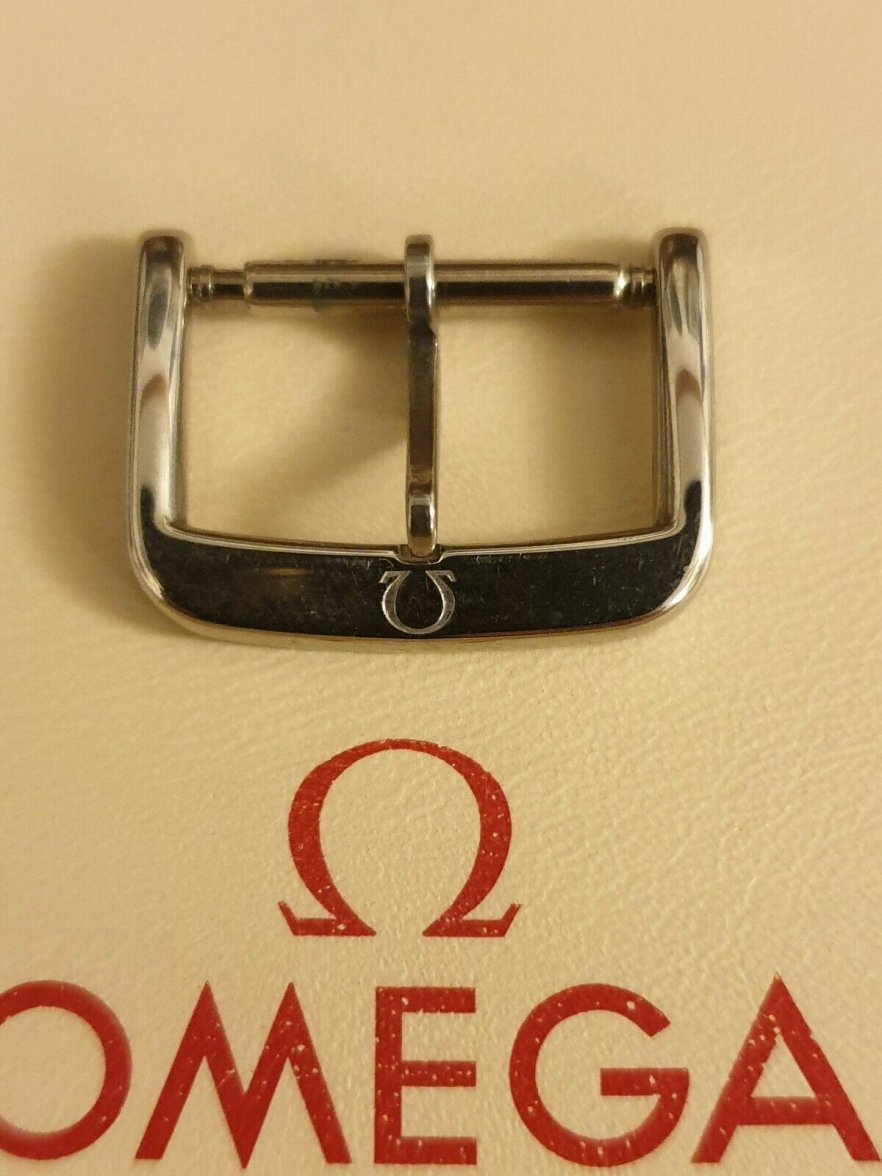

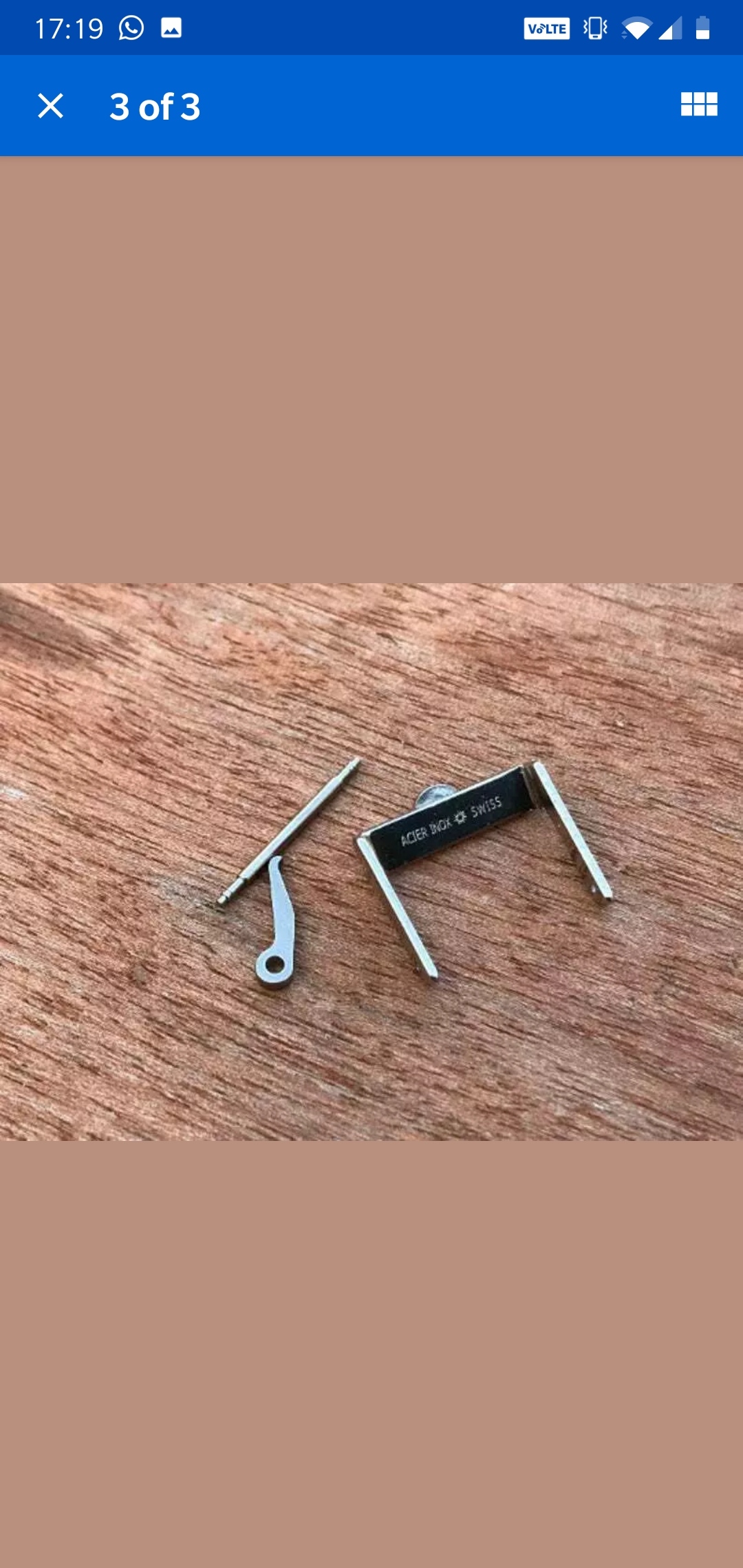

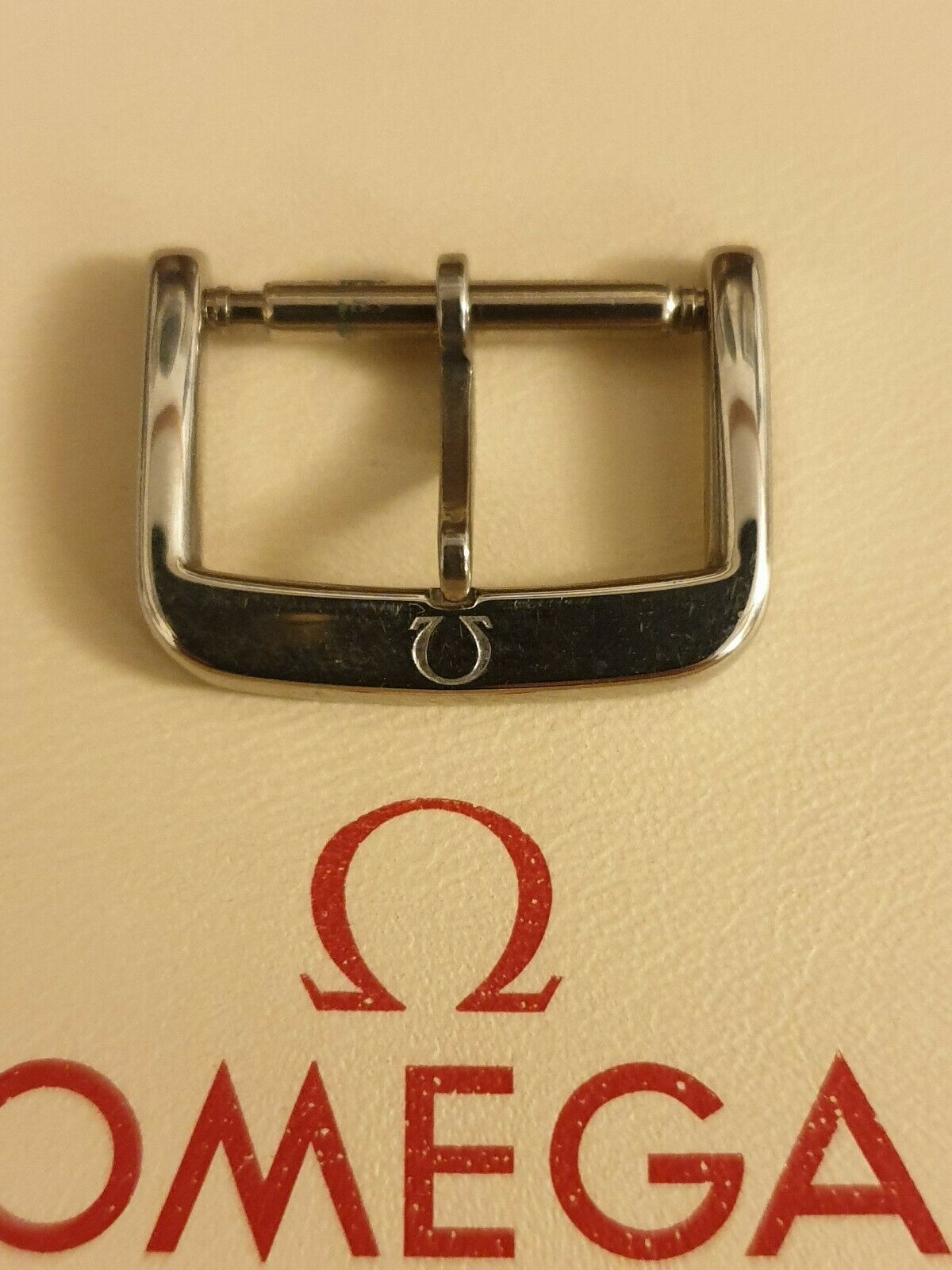

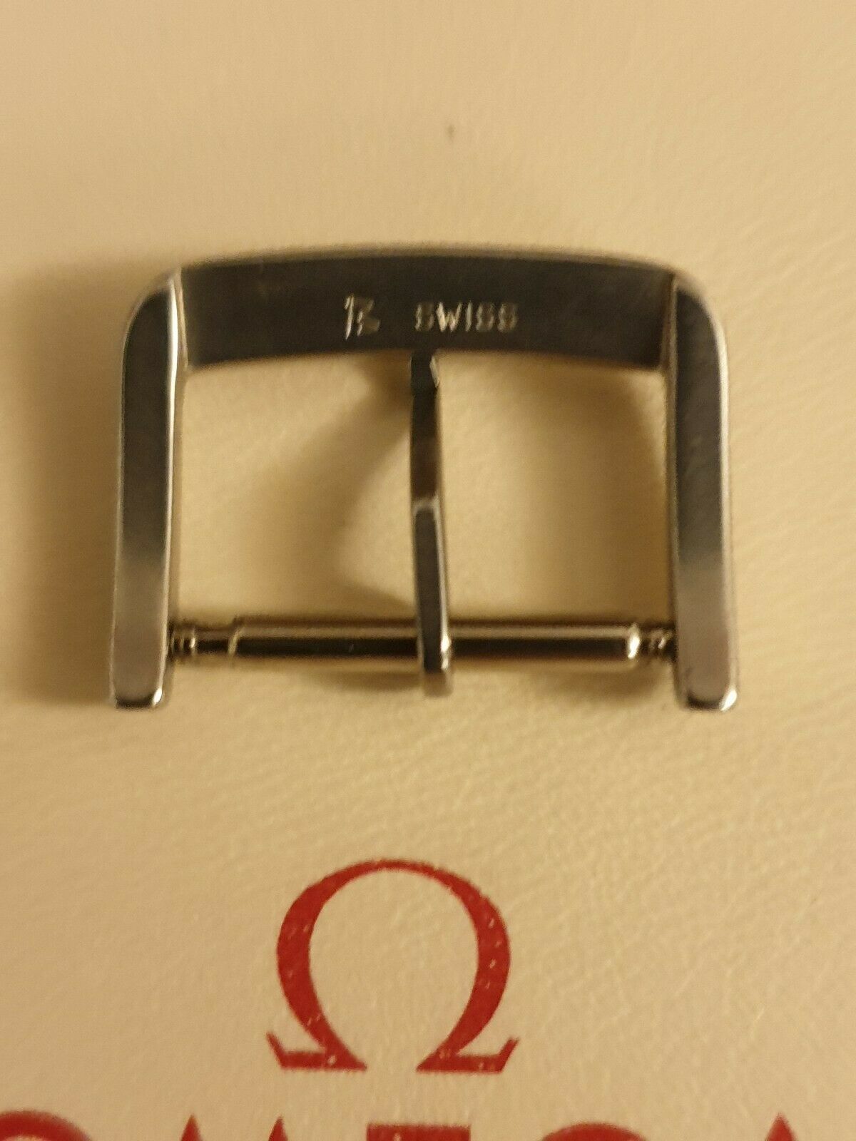

This was the other buckle I was looking at which seems to align to 1960's based on the thread I have been looking at on buckles...engravings looks right too.
383
349
Tom
I know. But at least it is vintage and I like the logo on a buckle.
1,120
1,792
Hi Dave,
I warned you this is how the disease starts. 😀
That’s about the right period I would say.

343
1,008
I have been looking at those too but I have come to the conclusion that they are fake. The upper part of the Omega is too thick, the angle of the tang is wrong and the spring bar is of course nothing like the original.
Yep and also probably too cheap to be genuine...we need a nice NOS seller/genuine stock seller for buckles patience is the key for us whilst searching 😀

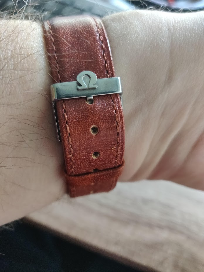

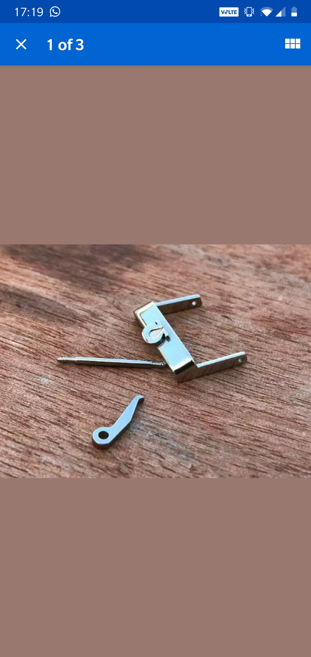

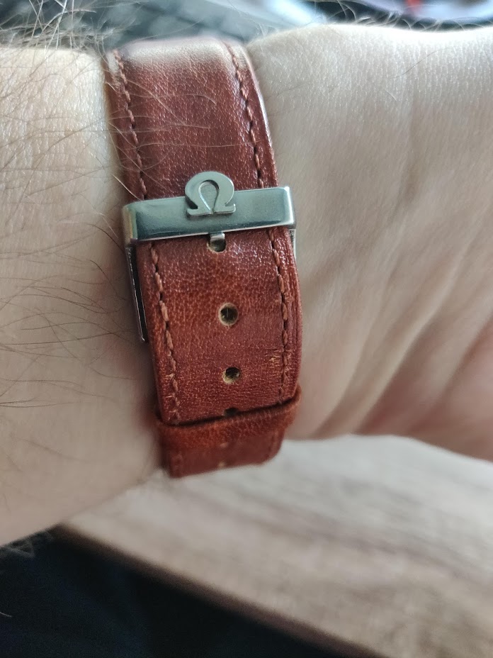

Afternon OF,
