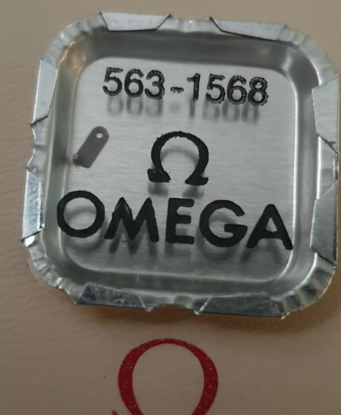

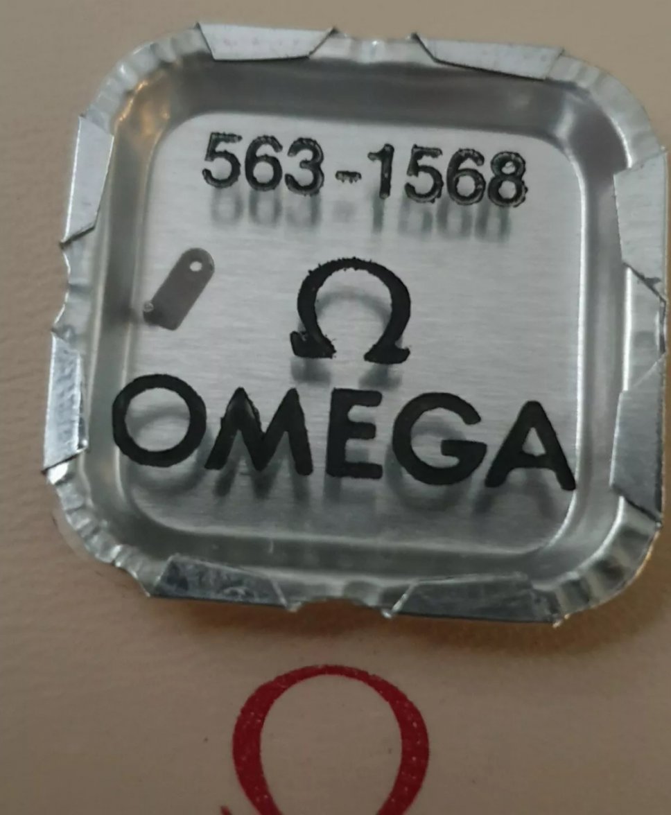

I suspect that you have a 563 with a broken date setting dongle (part 1568 - Correcting Yoke).

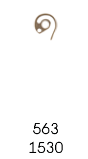

The part that is most likely to have failed (as it is designed to do when the load becomes too high) is this one:
You won't see it in that other thread because it has the steel design that we usually replace with the one above. This is the best advice:
