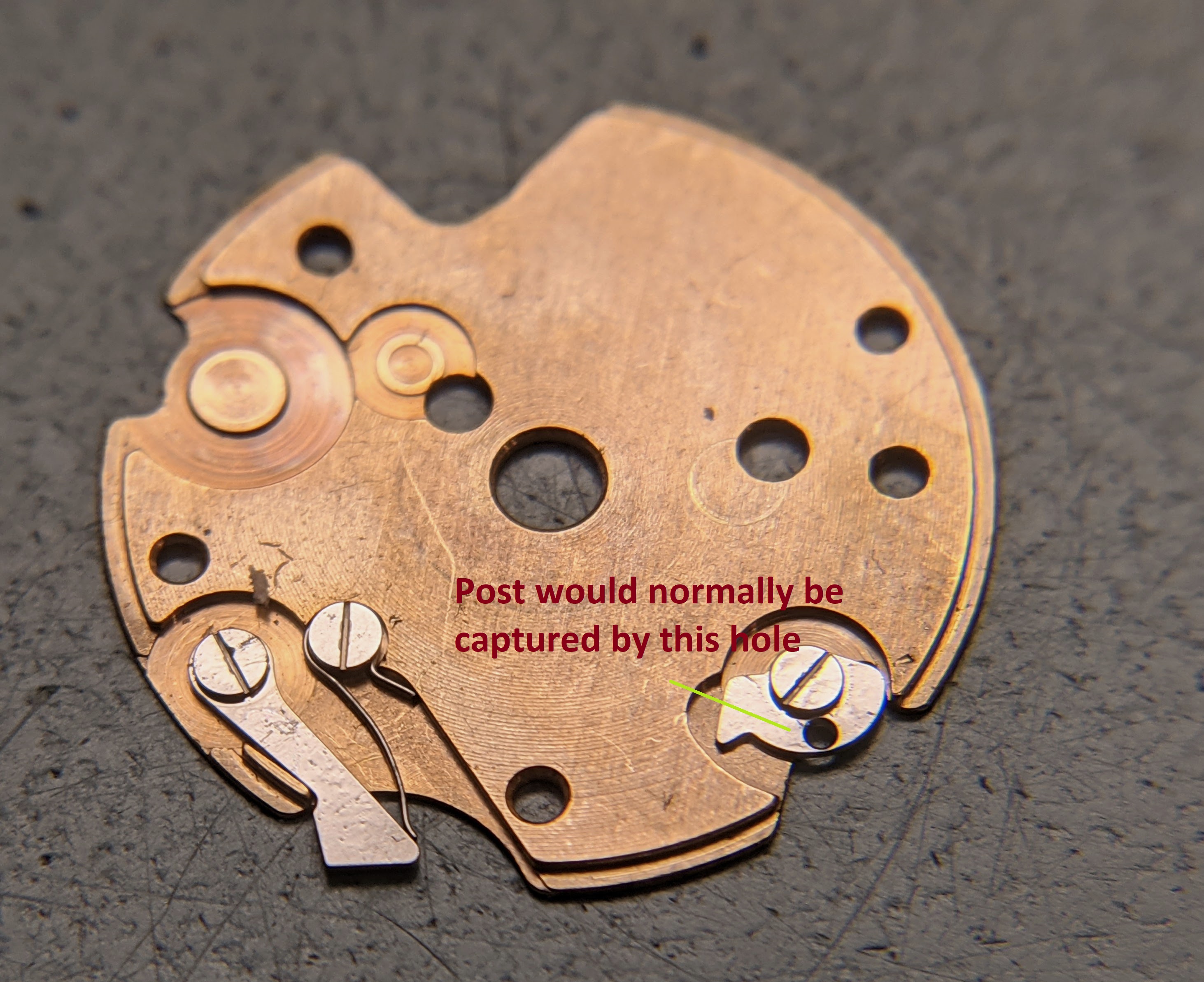

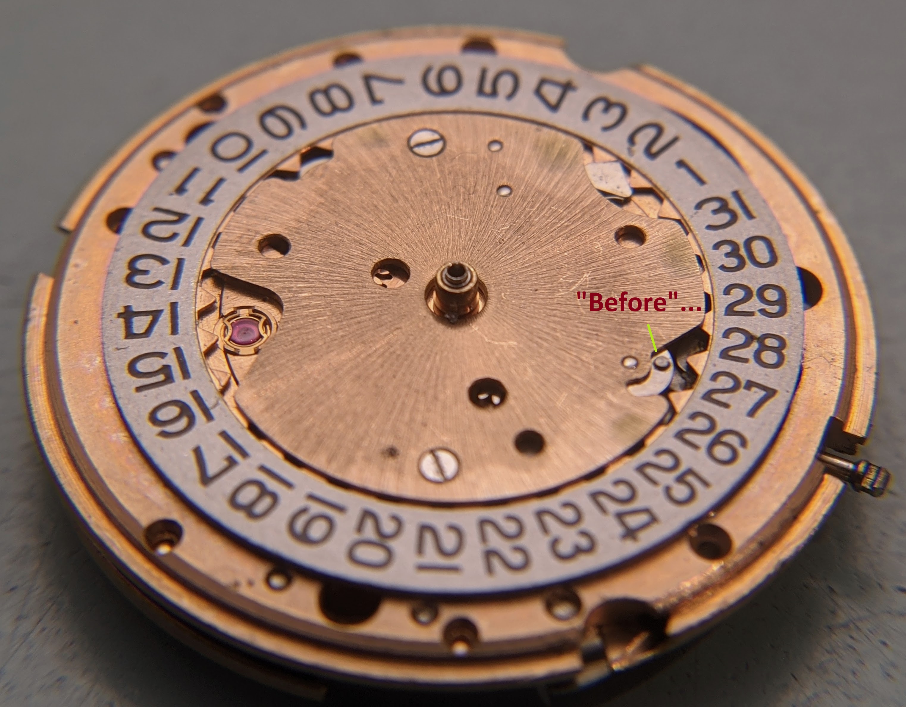

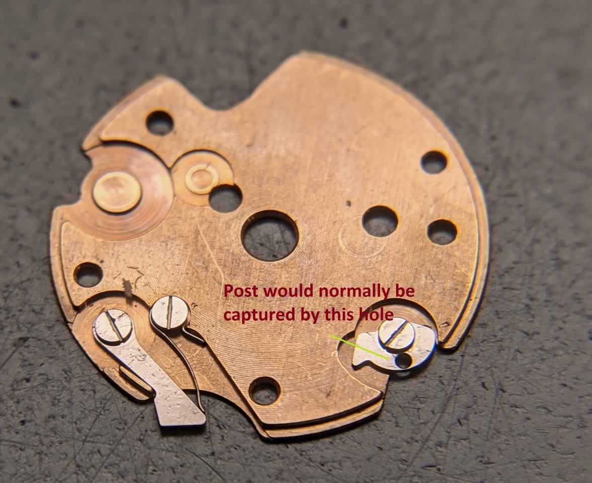

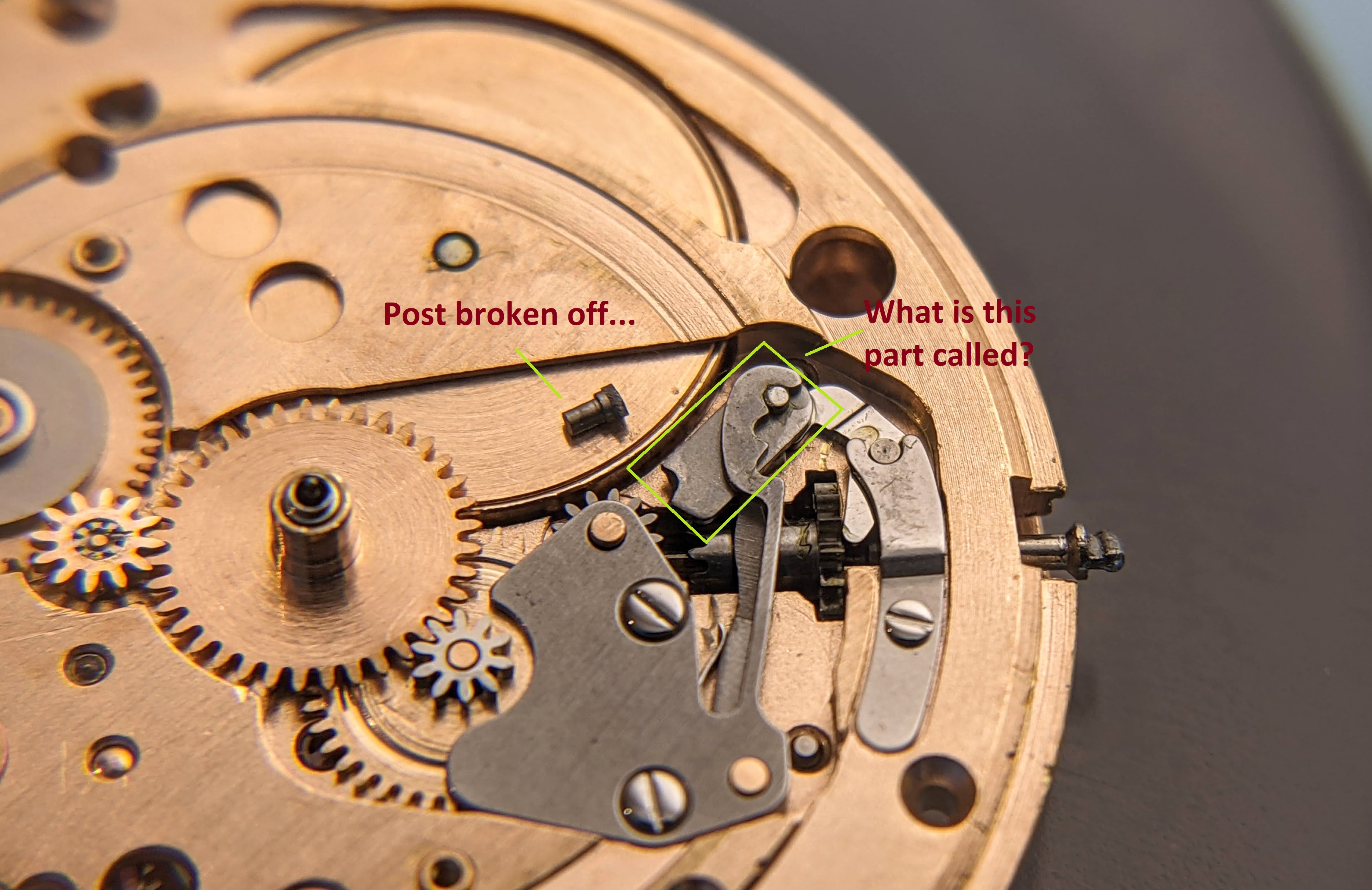

Posts 348 Likes 1,180 WestCoastTime ·May 26, 2021 Related (I assume) to the Date quickset. If it were not broken the post would be captured by what I think is the quick-set date actuator on the underside of the calendar works cap Likely that I reassembled it incorrectly & snapped the post when pulling out the crown (maybe)

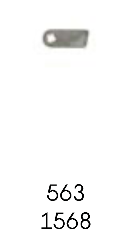

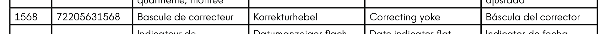

Posts 18,840 Likes 39,182 JimInOz ·May 26, 2021·Melbourne Australia I think this is it, but wait for confirmation.
Posts 348 Likes 1,180 WestCoastTime ·May 26, 2021 JimInOz I think this is it, but wait for confirmation. Thanks, I think you're right, & complete with part number (leave it to the Australians to provide an answer in the middle of the night... ;-)
Posts 30,285 Likes 78,160 Archer ·May 27, 2021 JimInOz I think this is it, but wait for confirmation. Yes, you got it Jim.
