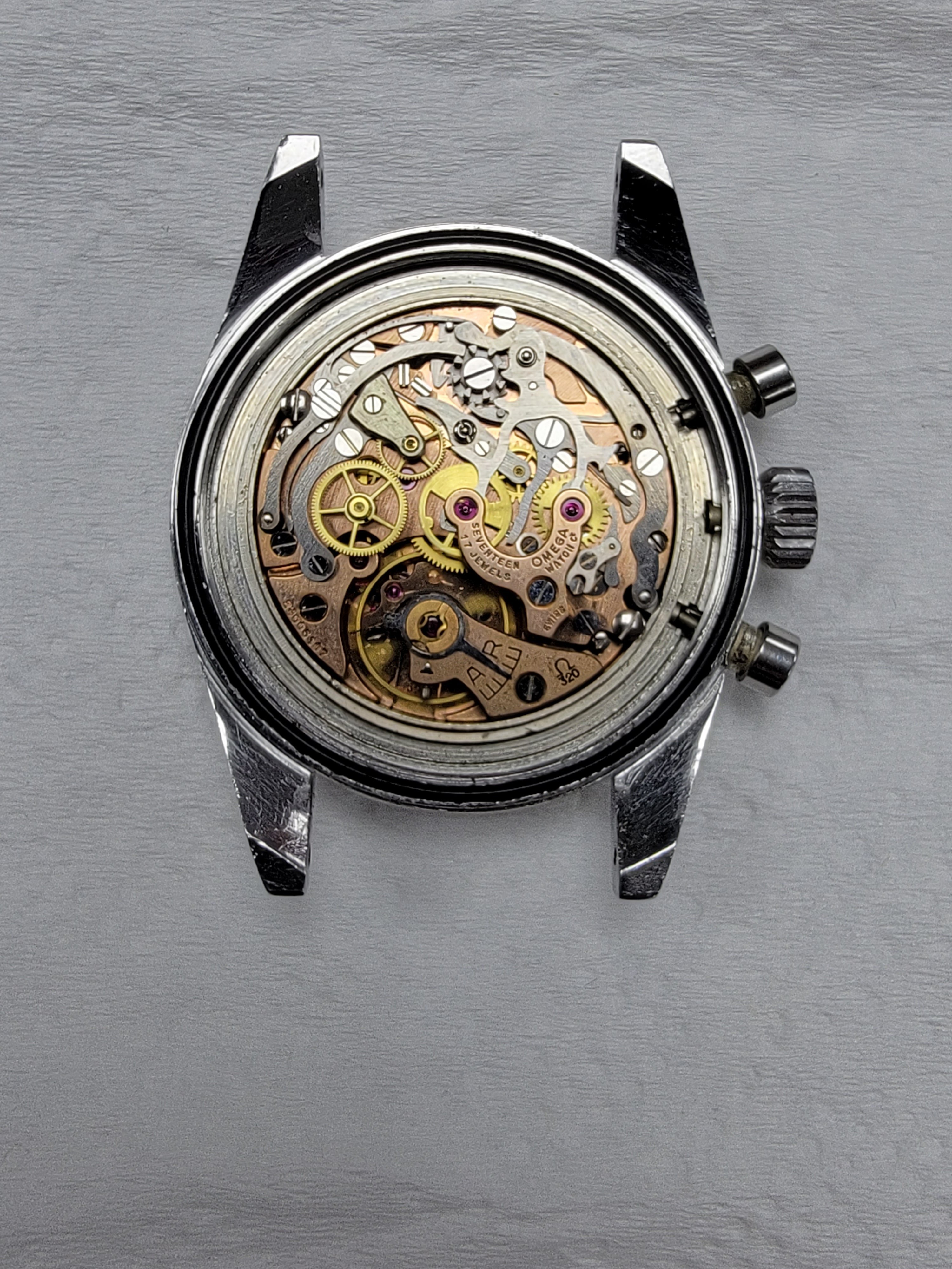

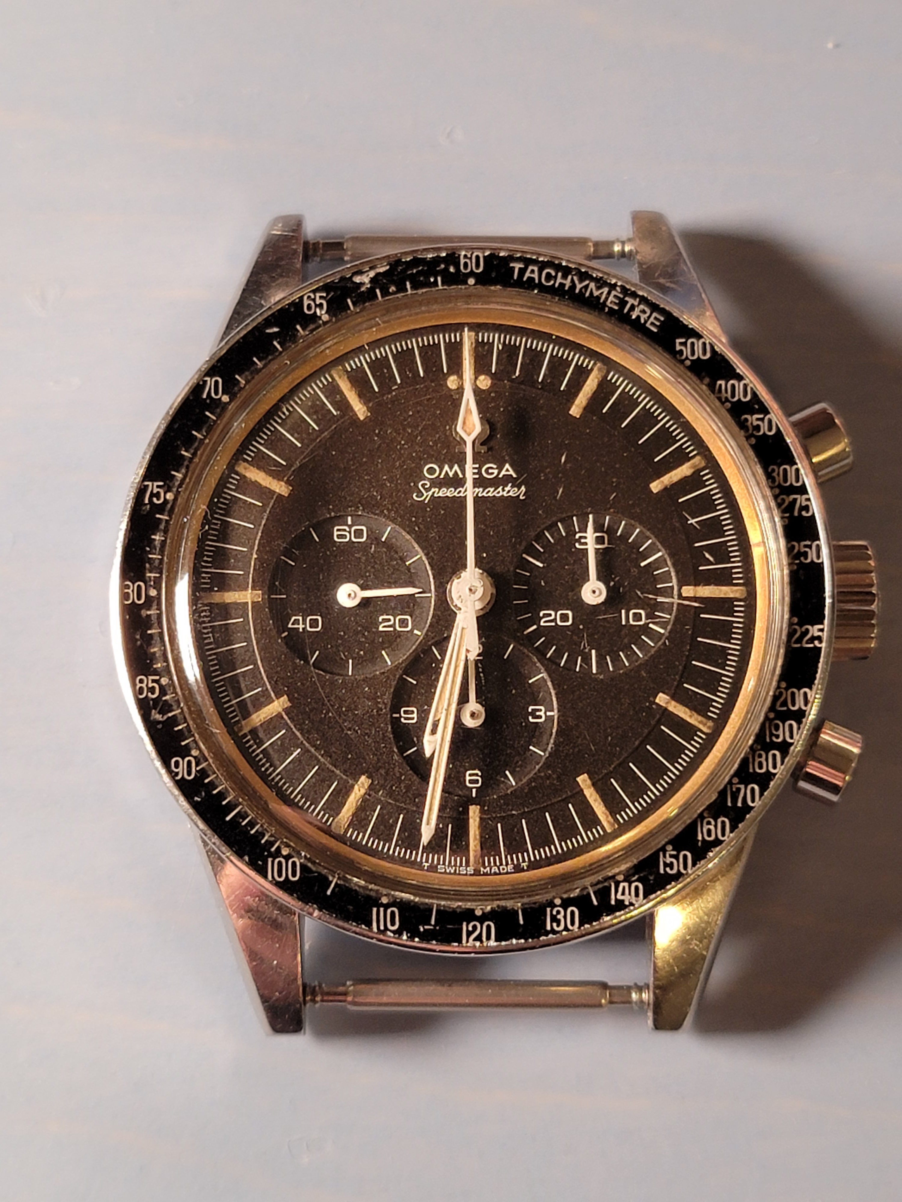

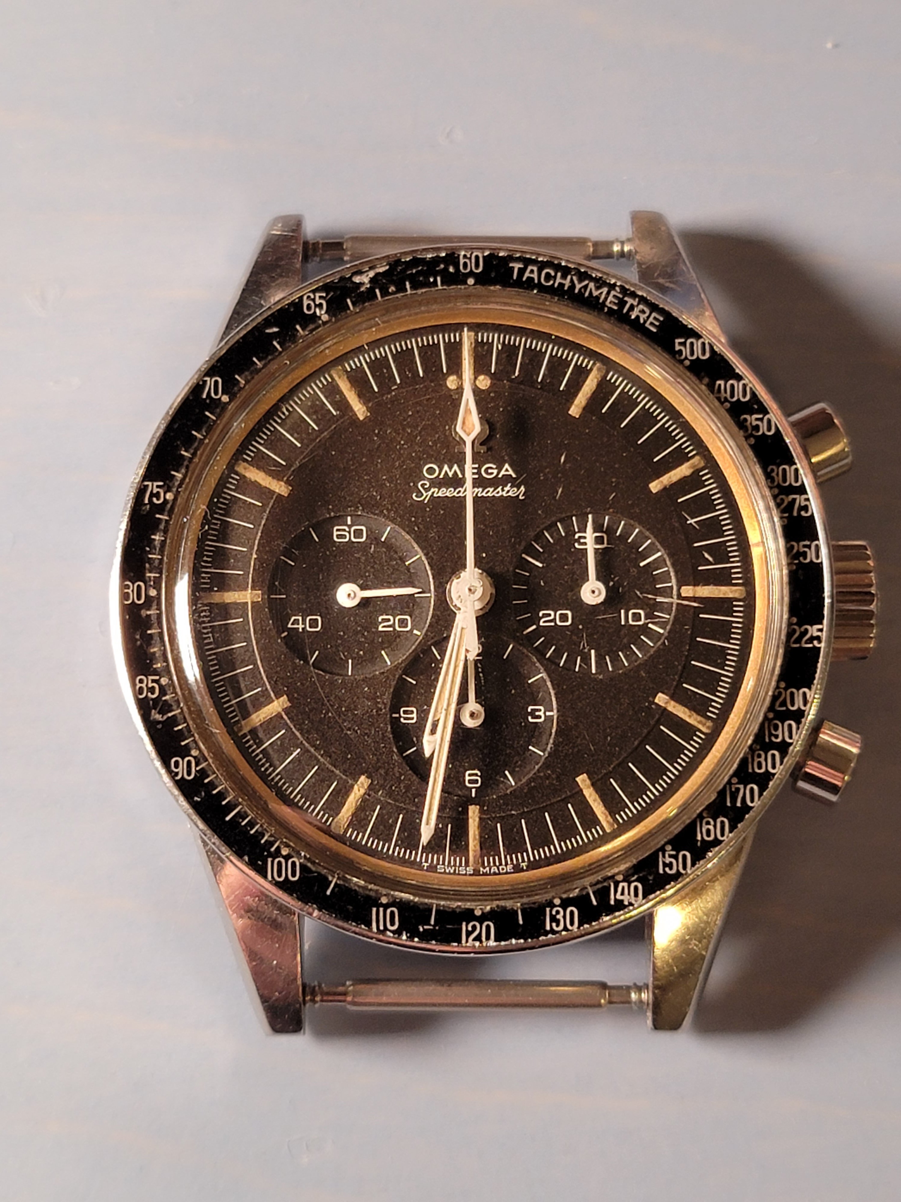

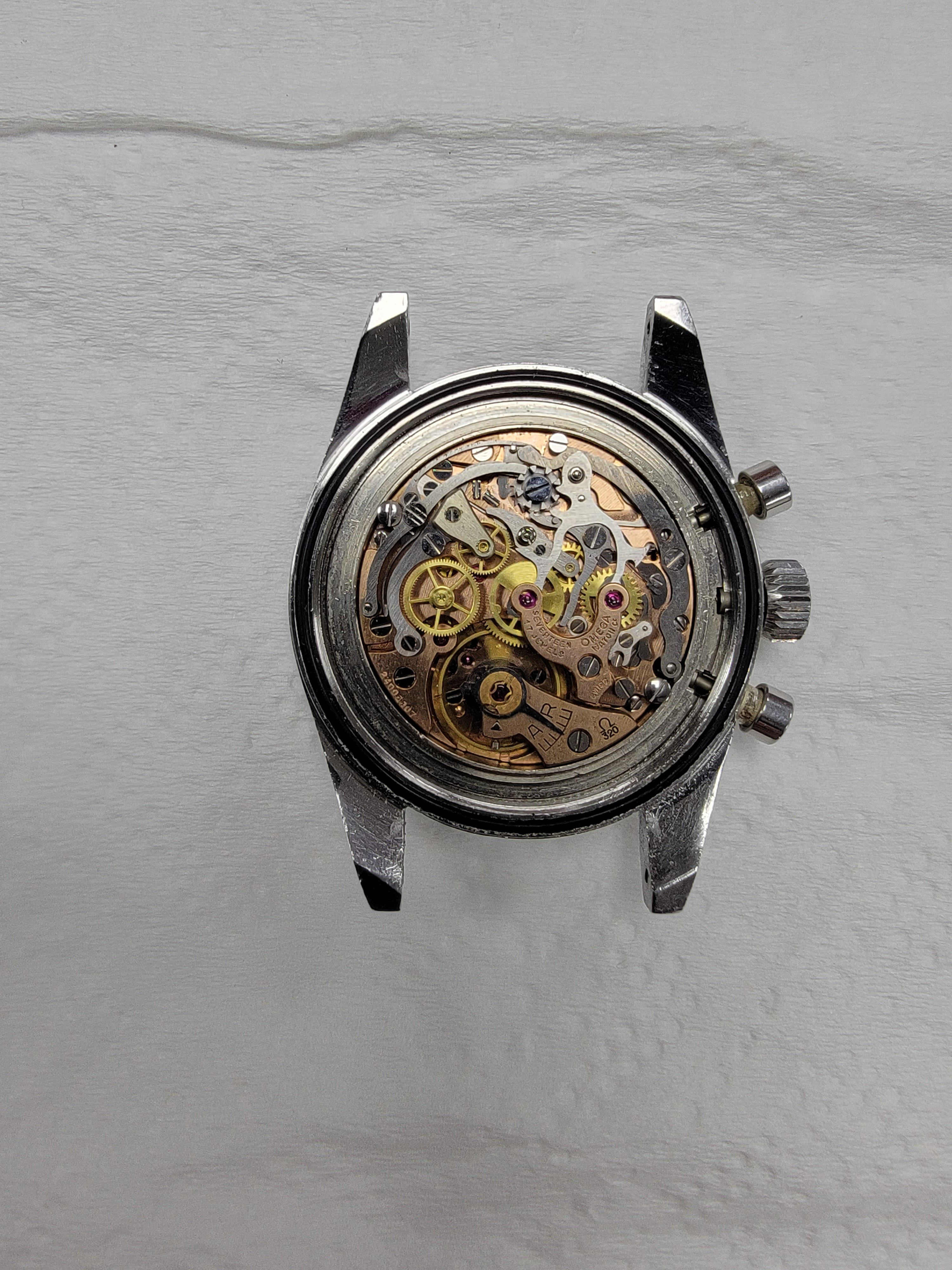

Hello everyone! I've recently come into possession of a Speedmaster. I took it to get serviced and I looked at the movement. Everything appeared to be in order (from what I could see as an amateur just comparing my watch to internet pictures). However, I noticed that the number by the OMEGA symbol read '320' instead of '321'. Is this just a case of certain parts being interchangeable between the two movements? Also, how will this impact any resale value? I'm not necessarily in a rush to sell it, but I'd like to know what I should expect.

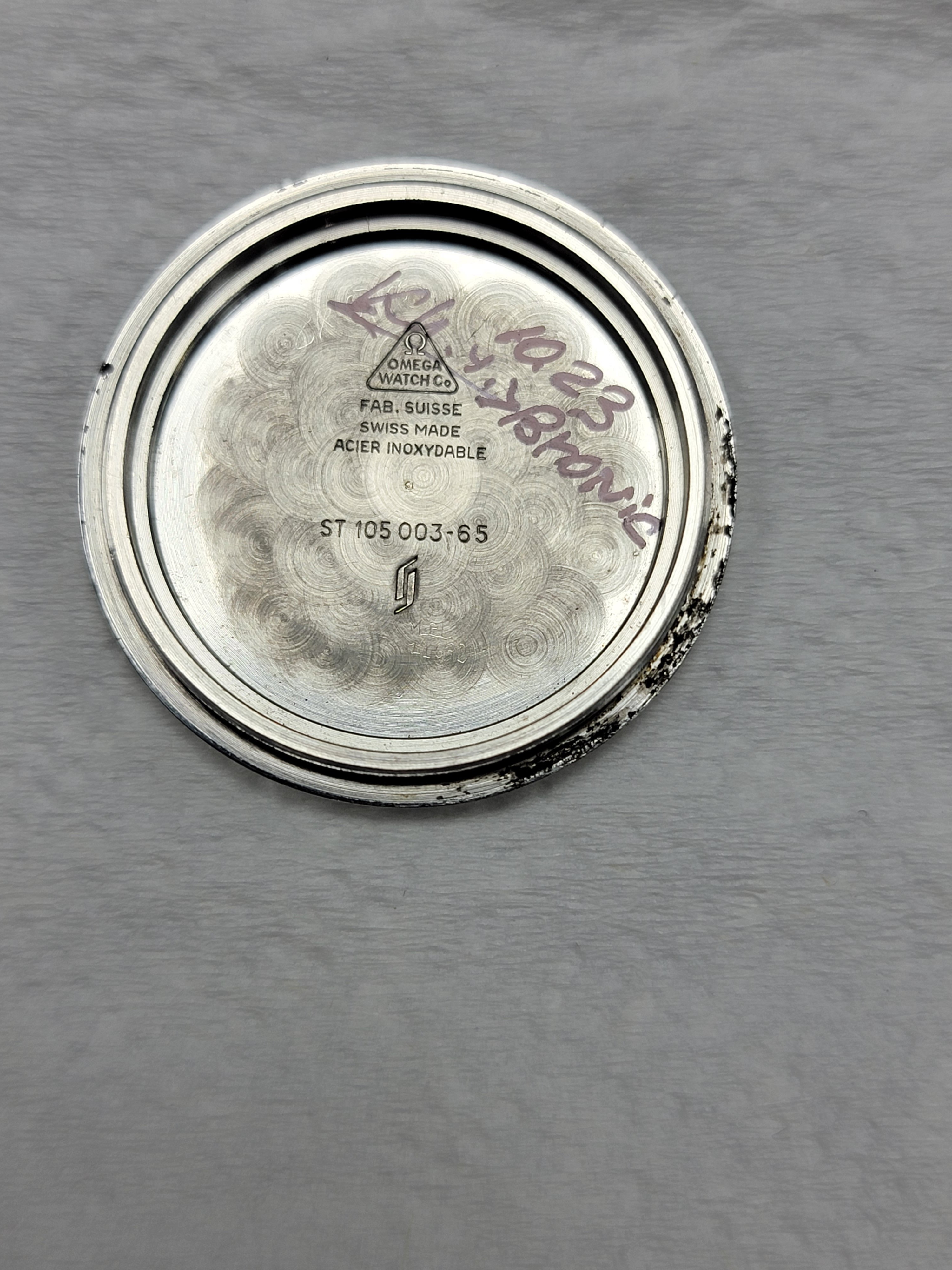

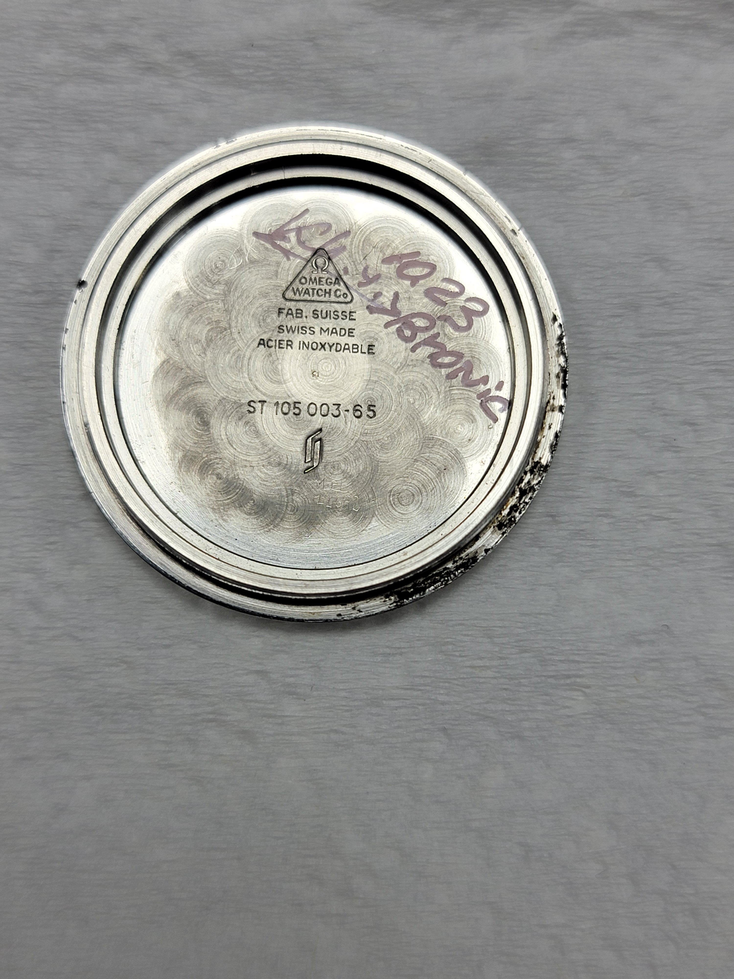

That's a pretty watch, welcome to the forum. Can you post the first few digits of the serial, or a photo that shows them more clearly. And the inside of the caseback.
Usually I see the cal 320 in other chronographs, like Seamasters. I assume the hour recorder works properly on your watch. 馃榾

Thanks! To be honest, I haven't tested the hour recorder. So I guess I'm assuming as well.

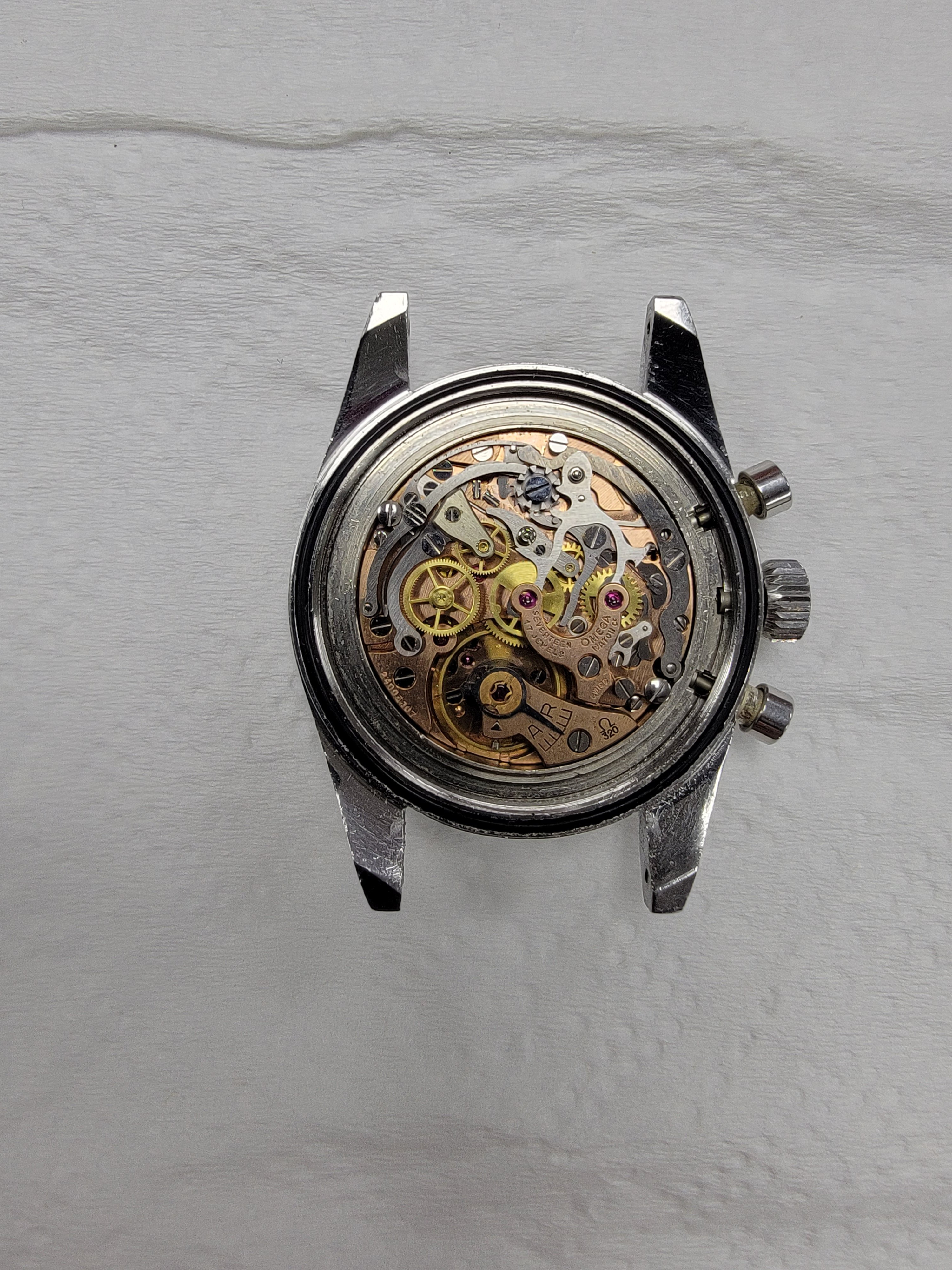

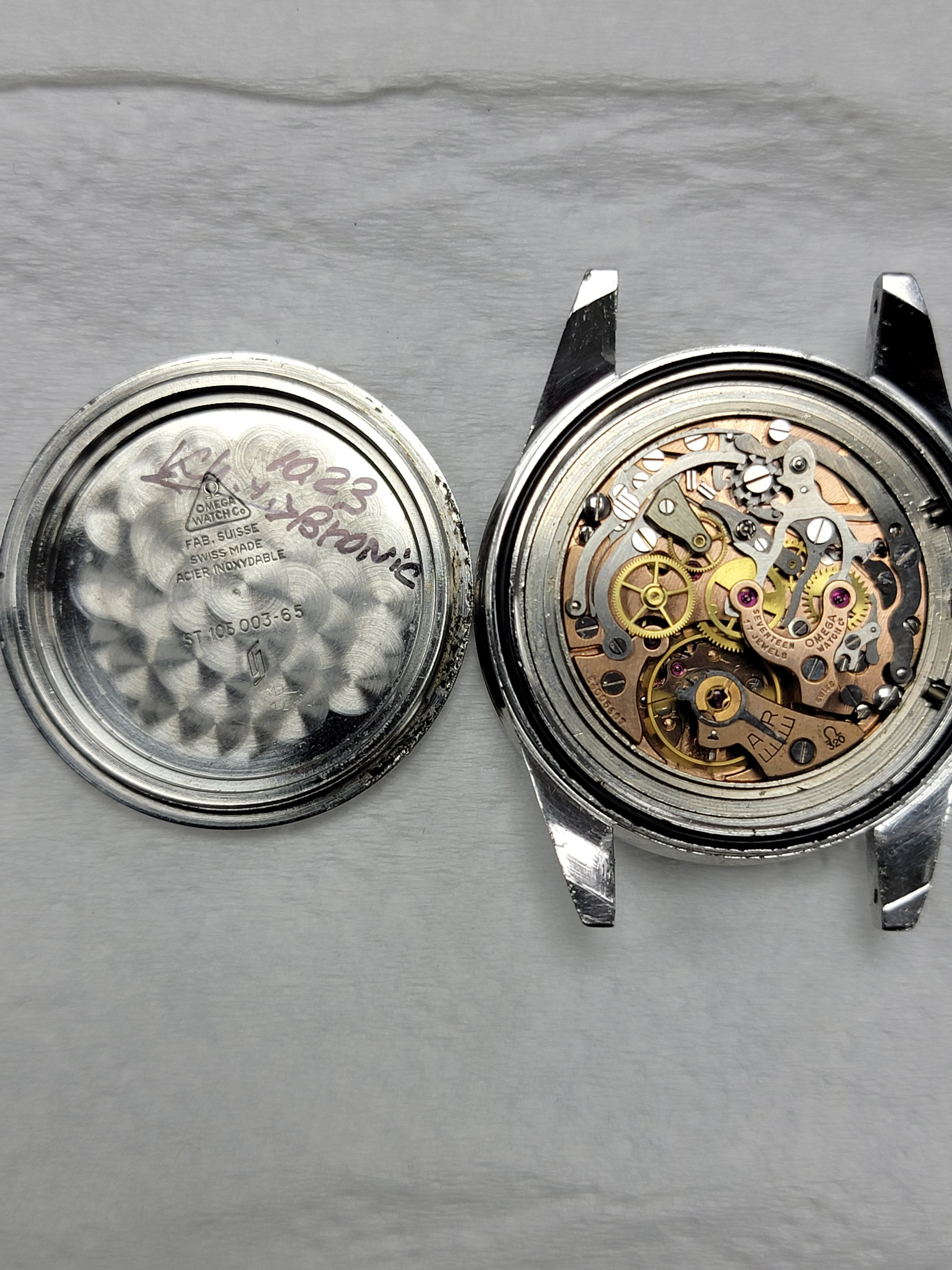

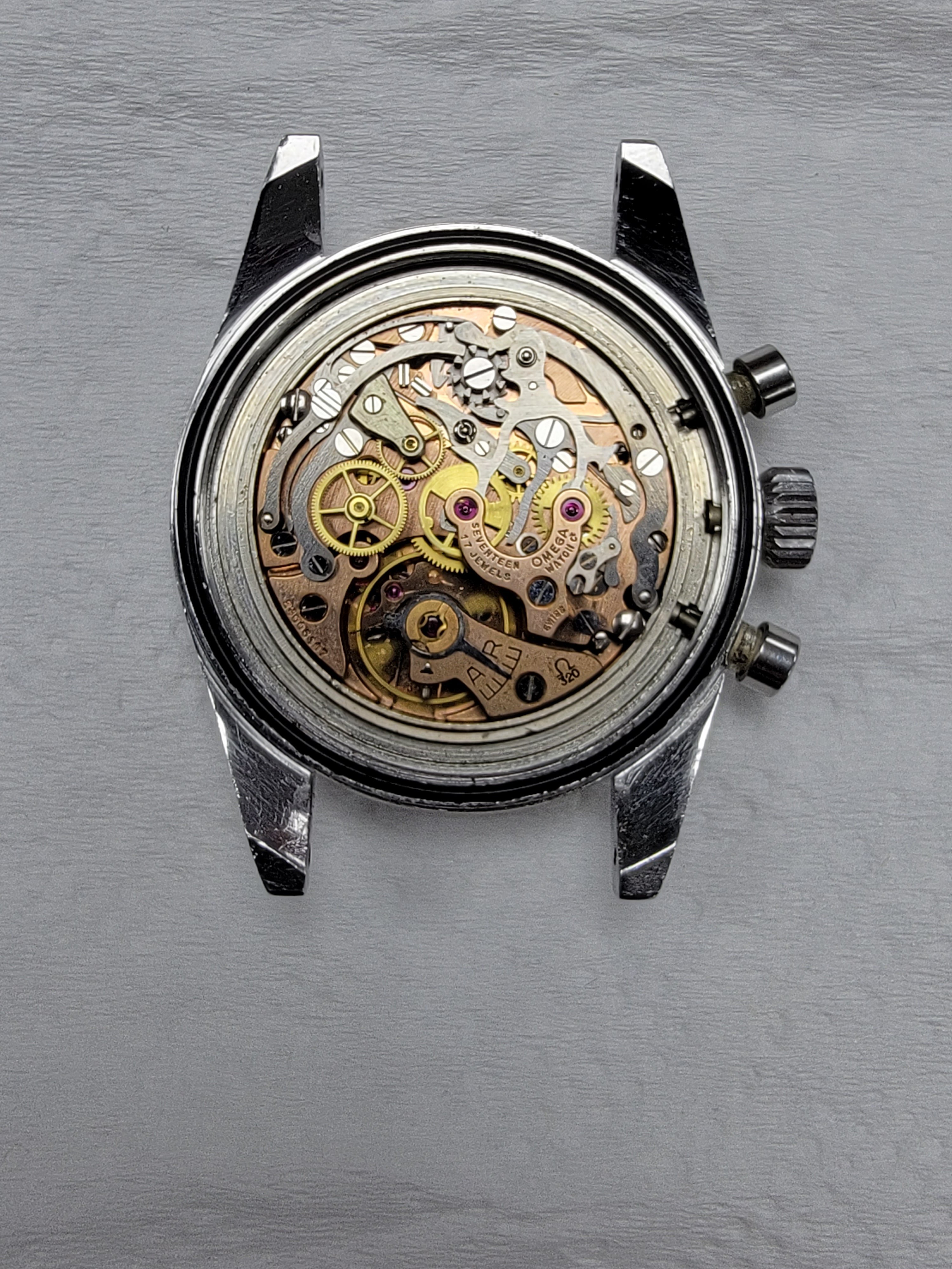

Here's a couple more I took before the watchmaker put the caseback back on.

Just based on these puctures, the serial number on the movement looks strange. Does it possibly look overstruck in person?
