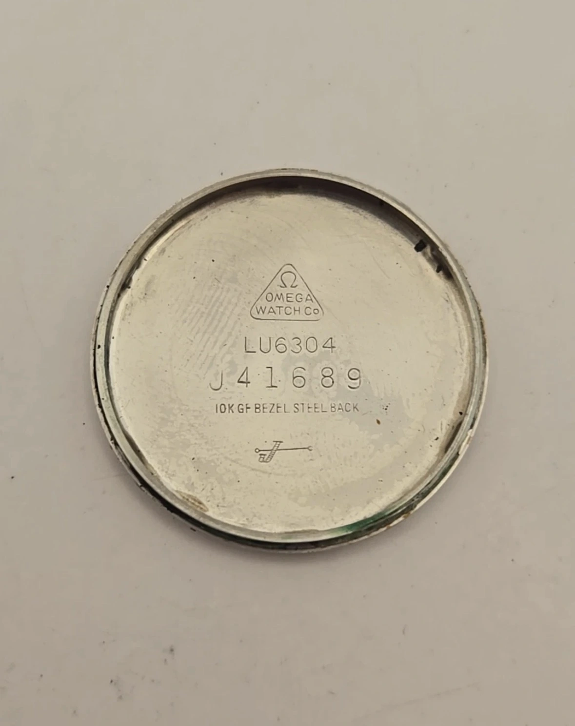

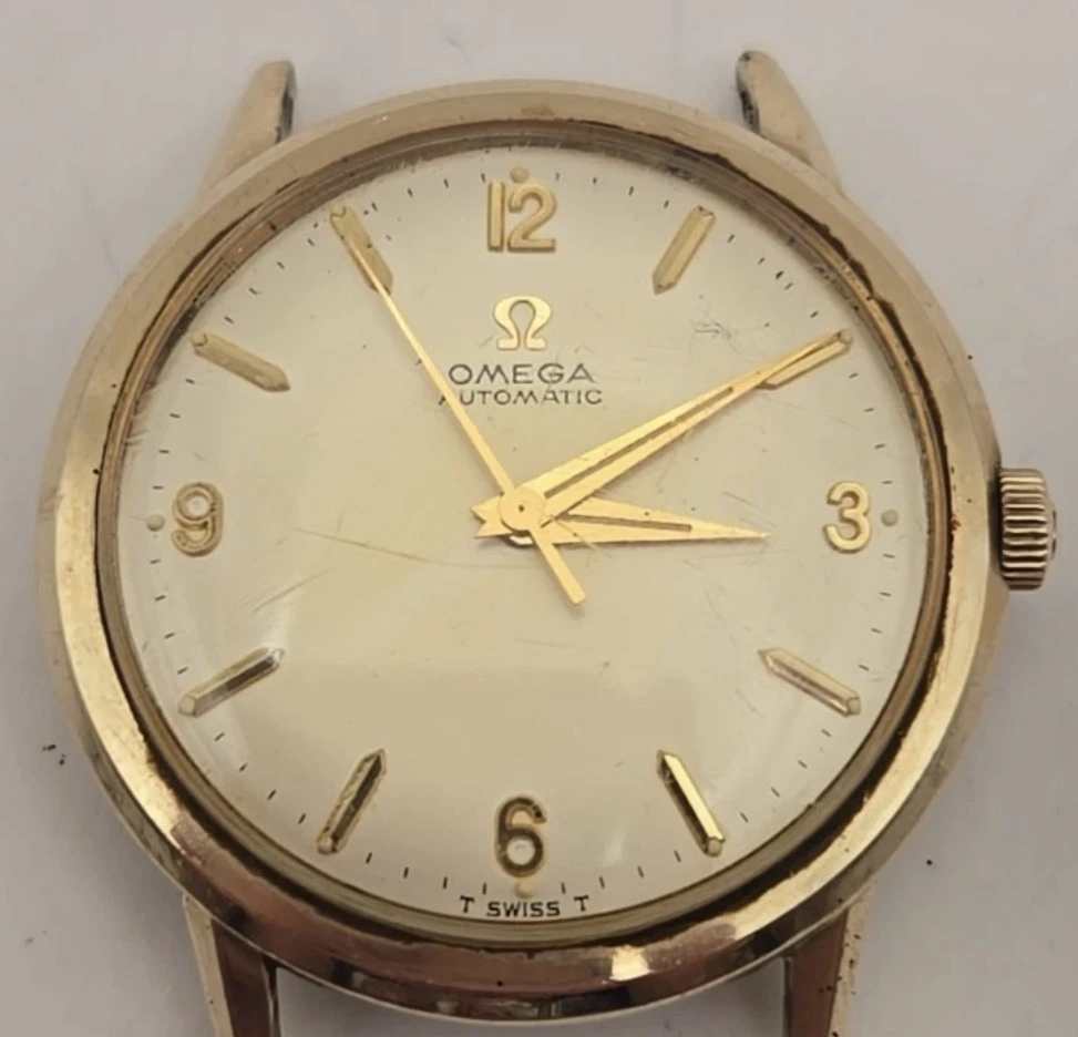

Earlier today I bought this Vintage Omega and I would like to know a few stuff.
First:
Is it authentic. From the little research I did (chat GPT) it seems like it but i know that is far from being the best source to get my info.
Second:
Dial. I would like to know if its possible that its dial has been painted/ restored previously and if the hands are the correct ones to the watch.
Third:
Service. If everything checks out what would be a good place to service it on the Bay Area, Ca.
Fourth:
Model/ Period correct buckle, also any recommendation on a good place to look for them would be appreciated.
Thats about it.

Looks ok. 60s. Try a forum search for some of your questions.

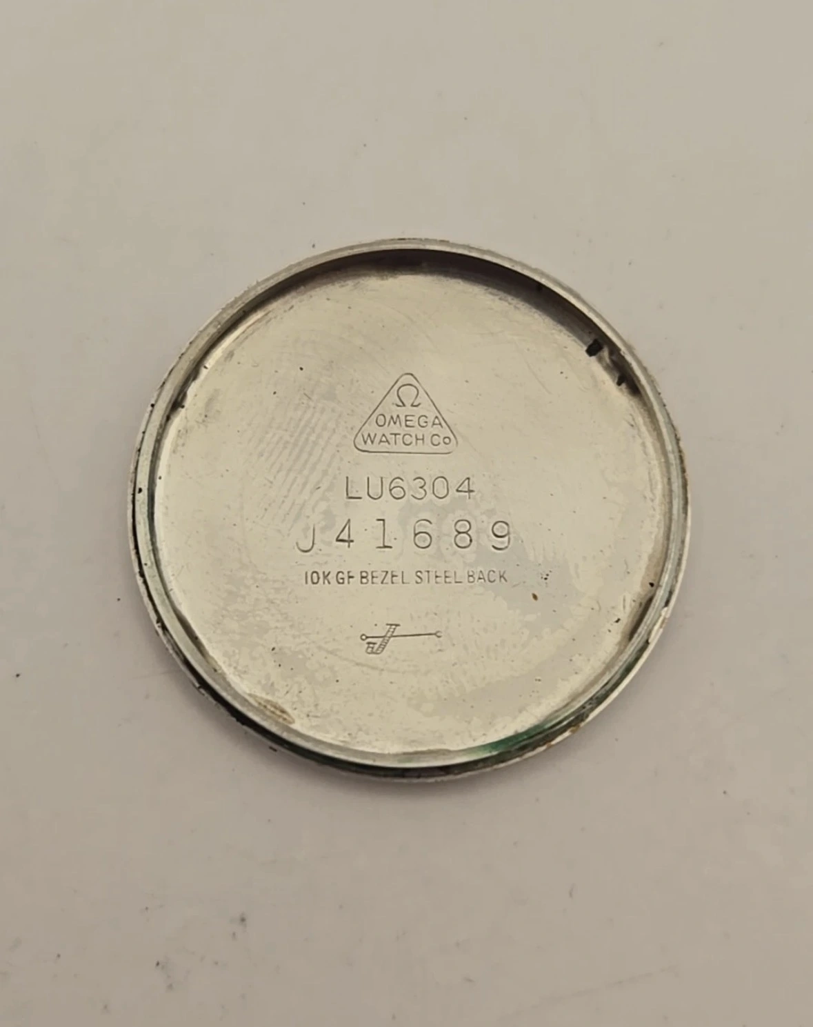

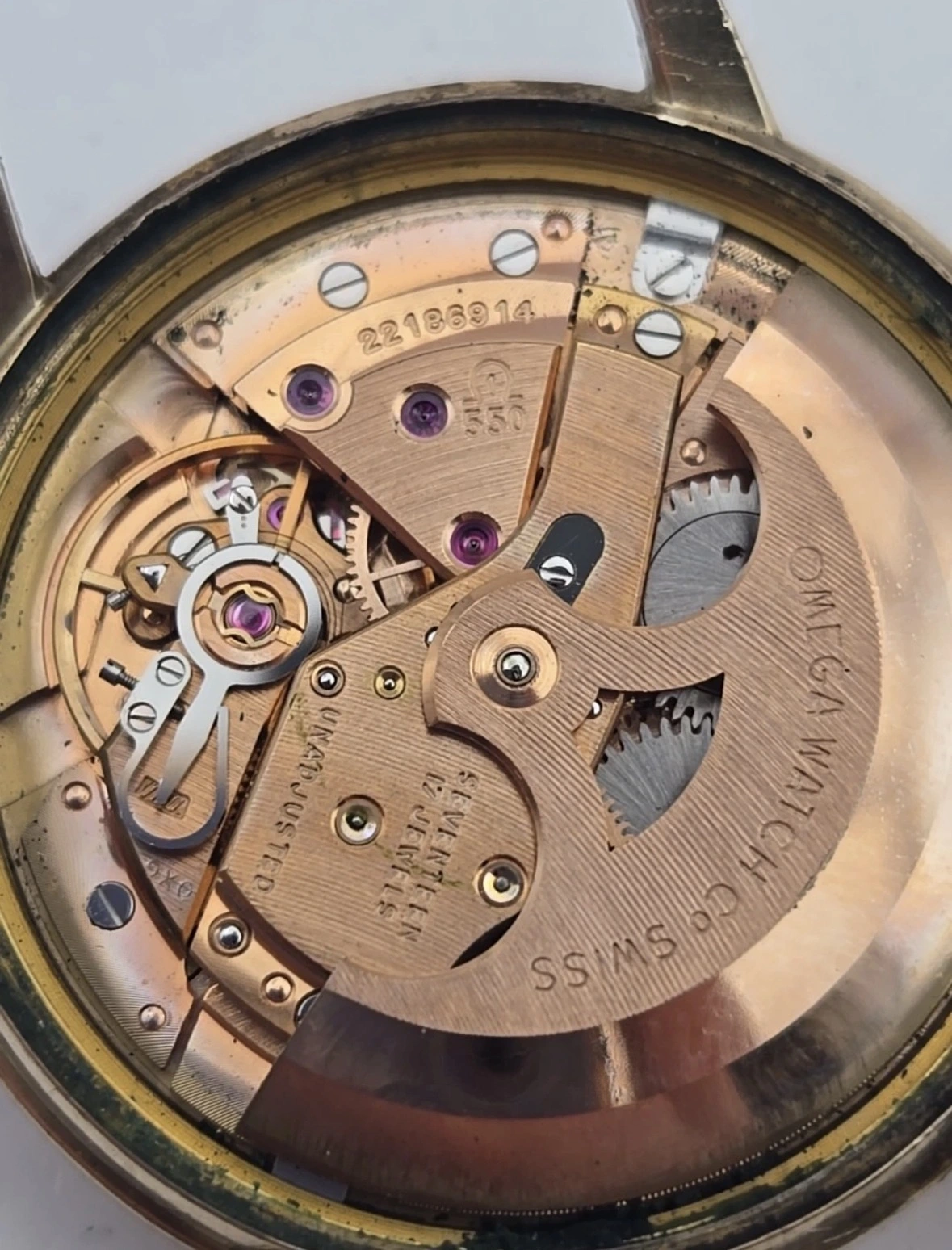

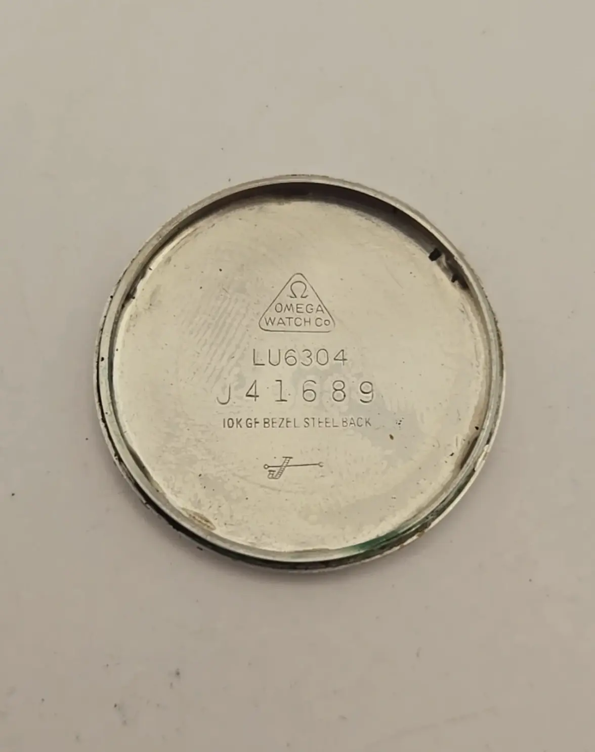

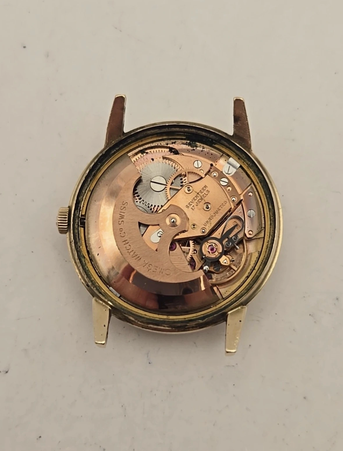

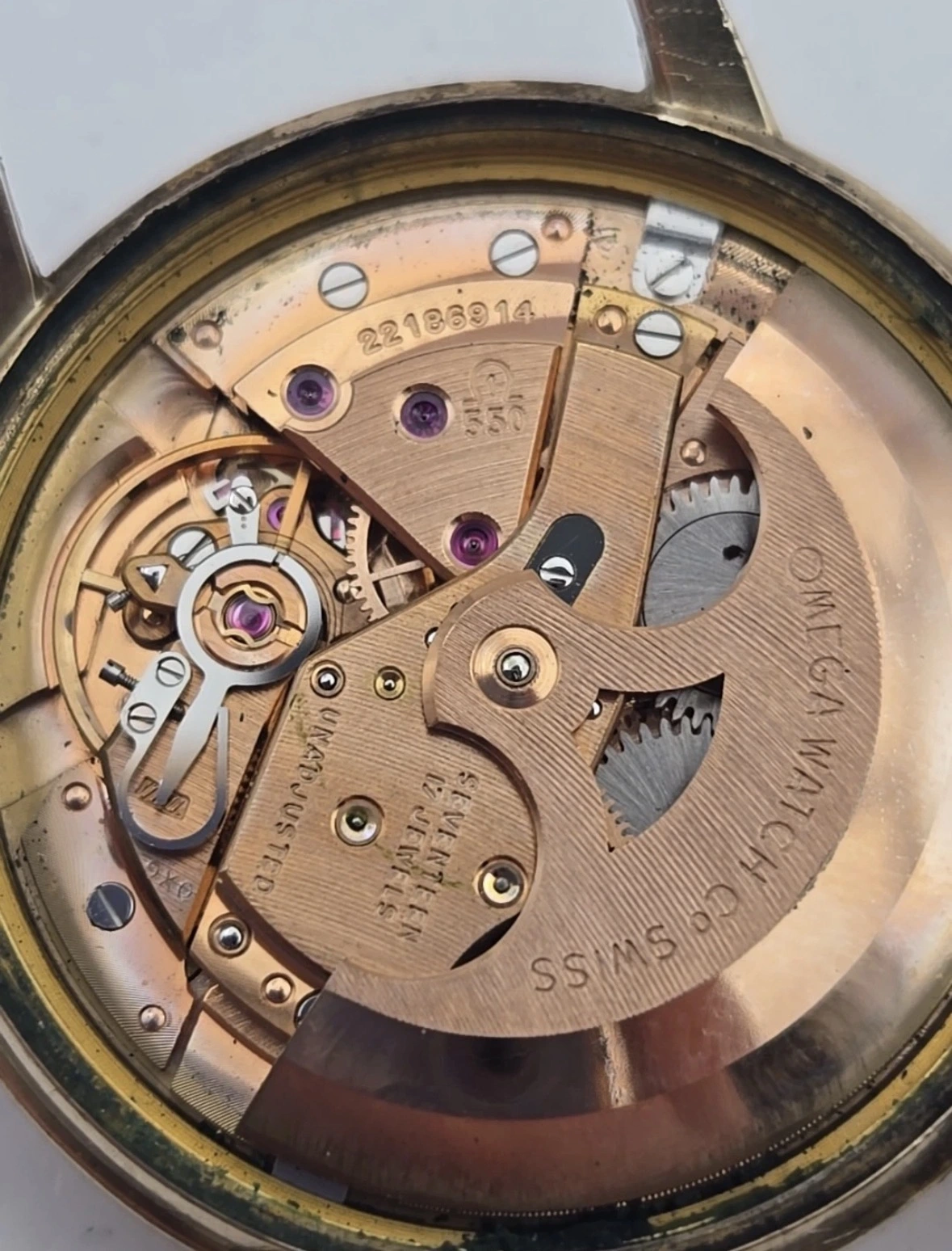

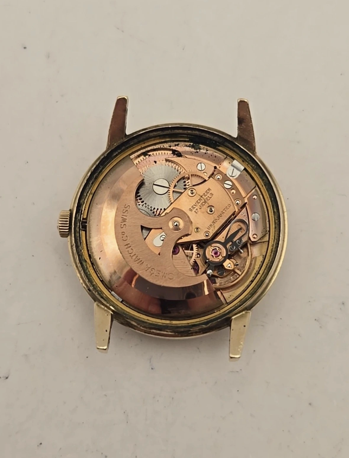

US-cased (low karat gold-filled) with US import code on movement. The movement photo doesn't show the serial number unfortunately, you would need to move the rotor. Looks like some corrosion in the movement due to water ingress, and some rotor rub on case-back and bridge. It's an entry-level vintage Omega that could require significant investment for movement repair/service. One oclock lug looks slightly bent.

Thanks for the info, I missed on that when I picked it up. This is my first watch purchase and definitely didn’t know what I was looking for when inspecting the watch. Would you consider it’s worth it to invest the money on it or should I save instead and invest it on a nicer piece?

1965-ish.
Personally, I would be hard-pressed to invest money in this watch, but others might feel differently. TBH, I wouldn't buy a watch in a 10k gold-filled case to begin with, but if you want to buy a watch like that, then just wear it until it stops working, don't invest more in it. My thinking is that you really don't want to go down a rabbit hole with potentially expensive repairs for a watch with limited upside.

Serial number dates to 1965. Trituim lume.

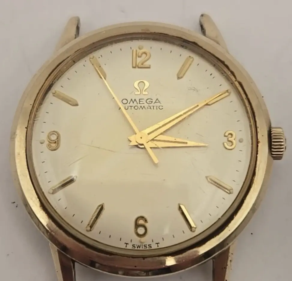

I can't tell if it's actually missing a bezel or not...

Bezel looks good to me.

I wish I had the time and patience to at least know enough to work on my own pieces. Will definitely look into Concord Ace in the future but today I decided to cancel the order. Even though I love how that watch looks it looks like I overpaid for the works that need to be done to it. Really appreciate the help you guys provided.

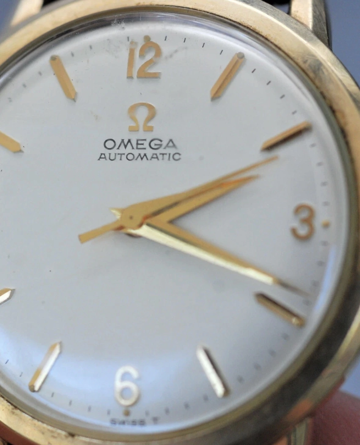

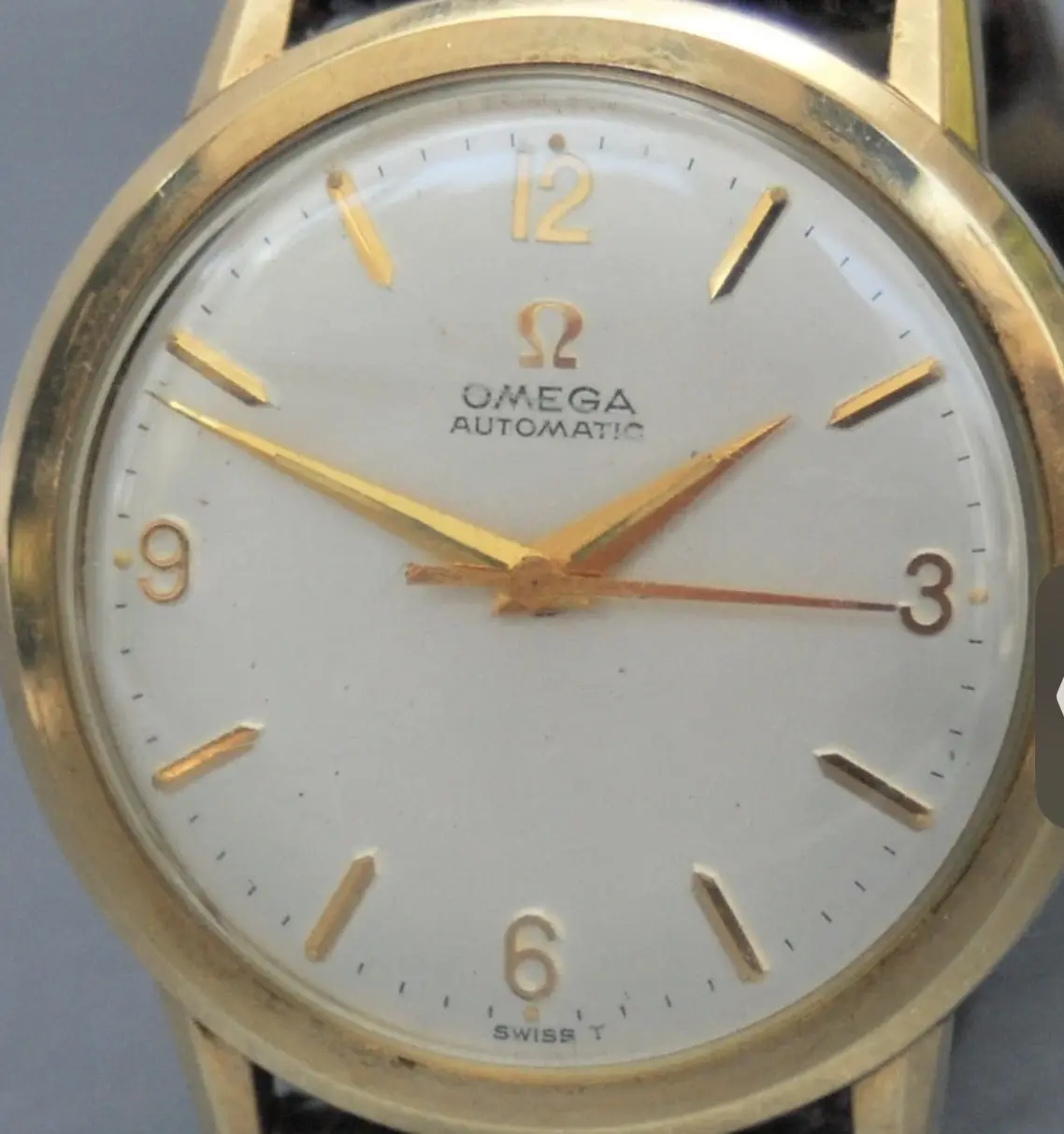

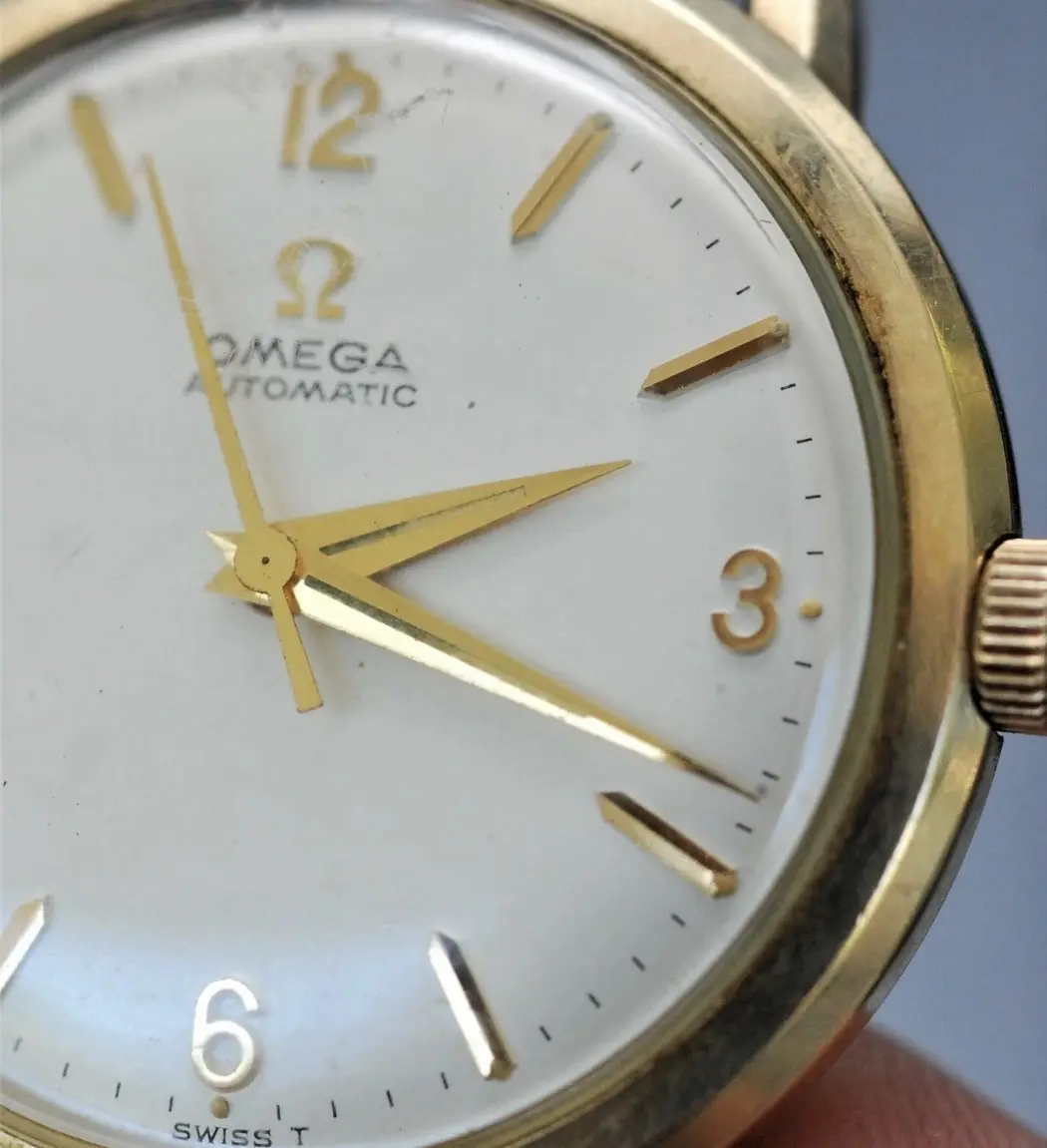

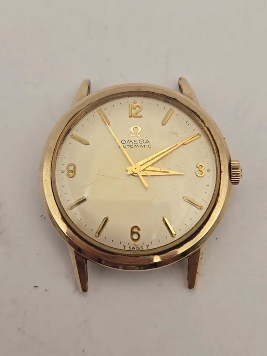

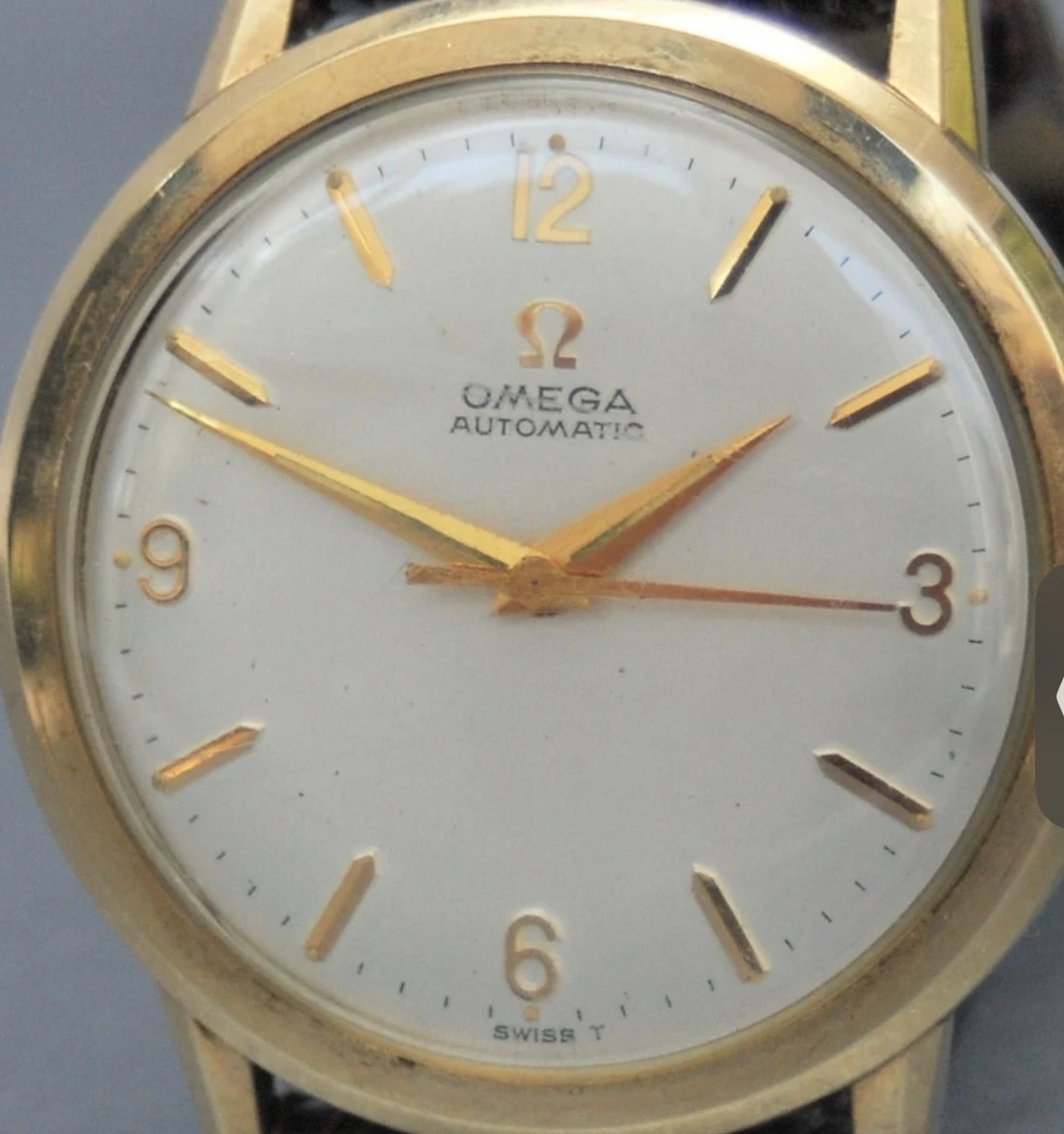

So I found a nicer looking example that I want to pull the trigger on but after inspecting and compering the dials for authenticity I found that this dial says “Swiss T” while the previous example had “T Swiss T”. Looked around on the internet and found other pieces that dont have anything on the bottom of the dial. Could it be a redial/ fake or are were there variations on the dial from factory?

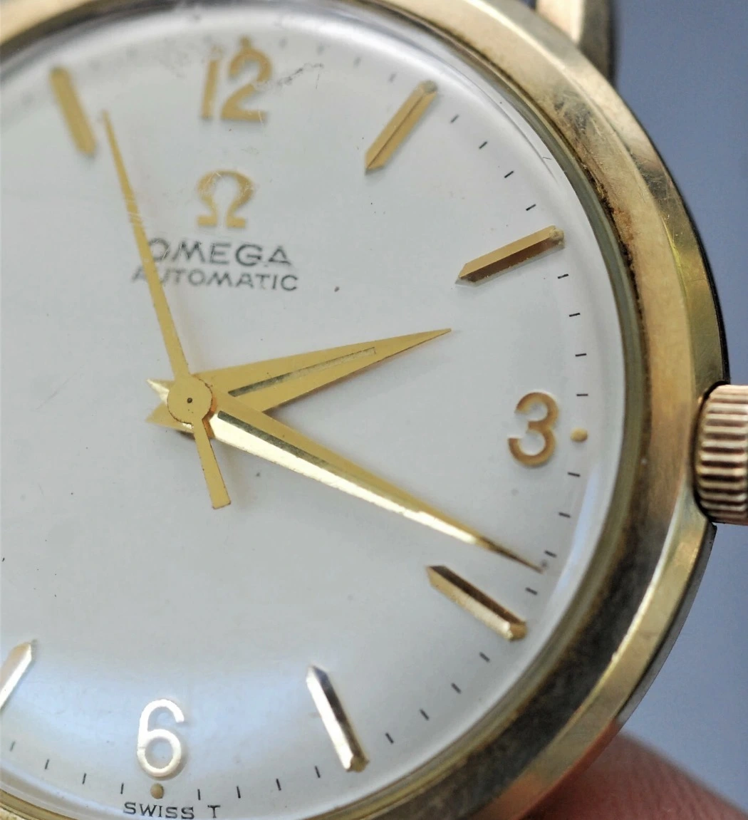

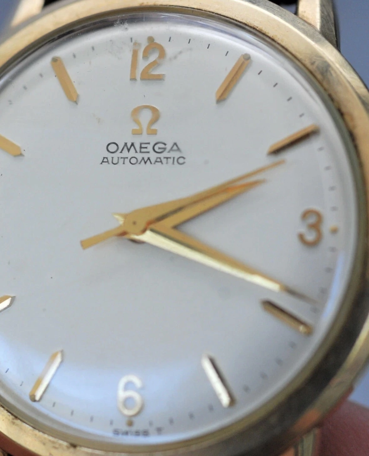

Not sure if I can see lume on the dial/hands which the T indicates. Easy to see on the second pic.

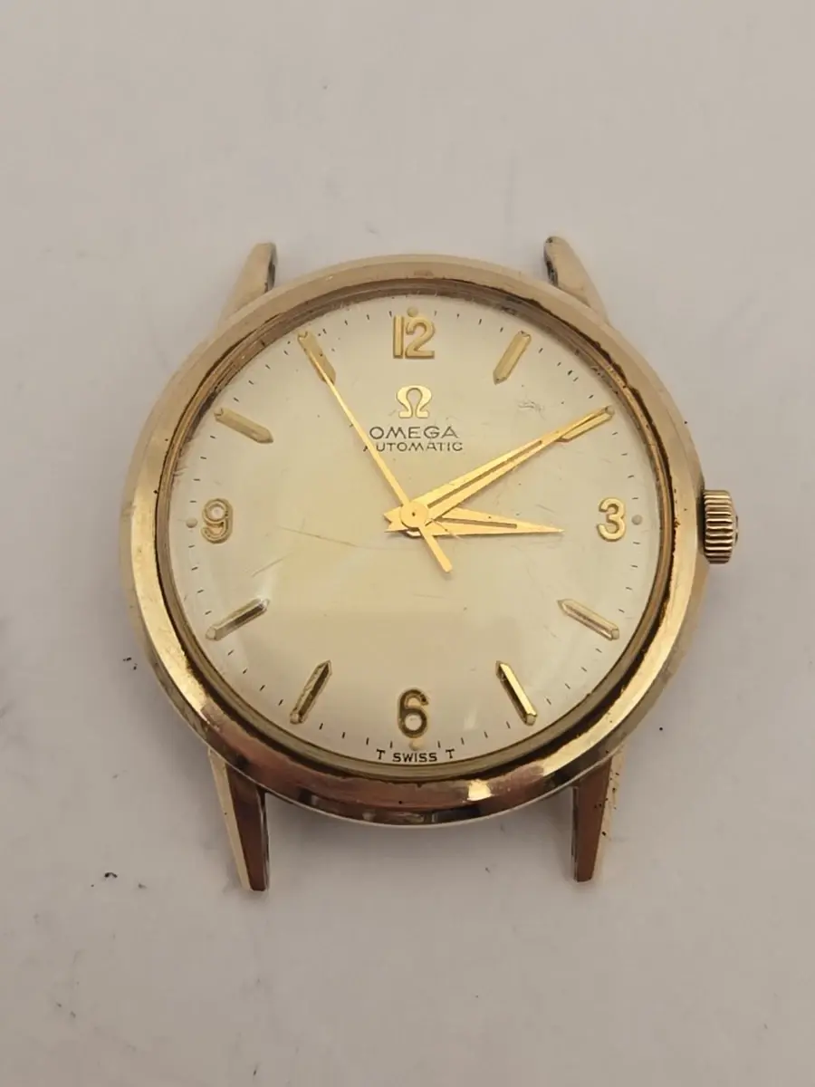

My bad, here are some better pictures. Tbh there reason why I decided to pass on the other one is mostly its corroded movement.
20
7
Ah yes, I see it now. And, for what it’s worth (not much), I completely understand your decision. It did look cool, however.
