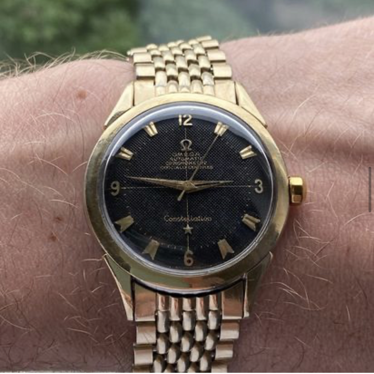

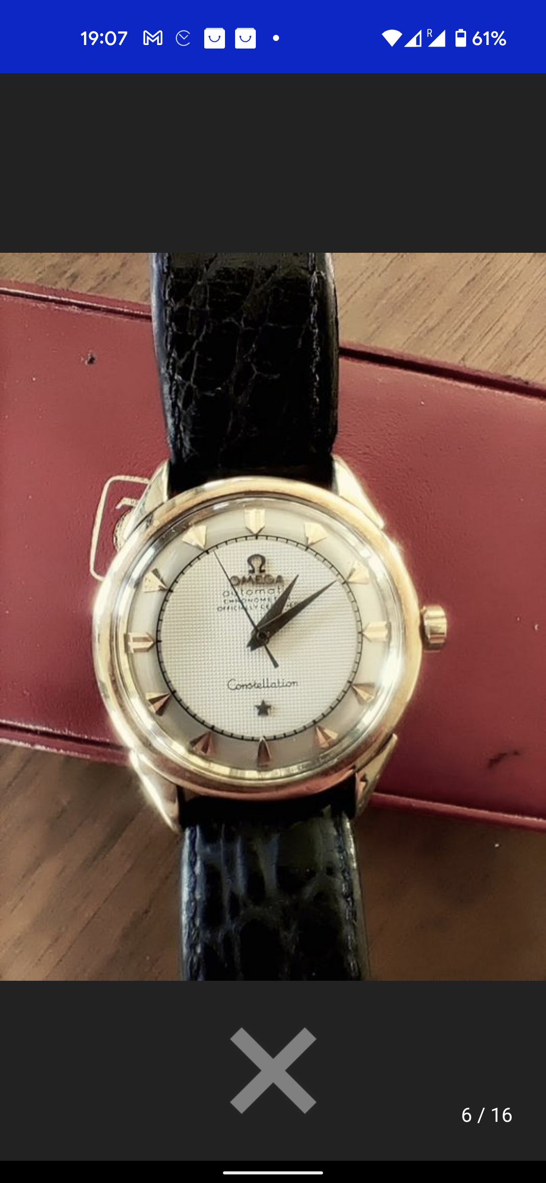

Hi Omega forum,
Could you help me with the watch below? Do you believe the dial is original? I haven't come across a like for like example.
Any other opinions about the watch? I'd say it's been quite polished.
How would you value it?
Many thanks!

Redialed - Wrong movement - Overpolished case - Wrong crown. Your decision 😉
9,588
27,706
Wrong hands too, if I am not mistaken 🤦

I like the "automatic" font..... Unique.

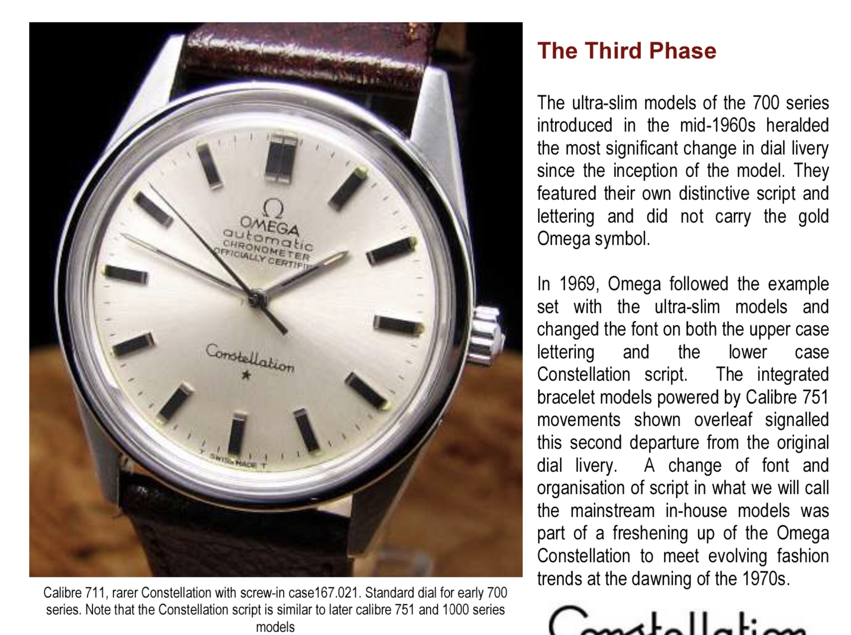

You do see that font (or very similar) on the ultra thin Connie from circa 1970. Can’t recall the ref.

If you think this watch is nice do more research before you buy a Constellation or you will likely get burned

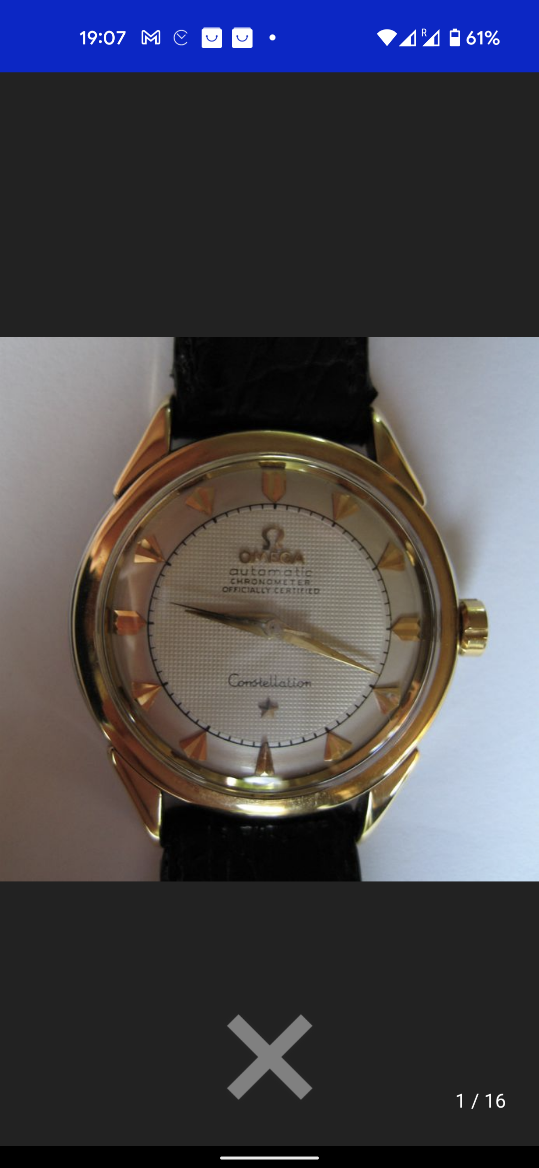

167.021
the lower case font was used remarkably early, from the mid-sixties, on the ultra thin Omegas ( both chronometer and non- chronometer rated) -this one from ‘66.
whilst ‘playful’, thankfully, it remained rare 😉
Should have said : I like the " automatic " font here with the OP reference......

The OP watch sold yesterday on an auction site for €800 🤦 with glaringly careful omissions in the description.
Looks as though its buyer is wasting no time getting rid. And no wonder 🤮
Oh I wasn’t criticising, just thought it worthy of note that they picked a legit font from a fairly obscure reference and applied it to the wrong watch.

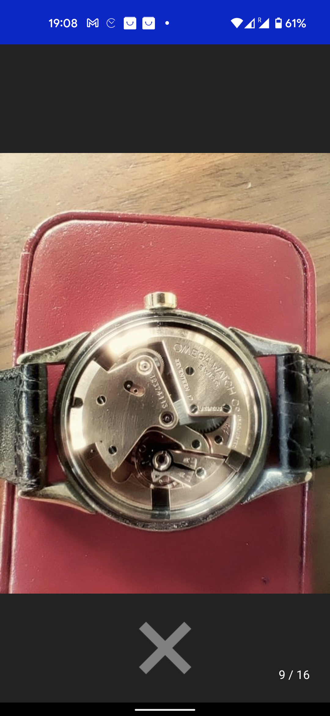

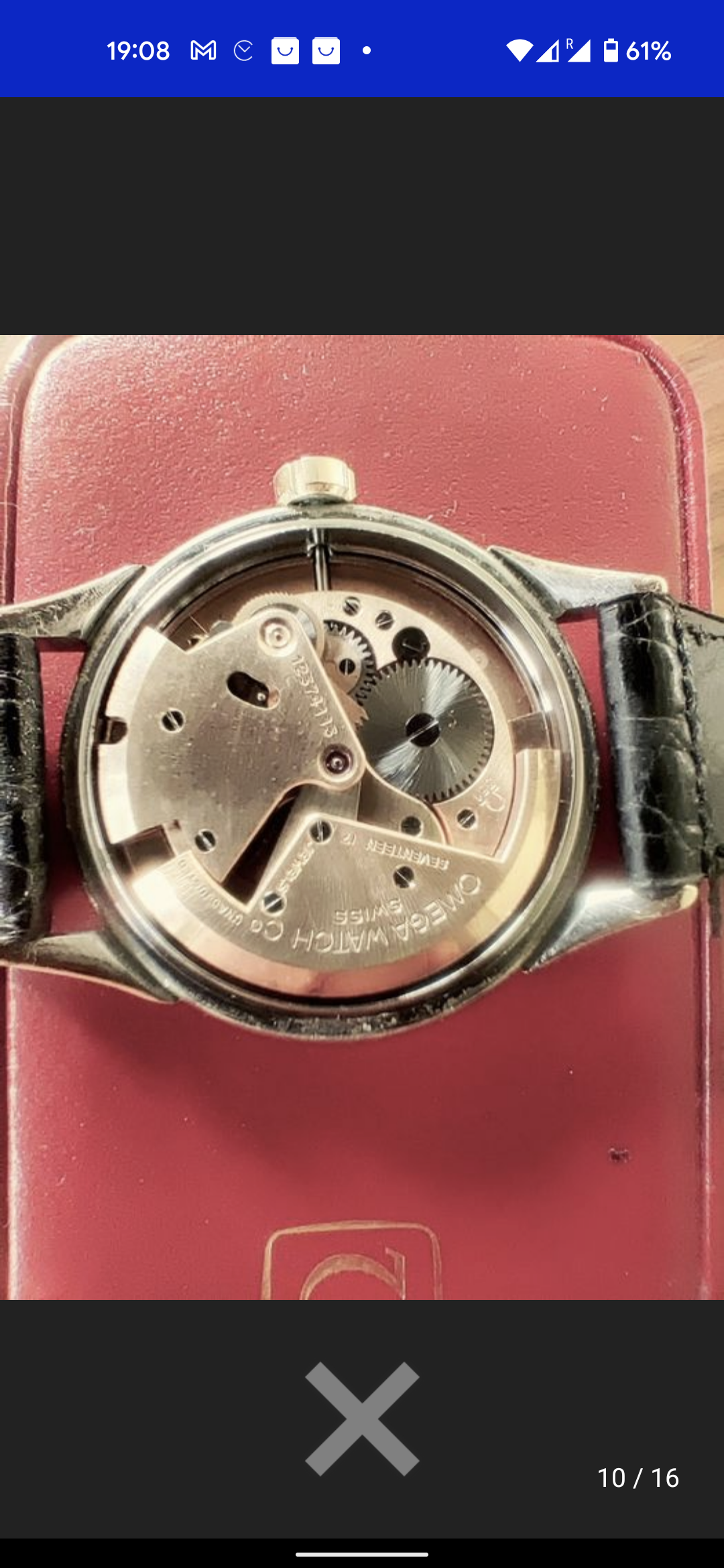

Thanks everyone for the responses. I didn't bid- the watch already felt like it was off, but I was not able to specify what it was.

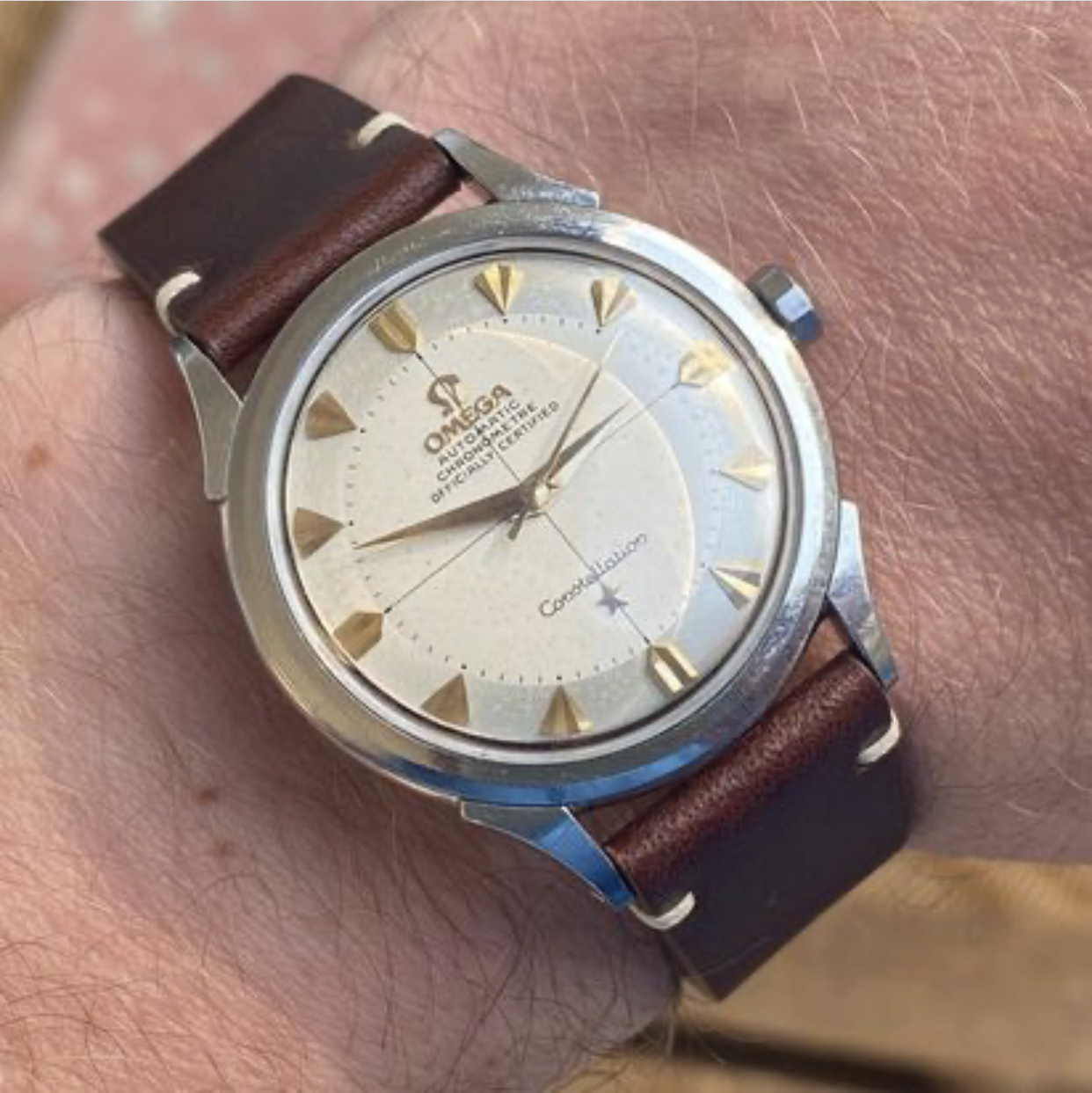

About the movement- do Constellations exist with a bumper movement?
3,595
13,551
Very much so! The earlier refs all had them.
Mine say hi:
