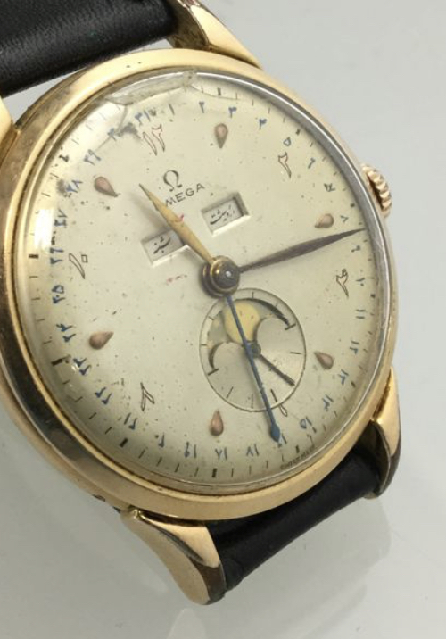

This is a redial, yes? I can’t find any more with Arabic writing (although the day/date are Arabic also, so that’s interesting), and I believe there should be an applied logo on the dial? Thanks in advance.

This looks like a cal 381 that was made for the Iranian market - in Farsi. The Cosmic is seen with both applied and printed logos. The pic is not conclusive but it looks like the dial is original. The Cosmic is a fairly rare watch and the Farsi variant is rarer still. Pls post a clearer pic of the dial.

A better more focused picture would help but from what I can see the dial looks original. Extra points for the jumbo case.
Hi Southtexas
I think the dial is original. Is that piece for sale? Feel free to contact me if yes.
