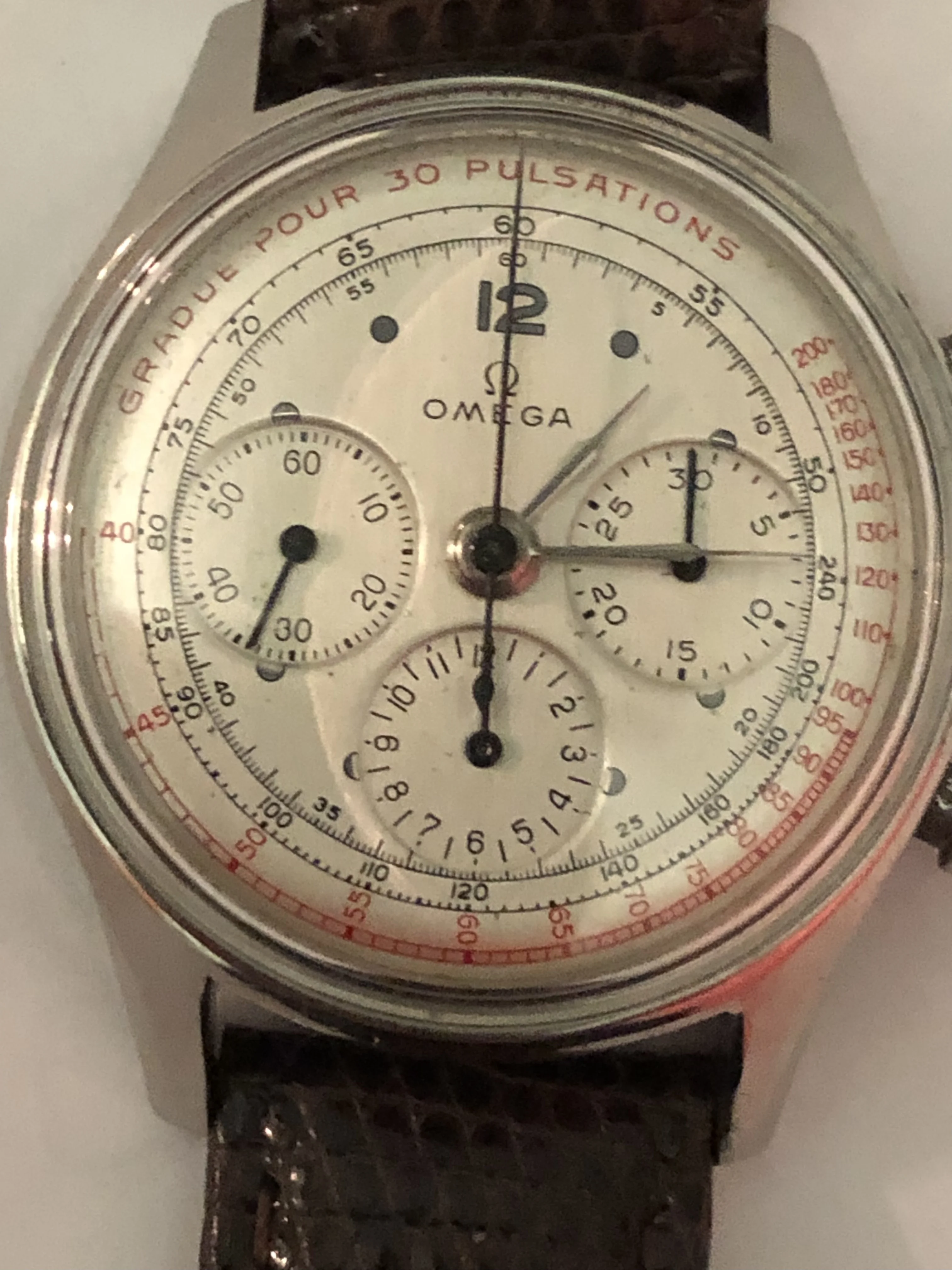

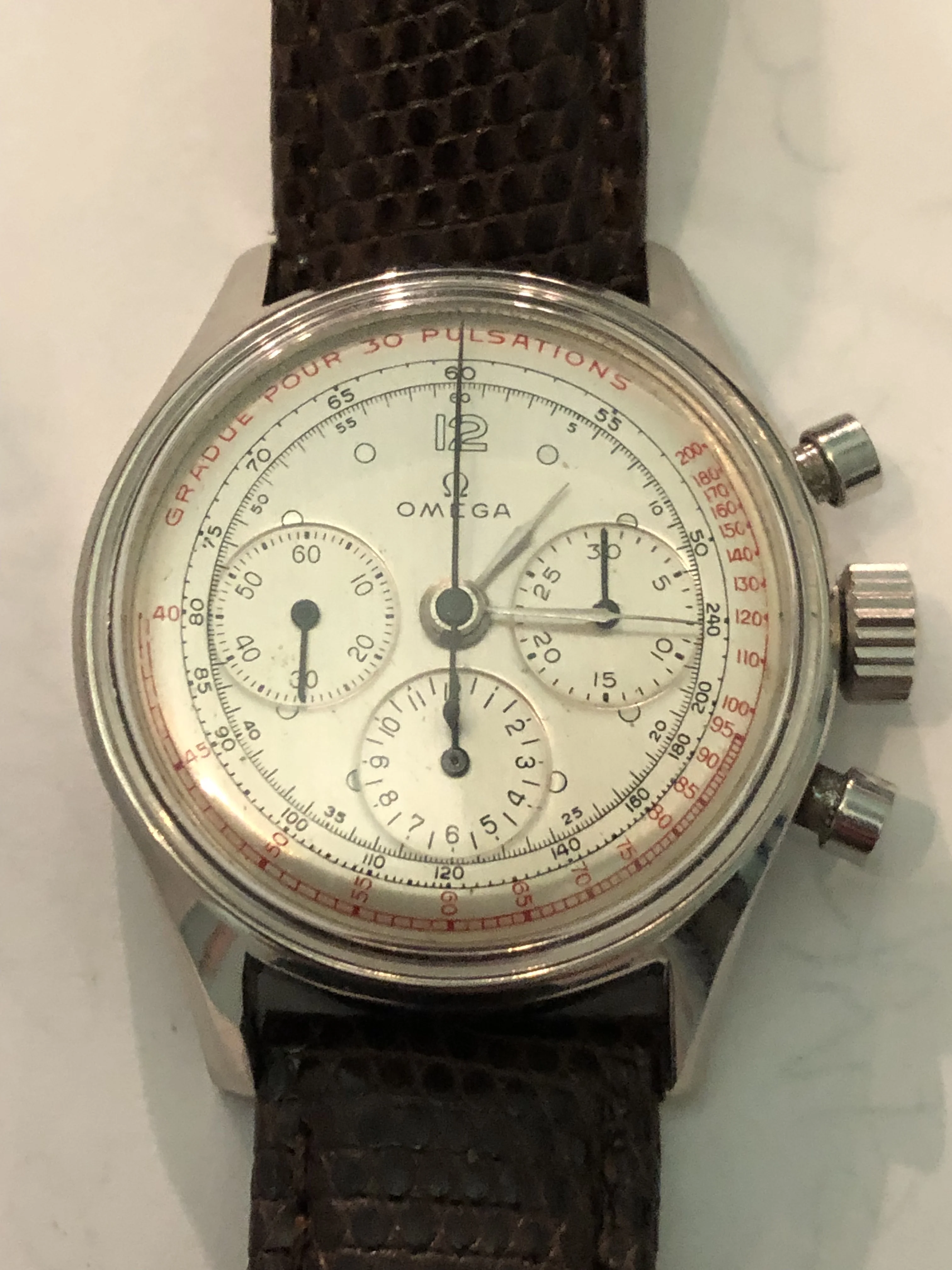

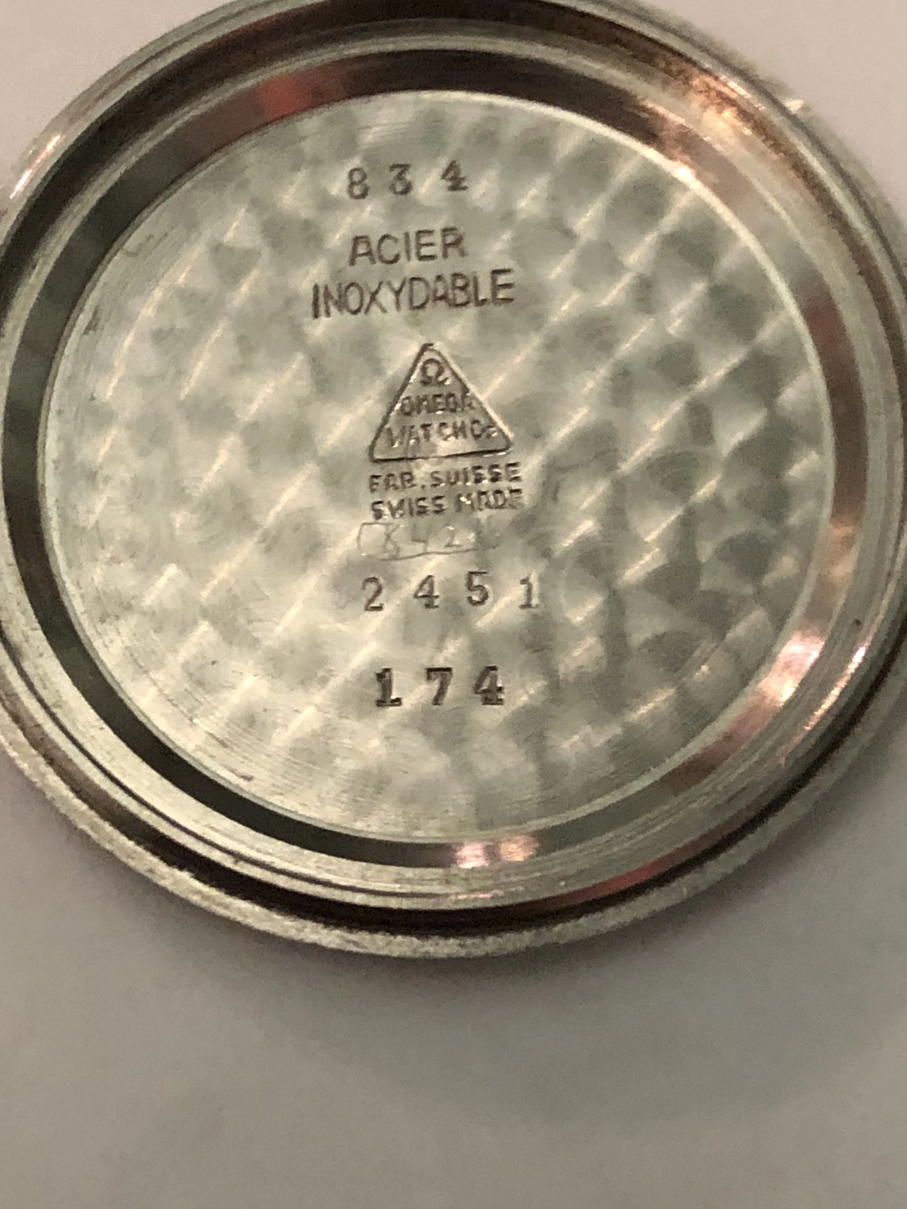

Hello members I decided to post this watch in detail , I’m inspecting my collection and already found some discrepancies in few of my pieces as knowledgeable eyes of the members pointed out to me correctly recognizing some issues and I’m grateful for the input thank you, here is one of my omegas that I took out after many years , it has the 27 CHRO C12 T2 PC movement inside , my question is the dial, is it redone ? thank you for your help, kazd

This is a repainted dial - and a fairly decent one I must say - yet, even with the out of focus header pic the Omega logo and the font and distancing of markers in the subdials (especially the 9 o'clock one) stand out as repro artifacts. The crown is much later replacement, but that is no big deal.

good morning and thank you for your honest diligent assessment , I was curious that’s why I asked for opinion , especially that after all it is about 80 years old watch , so the dial must of being done many years ago I assume now , still has a great appeal to my eye. , and the movement runs like Rolex 😊 and the rest of the watch looks like was very well cared for imho , thank you again and good day , kazd ah I love the way you guys know what to look for, it definitely takes a experience and train eye to spot these little details that matter, 🤗
