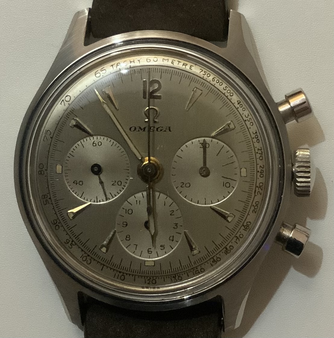

Hello,
I am posting the first time here, even I am following the forum since 2 years. Thank you folks for all the information, I am appreciating this forum very much.
I am a guy from Germany, mid of the 50th, living close to Frankfurt and collecting watches since some years, mainly vintage Omega watches of the 50s (this is my first one), 60s, 70s.
Recently I got a chance to buy a Omega 2451 with cal. 321 (13 mil.). I like it very much.
The only thing I was doubting about already at the time I bought the watch is the dial.
As far as I can see the dial is original and I know that the hands and the dial had been relumed. Is seemed to be not repainted overall, you can still see the circles in the subdials very well. For me it looks like that some numbers and letters had been corrected.
I am not quite sure what to do now. I love the watch and it is wearing pretty nice even as it is:
- leave it
- looking for a dial in a better condition in the web (seems to be difficult)
- restore the dial; do you have an advice, who could do it
What is your opinion, what do you think?

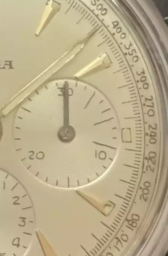

Dial appears to be completely repainted to me. Wrong logo font, sloppy numerals, etc. Just blow up the photo and start looking at the printing in the sub-dials and outer track. Pretty bad.
It won't be easy to find a new dial, but that would give you the best outcome.

Looks like someone painted it with a sharpie. Or one of those kids tee shirt pens that leave a worm of paint behind.
This is why I was never happy with redials.
Still there is some history to this mess. I'd probably keep it.
Good luck finding a new dial.

I agree, these were my first thoughts as well. Someone took a black pen and corrected the numbers, figures and dashes. If I could find someone to bring it in the condition it was before ‚restoration‘, I would do it. If you are not zooming, the watch is still looking very nice. Thanks

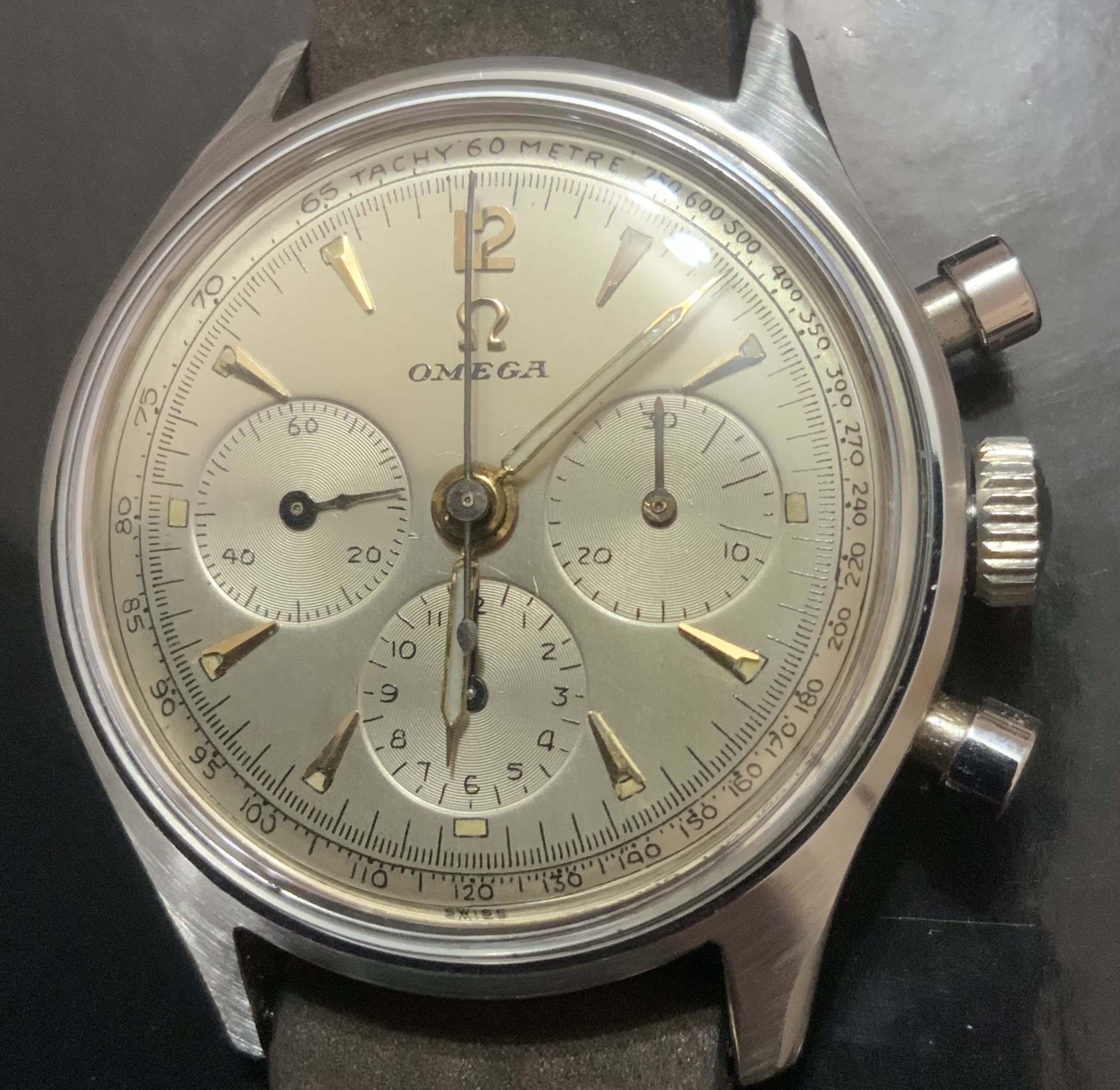

I agree with your findings. I always thought, if it is a complete repaint, you won‘t see the circles in the subdials anymore, which you can still see here. I was thinking, that some corrected the dial with a (ball)pen in a bad way. The logo font is from earlier ages I am thinking. Appreciated your feedback.

If the circles in the sub-dials are missing, then you can be sure that it's a repaint, but the inverse isn't always true. Some repainted dials successfully preserve those circles.

I discussed the photos with one of the best known dial restauration specialists here in Germany to get his advice. He told me, that based on the photos the dial could be original (except of the lume) and the effects could come from moisture or sun exposure. He had similar cases like this before. The only way to get more sure is to bring the dial physically to him so he can take a look through the magnifying glass/ microscope. If I will find the time I will visit him. Keep you updated, if I get new information.

I am sorry, but simply no, that is wrong. That redial is a total mess and can never be original.
Apart from that also several hands are wrong. You can compare your watch to the watches in this thread:

I'm not sure who this so called expert is but he is seriously yanking your chain if he is insinuating that this dial could have left the factory like this and has been affected by environmental factors 😕. I would run a mile from him in future.
The print, font and lines are hot mess and clearly a redial.

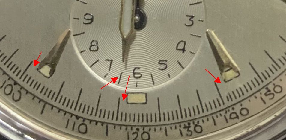

As indicated in the posts above, there is no doubt about this being a redial.
There are too many indicators but just look at the print underneath the 10 o'clock marker. It is completely off.
And indeed the case has also been been refinished (quite harshly in my opinion).

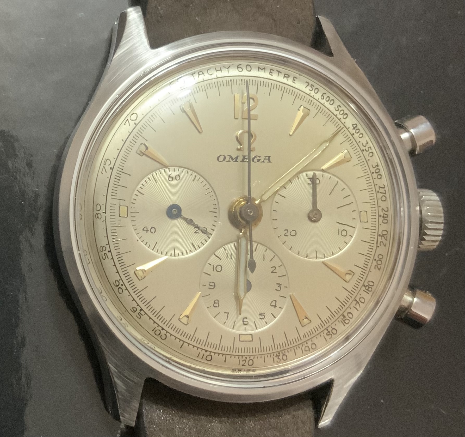

As others have said this is a redial. And a pretty brazen one at that. I wonder how anyone could do a redial like this and look at it and say, "Yes, this'll work." It looks like the dial's been written on.

This expert is apparently trying to extract some money from you. Anyone with experience would immediately recognize it as an amateurish re-dial. I would suggest that you spend some time, at least a few months, developing some first-hand experience with Omega dials. Then you will not be so reliant on the opinions of others, and so easily taken advantage of.
