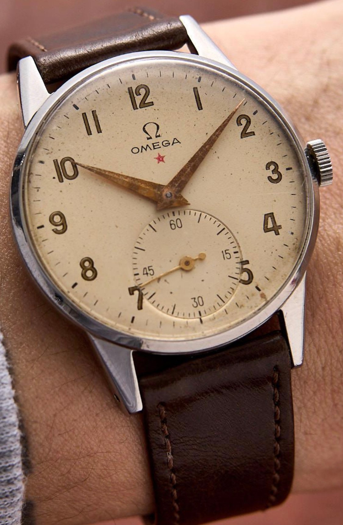

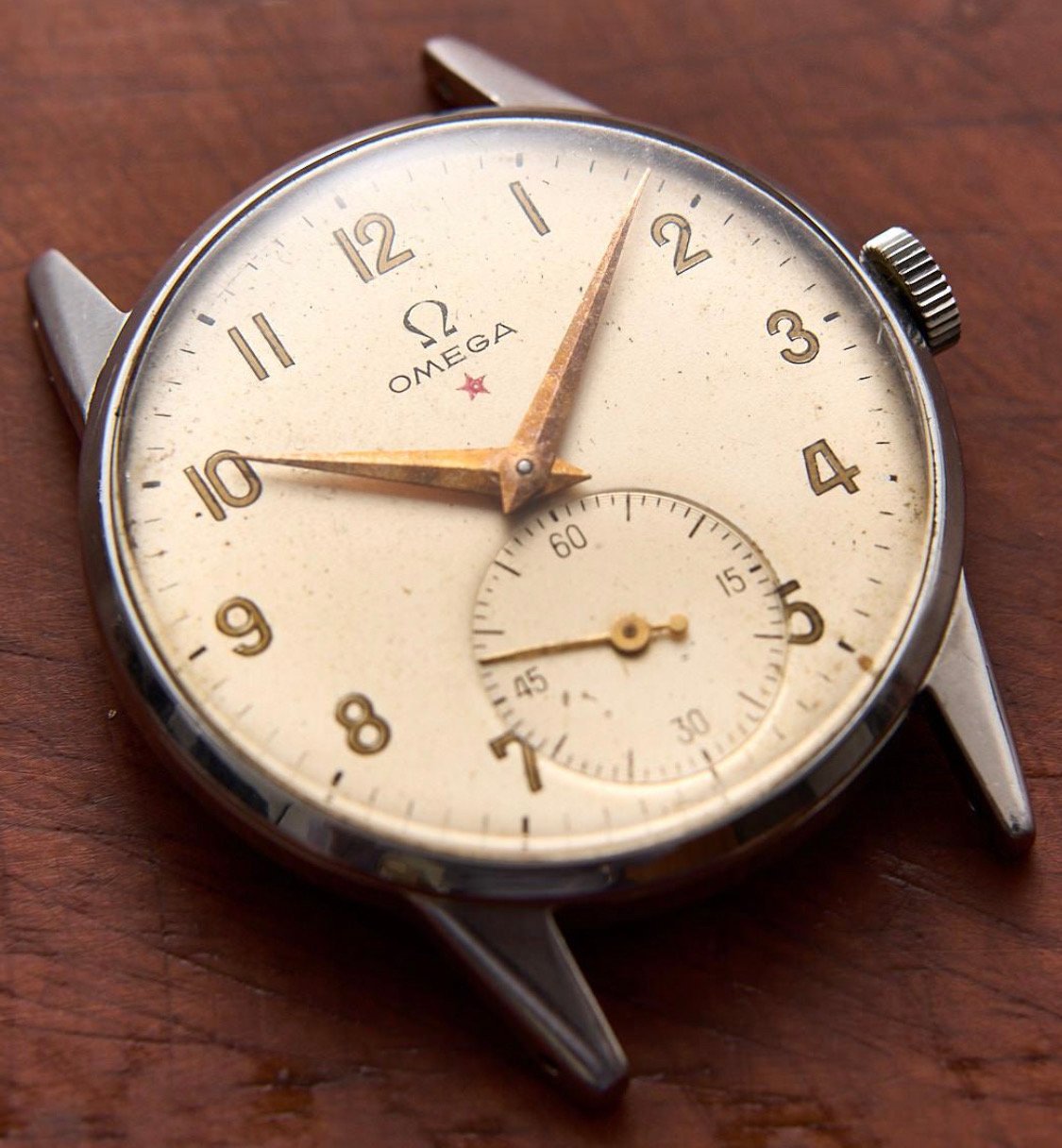

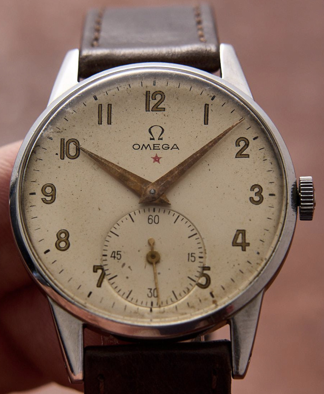

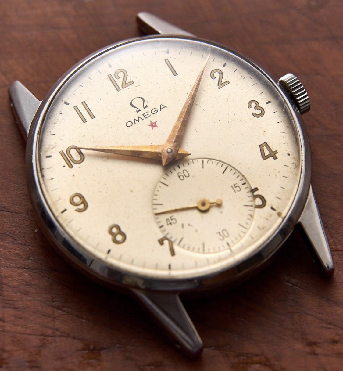

I stumbled into this Omega 2271-1 Red Star vintage watch which interests me, however some details make me wonder if this watch is not an original one, or if it was modified. I have no prior experience with vintage watches, so I can't tell for sure if my remarks are legit, or if it is the way vintage watch are.
This is also me learning, so here we go. Given the pictures:
- The 30-second index is not well aligned with the 6-hour index
- The logo/OMEGA/Red-Star combo are not aligned in the center (consider a line between the 12-hour mark and the center)
- How does the hour and minute hands look so aged, but the dial still looks good?
- I cannot find the same watch elsewhere on the internet (at least one with numerals on the seconds indices)
The seller is from Brazil, maybe it's a watch that was restricted in that area (sorry if this is dumb, please consider me a noob).
I would love to have your opinion, and if this can be a first vintage Omega purchase, or a "run away"?

A reference 2271 is listed as a Teddington model on this advertisement from Brazil:
The red star on the dial identifies your watch as a Teddington model containing the same movement as the wristwatch that, in 1940, obtained "the best precision results" at the annual chronometer trials held at the Teddington Observatory.
Thanks for your help. I didn't know the story behind the watch, so it looks like there is a ton of Teddingtons out there, most of them repainted.
I'll pass on this one.

The soft edge of the sub-dial, especially on the left side, makes me think that the dial has been repainted, probably a long time ago.
In other words: The red Star is a marketing gimmick by Omega to spice up sales by referring to a normal, mass produced movement, that can be exceptional. Mostly delivered to South America.
