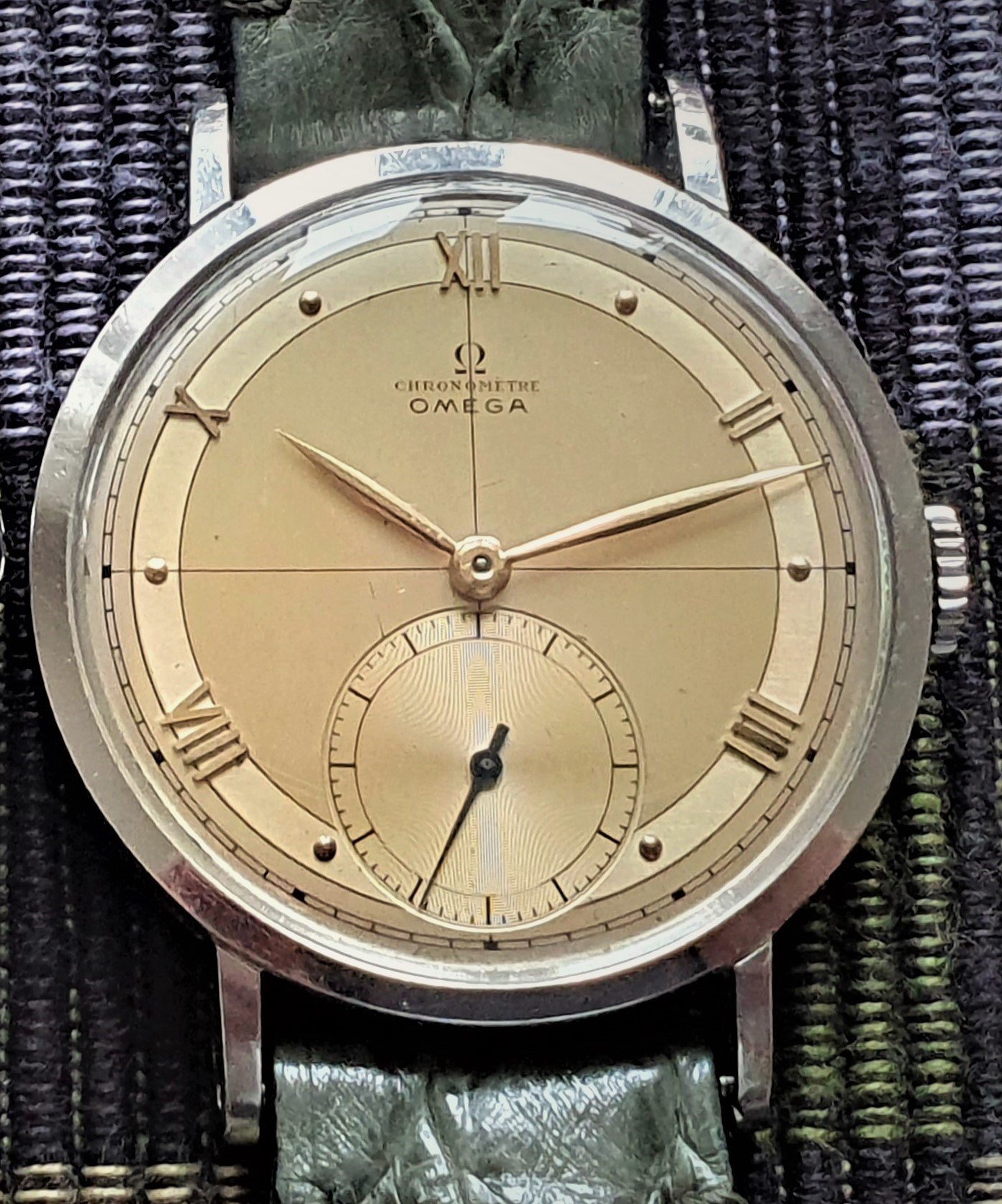

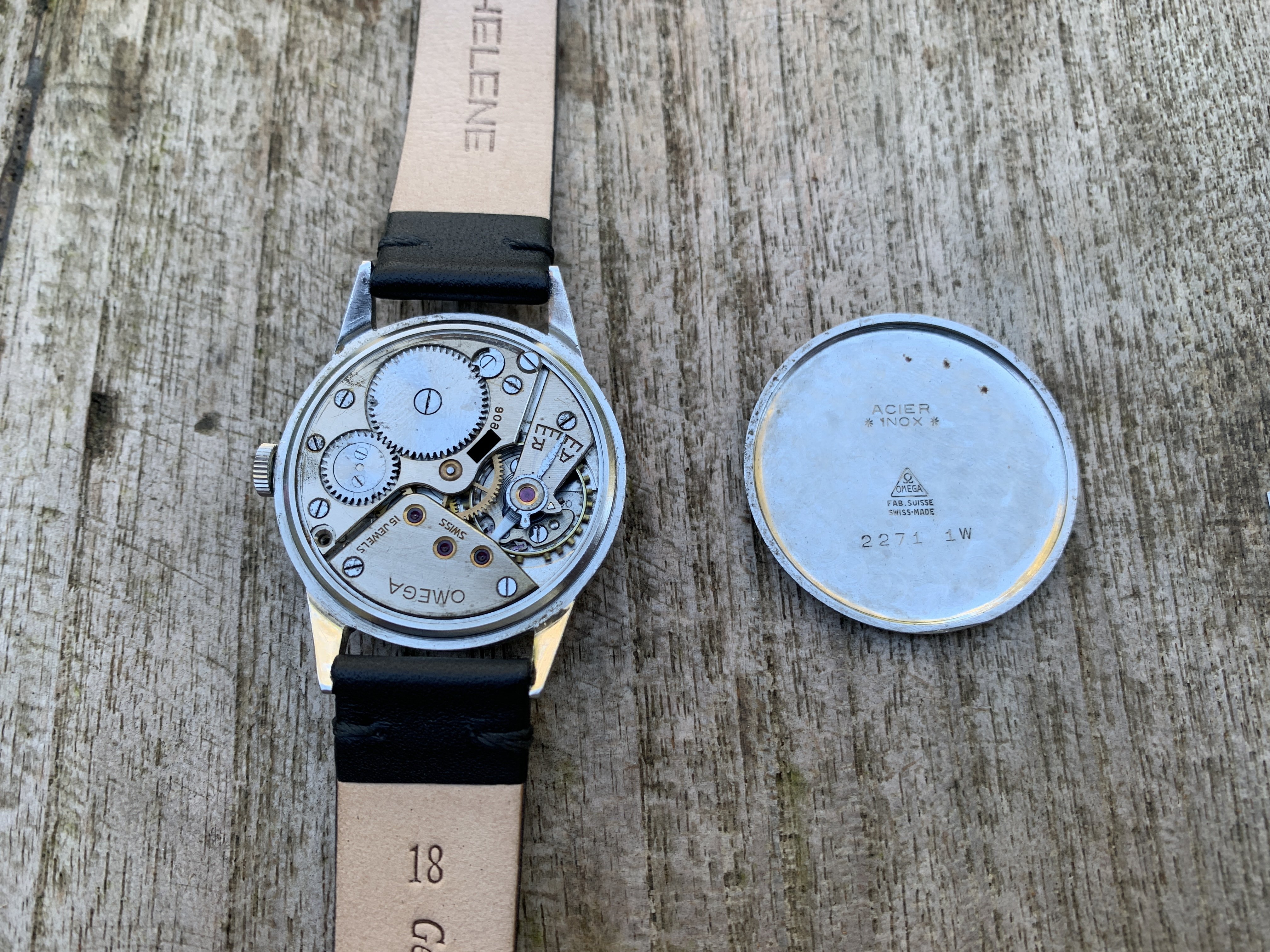

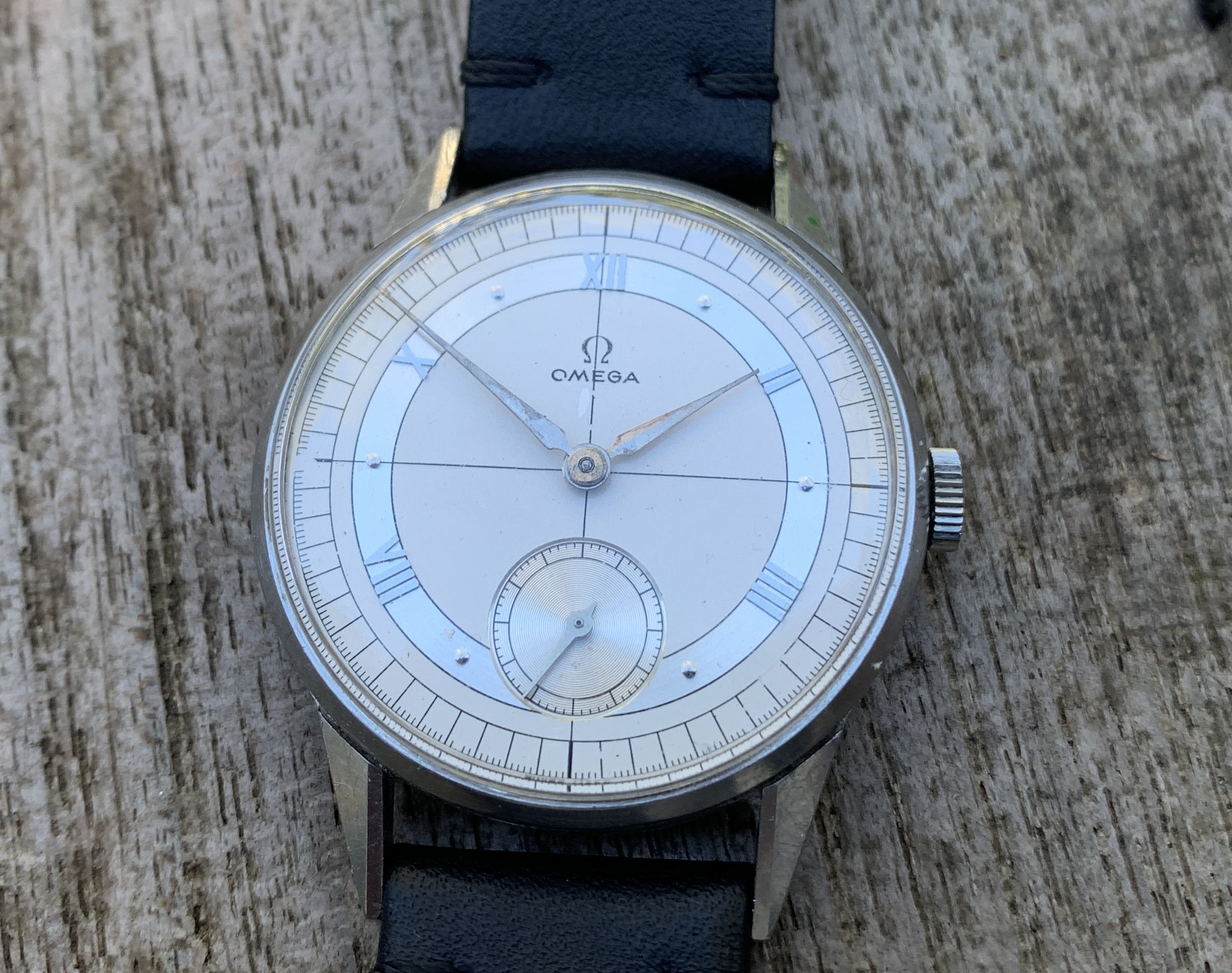

Hi,

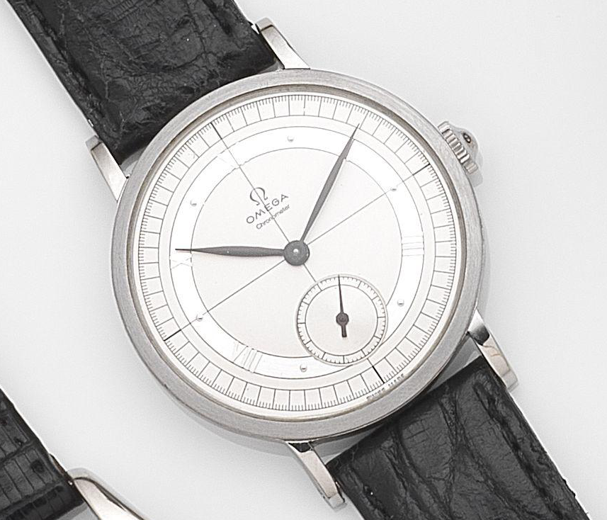

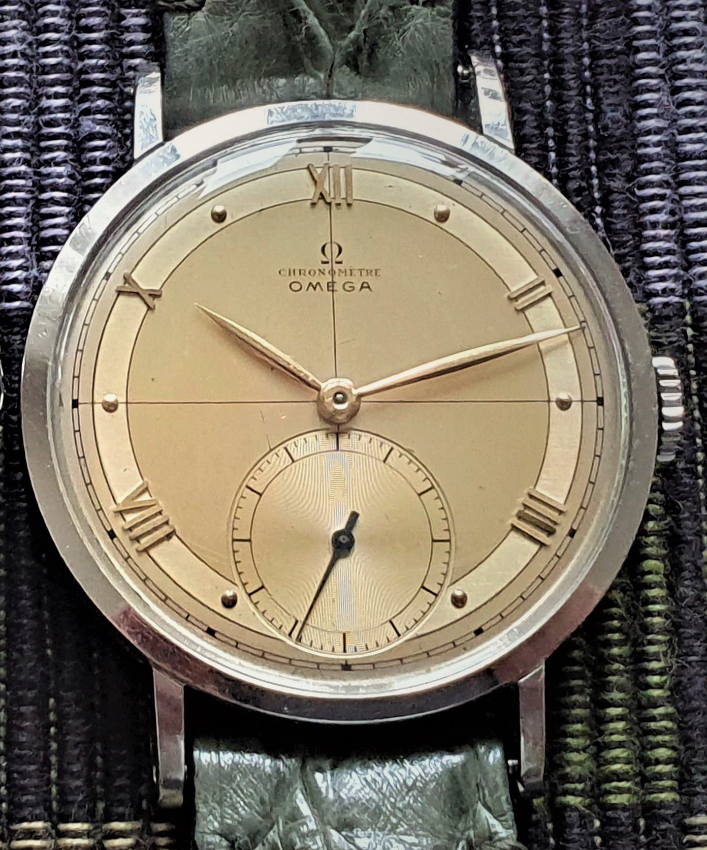

This watch recently arrived and I'm a bit lost. Per the caseback it is a 2271 1W with a Cal 30 movement with a serial 9088xxx dating it to 1939/40 or thereabouts. Although the case looks like most of the other 2271s out there, my dial has a small sub-seconds: most of the ones I can see on the internet seem to have a much larger subdial. My other question is about the hands: the subdial hand is obviously wrong, but I'm not sure about the minute and hour hands. The bottom photo, from a Bonhams sale of a later 30T2rg chronometer, shows a longer hour hand and a shorter minutes hand in black: which is right?
Any help very gratefully recieved.
Tim
Courtesy of Bonhams

Your dial is a later replacement and also Bonham´s is.
Hands on your watch seem wrong also.
Haven´t you got my book or do I recall wrongly? There is a chapter about dials and these kinda dials are described in detail.

Many thanks for replying. I should have your book, but don't....

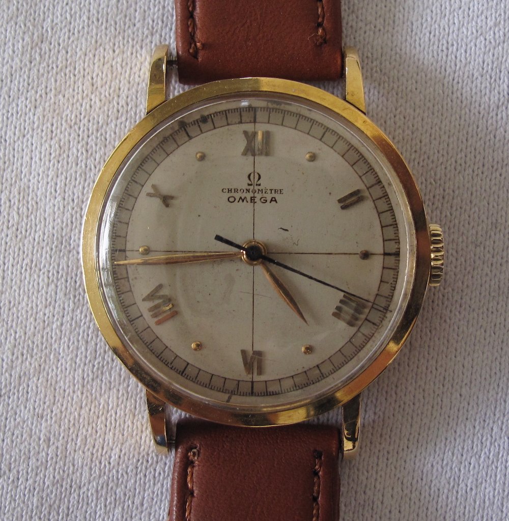

I've only managed to find two other non-chronometre dials with a similar two-tone pattern and applied roman numerals: one (here) which is a bit later, and one in AJTT (p138) on a 2317 -- which weirdly has luminous hands on a non-luminous dial. Is it possible to tell what reference would the dial have been on originally?

2366, cal 30T2Rg
Nice.
I can understand going to the trouble of producing a dial with individual applied numerals for an expensive chronometer, but my dial is presumably for a non-chronometer rated movement.

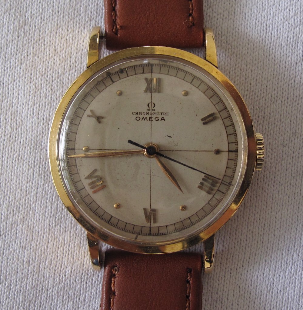

Here's my 30T2rg

Here's my 30T2rg
I only showed a similar dial
Apologies - my response read like a criticism of you, it wasn’t meant to be: “I can understand why Omega would go to the trouble of ….”

@timjohn
Your watch did not leave the factory with this dial - nor did Omega make or order these dials.
these dials are of unknown/uncertain origin and were sold on watch exchanges/markets as well as on ebay some time ago.
Most probably they were ordered by somebody to be made by a professional dial manufacturer in a small batch - more is not known...
