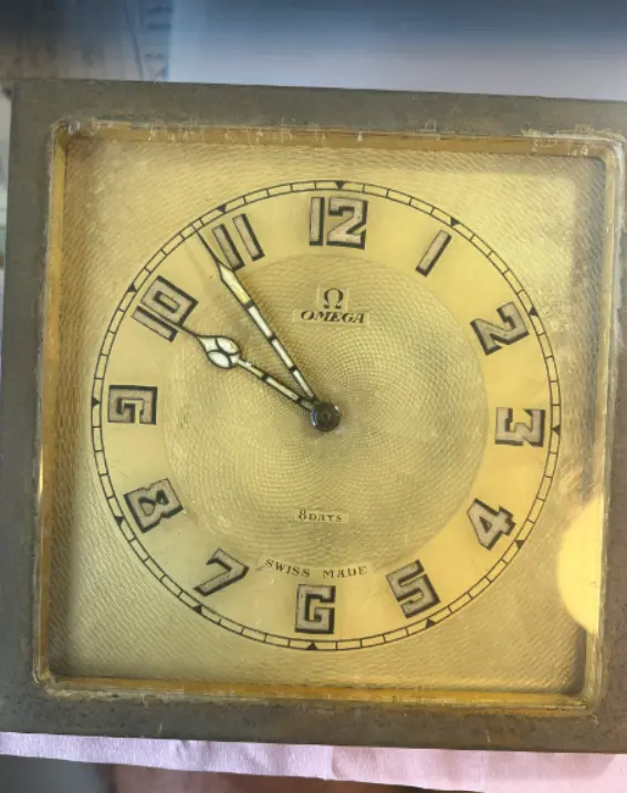

Omega 1928, 8 days, cal 598-d, ref 14.785-B need help
10

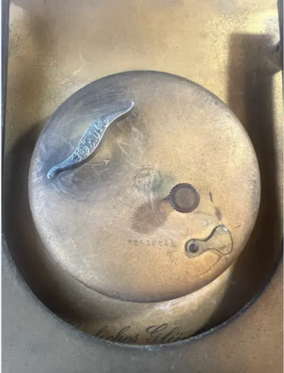

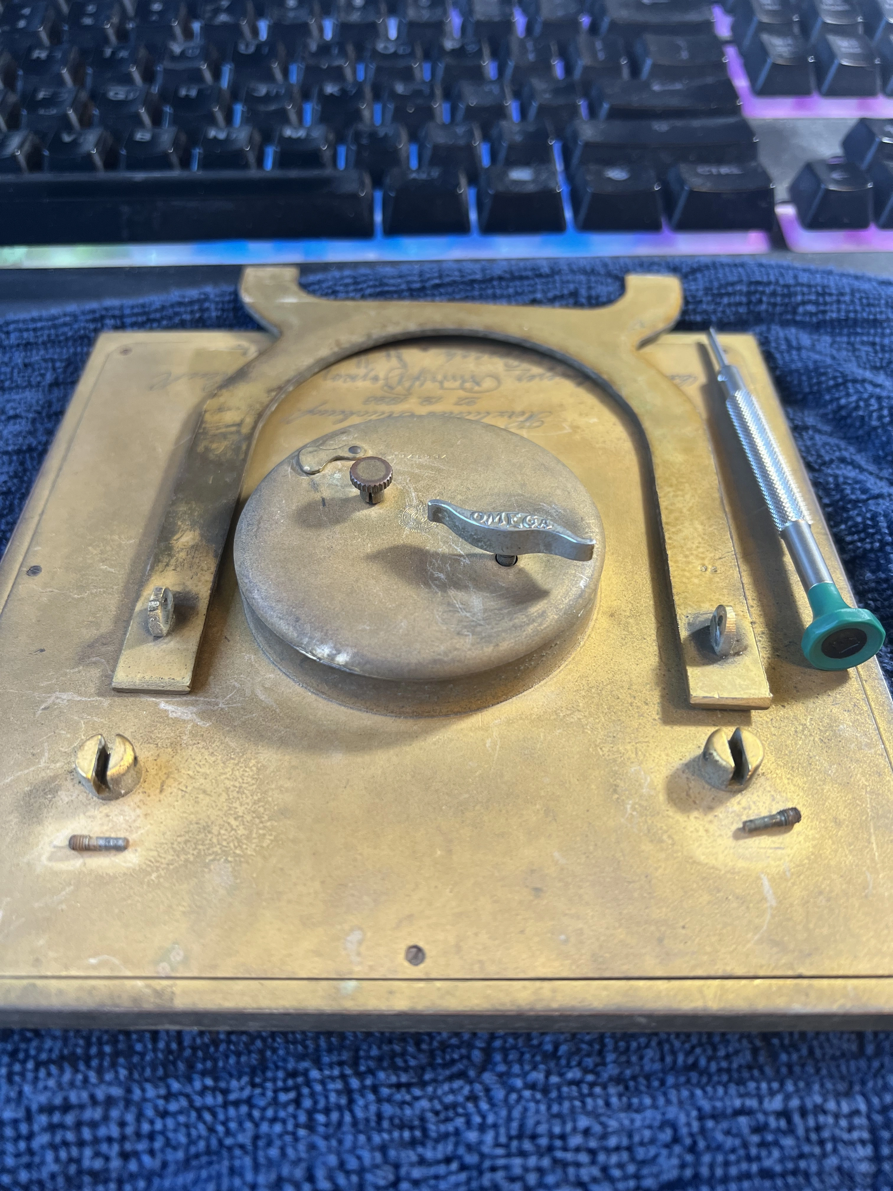

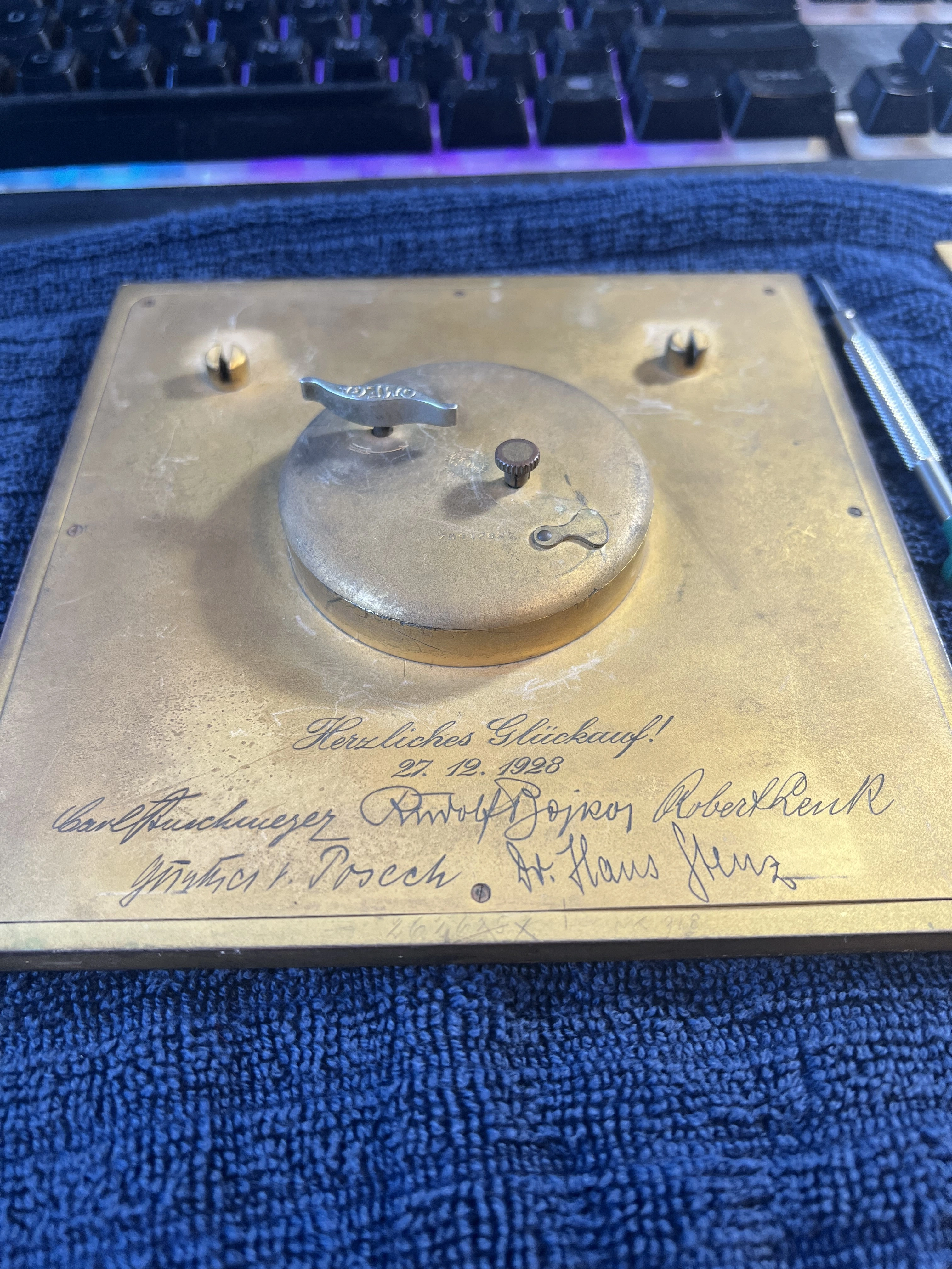

Hi everyone , need help to open the movement in the back. how to do it? need a special equipment? thanks
305
228
Hi, I don`t have this exact case, but I`d bet, that you have to remove the winding and time setting nut first, to be able to unscrew the caseback. looks like it may have thread, or just snapped on?
Mine has banjo fitment.
10
Thanks for your comment. I tried this. But after removing the winding and time setting, still, l can’t remove or turn it. I tried also the remove the whole frame , from dial side. After removing the hands, l found that the dial plate is impossible to be taken off in order to see the movement from the dial side. Any more ideas?

I did it and got the whole frame out. But the dial is fixed and didn’t got it off. So I can’t see the movement

I think if you unscrew the winder and setter the raised back will lever off
10
I tried. Can’t get the movement off from the back. Not by turning not by pooling out

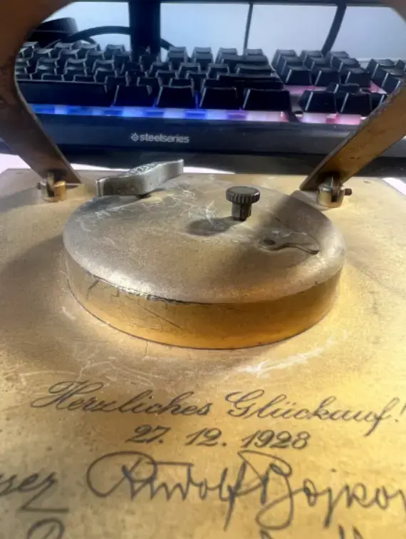

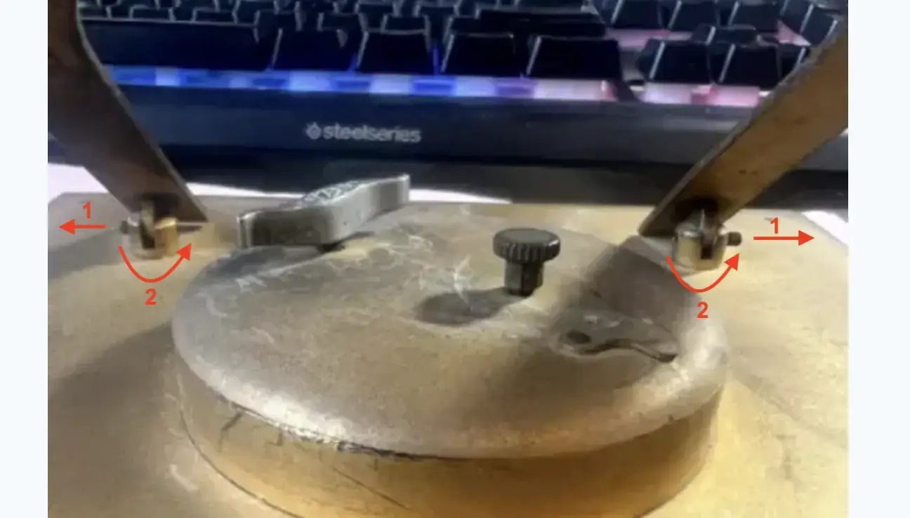

I thought maybe the large round studs the stand attaches to are screwed in but maybe not.

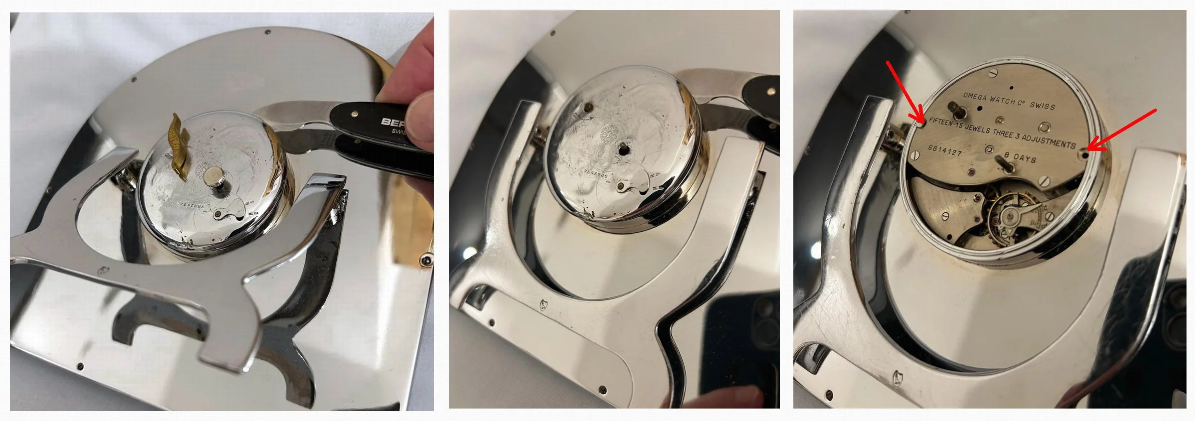

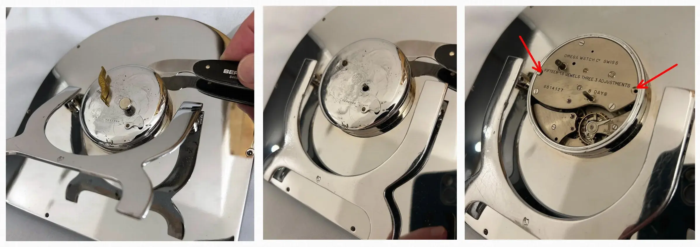

Cristos (above) is correct. The case-back is a press-fit.
The two controls must first be removed (CARE: the winder is a reverse thread and must be moved CLOCKWISE to remove).
There will be a slot (sometimes hard to find) into which a case-knife can be inserted - to allow the case-back to be levered off.
That allows access to the movement retaining screws - and that will allow any further dismantling.

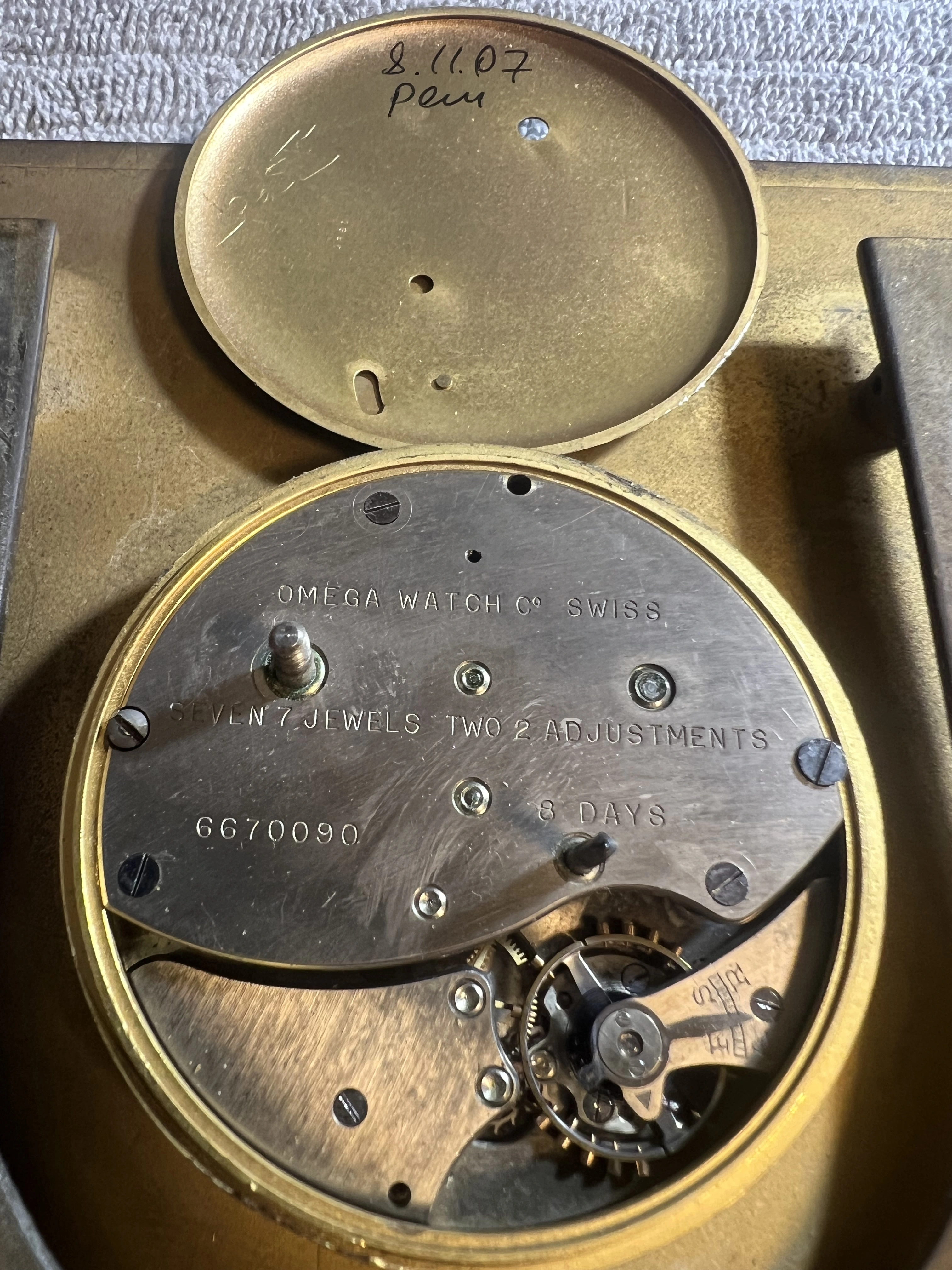

Thank you. I'm pleased it worked.
In passing, I think the reference of your piece is not 14.785B: I think it's 14.706B (not much difference!). Year 1927..
