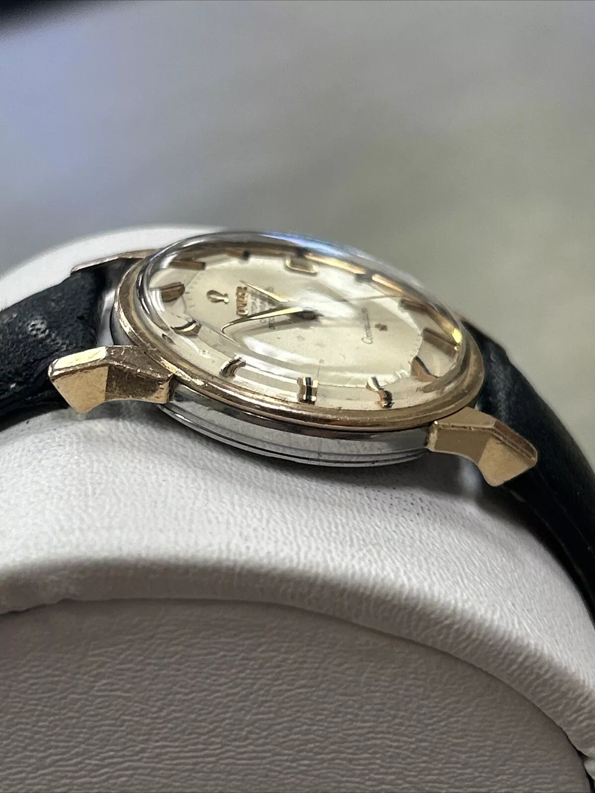

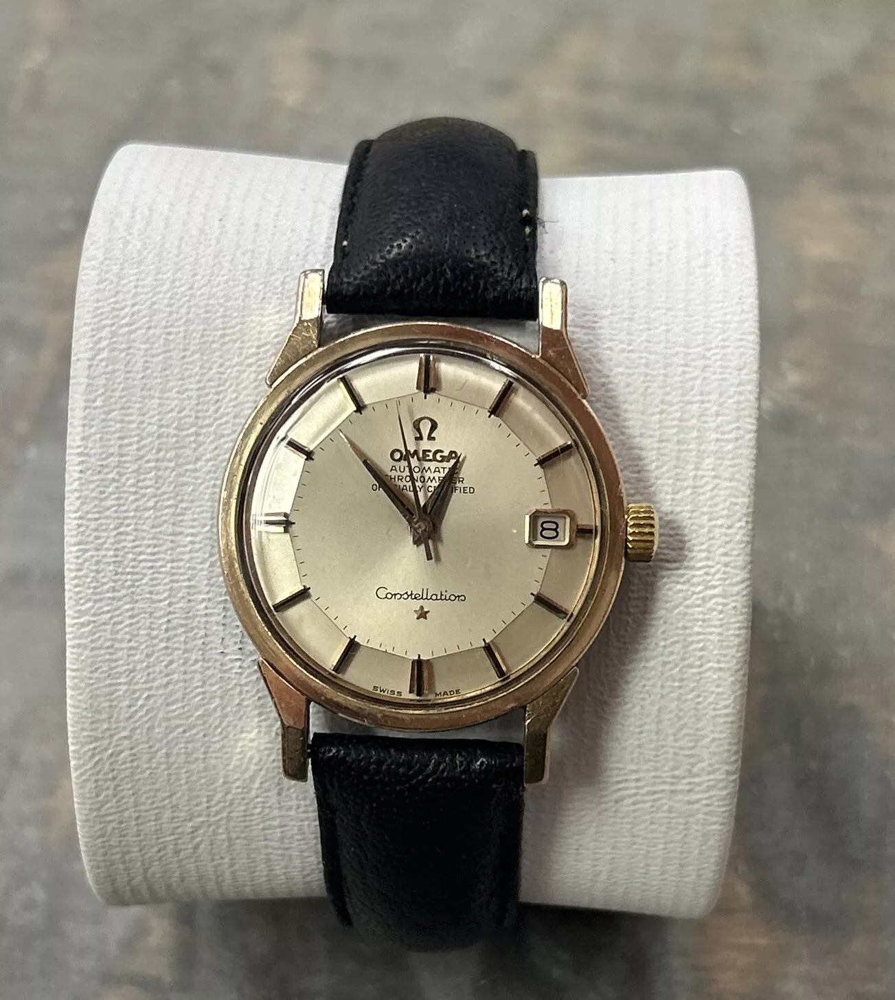

I Just purchased an Omega Constellation 168.005 off of Ebay.
At first, everything seemed to check out about this watch but after receiving it i noticed that the indices at 9 oclock and 12 oclock appear to be backward!
Is there anything else about this watch that is off that i am missing?

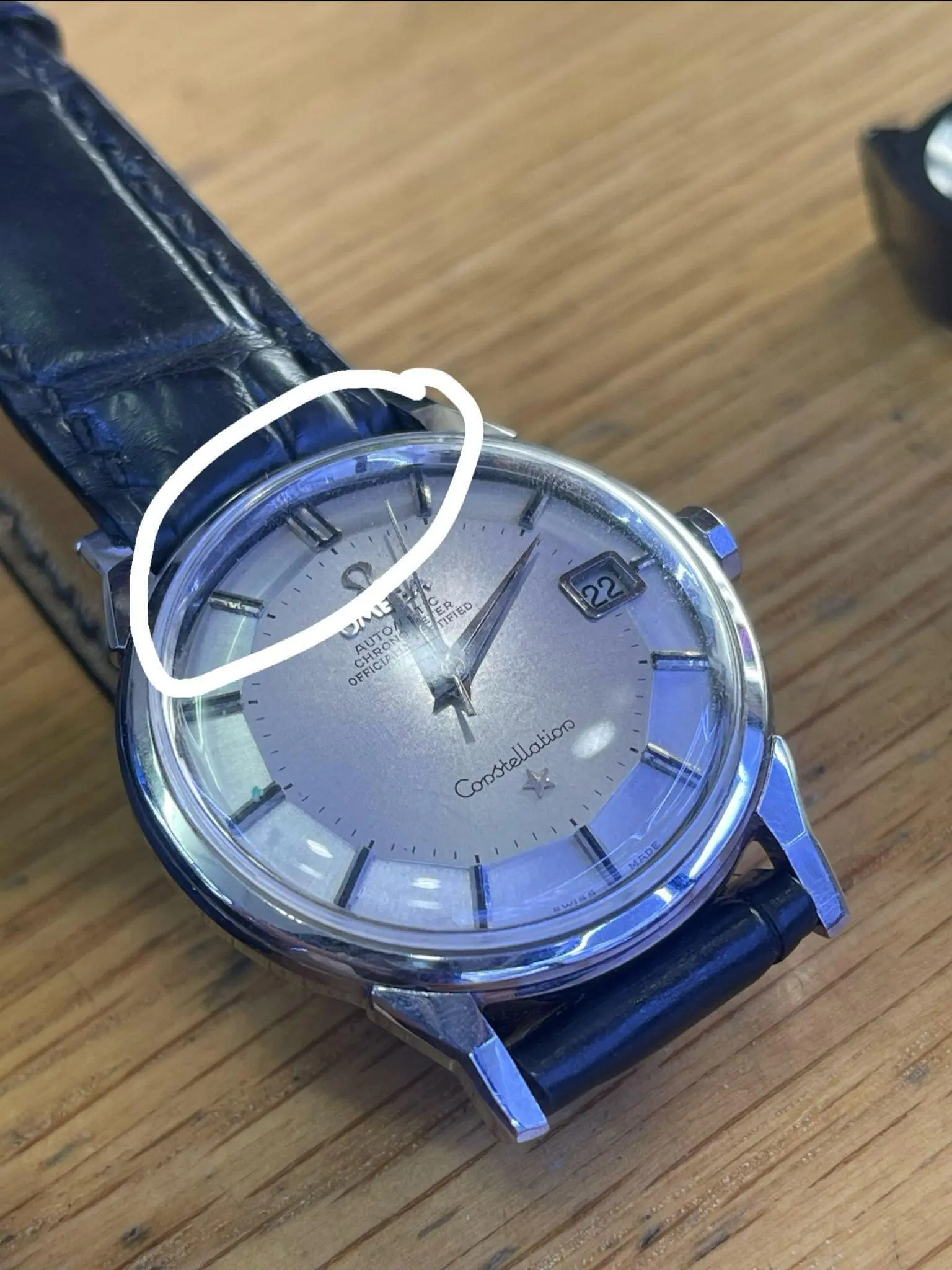

Do you have a picture where the hands aren’t obscuring the text? Even so, I’m inclined to say the dial is original. However it’s overpolished and the crown is wrong.
These are visible in the pictures though so if it was an auction I’m not sure you have grounds for a return.

Thanks for the response, these are the pictures from the listing. I will post a couple better pictures.

Yes you are correct the index at 6 is correct, the indices at 9 and 12 are applied incorrectly, backwards.

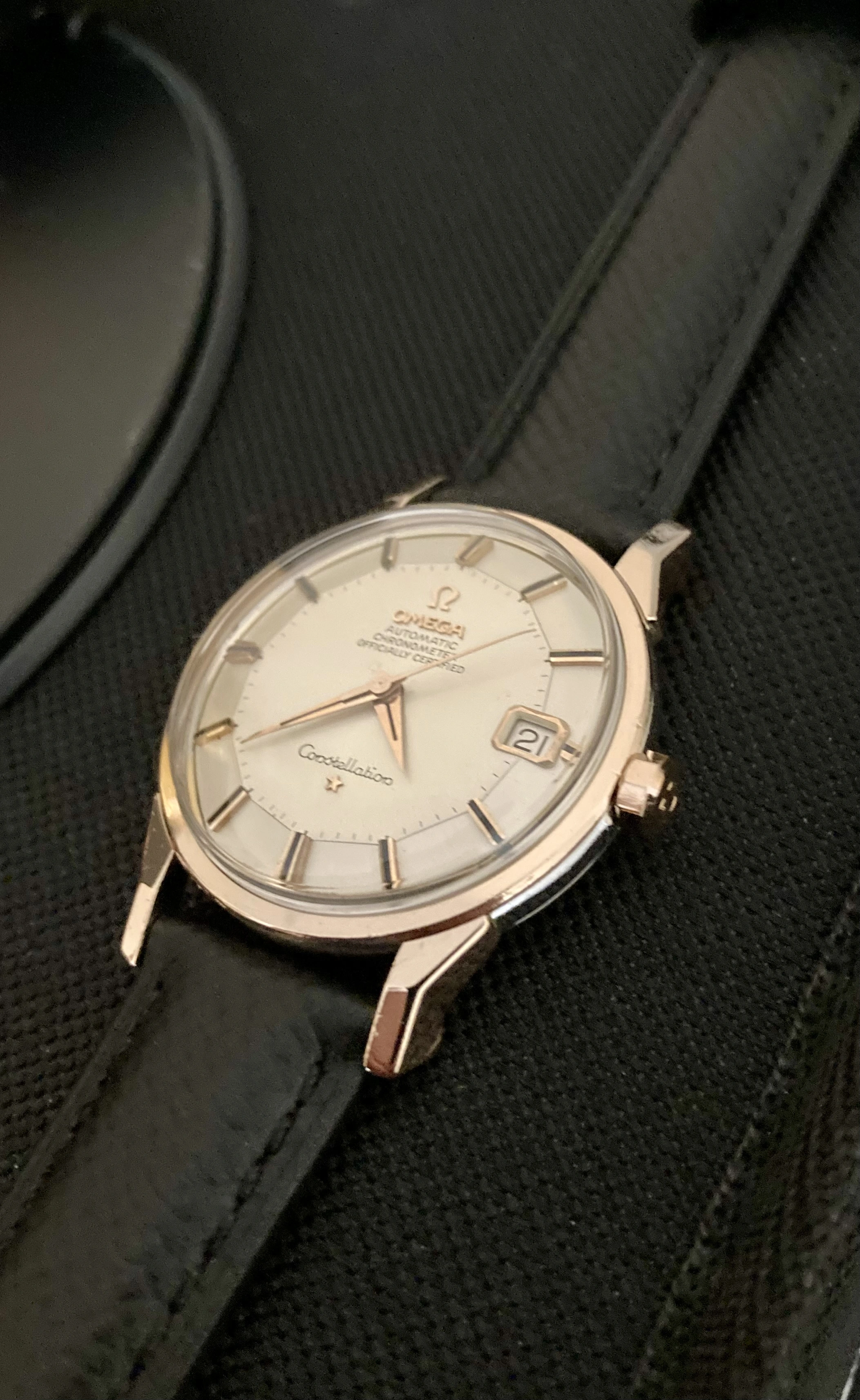

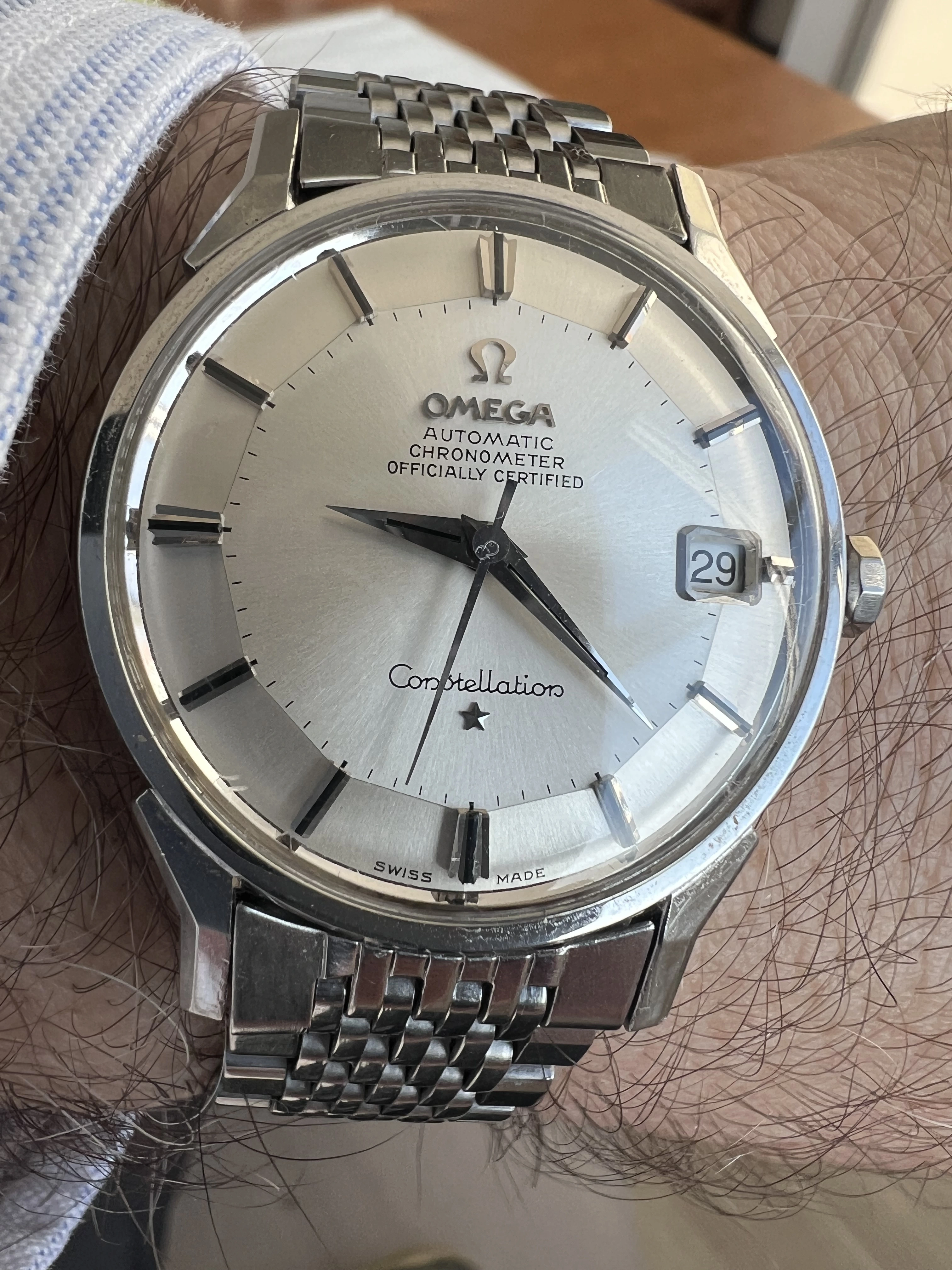

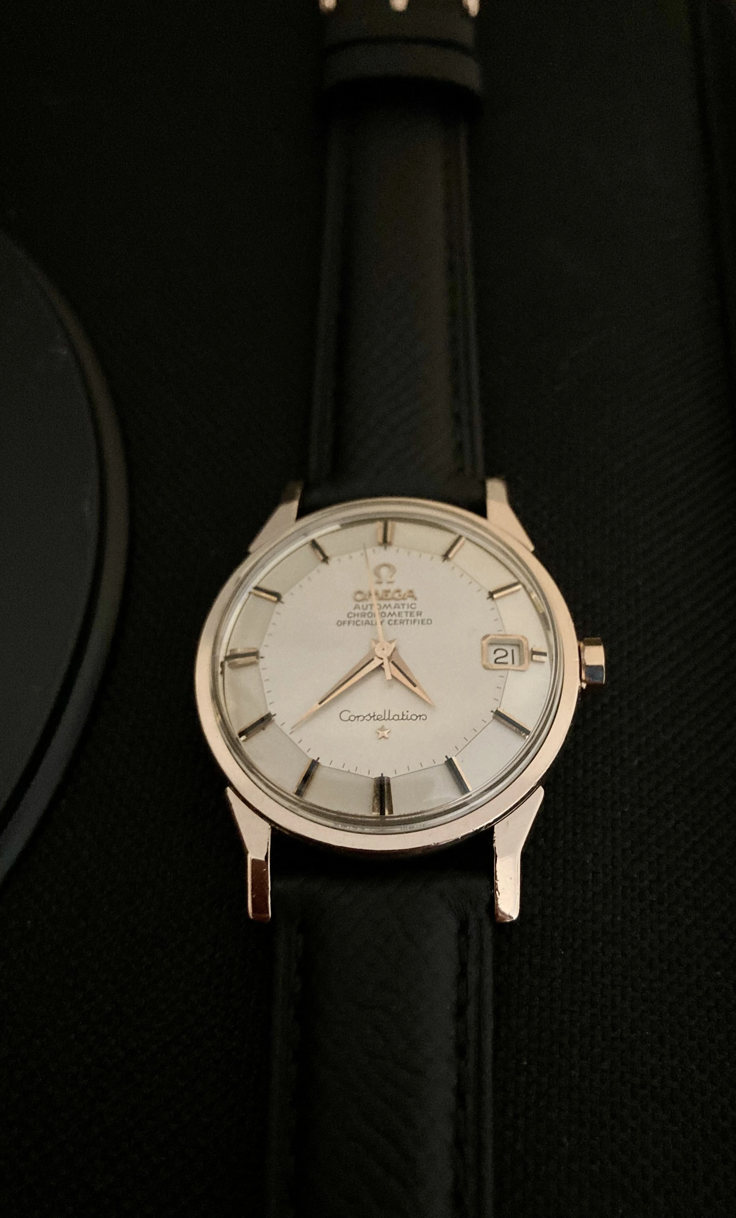

Here is my SS example for comparison.
So clearly the dial was fiddled with and if it was advertised as all original you may have grounds for return. How was it advertised?

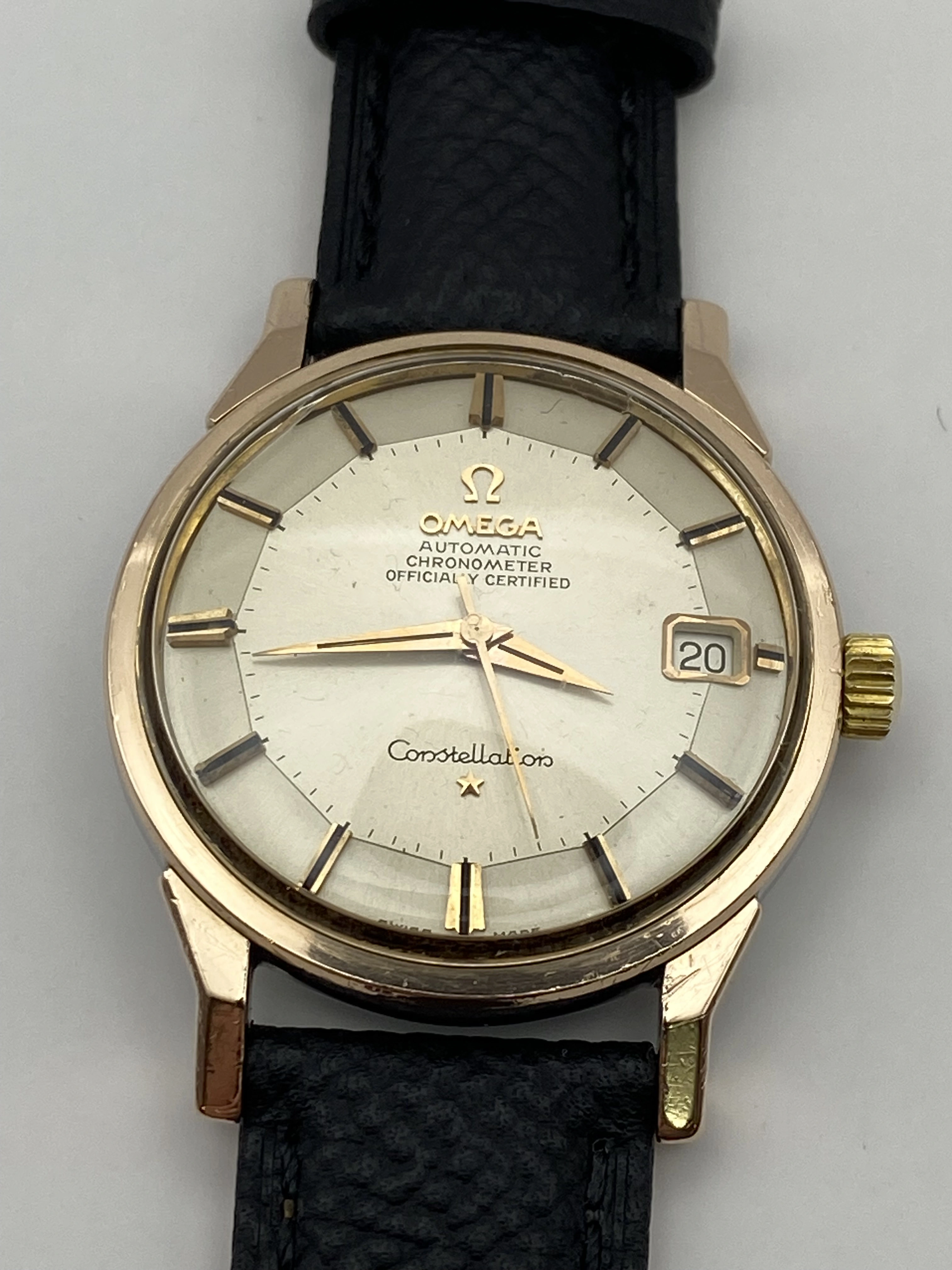

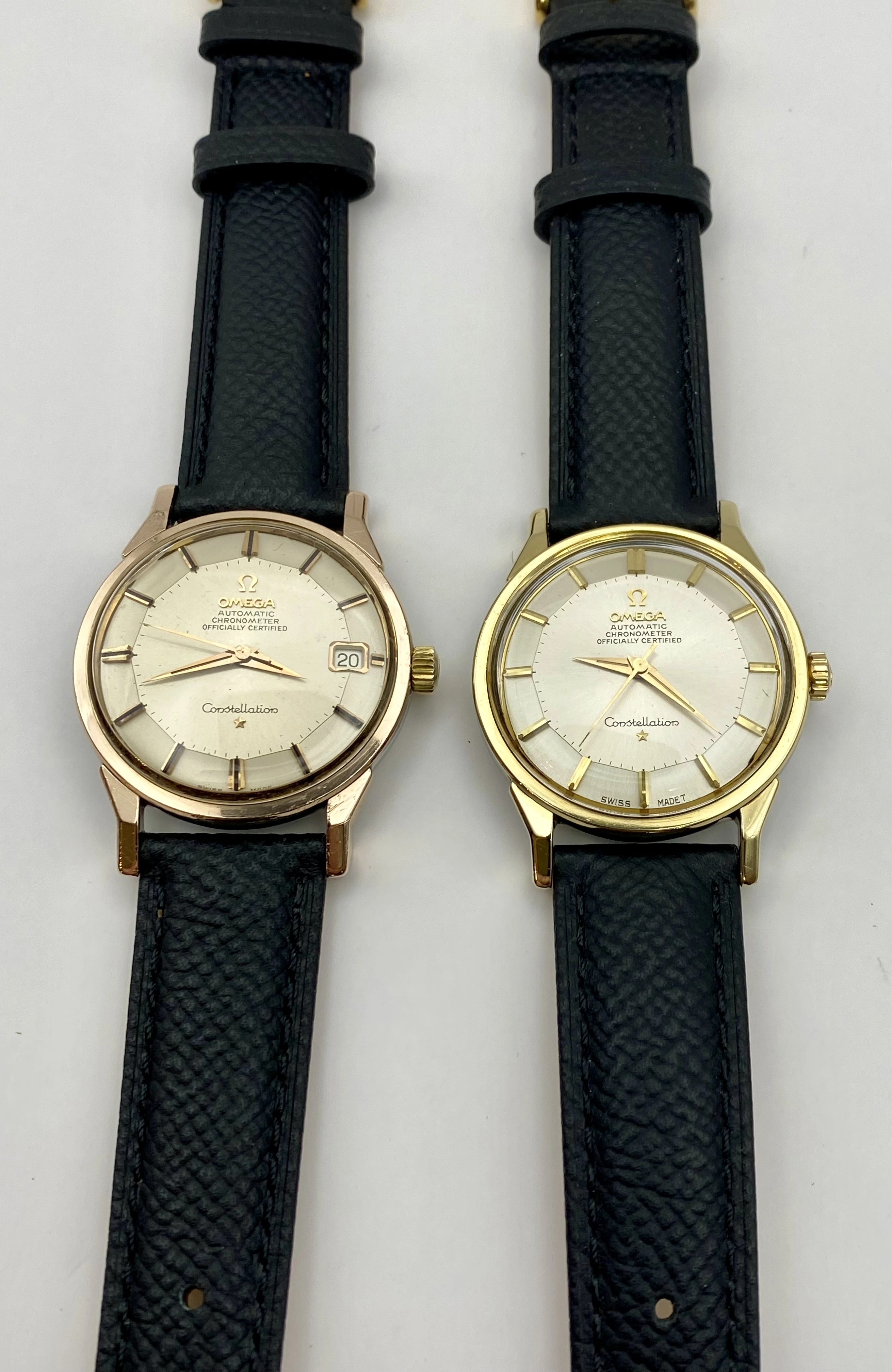

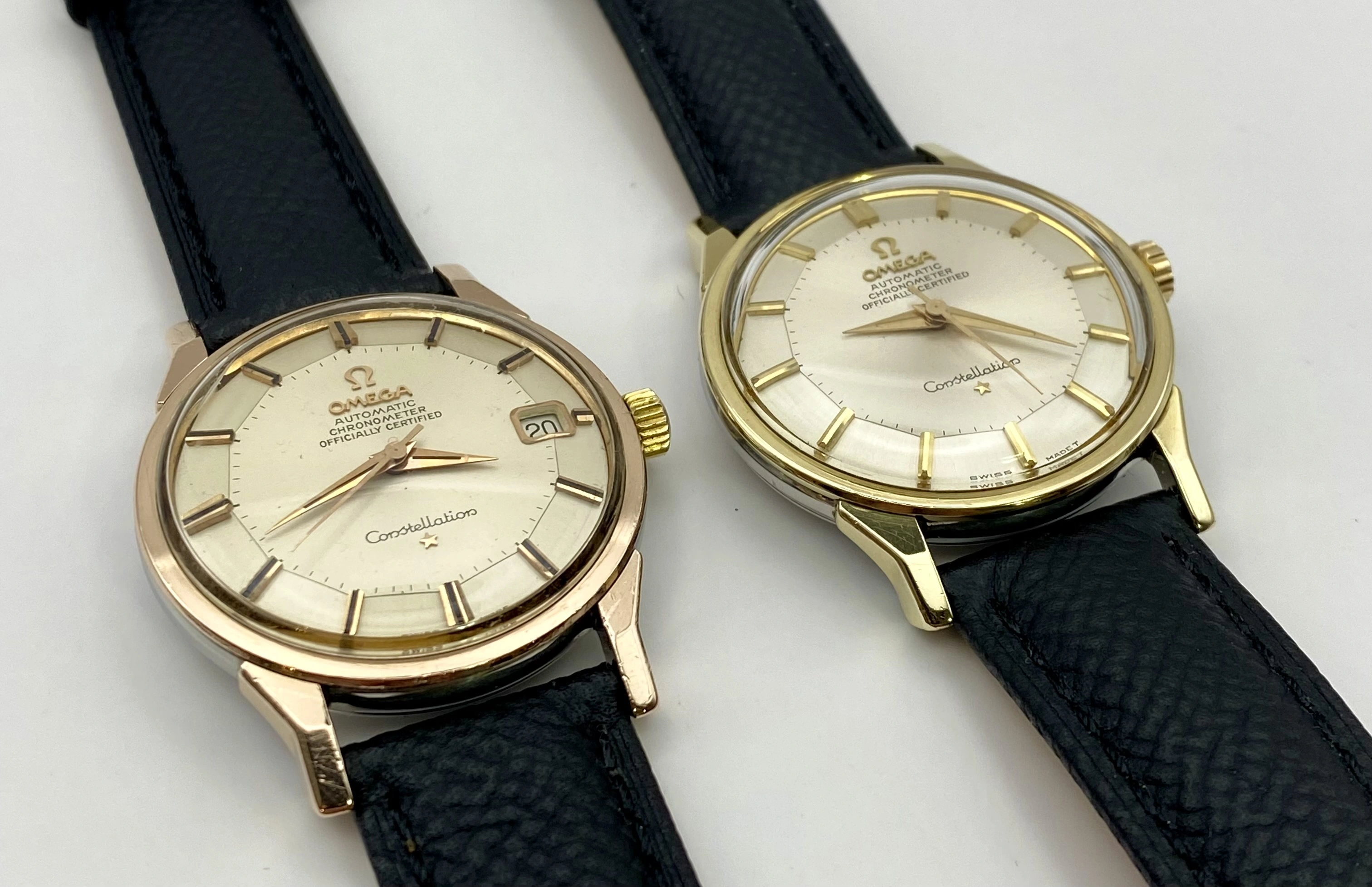

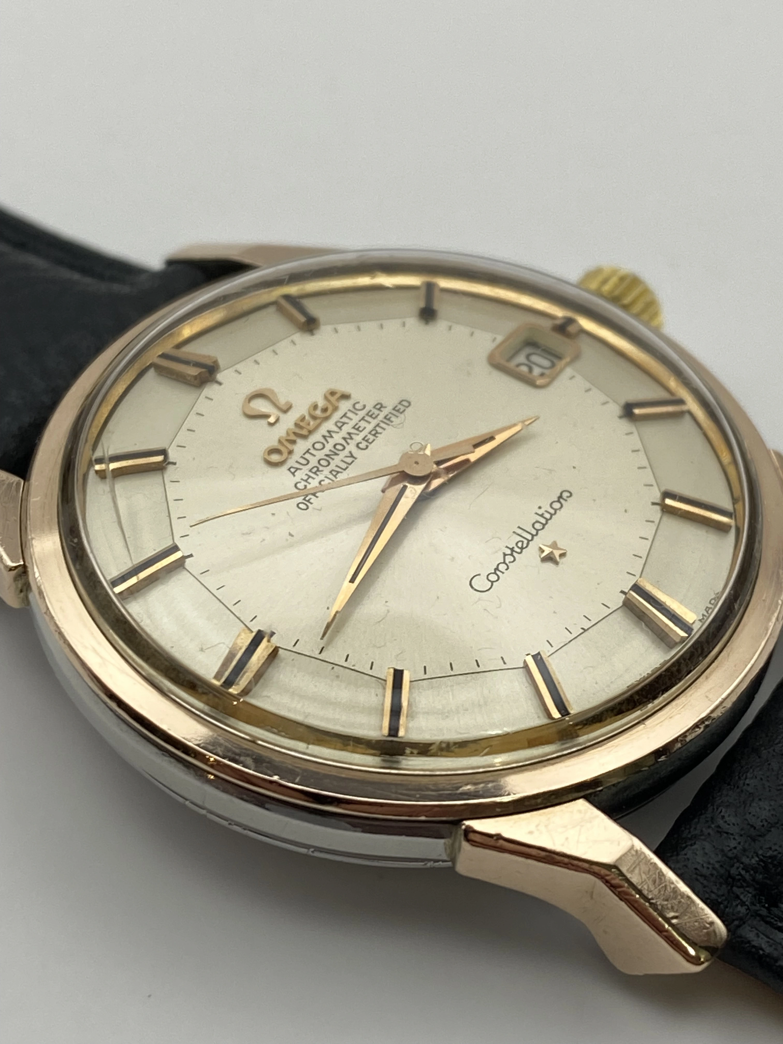

Here are some better pictures. It also appears to be rose gold in color when I compare it to my yellow gold capped 167.005.

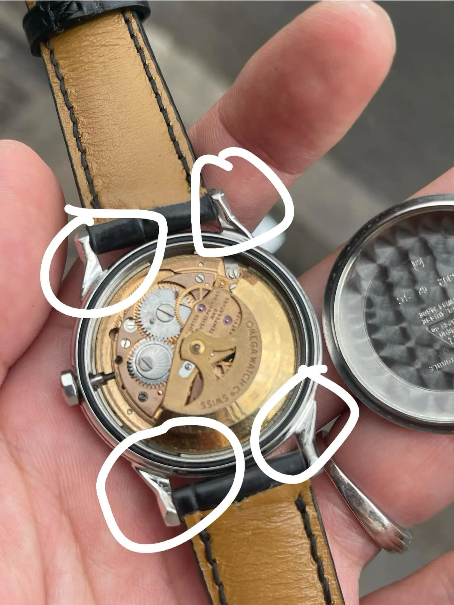

Photos look like a lot of wear, maybe even wear-through of the gold cap, particularly on lower lugs
What do those areas look like in hand?

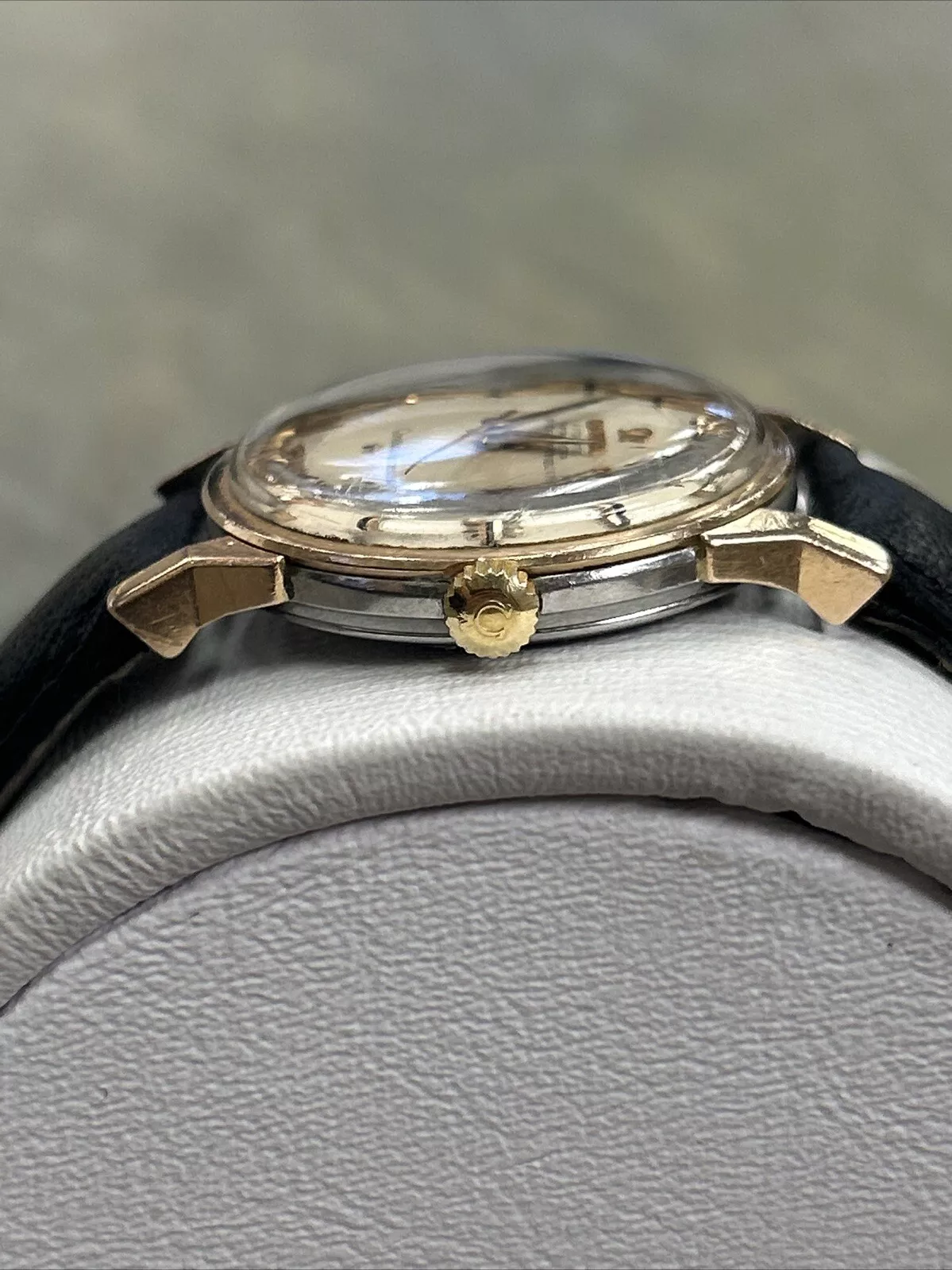

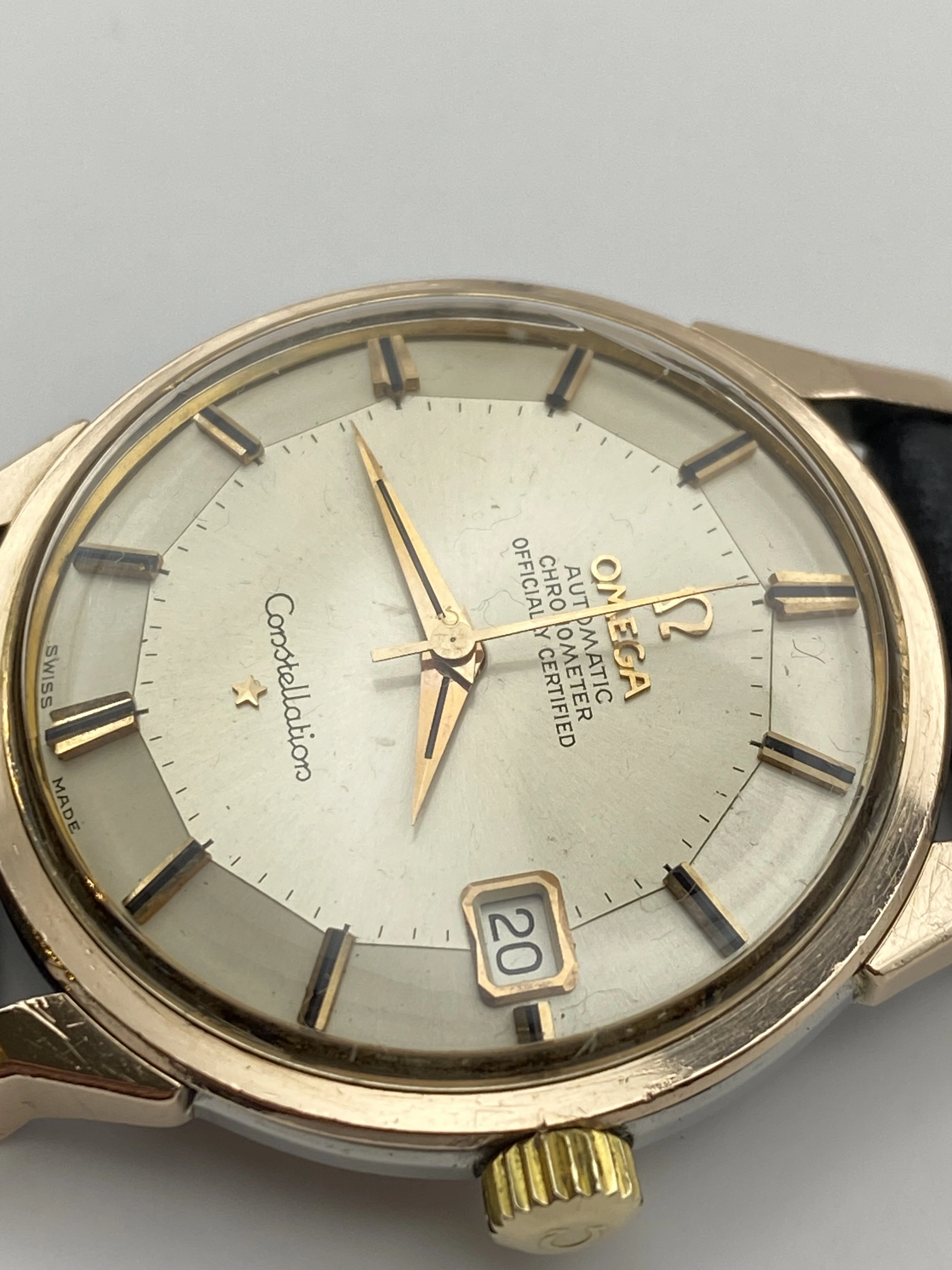

On these photos there is some lug wear but I don’t see any wear through the concerns were shadows. So that’s good
On these shots the indices at 12 6 and 9 look ok. Is this my old eyes late at night or do you agree. Were the initial photos an optical illusion created by crystal edge? A straight frontal shot with no tilting may help.
The indices were the wrong way round on the initial photos.
The errant indices appear to have been righted and the crown changed.

I made it a little better.
I’m not sure how you did that but assuming it’s the same watch you done good.

We’ve been pranked
Lugs seem to be replated too

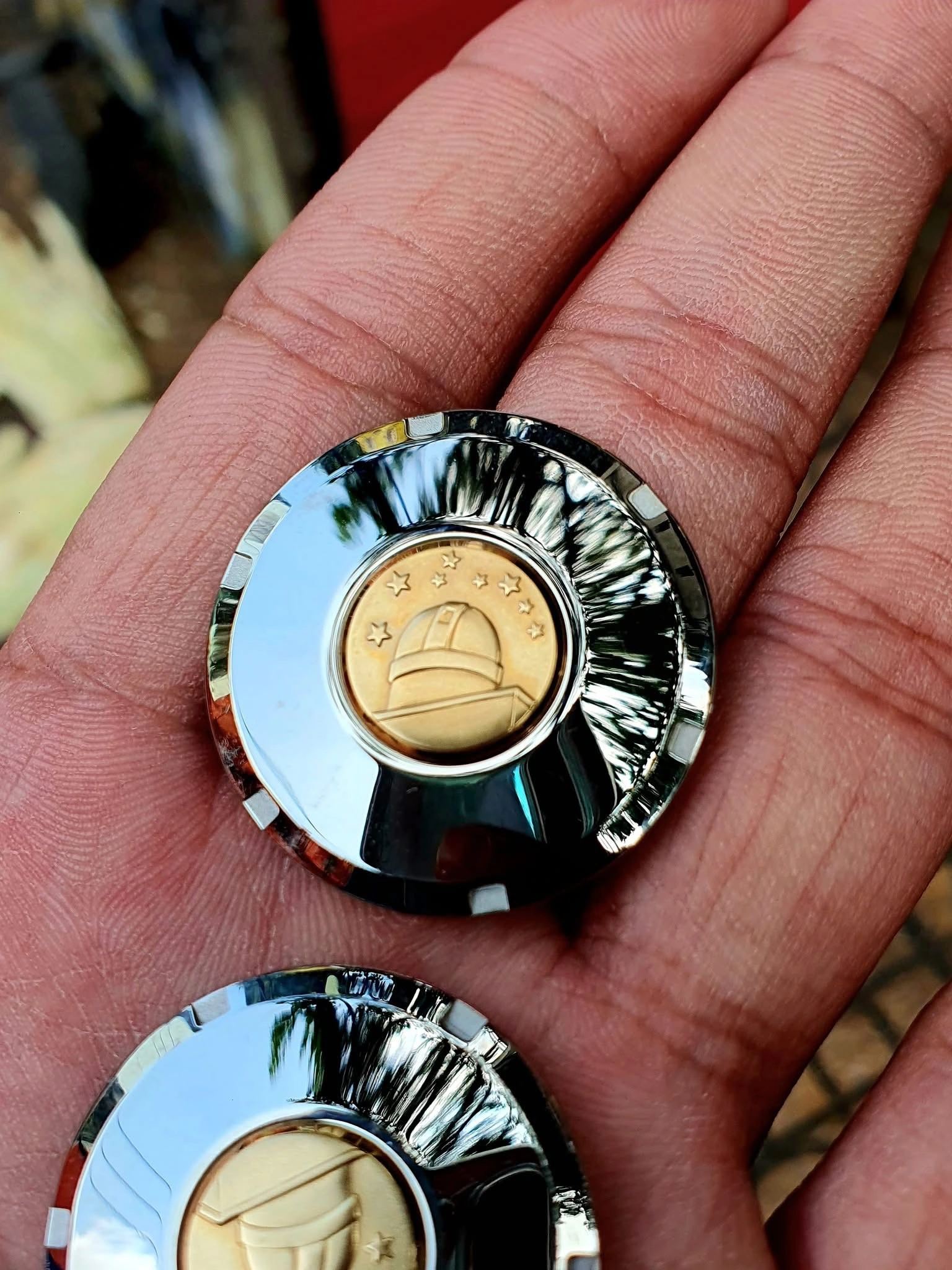

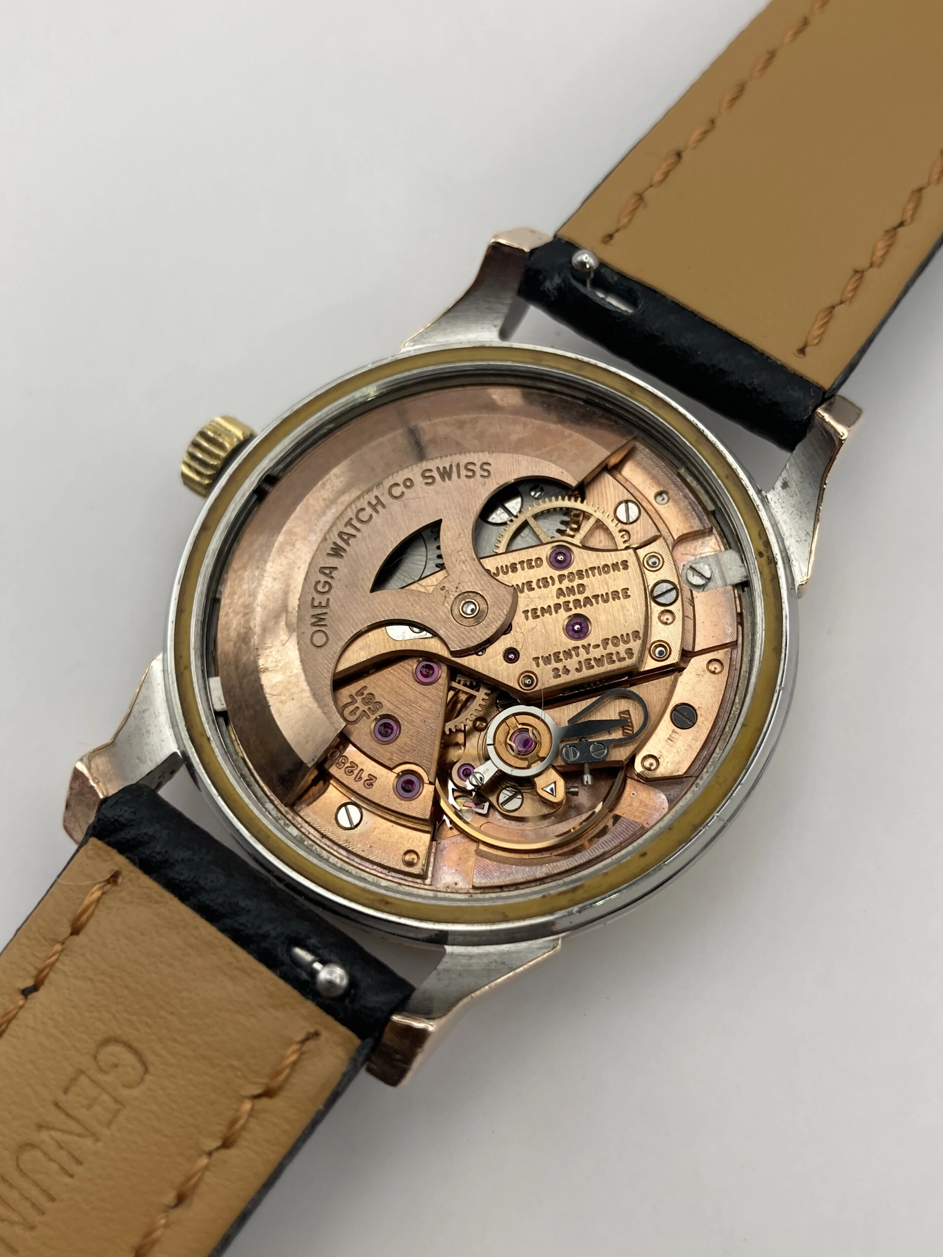

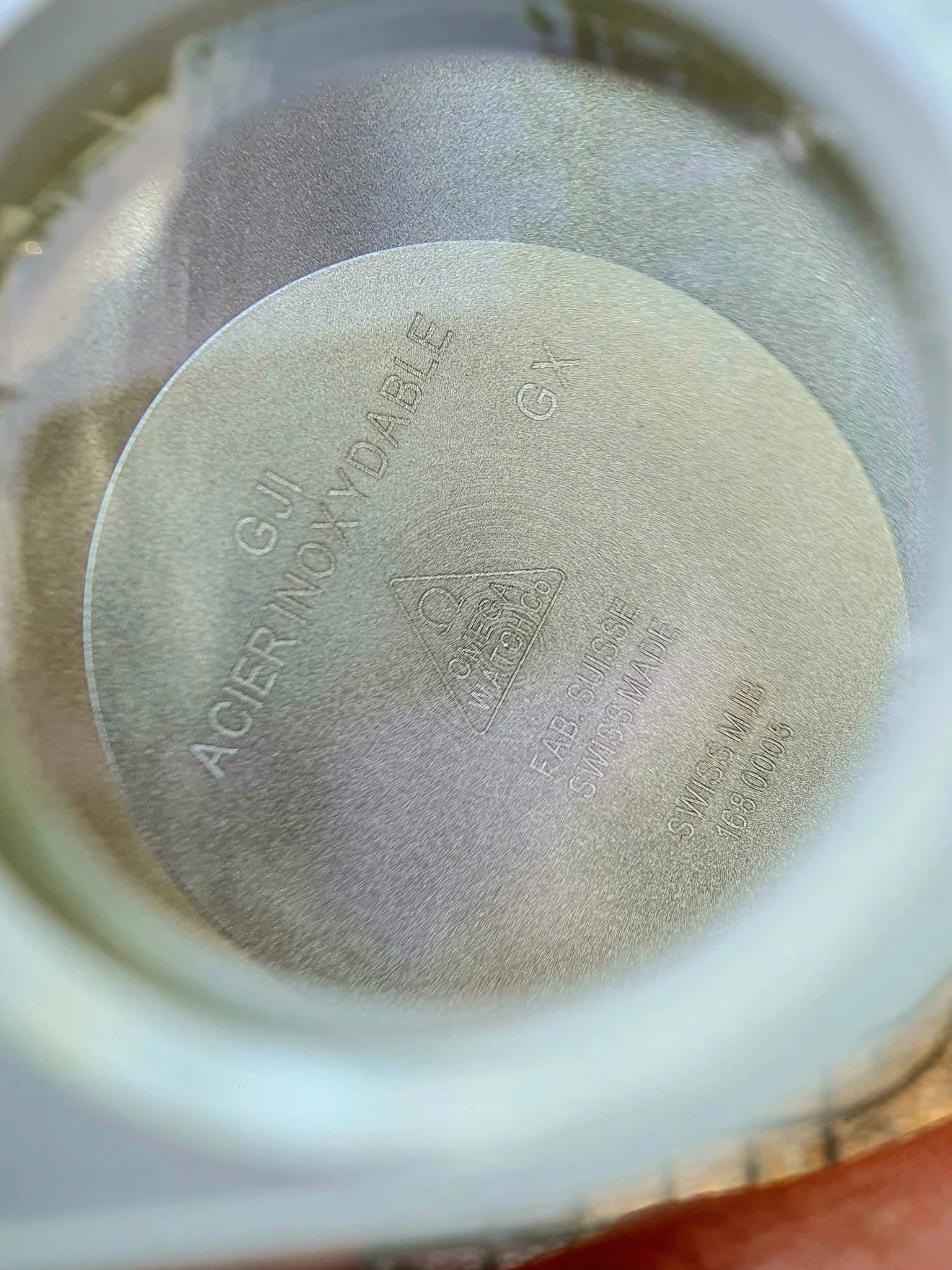

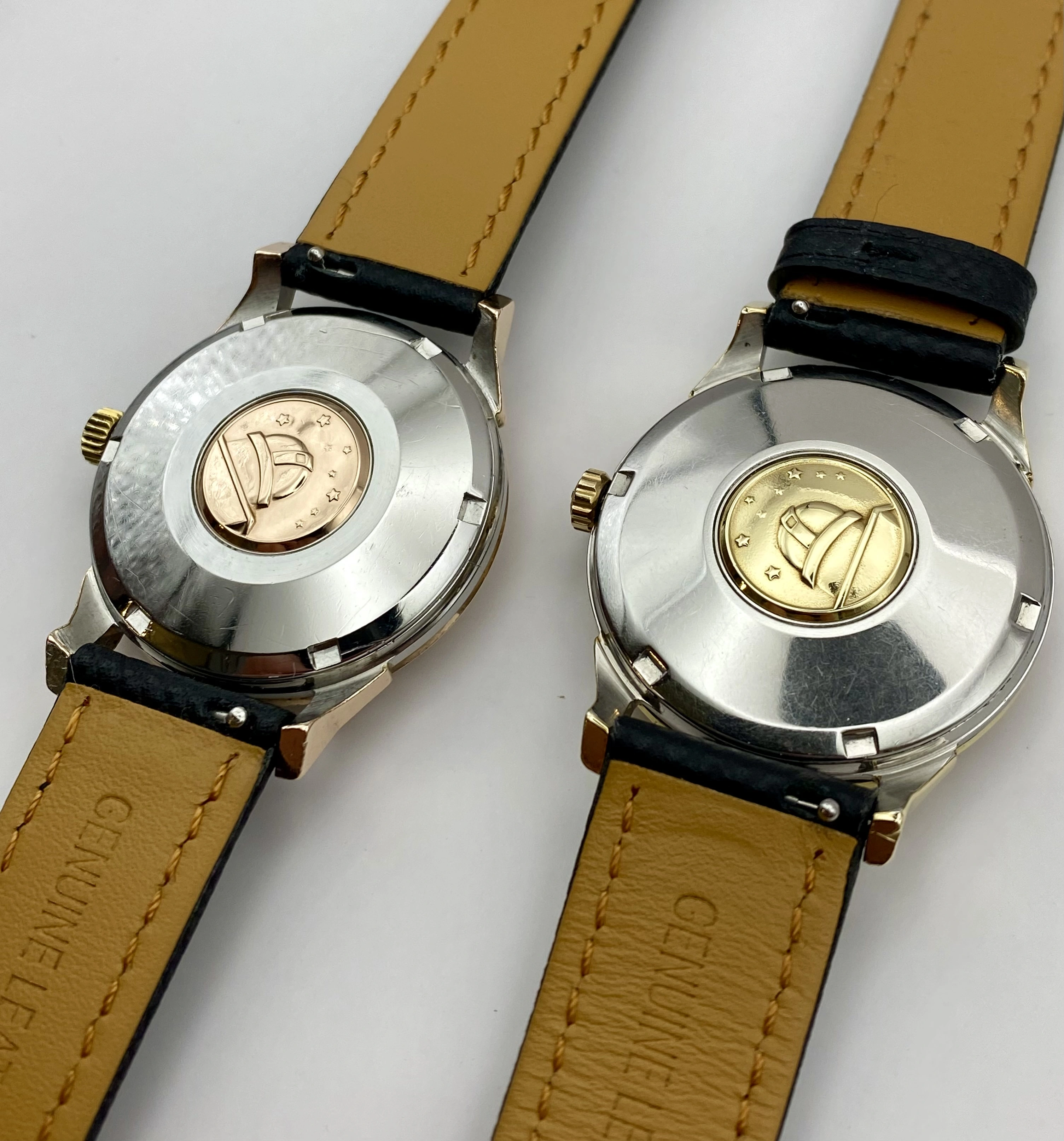

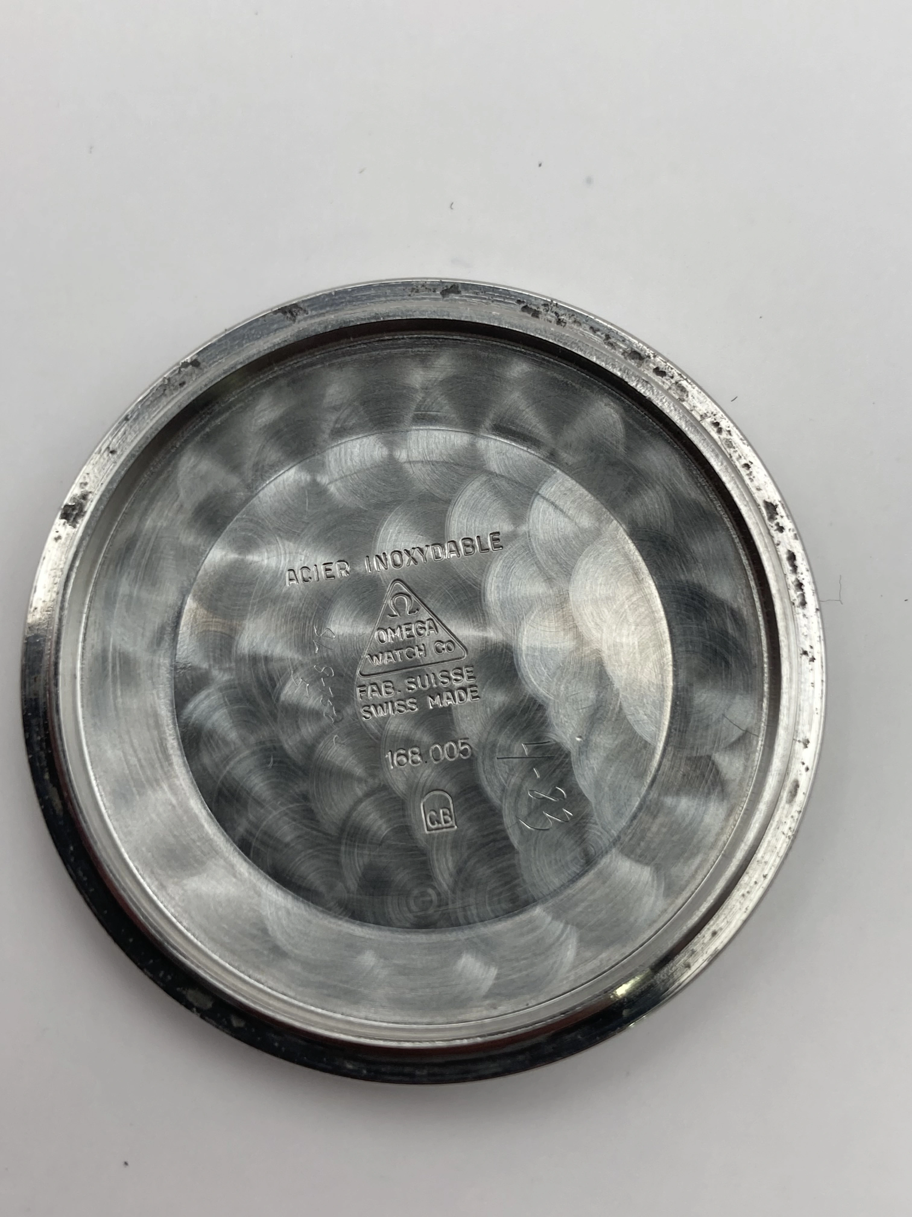

IMO it’s a FAKE case. The lugs are thick and ugly. The dial can not seat properly inside the case. Fake
Presuming that all the images belong to this watch, I see no issues with the case.
The inside case back looks ok.
The medallion looks ok.
Do remember that a CB case will look slightly different to an SGR case.
Oops that was quick. I deleted that post after rechecking some fake case that I have picture. Yep, OP’s case doesn’t look like that.
Btw, I have some photos about fake case here. Just for your information.
(dial can't seat properly inside this one)
(lugs are sharpened by hand)
(those small stars are not small enough)
(wrong inscription)

I took the 2 indices off that were on incorrectly and reattached them, I replaced the original crystal with an omega px5015 one (the original one had a small crack between 10 & 11 o’clock, it can be seen in the original pictures I posted), I replaced the crown and cleaned the case by hand with flitz polish and took some better pictures.
