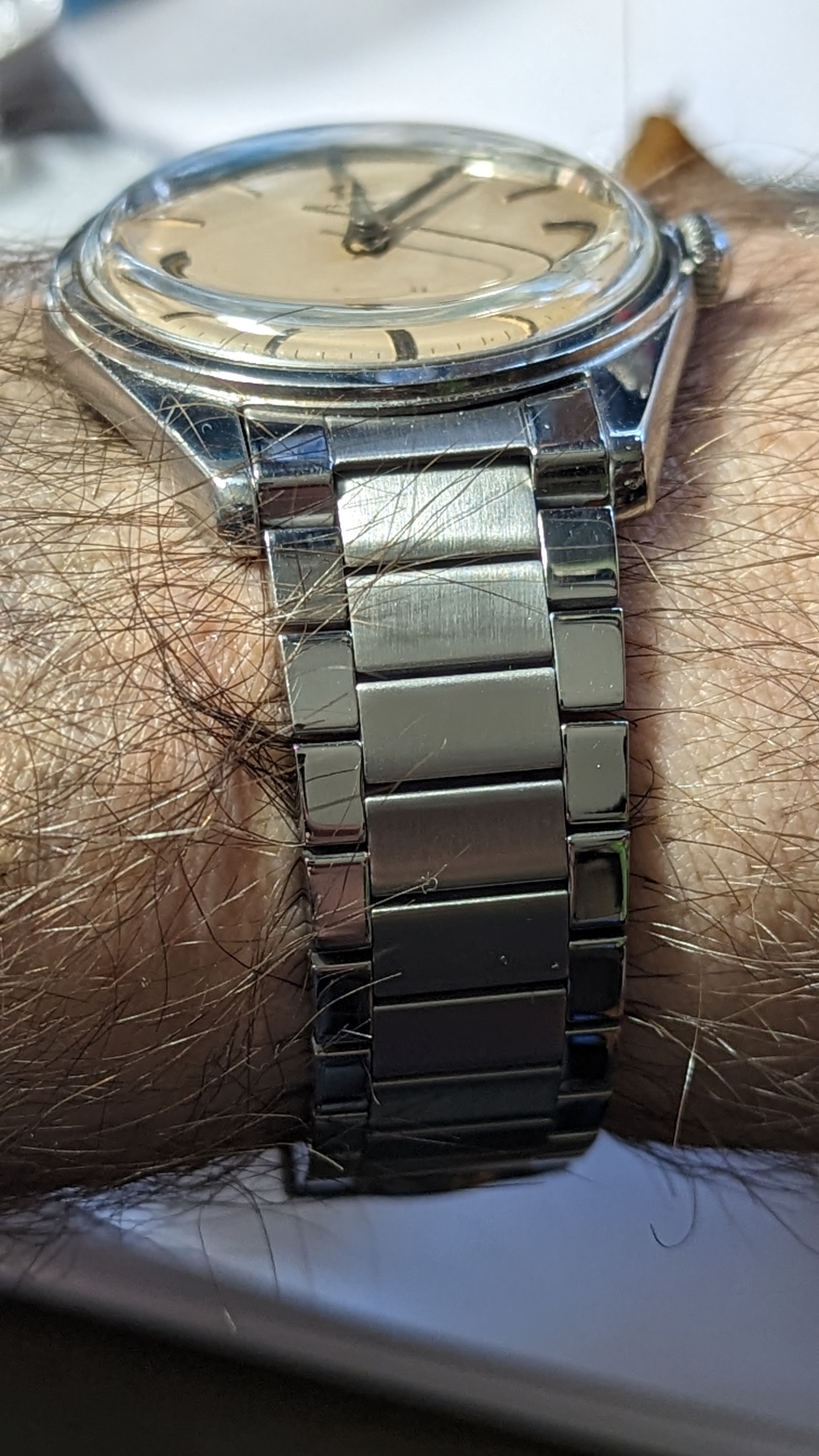

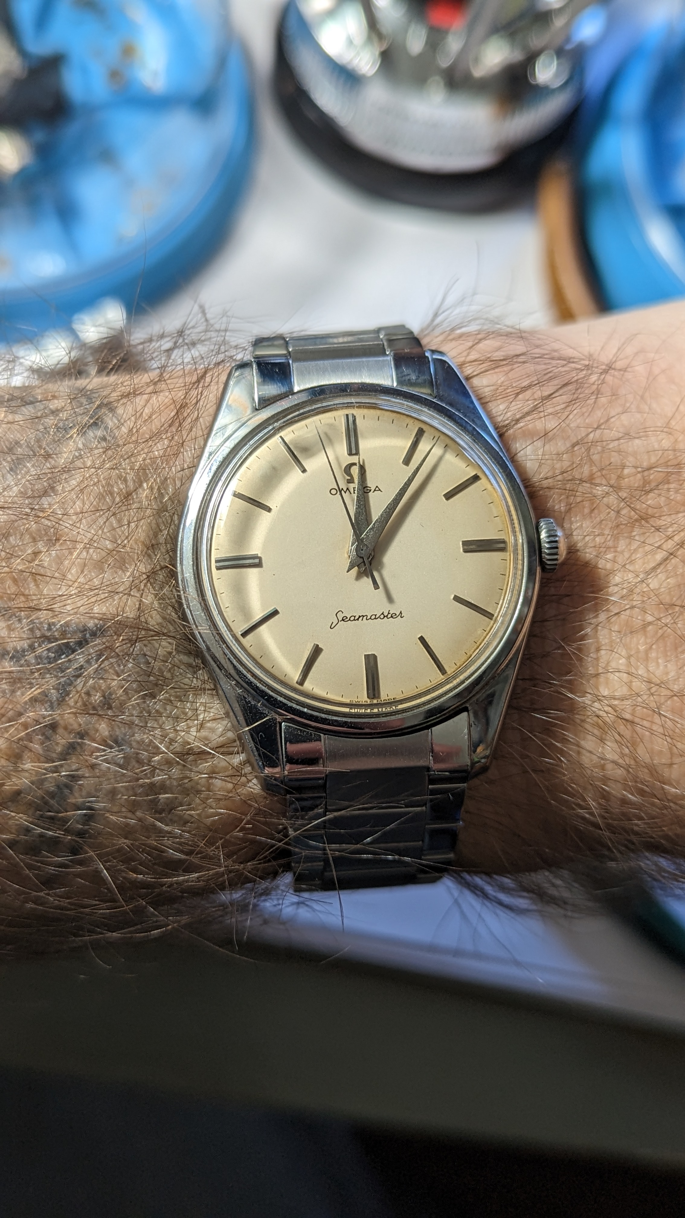

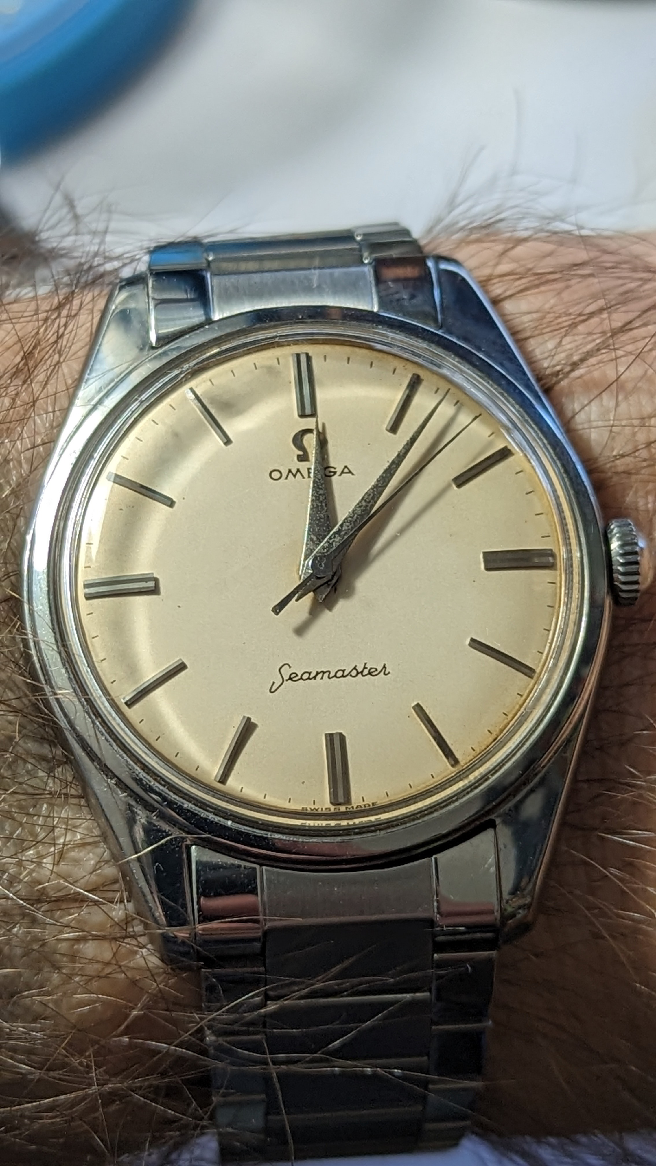

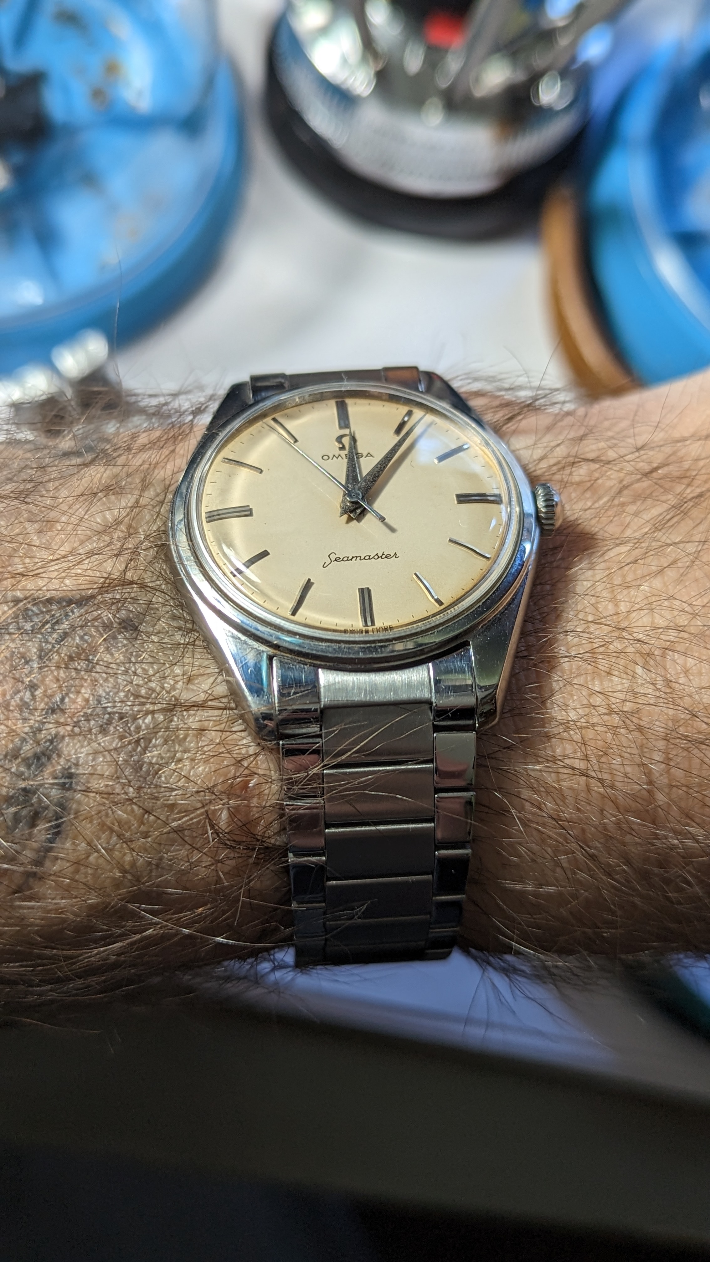

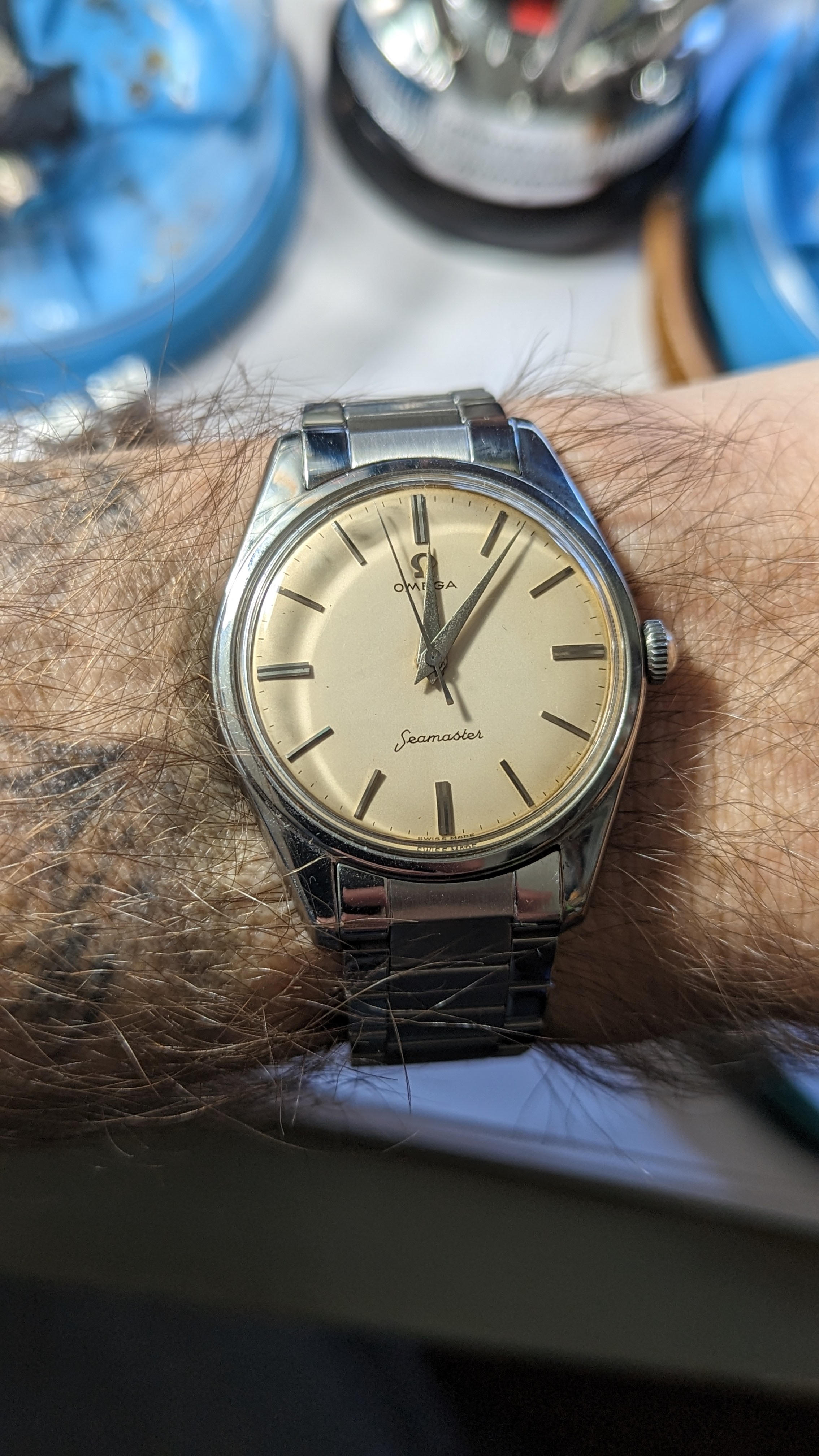

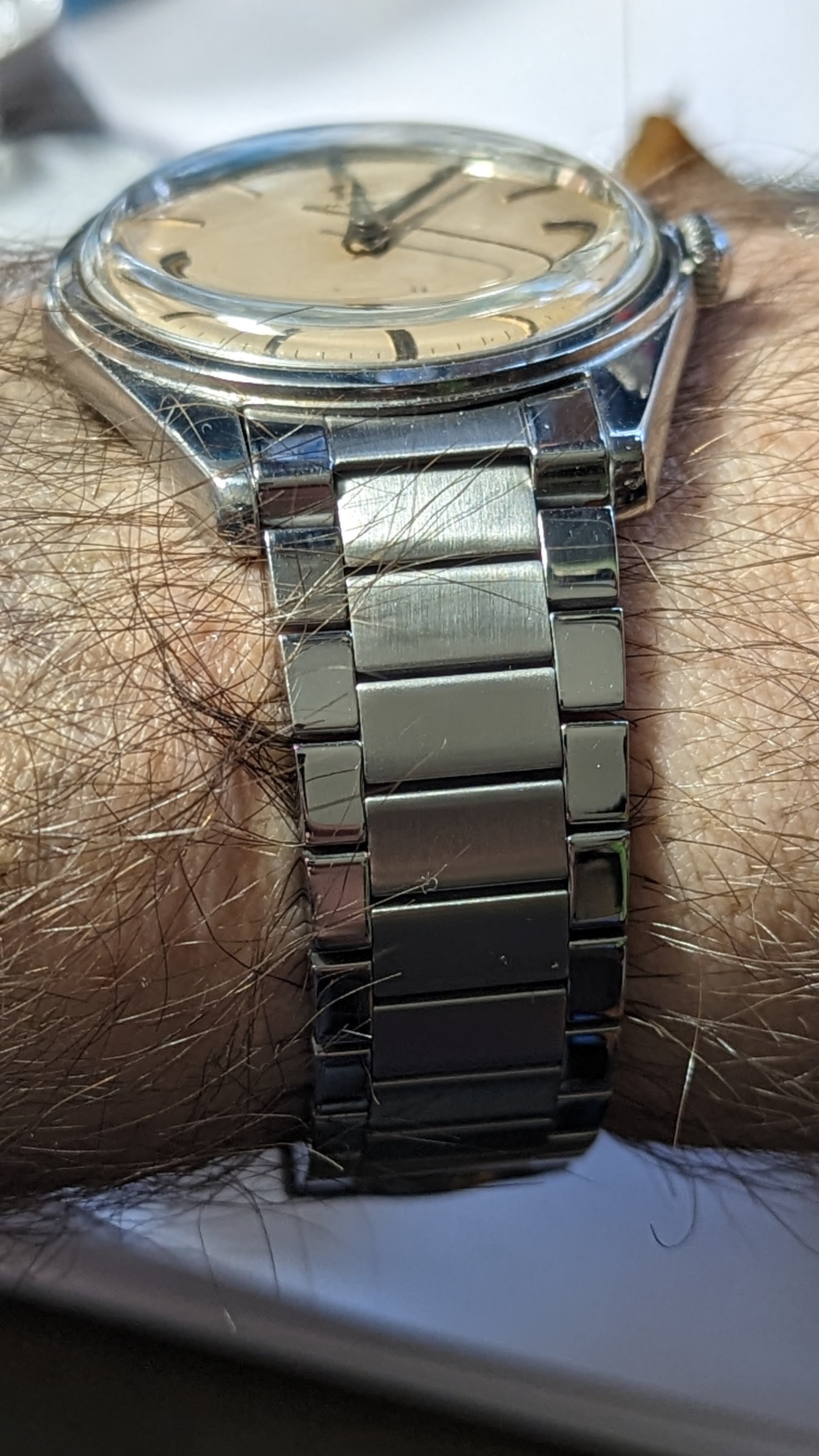

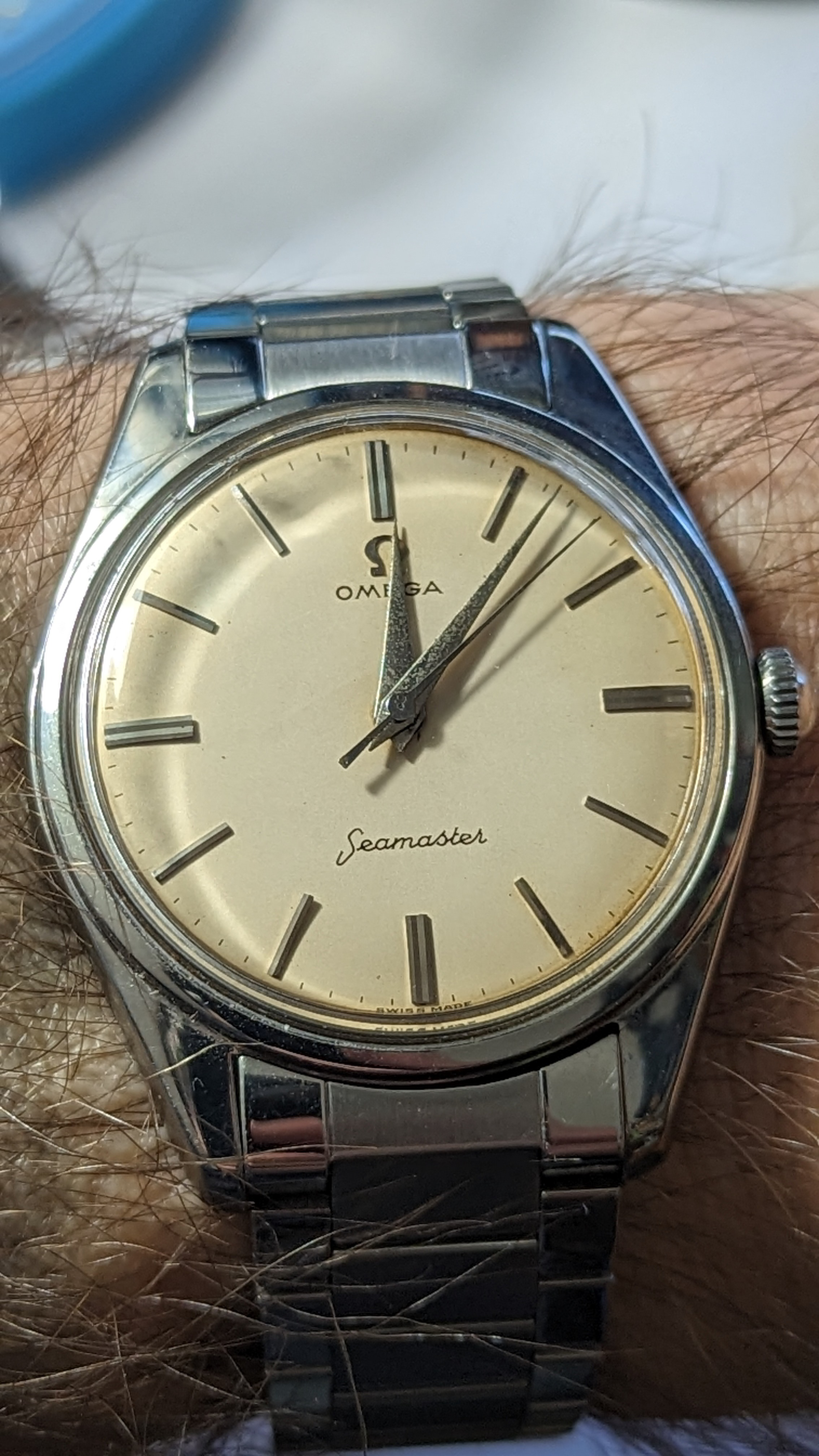

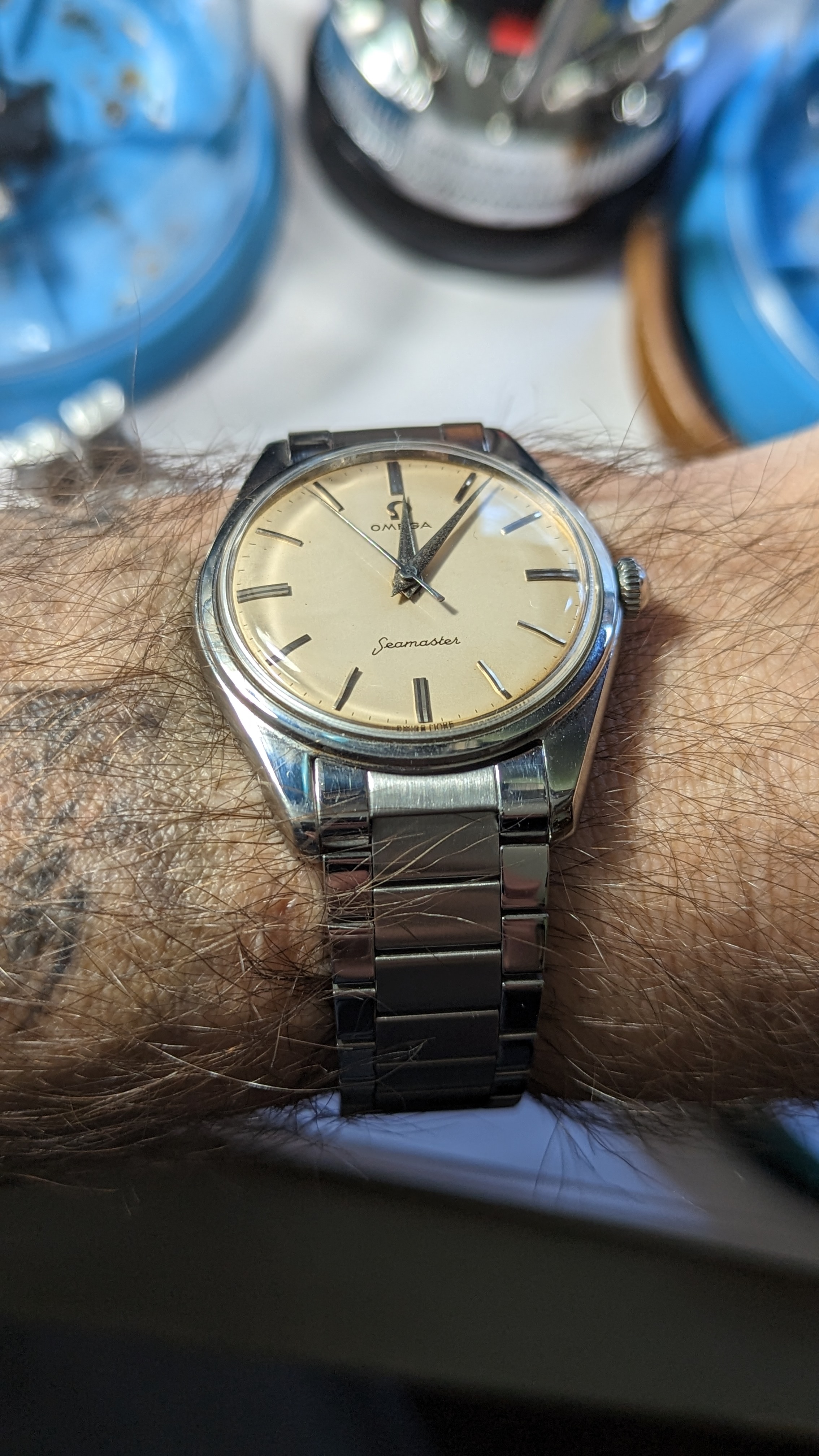

Needed a touch of slip stone on the edges to make it fit but wow. This is like the glasss slipper of bracelet and the feel is right on vintage.
246
586
That looks great @RevZMan123 and the fit looks really good too! I feel like there aren't too many pics of vintage 18mm lugged Seamasters with bracelets like this one so it's good to see one.

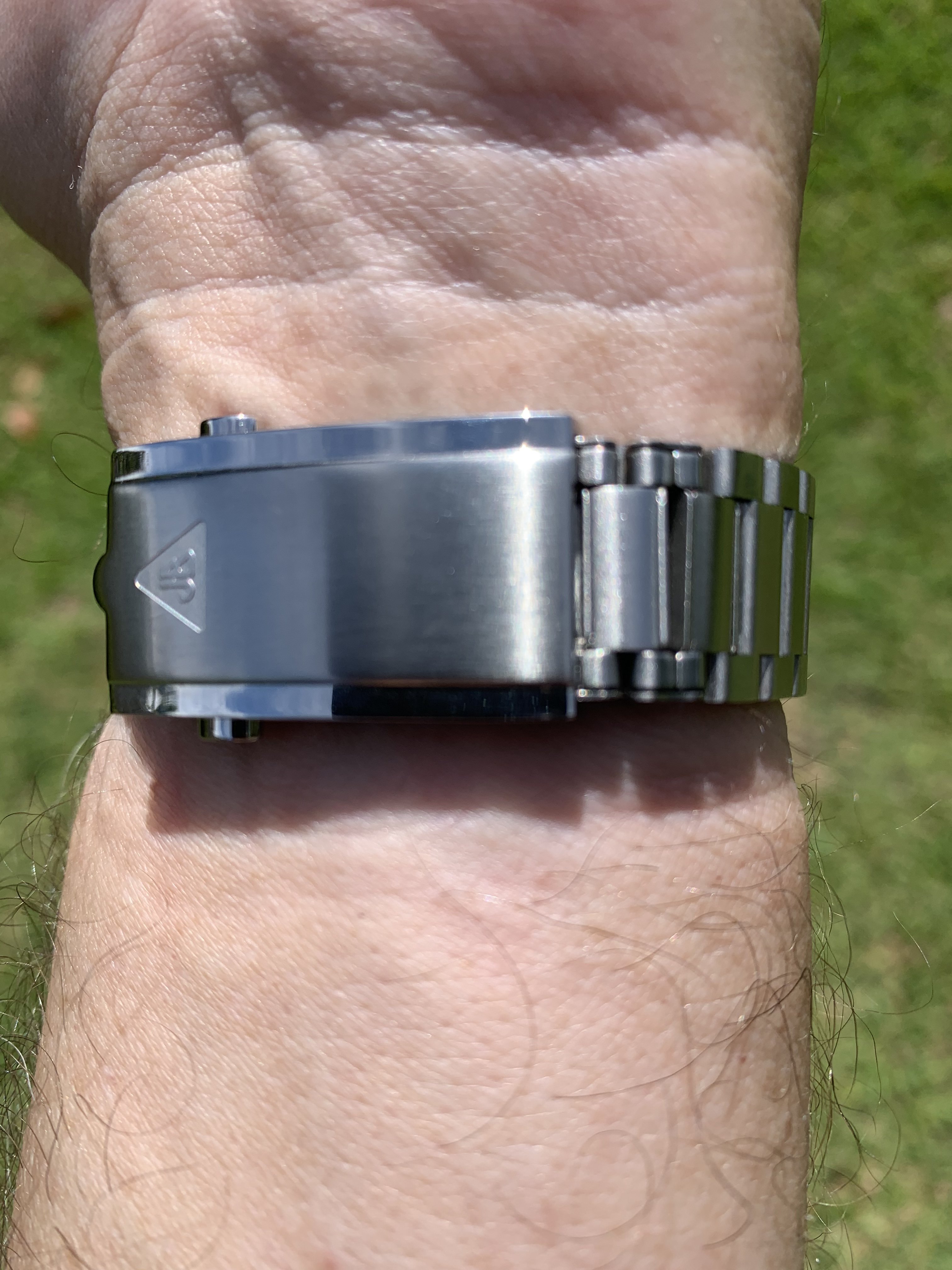

There's someone from Canada that sells "vintage genuine" Omega clasp covers that fit this 16mm clasp if you are interested. Using quotes because I can neither confirm nor deny that it's the real deal. But it's at least good quality and fits it perfectly -- I have one on mine and like it.

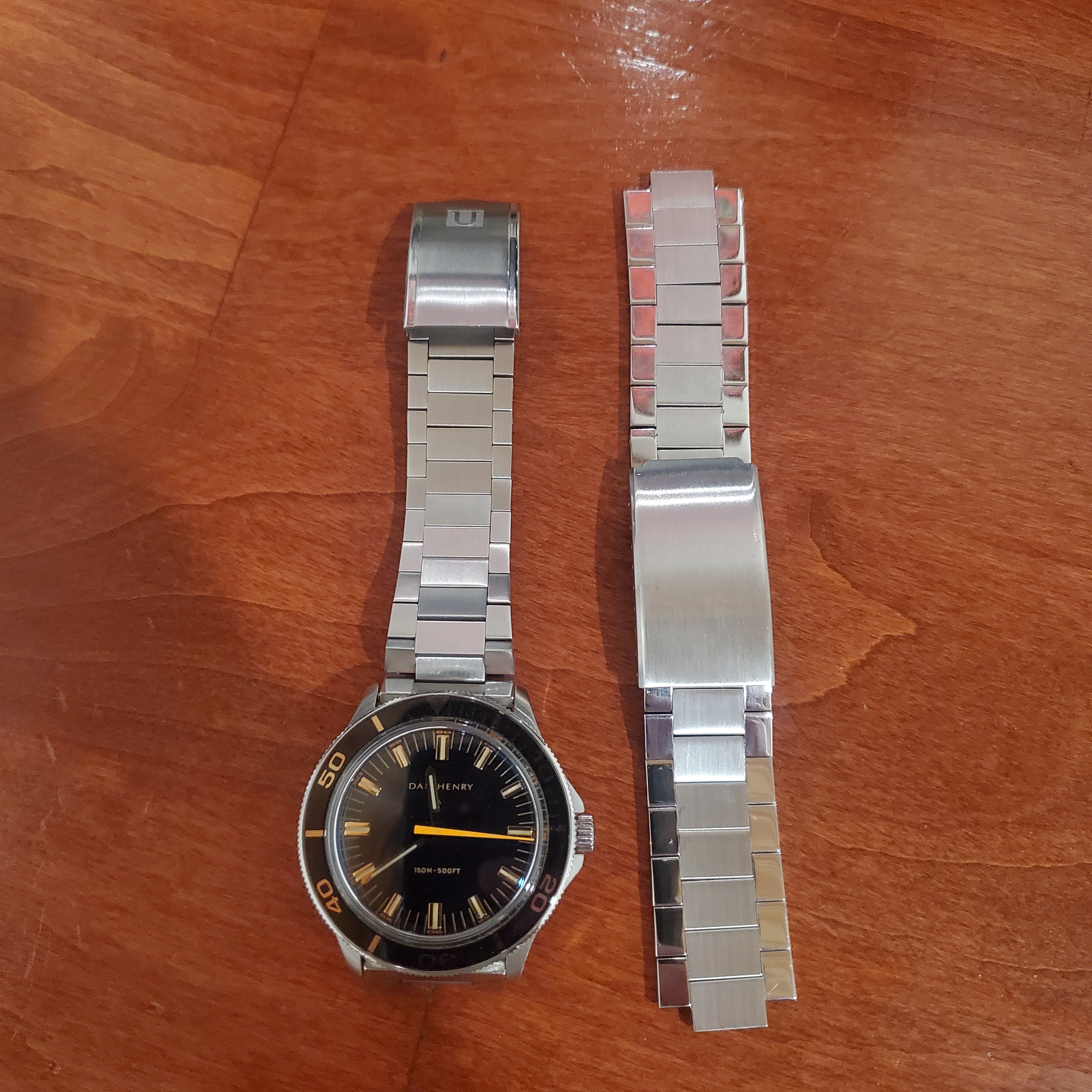

Allow me to add a few thoughts about a couple of even cheaper options I've tried out recently.

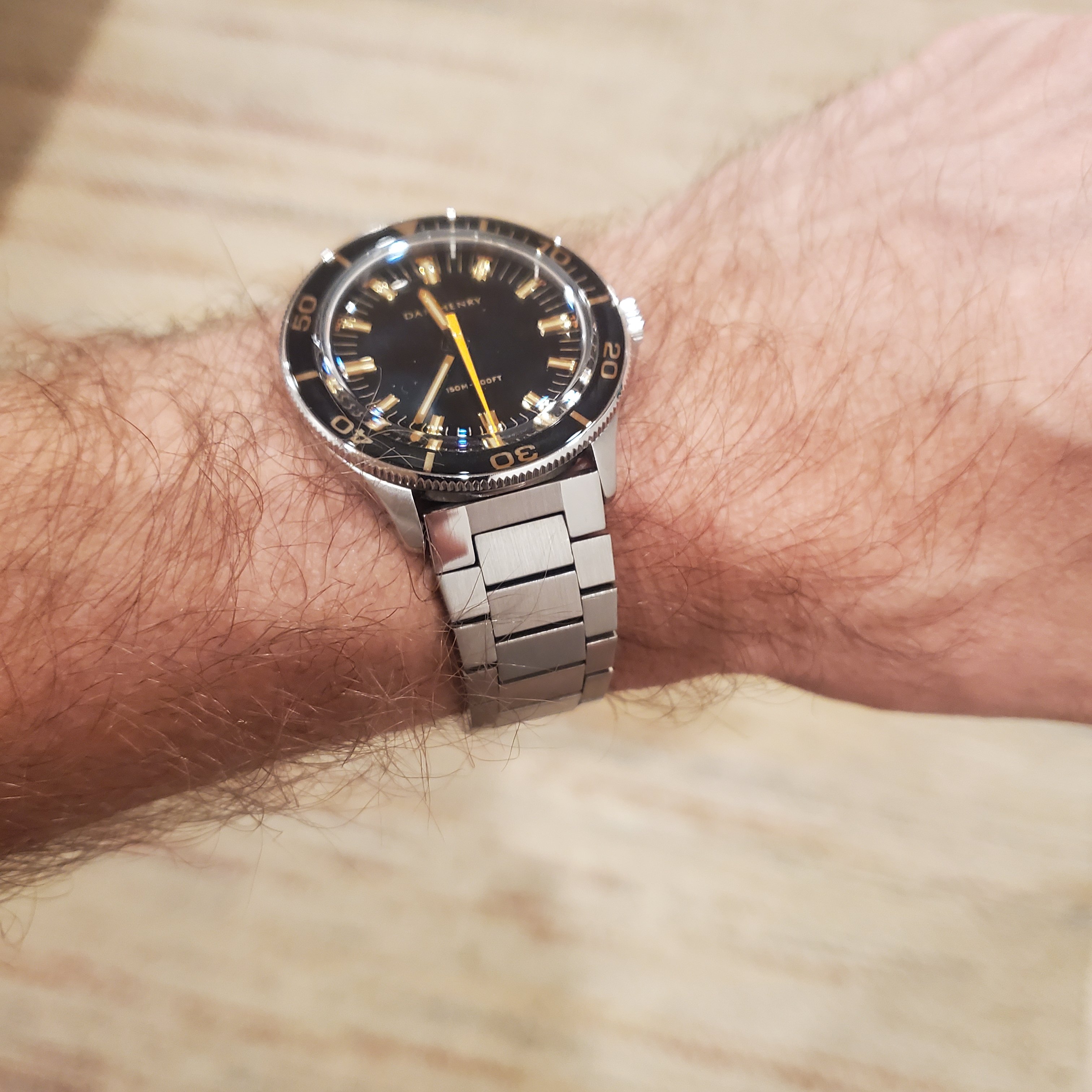

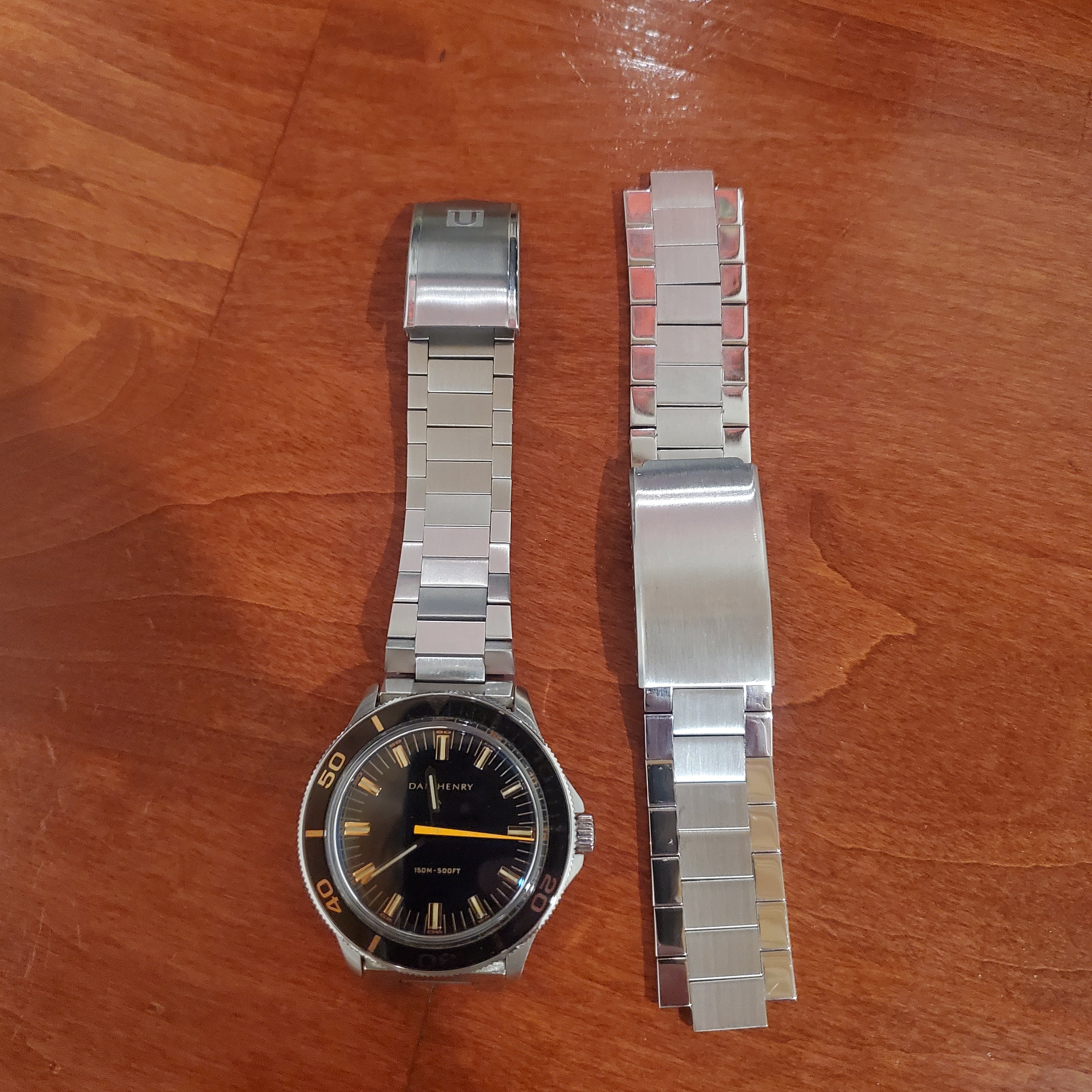

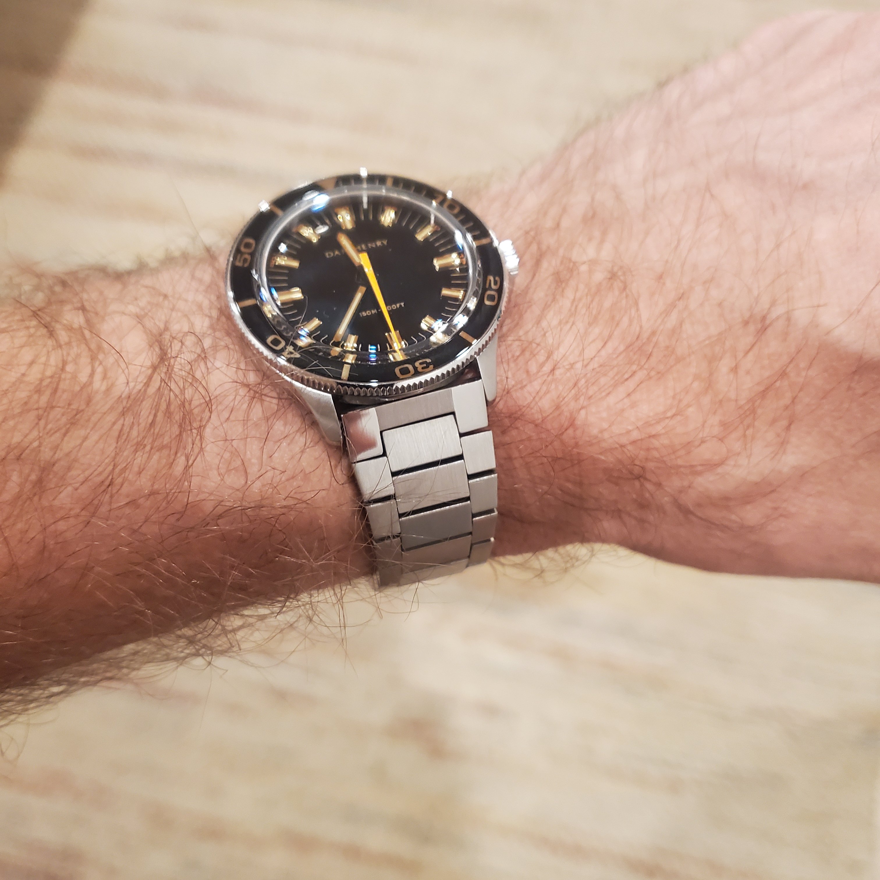

I recently bought a 19mm Uncle Seiko US1035 from eBay for a non-Omega (Dan Henry 1975) stupidly hoping I could make the endlinks work with some adjustment or creativity, but the lugs are way too short. So I tried a couple of cheap flat link bracelets with straight end links.
First I tried one I found sold by StrapsCo (~$65). It was advertised as all brushed and tapering from 19mm to 16mm at the clasp, but the outer segments of the links were polished and the clasp was 18mm. Plus, when I just draped it over my wrist, it pulled my hair like crazy. I returned it, and I don't recommend it.
Then I saw some on AliExpress (~$35) that looked similar. The links were polished and the taper looked the same, but I figured I could live with it for the price. I bought one (actually from Etsy for $40, but I suspect it's the same product). It's okay, but I definitely got what I paid for. The brushed segments look great, but the polished segments have a few noticable dings. But it doesn't pull my hair at all. It's not a bad option for a cheap flat link bracelet with straight end links.
But the better news is the straight end links are removable, and they fit the Uncle Seiko bracelet pretty well. I still need to "brush" the polished segments to match, and I need thinner spring bars because the the lugs on my watch are so damn short that the straight end links still bind up a little, but I think that this scratches the flat link itch fairly well for now.

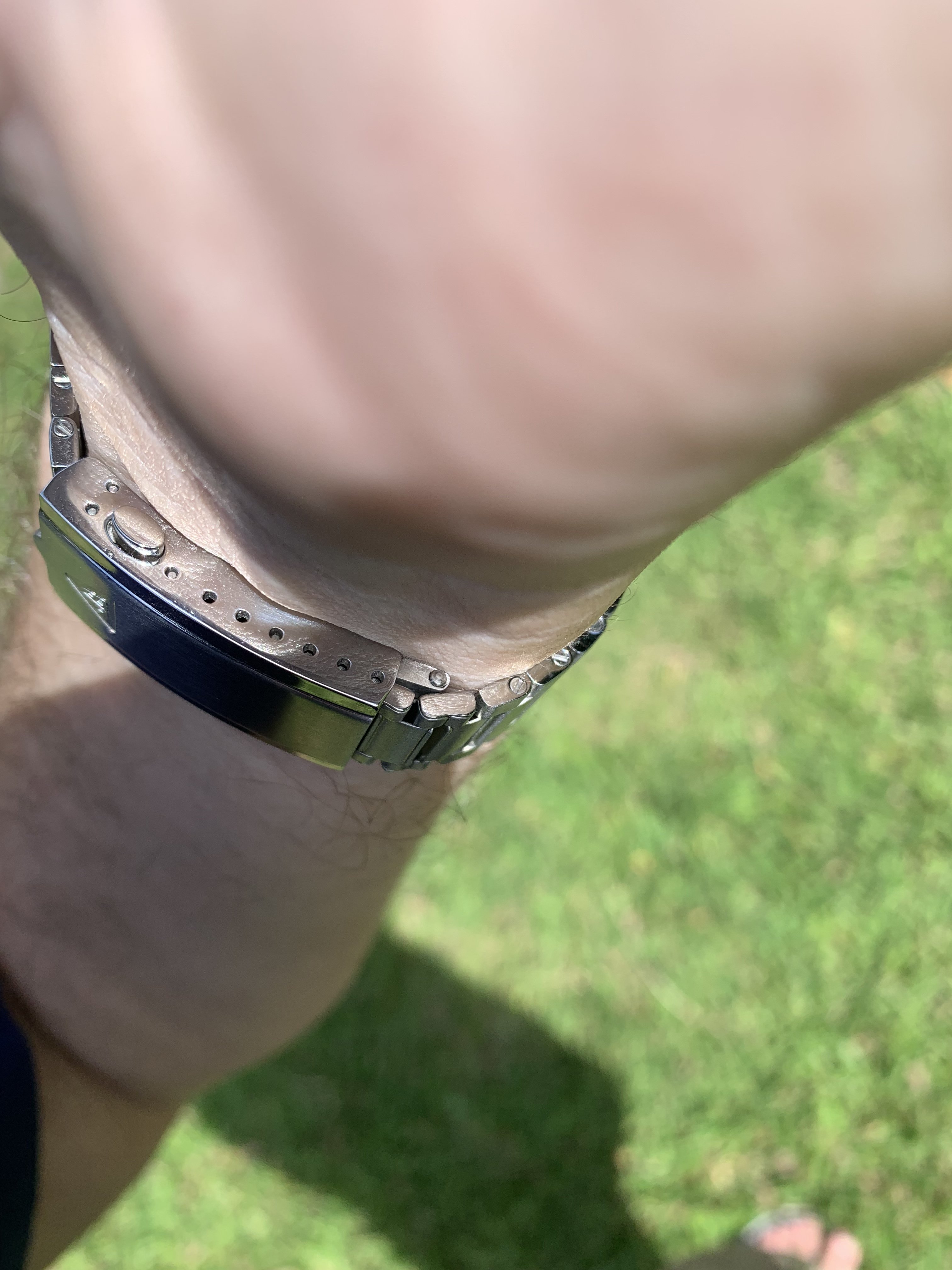

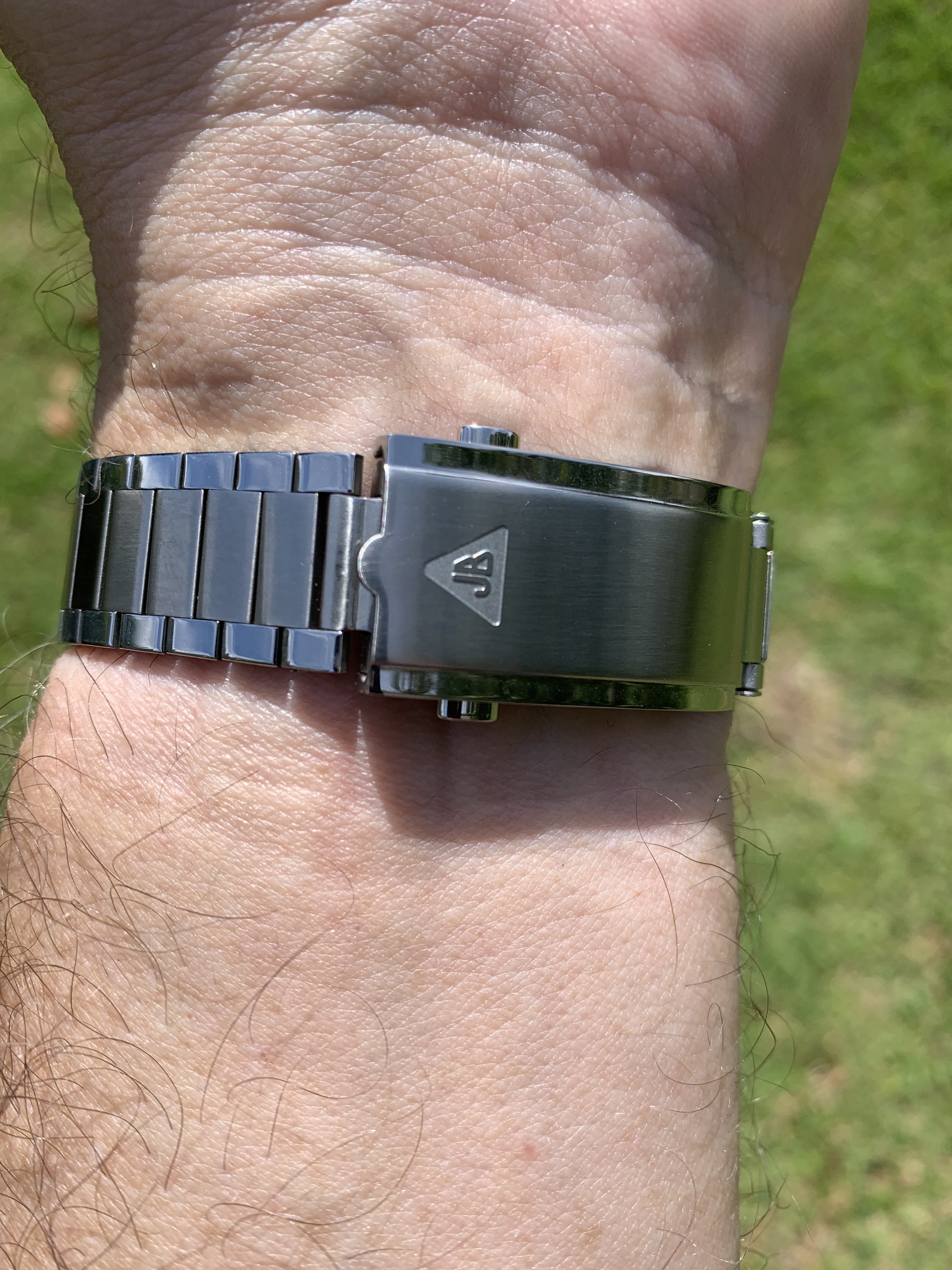

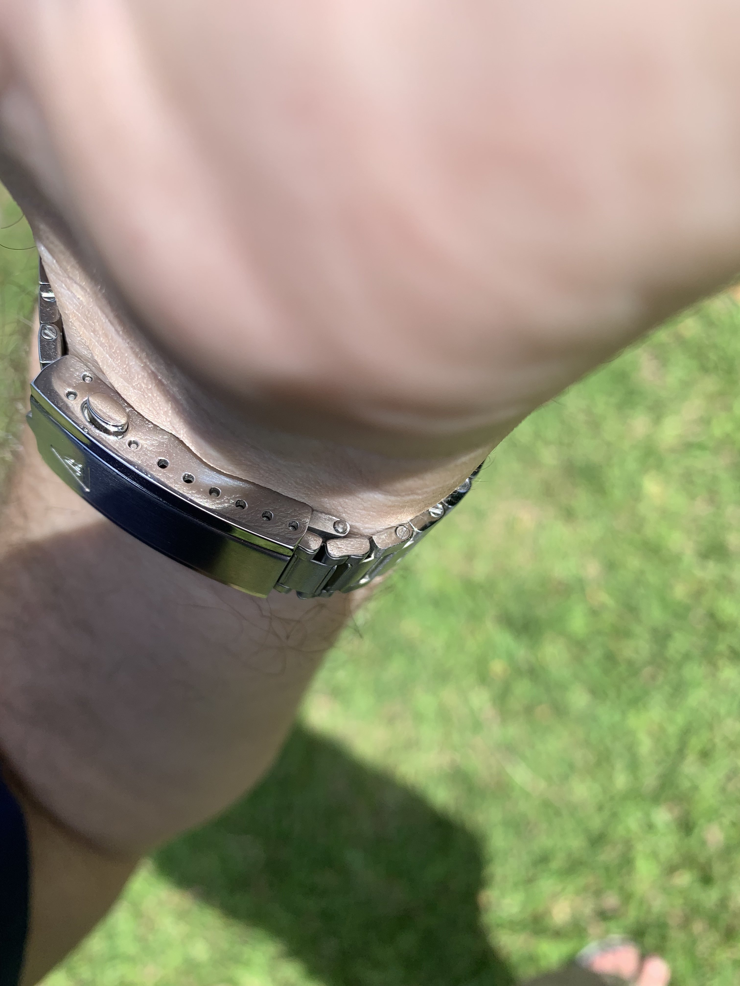

I put the Forstner on my FOIS but added the milled clasp to it. I don’t wear bracelets tight (I’m not using the stretchy links in Hawaii). I’ll see in a few months if I got the scratches like Doc. The guy at the Omega boutique says those types of scratches are common, even with OEM parts so it’s not worth waiting for a “safe” bracelet. The Forstner flat link with the aftermarket milked clasp is comfortable and secure (plus the clasp is shorter so it doesn’t slip to the side like the pressed clasp did).

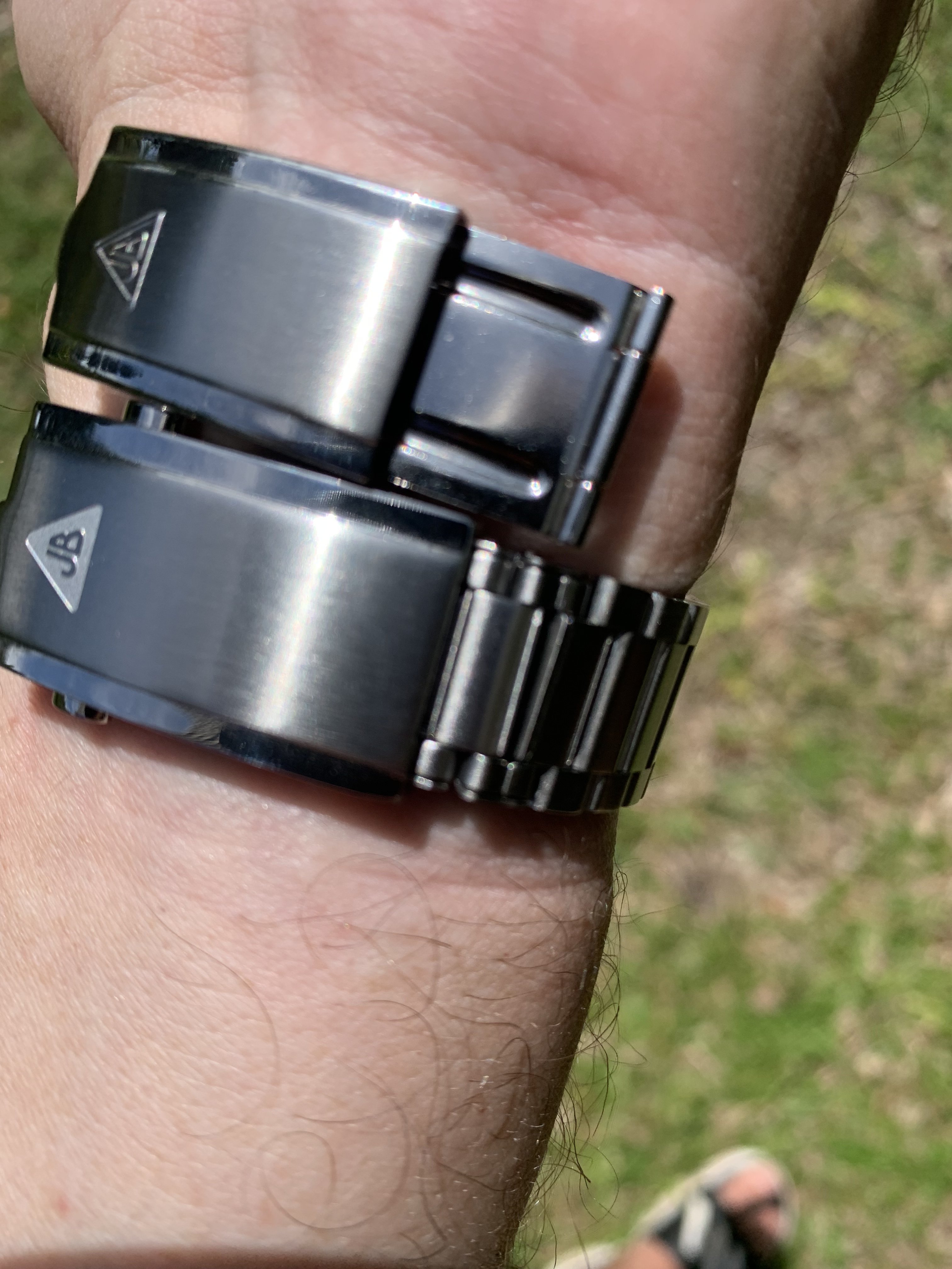

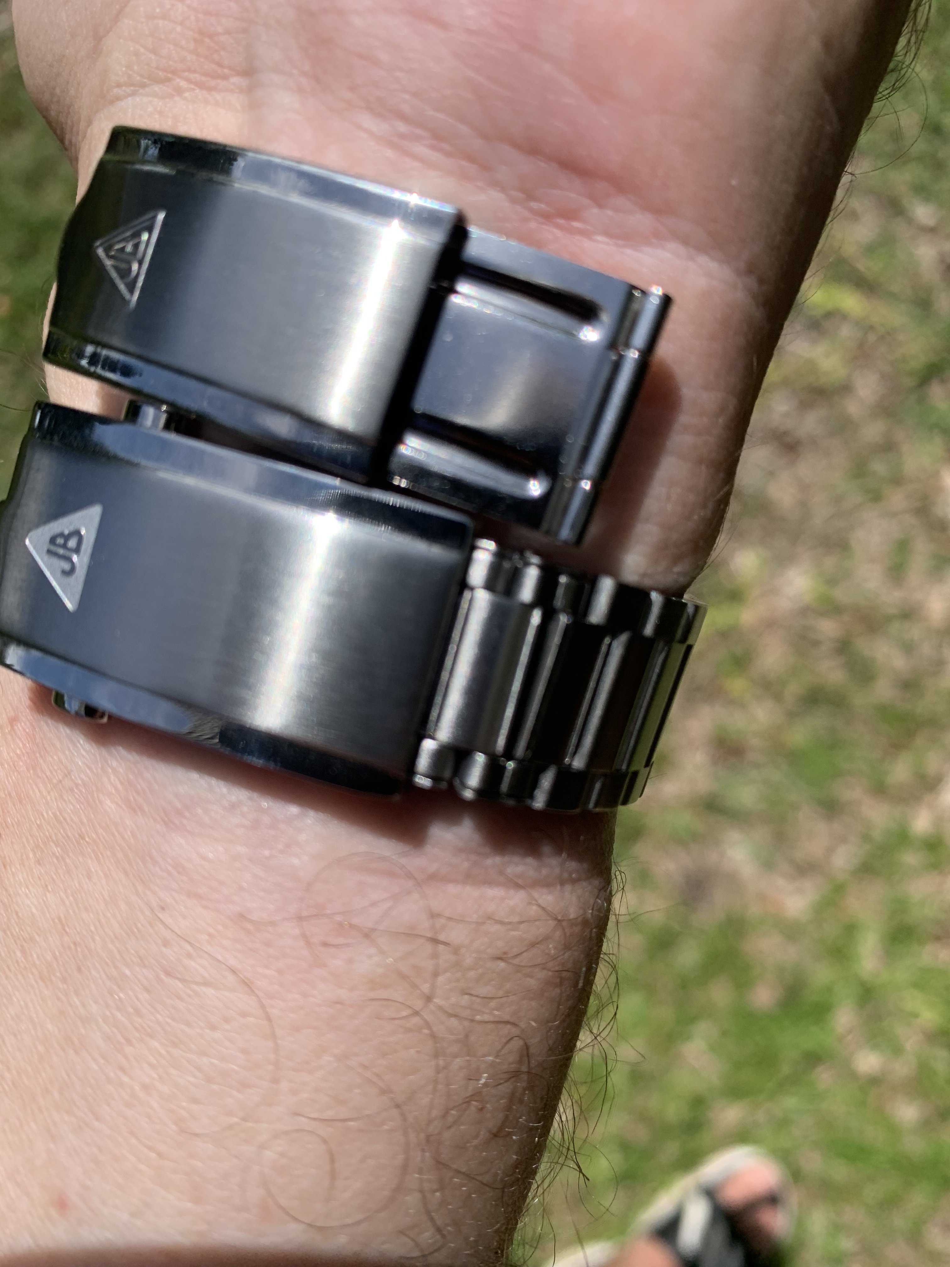

Do you mind posting a few pics to show how the milled clasp looks with the "classic" Forstner flat link? Thanks in advance.
62
27

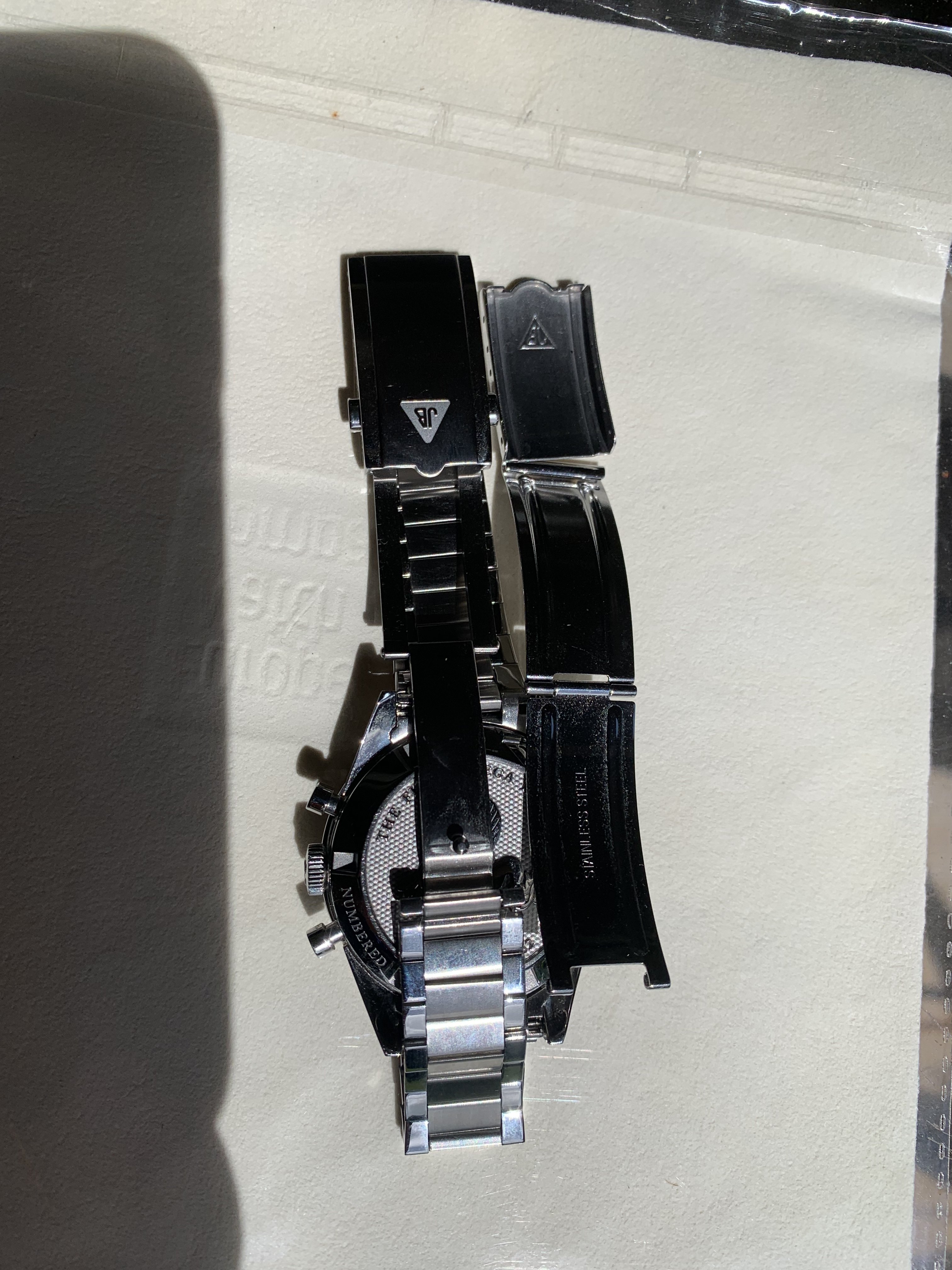

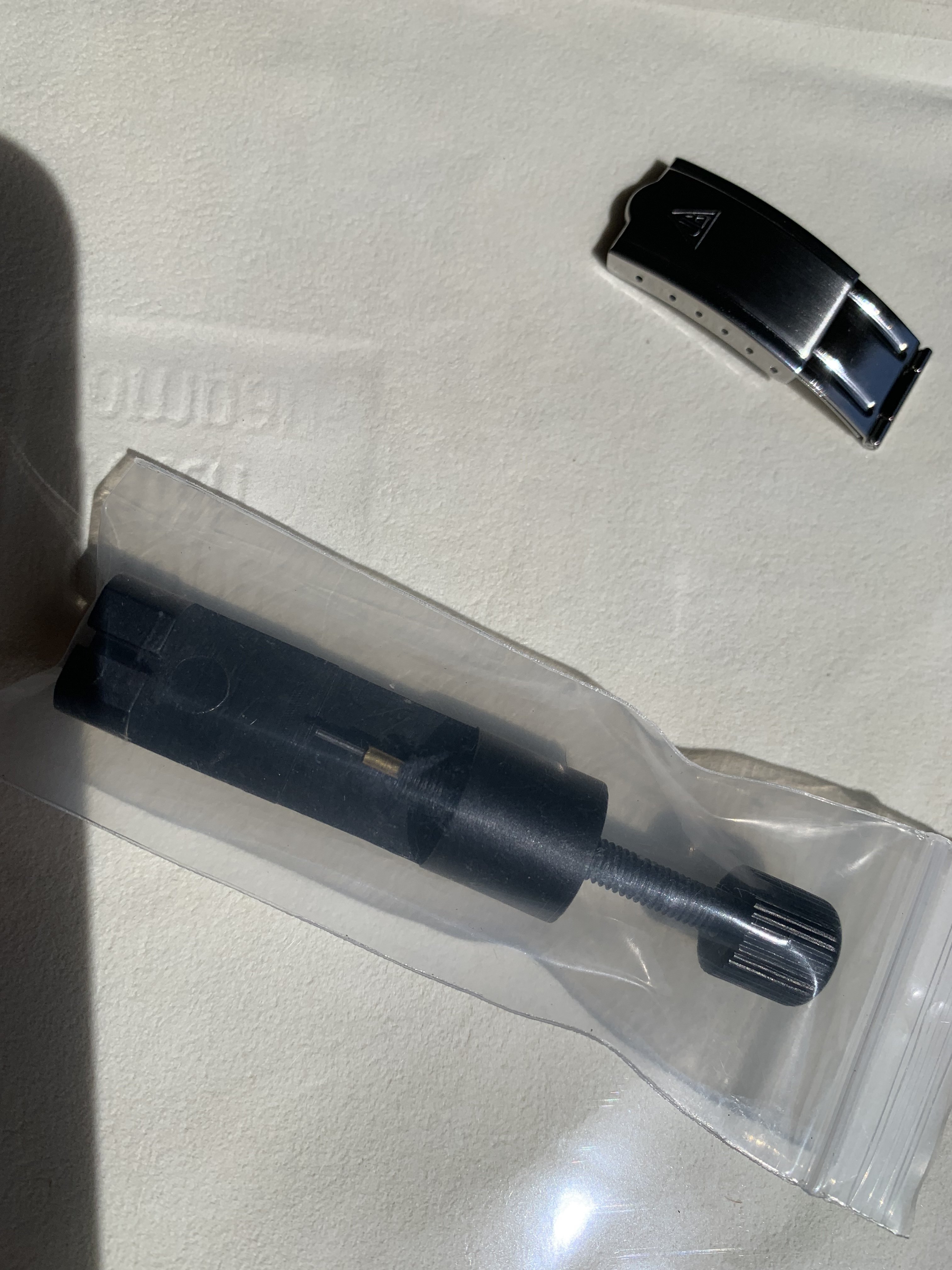

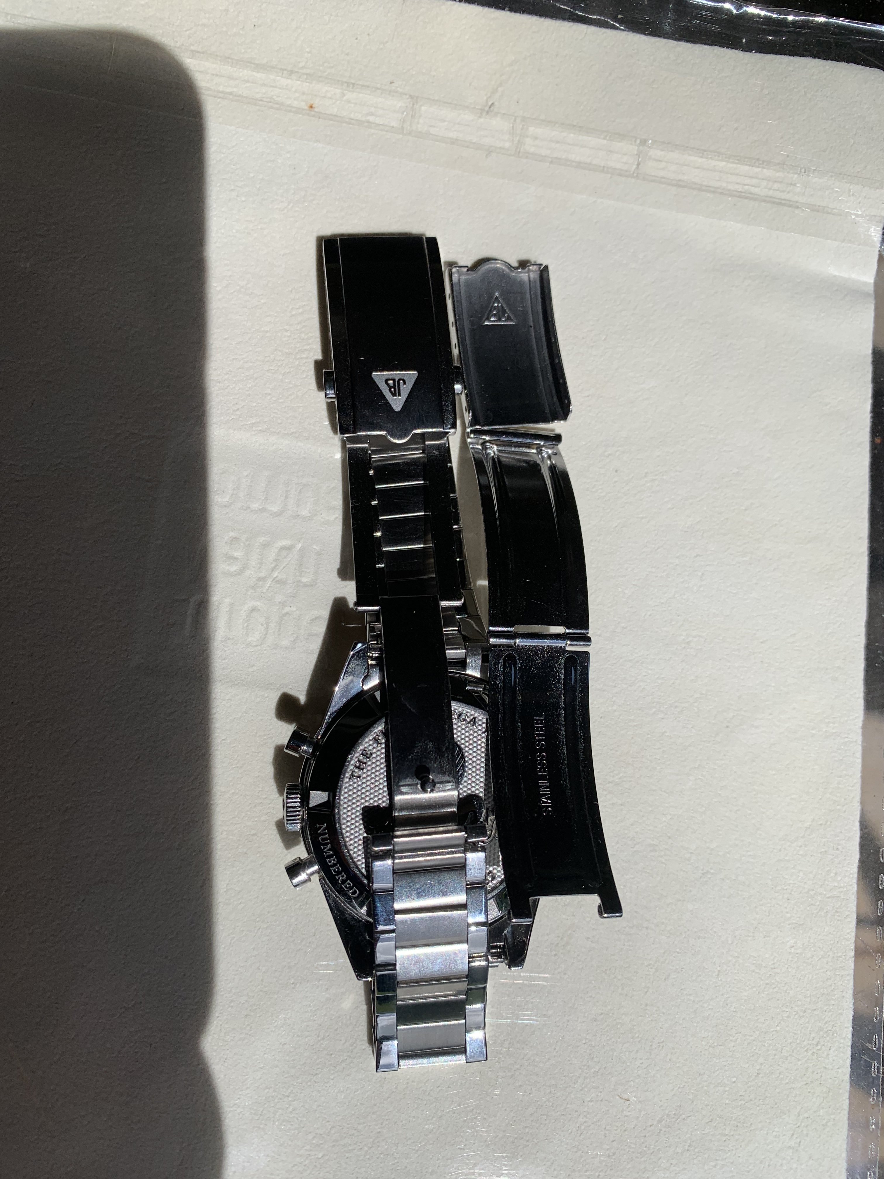

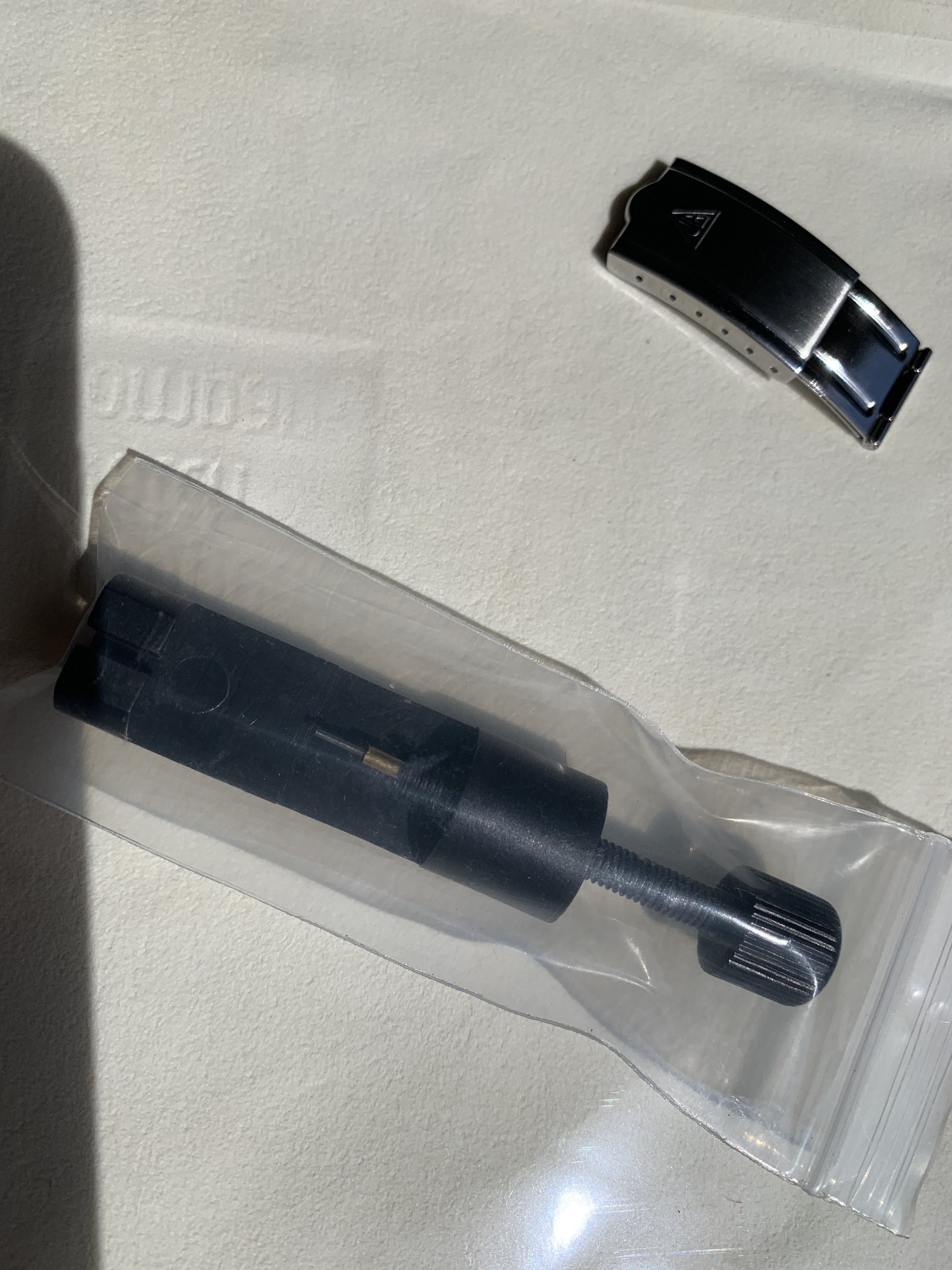

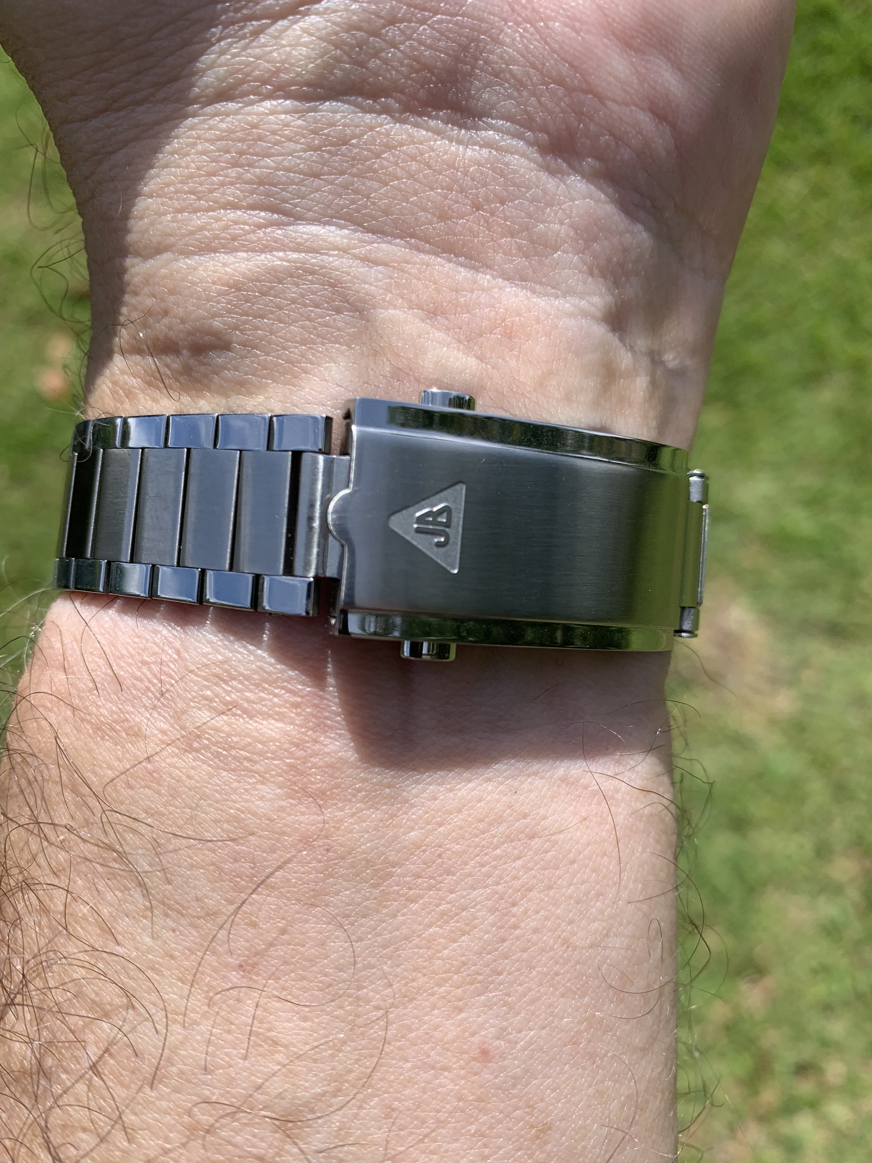

See attached. The hardest part is pushing the pin that holds the double pusher end of the clasp to the bracelet. They provide a pin pusher with the $75 milled clasp but it’s sort of a budget version. They also have a web page with instructions on how to do that part.
62
27
Forstner doesn’t supply that pin on the accessory milked clasp so you have to push it out of the pressed clasp (that’s why my old pressed clasp is in 2 pieces)

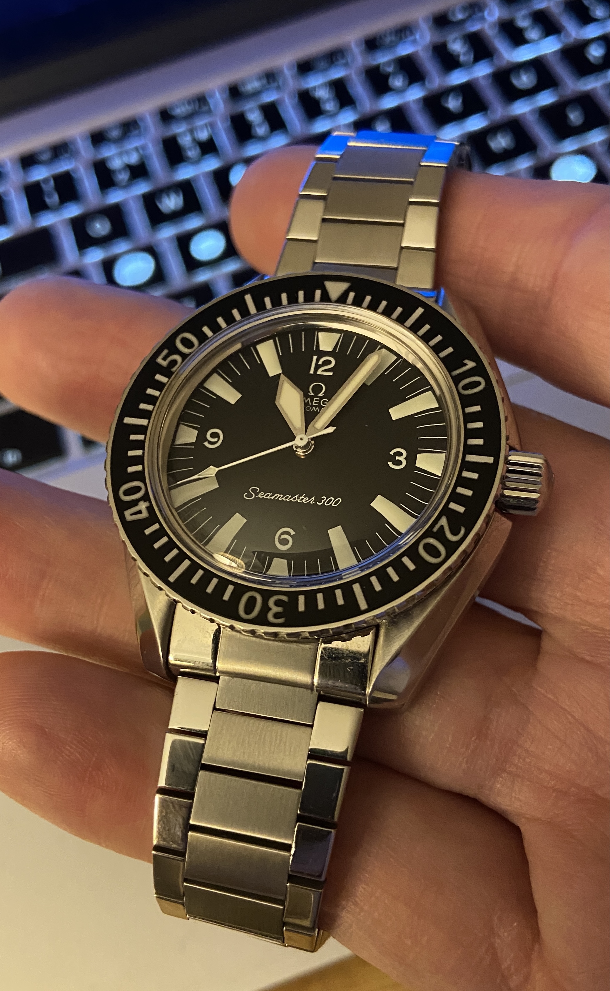

Uncle Seiko 20mm flat link on my ‘Watchco’ SM300. I thought it fitted pretty well.
Hi, Is this solid endlink?
