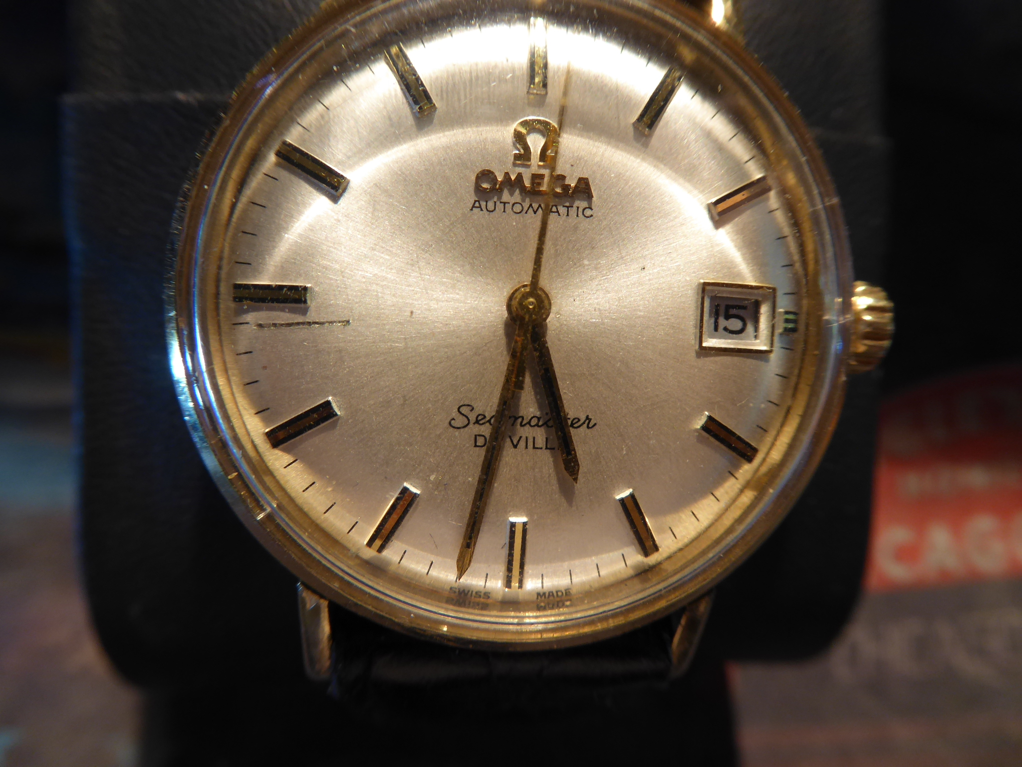

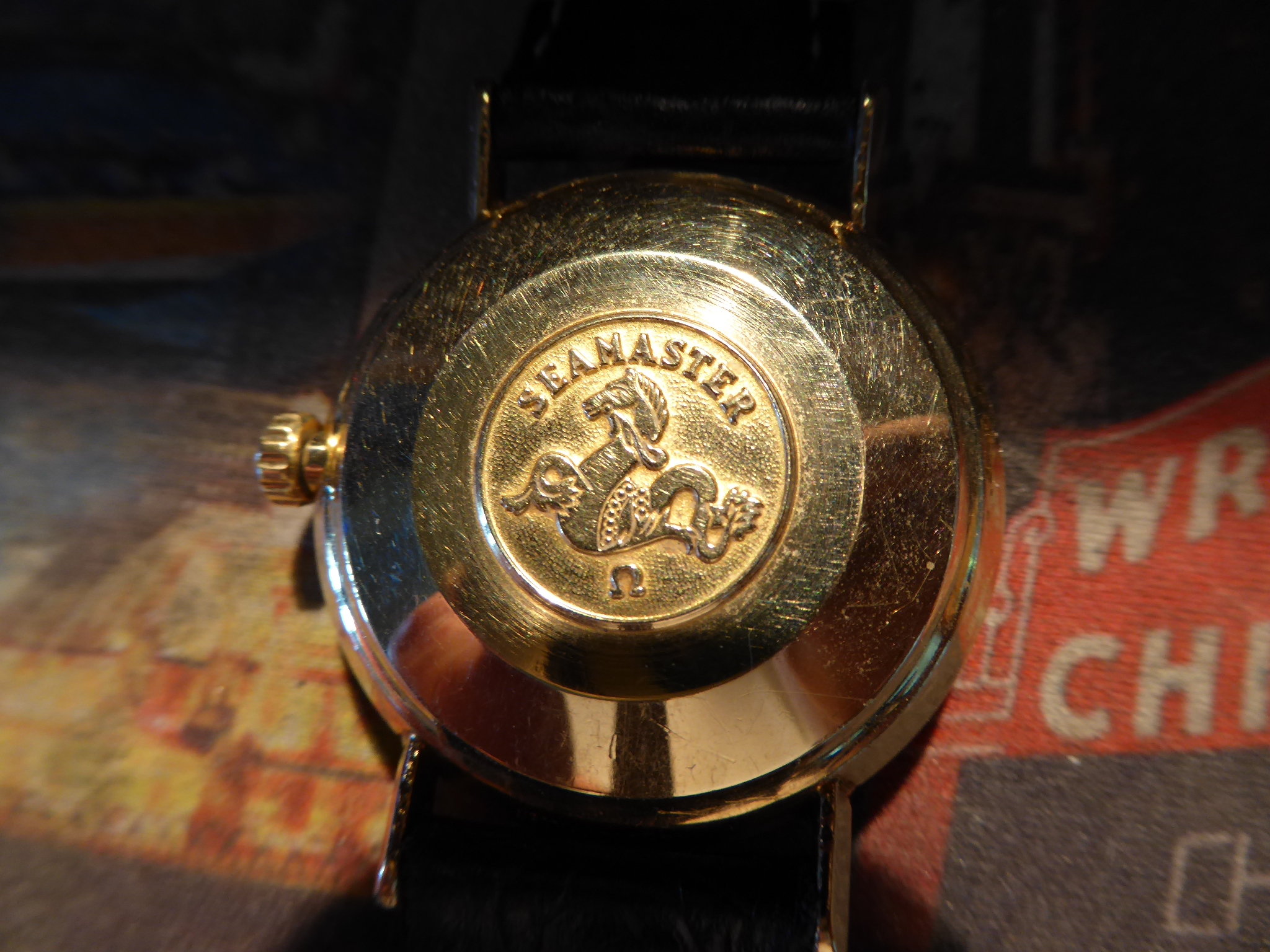

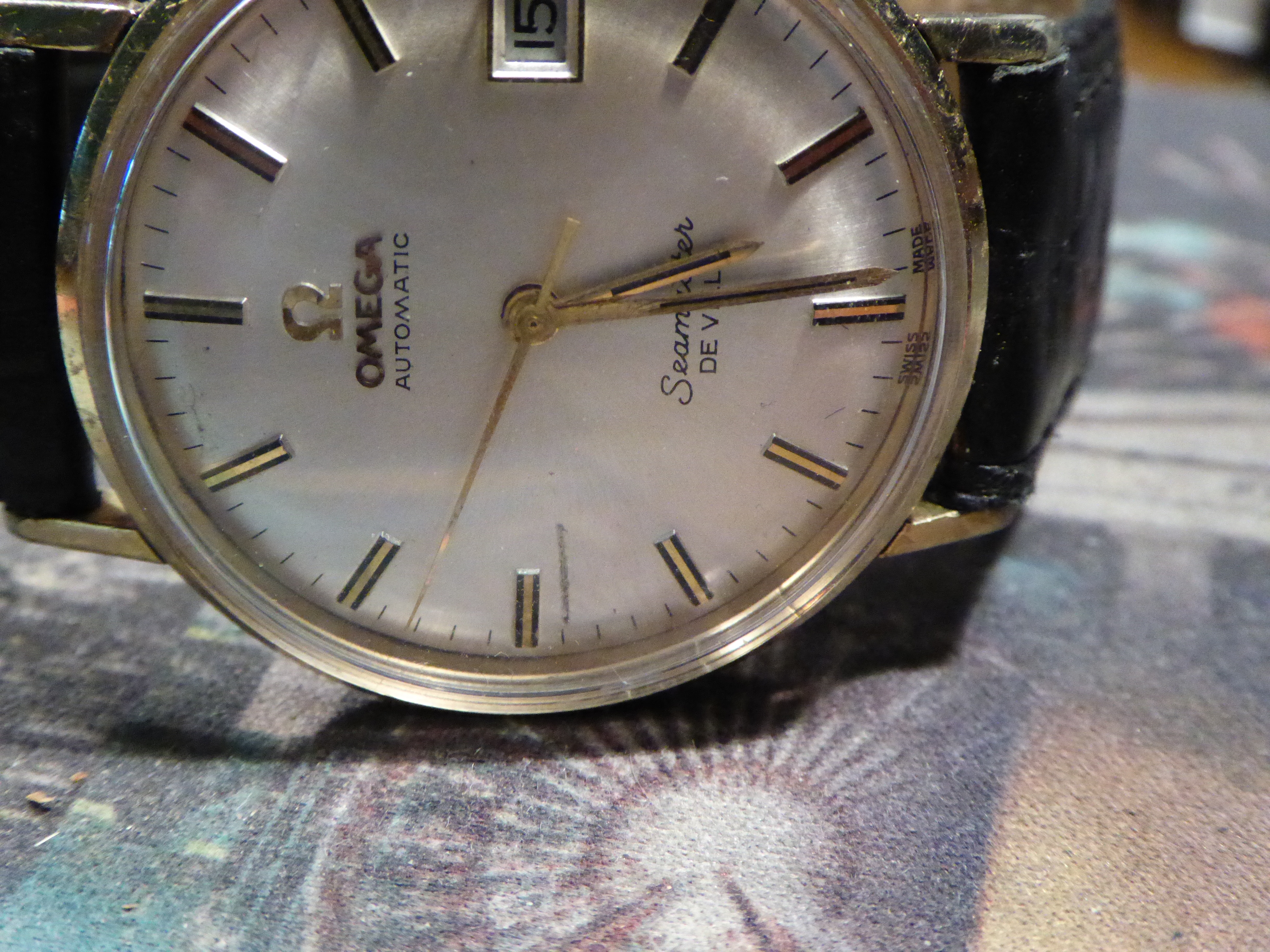

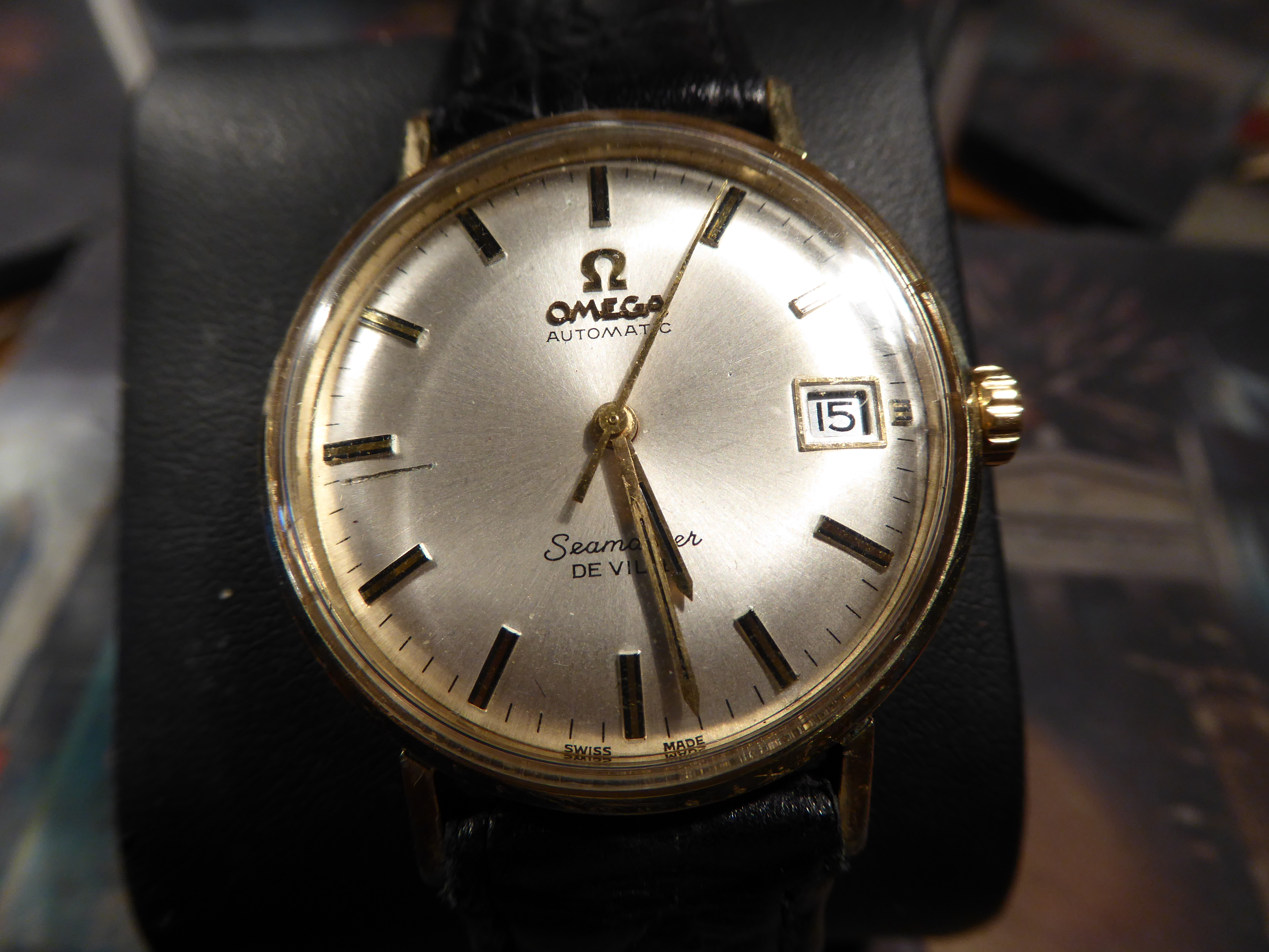

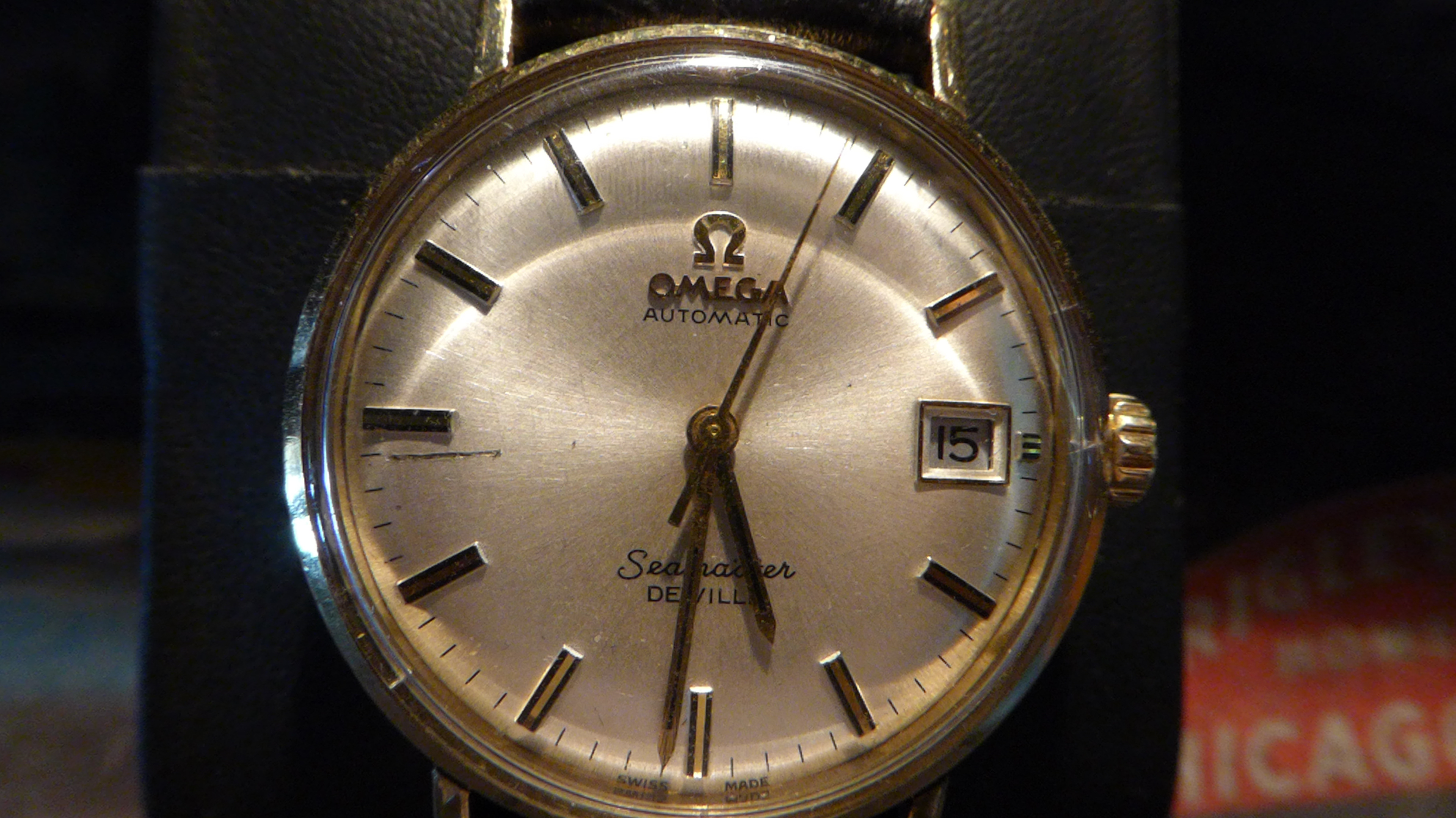

Omeg Seamaster DeVille mvt?
26
Hope someone can ID this for me,possible year and movement.As it opens thru the front I can't look into it.
Thank You
3,133
5,569
Seamaster de Villes were in production 1963-1967, movement either a 562 or the later 565. If the date can be changed by pulling out the crown and pushing it back in, it's a 565.
26
Thank you.
13,493
31,814
Don't forget the 17-jewel cal 560 and 563.
3,133
5,569
Good point, I had forgotten about the US market variants.
26
Thanks guys as it's not getting any wrist time I'm gonna put it up FS but need help in determing a fair price?
25
18
From my limited knowledge, with the cal. 565 dont try changing the date using the stem between 9 o'clock and 3 o'clock as the date changing mechanism can already be engaged. To prevent possible damage, It is best to adjust the time (i do 6 o'clock) and then pull the stem until the 2nd click.
