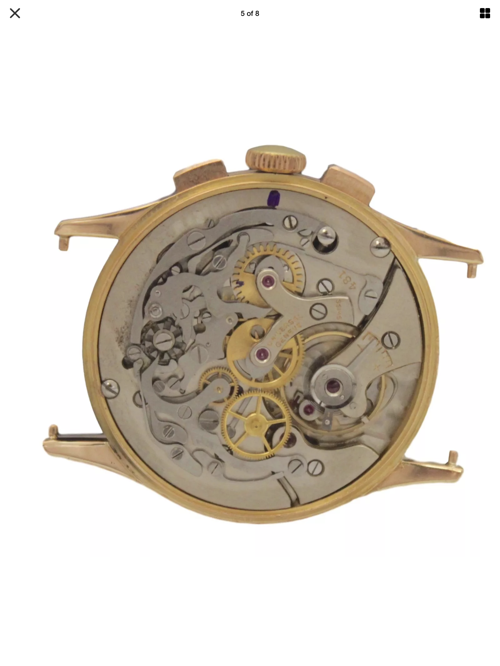

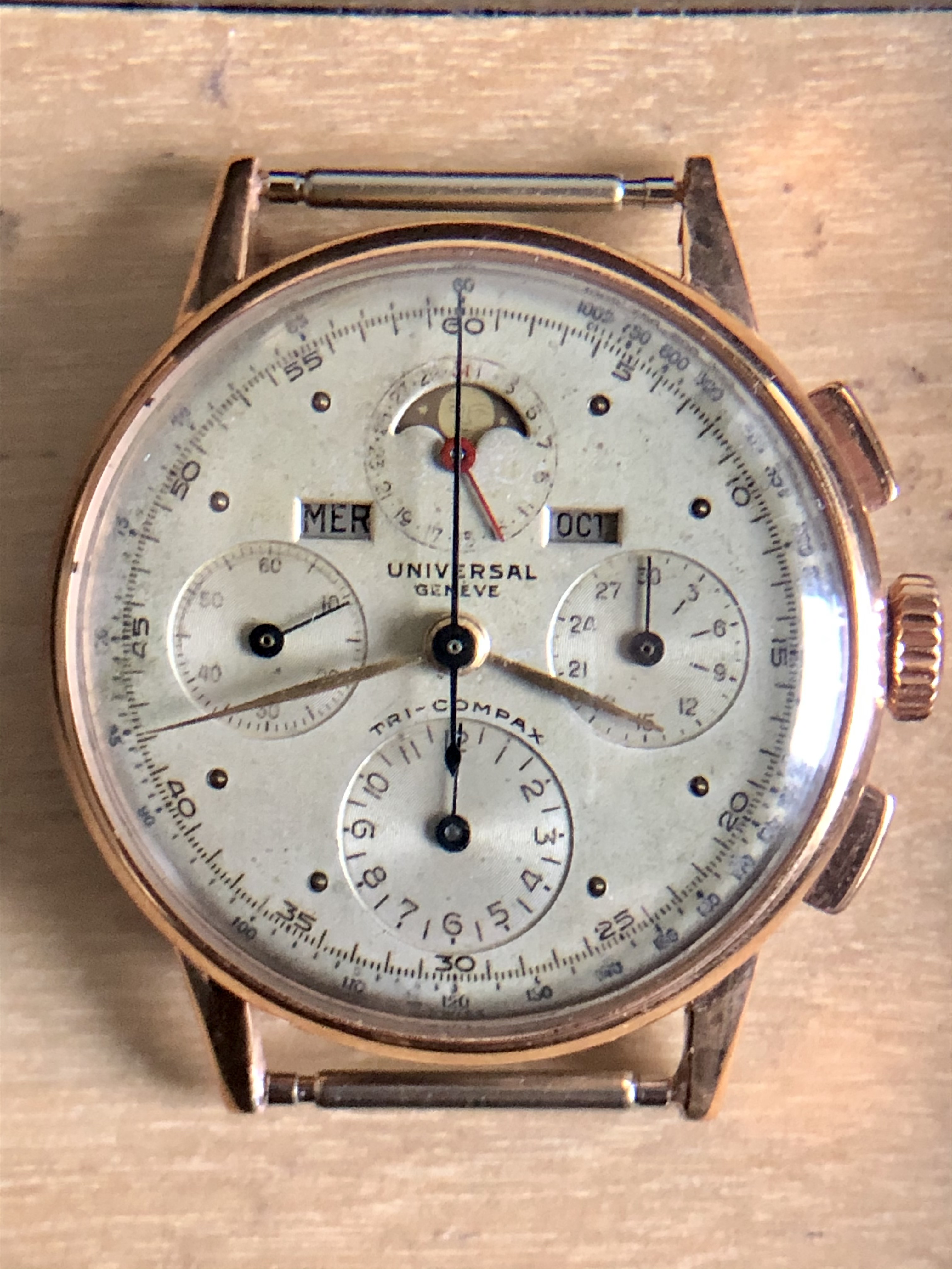

Might have to disagree on that point my friend. I’ve been loathe to change the (lovely) strap that came with my 1940s rose gold 12266 for exactly that reason....fixed posts for female springbar as, as shown on these pics that came from the dealer when I first acquired it a few years ago. 😗
I think you may have misunderstood Ben's comment, since you are actually agreeing with him.
13,624
18,978
I have only seen male lugs like that with precious metal cases, so my conclusion is that with the proper spring bars, this set up might be more secure than drilled lugs.
Oh holy cow. That's a big flex...
I'm a bit embarrassed by my mucky example compared to this beauty contest winner. Very nice example, congrats.
Sorry that I misread/misunderstood the reference to fixed springbars (as opposed to female springbars) in your comment - I would agree that I’ve never seen a fixed springbar Tri either.
