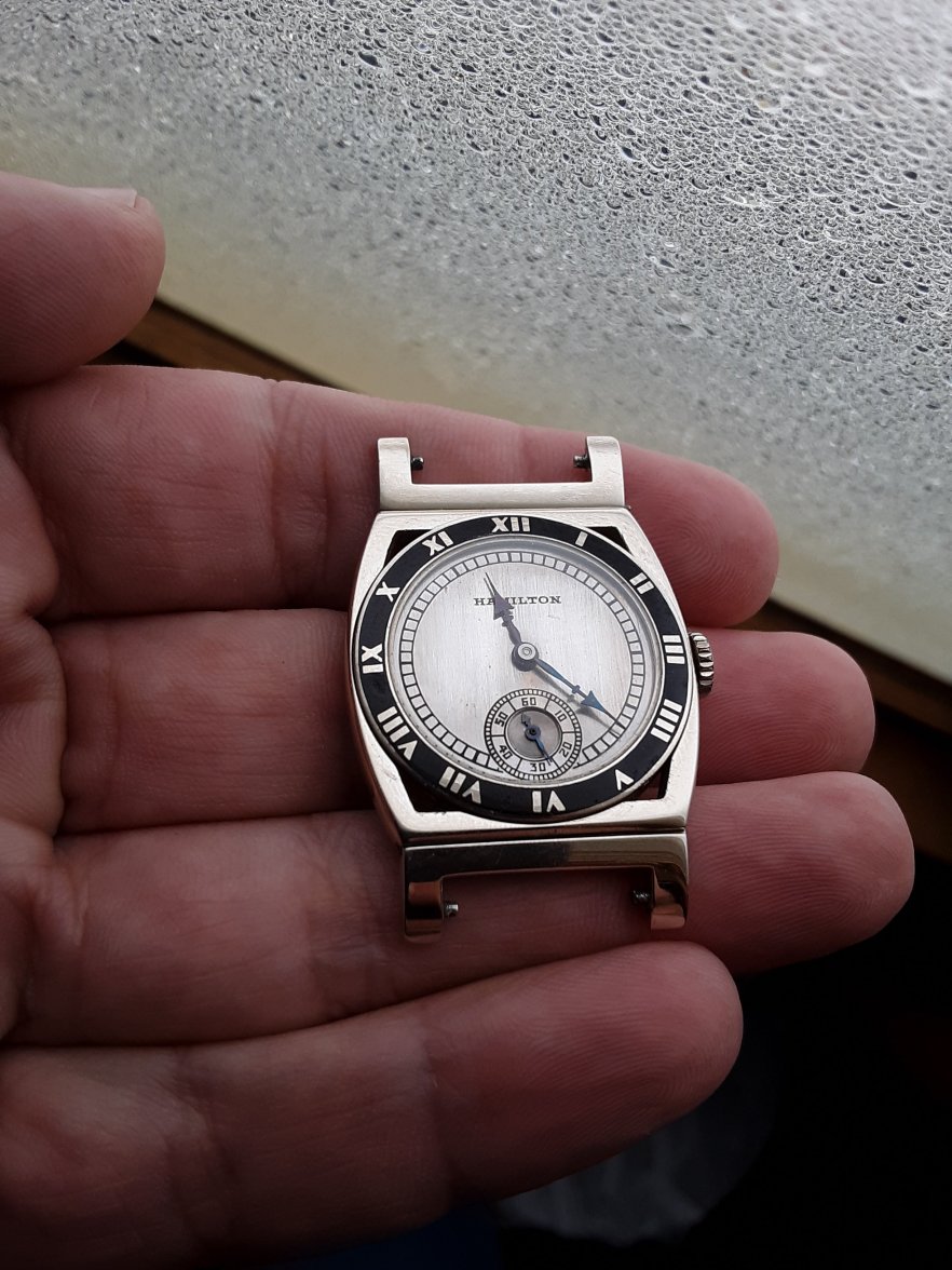

Hey everybody, after recently picking up a nice little Hamilton Piping Rock I have found that acquiring new spring bars for it isn't all that straight forward. Does anyone have a good source for these old fashioned female spring bars? Here is your gratuitous photo.
2,327
2,542
These are available on Ebay but after you first posted about your Piping rock I googled a site with an article on restoring several Piping rock watches and they mentioned not being able to find an exact match and having to bore out the ends of a new pair to make them fit the studs in the Piping Rock lugs.
http://www.hamiltonchronicles.com/2014/05/1928-piping-rock-overhaul.html
Might require some searching to find these in the right size.

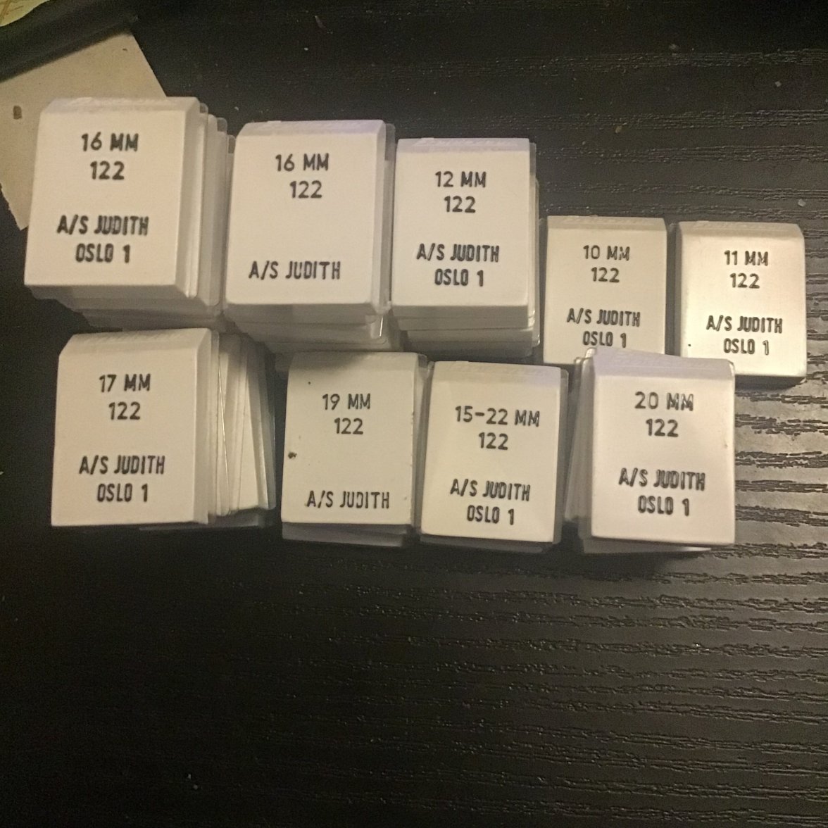

I have NOS female springbars in many sizes. Let me know if you strike out. Located in Scandinavia.

I have purchased them from eBay, but as noted above, they are a different style than were used at the time (which had large diameter flanged sections at the ends) and the inner diameter of modern bars is not always large enough.
1,241
3,840
Same issue as @Dan S
The ones I purchased has too small a diameter on the part that goes over the lug pin. Getting some with larger pin holes is on my never ending to-do-list
1,542
3,355
Cut the nibs, drill out the lugs, use male spring bars.
