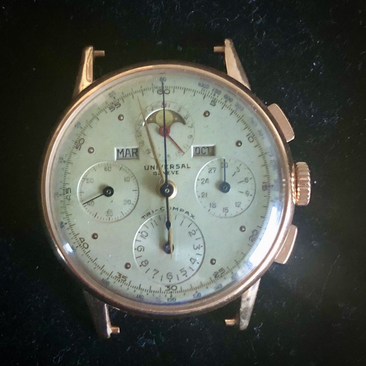

I have been trying to find said bars for weeks. Nay, months.
I once got gouged for a grubby, used, pair on the Bay by a bloodsucker. I vowed never again...
So I bought some from Cousins UK (Female Swiss Spring Bar Ø1.8mm x 18mm, 10pcs). I was optimistic and after the hellaciously slow shipping, quite excited for their arrival...
It turns out the diameter of the case pin exceeds that of the hole in the bar! DOH! As if these little buggers weren't hard enough to fit even if the size is right! No wonder UG collectors are looked upon as the autistic savants of the WIS world, with their crazy female spring bars!
Would anybody be willing to swap a virgin bag of 10pcs for a single, solitary set for my Tri-Compax?

I suspect that case started out with fixed lugs and someone cut it.
You could have the lugs drilled, I suppose.
I'd hate to vandalize it just to get a strap on it...

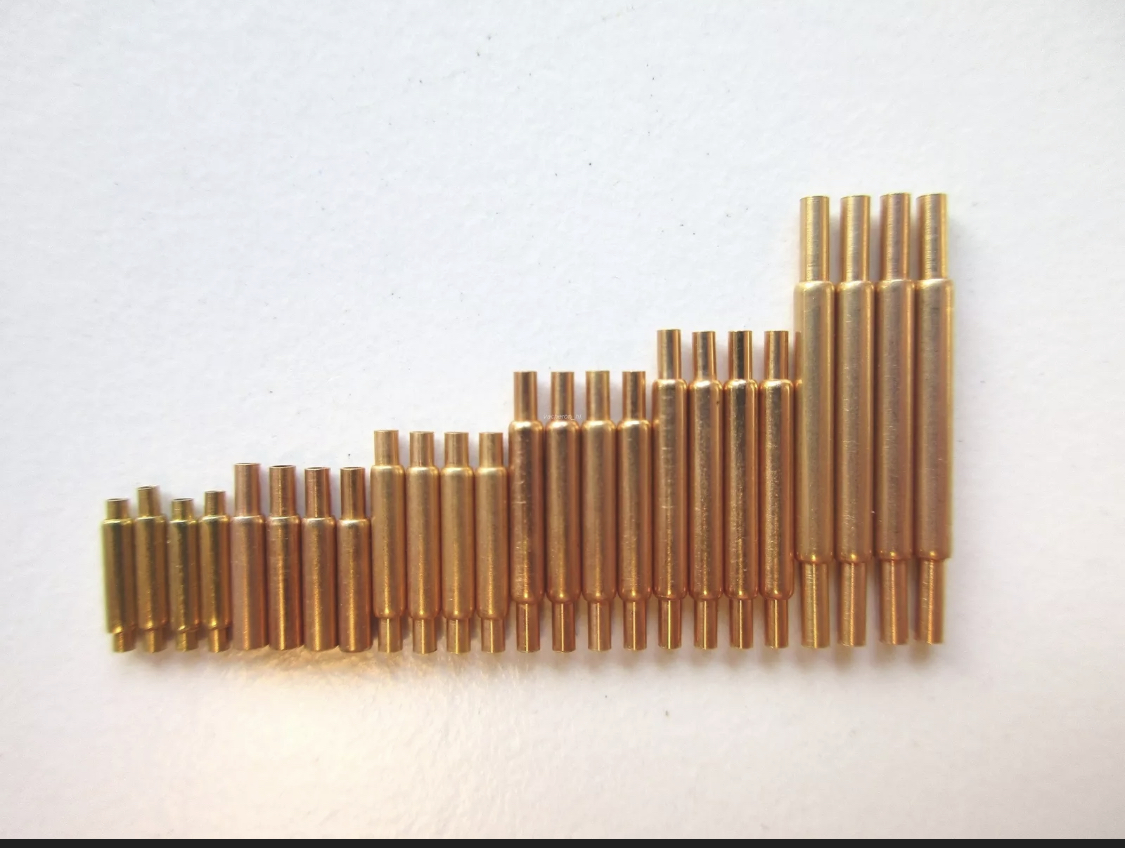

What is the diameter of the case pin? Some 18mm female spring bars with a 0.95mm hollow end diameter are here, if this helps: http://www.ofrei.com/page1466.html
Thanks. I'll get out the Verniers later and check...
It looks like I have to buy a minimum order of 15pcs (!). I'll give it a go if nobody here has any they'd be willing to swap with me 😀

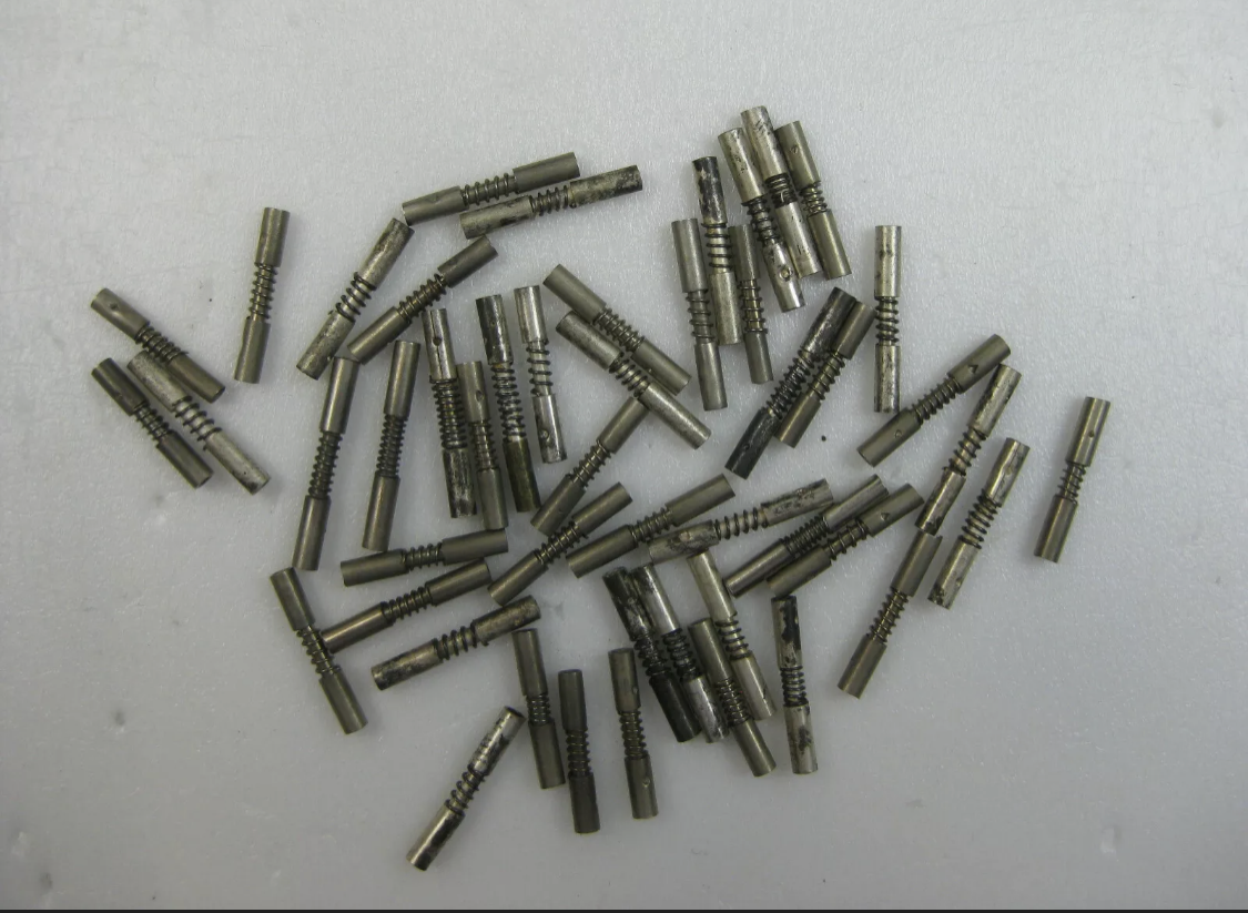

This issue is quite common on these pieces. In the old days, they made female spring-bars with flanged ends. Unfortunately, I don't have any. They look like this
https://www.ebay.com/itm/FEMALE-SPR...ge-Watches-16mm18mm19mm20mm-NOS-/192873003722

Or have a goldsmith restore the fixed lugs?
Have you seen this reference with fixed lugs? 😕
There are pics online that look close. Not my watch, not up to me to do the research.

Mine has the same case. Same lugs. Bought my female spring bars from Jules Borel in KC. Worked the first time. Sorry about the struggles.
And yet you comment - multiple times - as though you know lugs were originally fixed, hence my curiosity.

Looks like these are too small too. I’m contending with 1.3mm pins...
The ones I linked have a 1.2mm I.D. unfortunately.
