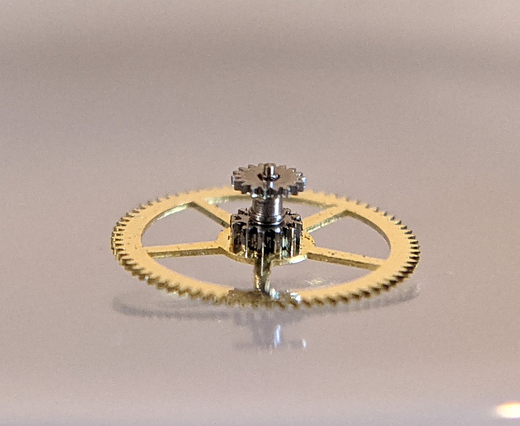

Offset Cannon Pinion - Any tips on how to remove?
348
1,180

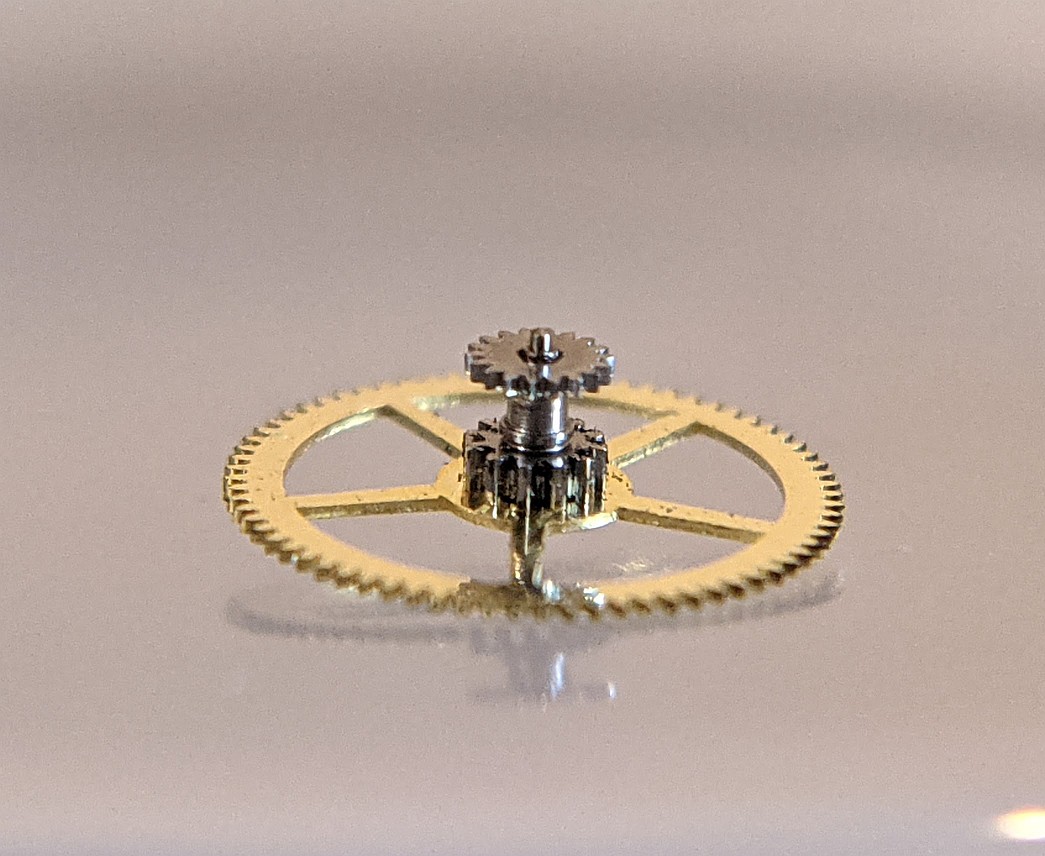

This is from a Hamilton 628, but also see these on some of the 1960's era Zodiac movements I like to work on.
A canon pinion removal tool or a hands remover works well if there is a nice solid mainplate to push against. But, wouldn't want to try that pushing against the brass second wheel for this application.
Would feel confident in pushing against the steel wheel pinion, but I don't think I have anything (intended or improvised) that's both small enough to gain purchase & large enough to push back up evenly against the canon pinion.
What clever tricks do other folks use?

Tweezers on top of the wheel pinion, and then use a Presto style hand puller to grip and remove the cannon pinion.

How about clean the wheel with the pinion in place on the arbor, and lube it after it is cleaned, rinsed, and dried? A solution for getting the pinion off. Two pairs of stout tweezers placed 180° apart, between the pinion, and the cannon pinion? Then “wedge” the pinion off, but don’t let it fly when it comes off.
Thanks! I'll try this with a pair of fine tip tweezers & see if it wants to come off for me.
