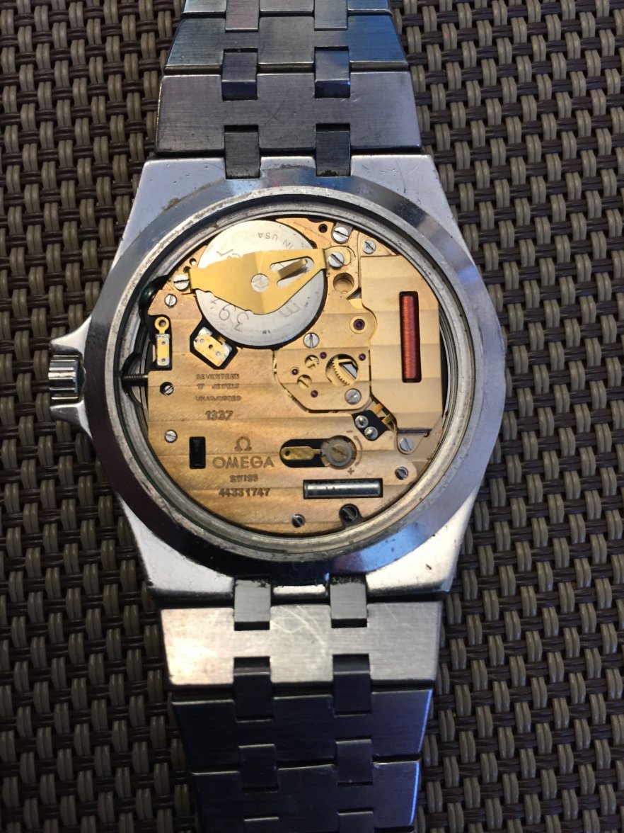

Assuming you get it going, don't consider it waterproof. They're a press on caseback and if the crown is the same set up as my 1337, it's not likely to keep water out anymore.
Once you pop a new battery in (loosen the screw furthest from the crown a little and slide the battery strap away from the screw) you might need to press the setting button at 2 - I've played with several of these movements and sometimes they haven't started after a battery change until you advance the second hand with the pusher.
You see a lot of these on eBay sold as not working and the circuit seems to be the common issue. If yours won't run then buying a donor 1332 watch might be necessary. The only difference is that the 1337 circuit has an end of battery life indicator, while the 1332 doesn't.
Here's mine, which I stripped down and serviced myself - rather a tricky job for an amateur like me.
