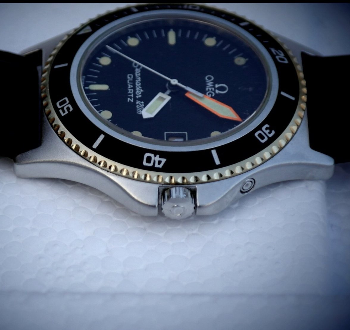

    Hi fellow forum members,
    I am not at alla familiar with old Omega Analogue Quartz watches and movements. I dont know why but all of a sudden i recently got a little interested in buying a Seamaster 120M Quartz. Never have been interested in these at all before. But now to the point, i have found one for sale and i need advice and help in what to do. The watch looks like it is NOS on the outside and that is a big plus, the sticker on the case back is still there. The big minus is that the seller thinks that the original battery is still fitted and and from the pictures i have seen it looks like it has leaked at some point. It can be seen on the dial, the calendar wheel and a little on the hour hand. The seller says he does not know if it works and sells it as it is. Im 99% sure the battery acid has destroyed the movement. He asks 340€ for the piece. Is it possible or even worth to fix it? Should i buy the watch? BEFD5DCD-C264-4C13-BA40-9CCE806AF774.jpeg BA9195D8-8C7B-4894-982D-DB5AEF1520A9.jpeg 9324CF23-B815-421B-82AD-50DA1C48FC72.jpeg

    So the movement doesn't work?
    Well with that dial damage, hmm.....probably won't be worth the cost to fix. Value would be only in parts. I think you should be able to find one that works without any major damage fairly easily next time.

    The seller says he doesnt know it it works and sells several watches just as they are without any guarentees. He thinks its the original battery fitted from 35+ years ago! I dont think that is a good sign of the movement working considering the battery leakage. I have seen the exact same NOS dial and hands for sale so that could be fixed. I think i could make this watch look like new again cosmetically. The biggest problem is the unsure future of the cal 1337 movement and if this watch is worth all the work and money. I dont even know if there is anyone who can repair it?

    Not worth it.

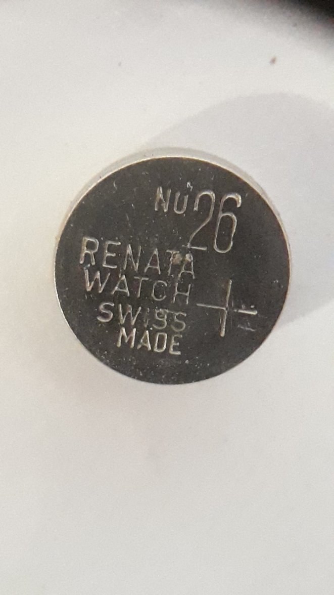

    Do not know if it is worth it or not but this aint 35years old Renata battery. This is newly produced becouse 30years ago standard was differend. It was not called 394 or 395 but it was 2 digit refererence.
    Here is oldest example of Renata battery that I have....

    Indeed that is not the original battery. The battery shown is a mercury free silver oxide battery (you can tell as it has "0% Hg" on it), and those didn't become widely available until fairly recently. I think Sony was the first to widely make mercury free batteries, and that was back in 2005. Renata didn't make them until 2010.
