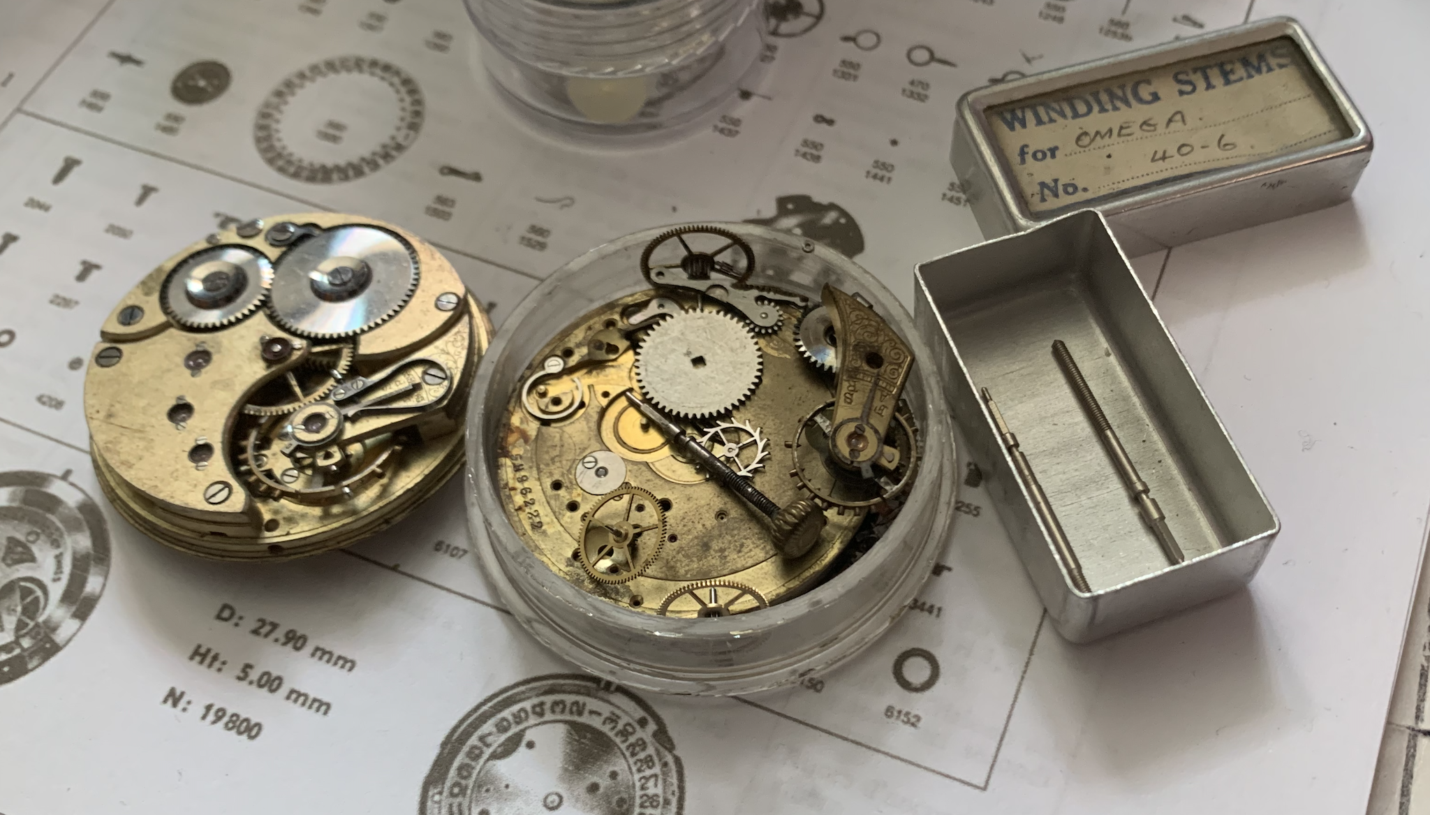

I have been sitting on these movements for decades. At one time I was planning to make a new escape pinion. The balance is just some rando balance I had layin around. Other parts may be just junk I had on hand as well.
On the other hand there may be an escape wheel on eBay I have been watching the listing for months if not a year. Not sure if it is the right size. Never really warmed up to pocket watches again. One movement seems to be 18L (40mm) the other 17L or so. I think 16L was the next common size. This can be a problem with the older stuff as there was not the standardization we now expect.
I suspect with some effort One could find more parts on the bay. There just is not enough time in the day. I seem to have declared war on Time, and time is winning.
