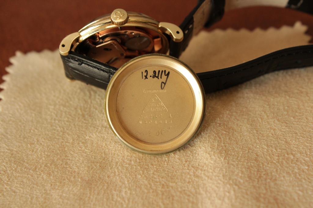

    This is what the case back should look like, though the crown on this picture is wrong:

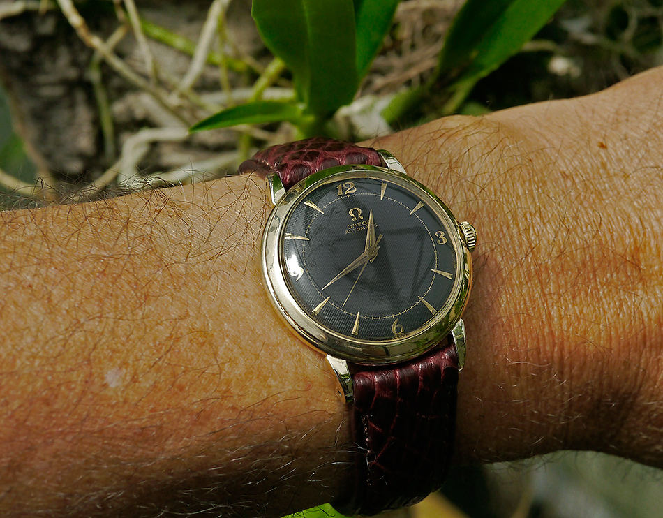

    Here is one of mine, this one has the proper crown.
