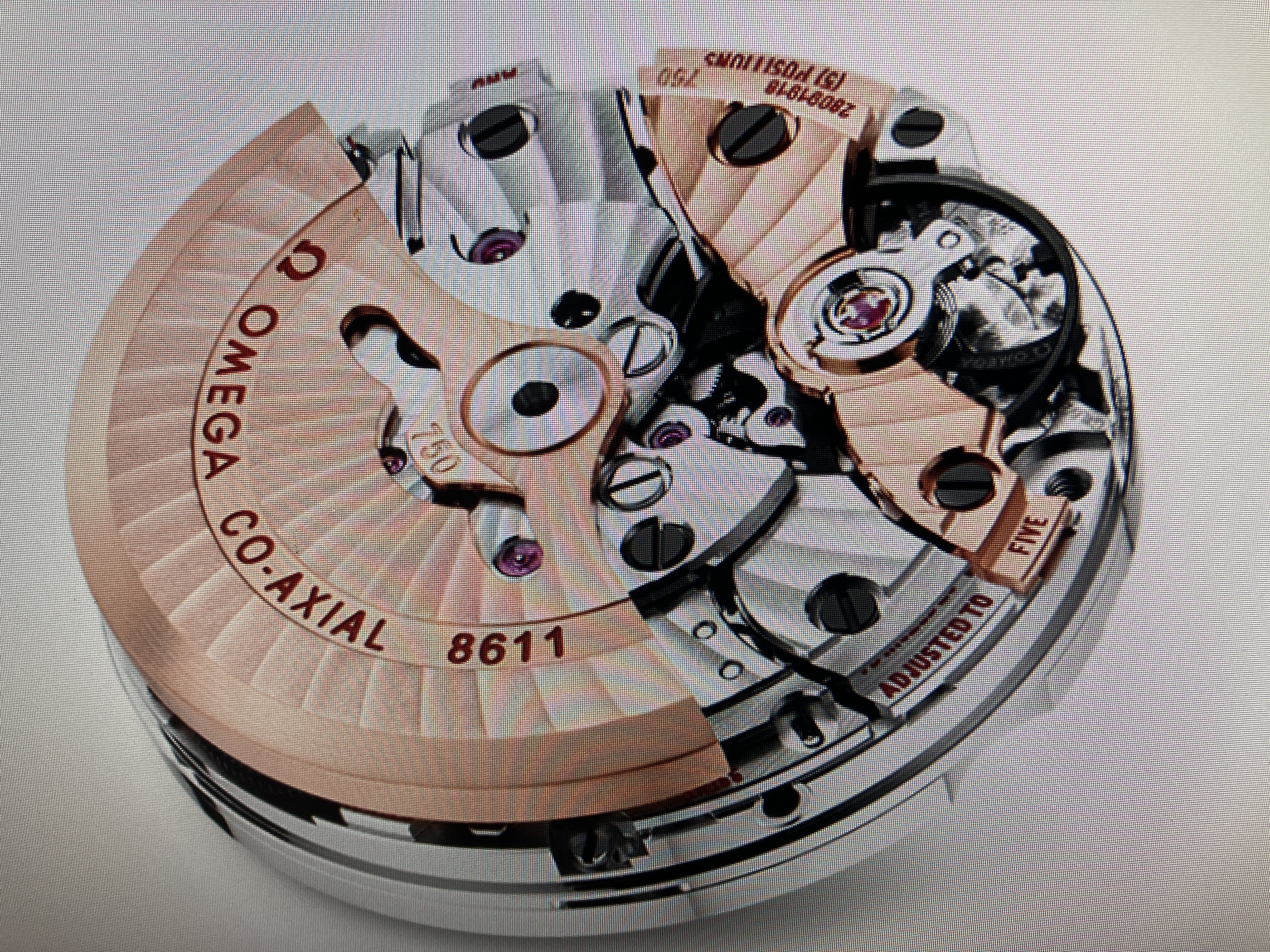

Anyone know how resistant to magnetism the 8611 movement is? It’s a co-axial chronometer (not a Master Chronometer) with a silicon spring, but I can’t find a gauss rating on any of Omega’s spec sheets for the movement or any of its associated watches.
This is a point of curiosity, not urgency.
