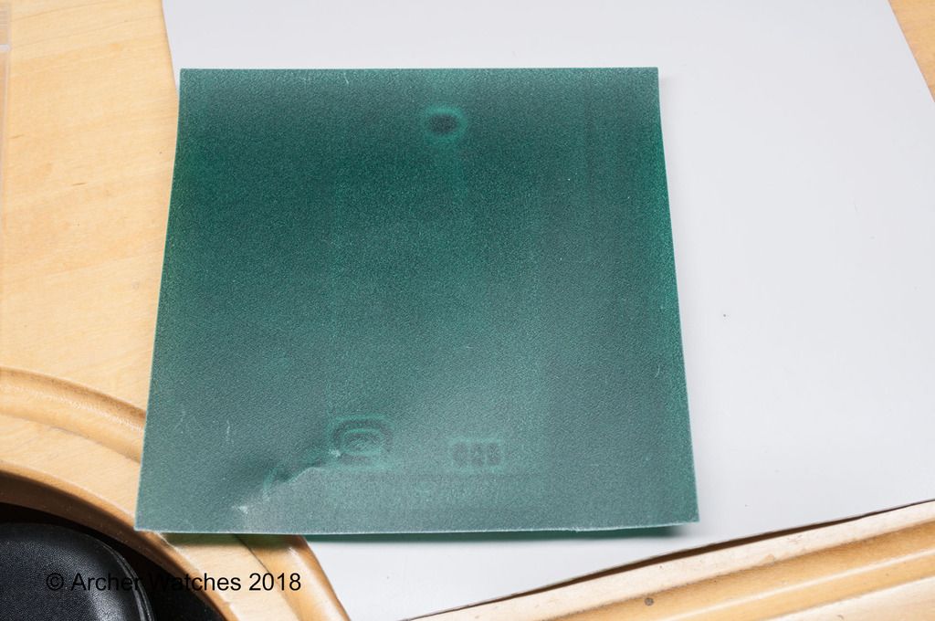

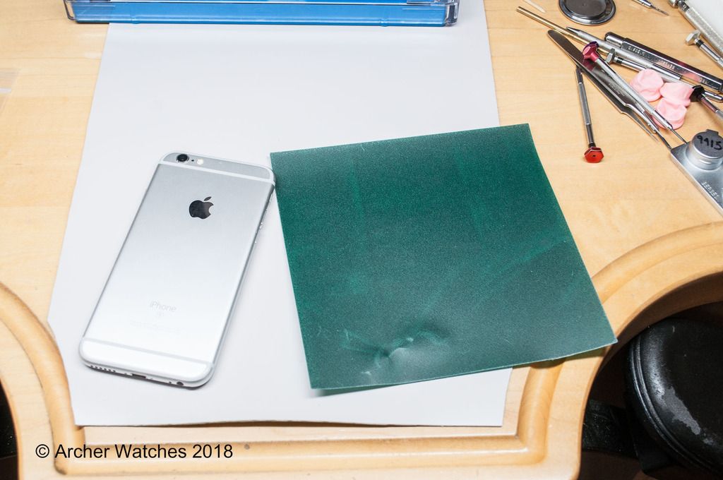

If you want to know where the magnets are, get some magnetic viewer film...cheap off Amazon...
Lay it over the item in question, and you will see the outlines of the magnets...
The part that will cause the most issues when magnetized will be the balance spring. Modern watches, even before silicon balance springs, are generally made from a material that is quite resistant to magnetic fields. Not impervious, but quite resistant. Magnetic field strength varies with the cube of the distance, so proximity is very important. If you locate the magnets and they are not right next to the watch, you are probably fine.
If the watch does get magnetized, it will most likely run fast, so if you see a sudden large gain in time, then demagnetizing it is simple to do with the appropriate unit.
Thanks a lot, I will try it out of curiosity.
