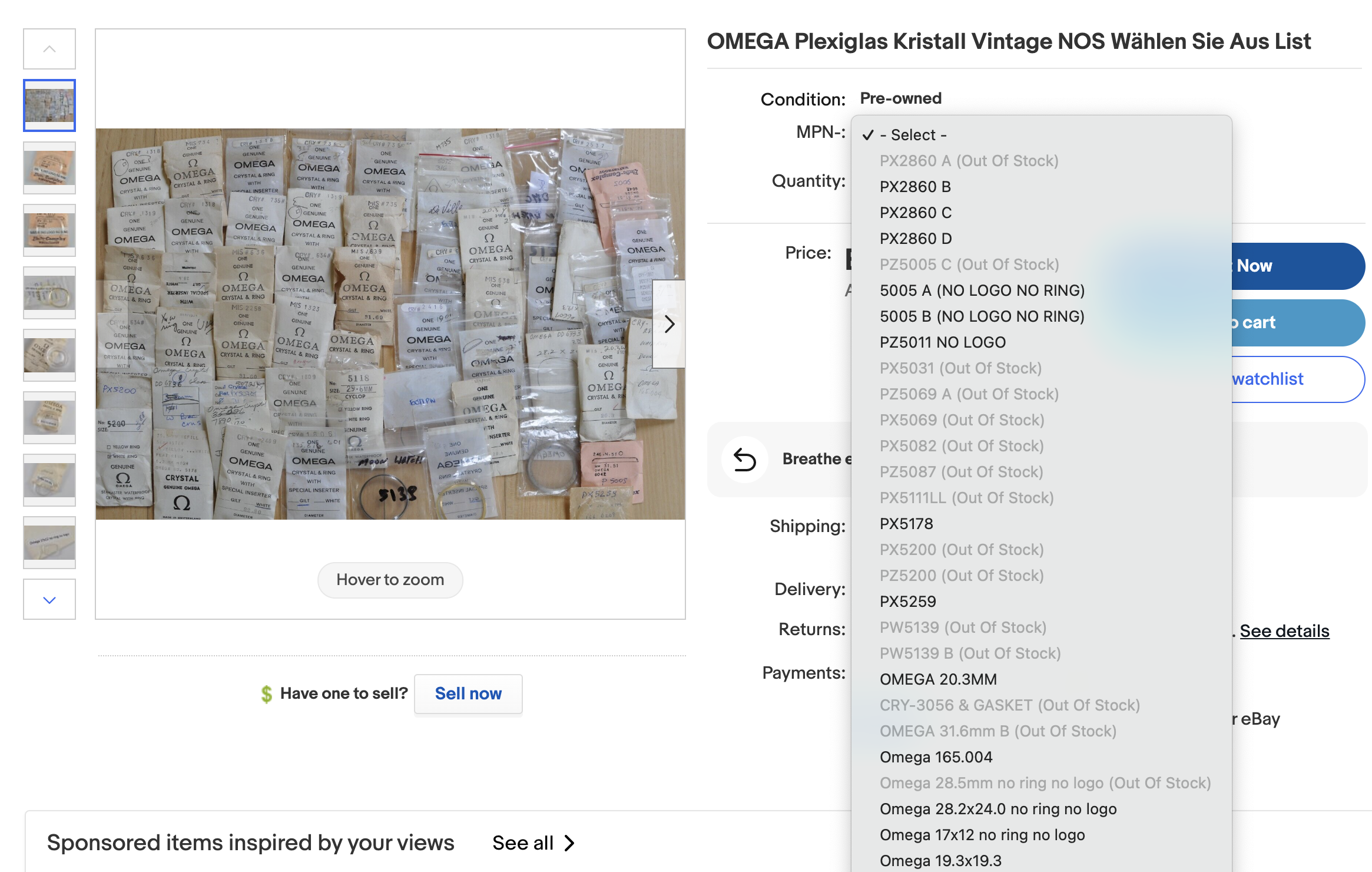

I asked this question as I recall seeing a crystal without a logo but inside a bag early on, and now seeing this other listing selling crystals without logos made me wonder as it became a pattern - I'll ask the seller more about it

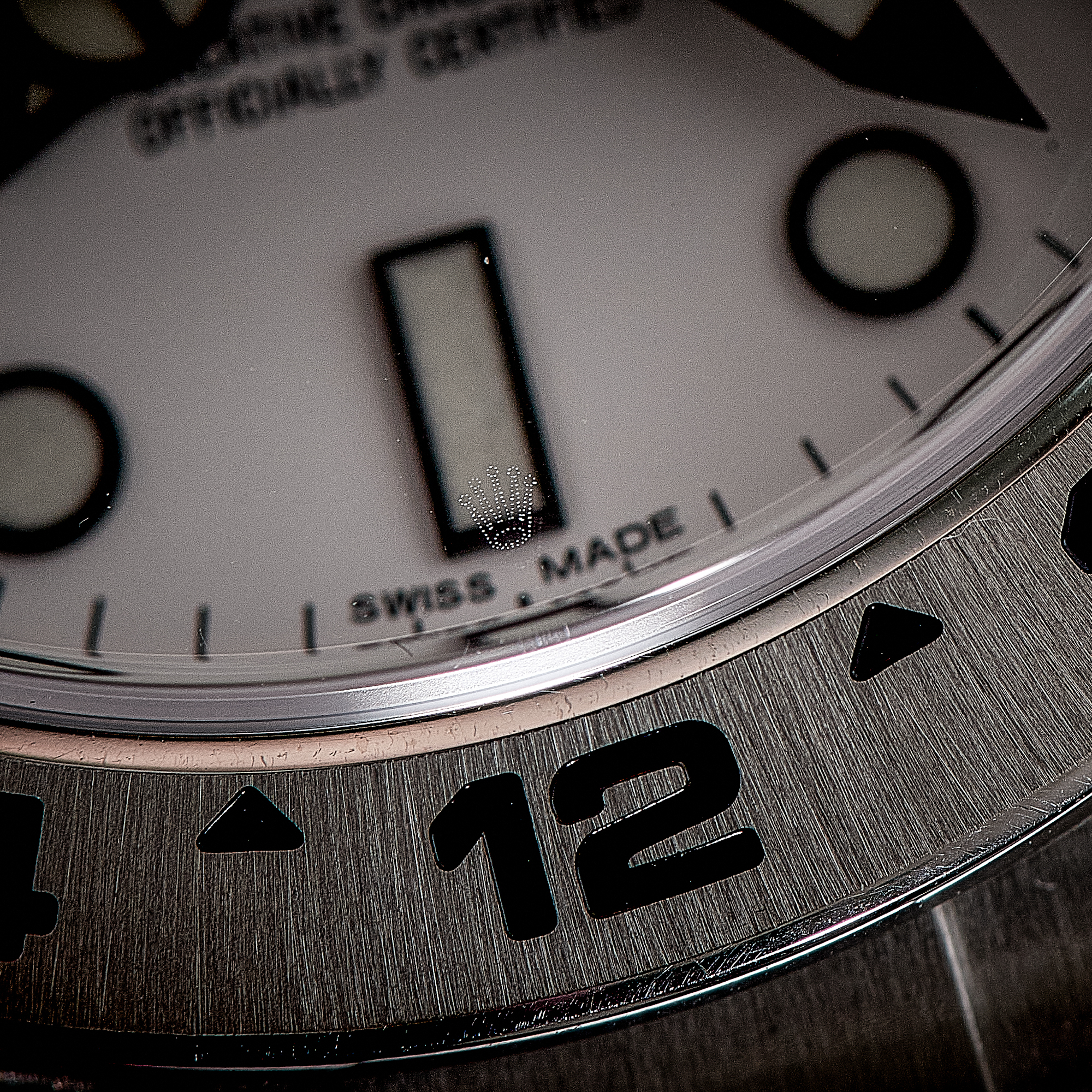

For some reason I also thought that Rolex marked their crystals but as I don't follow that brand I could be wrong.

Rolex did not mark the plexiglass but the original T19 for vintage submariners are highly sought after, and very expensive
Ah -my mistake - I knew I'd been something, somewhere, about a Rolex-marked crystal.
On post-2002 sapphire crystals - to countermand counterfeiting.
