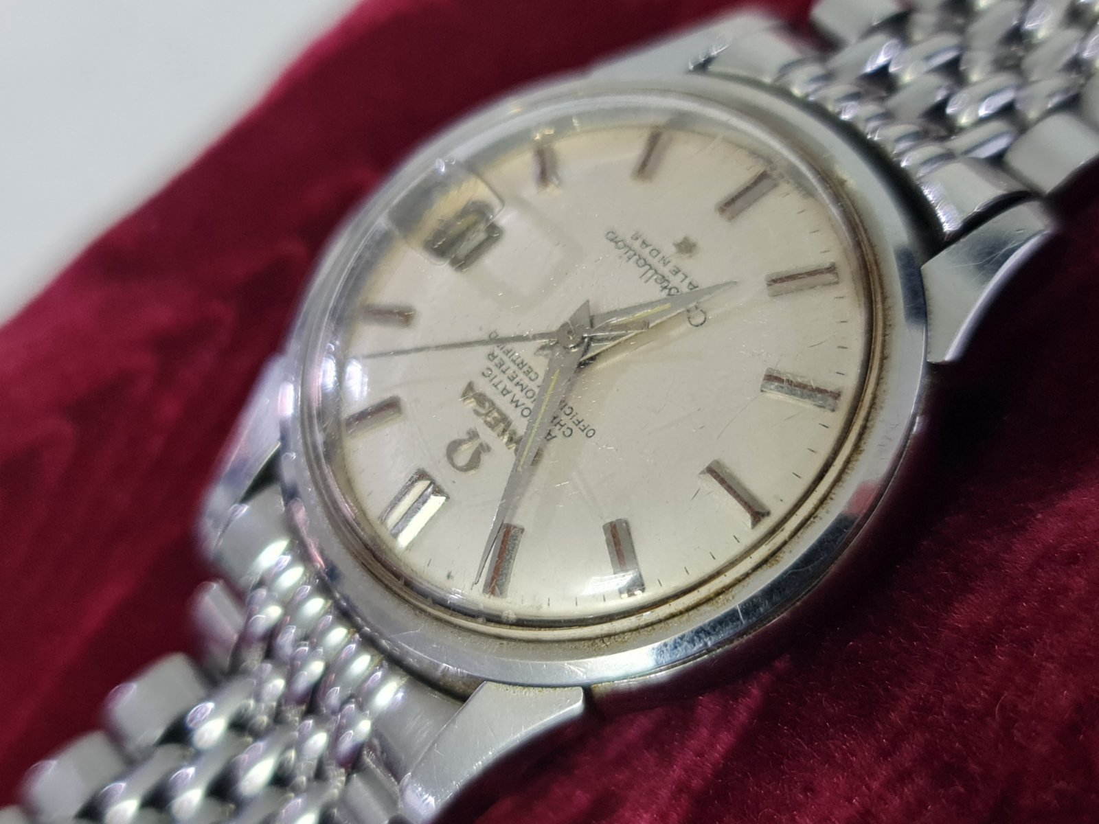

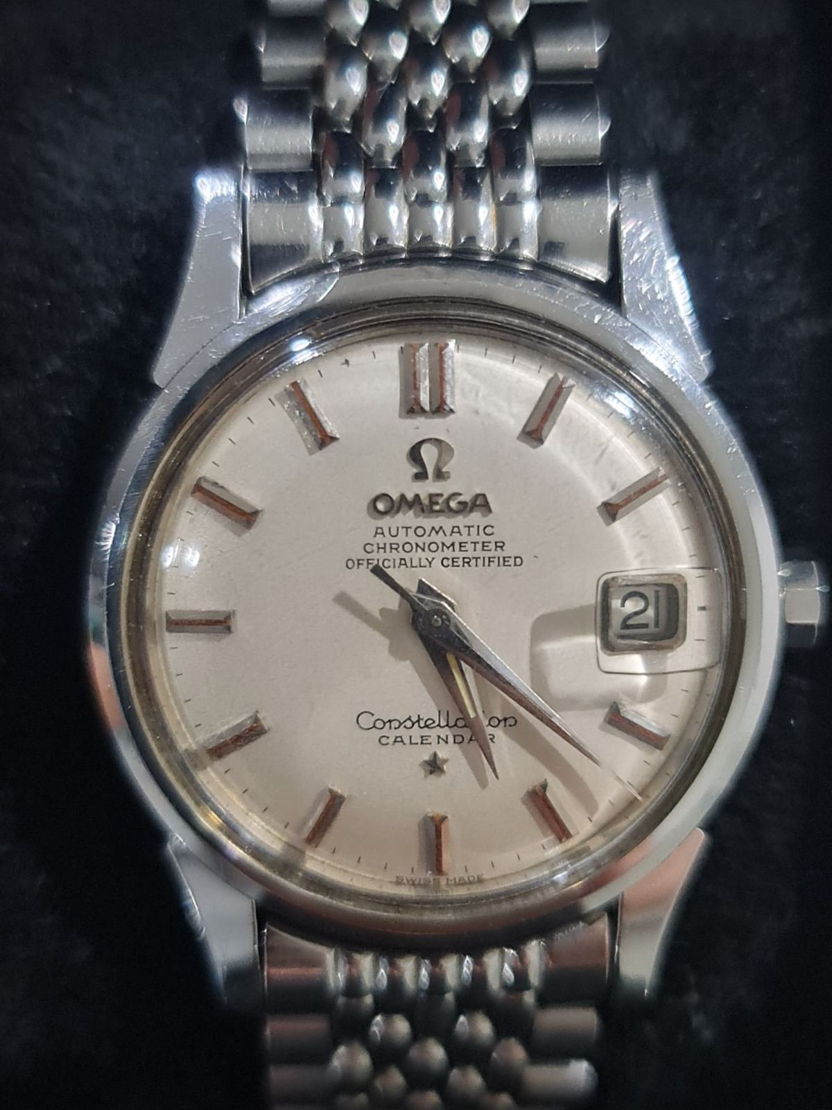

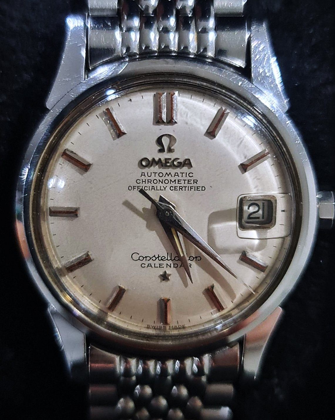

Hello Omega Forums, I have been lurking for a few weeks before becoming a member of the forum.
I’ve only had two watches in my life, my grandfather’s Elgin pocket watch and a Seiko 5 superior from the early 2000s that was a graduation present and tradition in our family. This changed late September of this year when my mother came home from a trip to see relatives, and now I have a third and the reason I joined this forum.

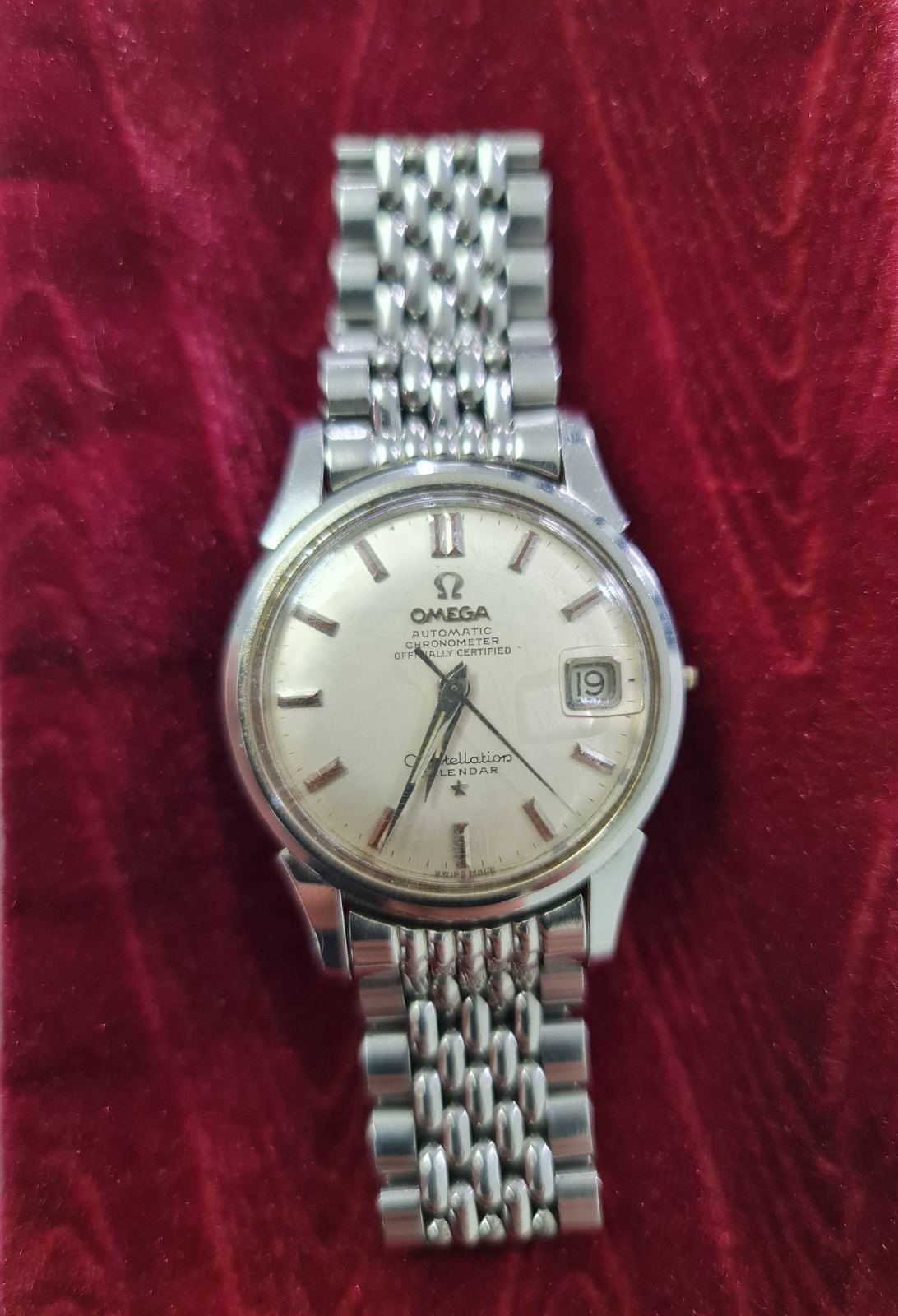

This is my grandfather’s Constellation, He passed it down to my uncle who is his godson who then decided to pass it down to me.

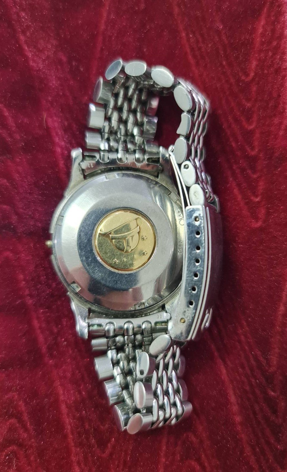

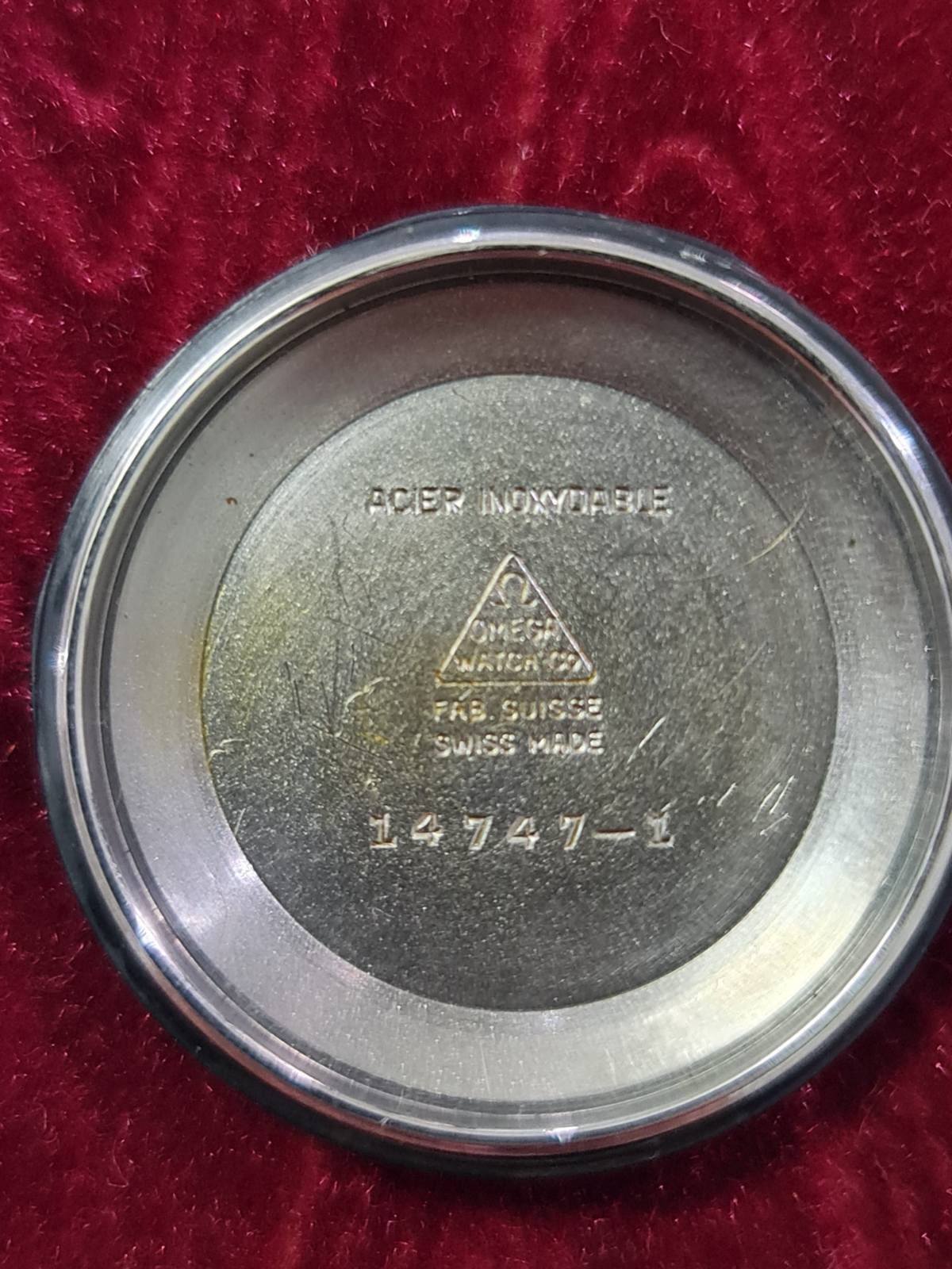

This is a recounting of how I went about identifying the watch knowing next to nothing about watches let alone the vintage luxury segment of watches. I started researching online and eventually I found Desmond’s blog and then down the proverbial rabbit hole I went. After a few minutes of reading, it became apparent to me that I would have to open the case back to see any serial number or identification numbers, luckily the case back came off easily with just my fingers.
I then look up those numbers on google and end up with the top 2 results being this forum post: https://omegaforums.net/threads/constellation-14747-and-14397-models.11452/ and Desmond’s blog: https://omega-constellation-collect...03/the-elusive-omega-constellation-14747.html
I was already thinking this was so surreal just being the one this watch was passed down to but then seeing that it was this hit even harder. I emailed Desmond and got a wonderful reply with sage advice to avoid Omega authorized dealers/service centers and find watchmaker that knows his way around old Omegas. I did manage to find a Omega specialist watchmaker here In the Philippines but he told me parts are scarce here and I would have to purchase online and ship them in. I found omegaaddict.com, Tim was very helpful and I was able to purchase a winding stem and setting lever spring from him. The correct crown though still eludes me. So I’m on an ongoing quest to restore my families heirloom and its already been quite a trip!

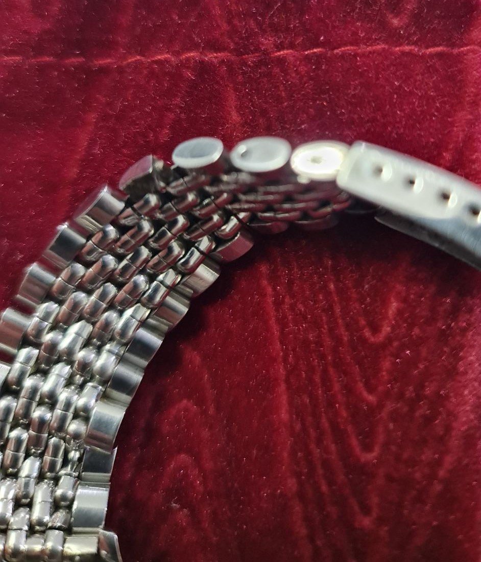

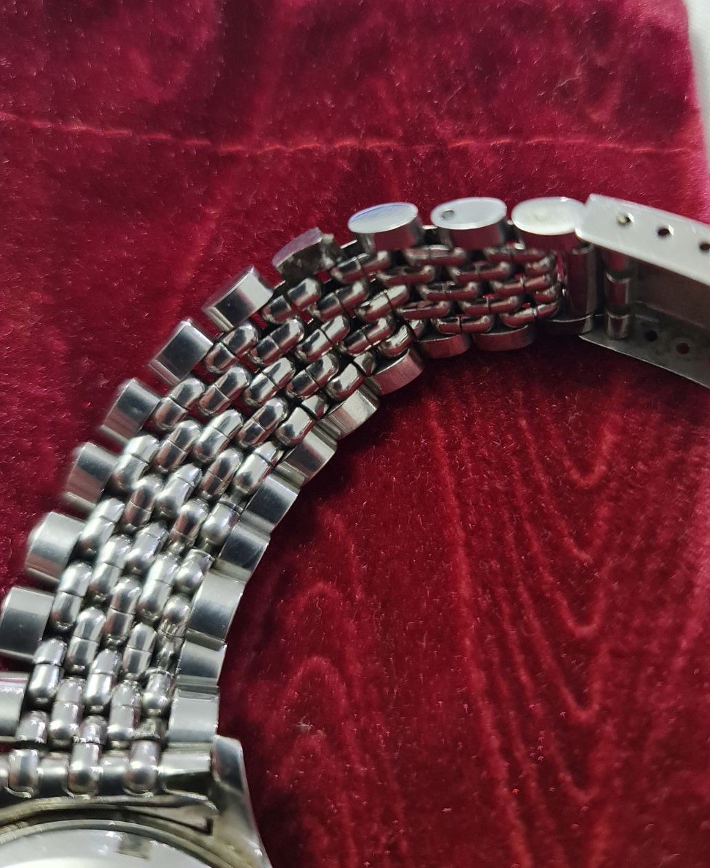

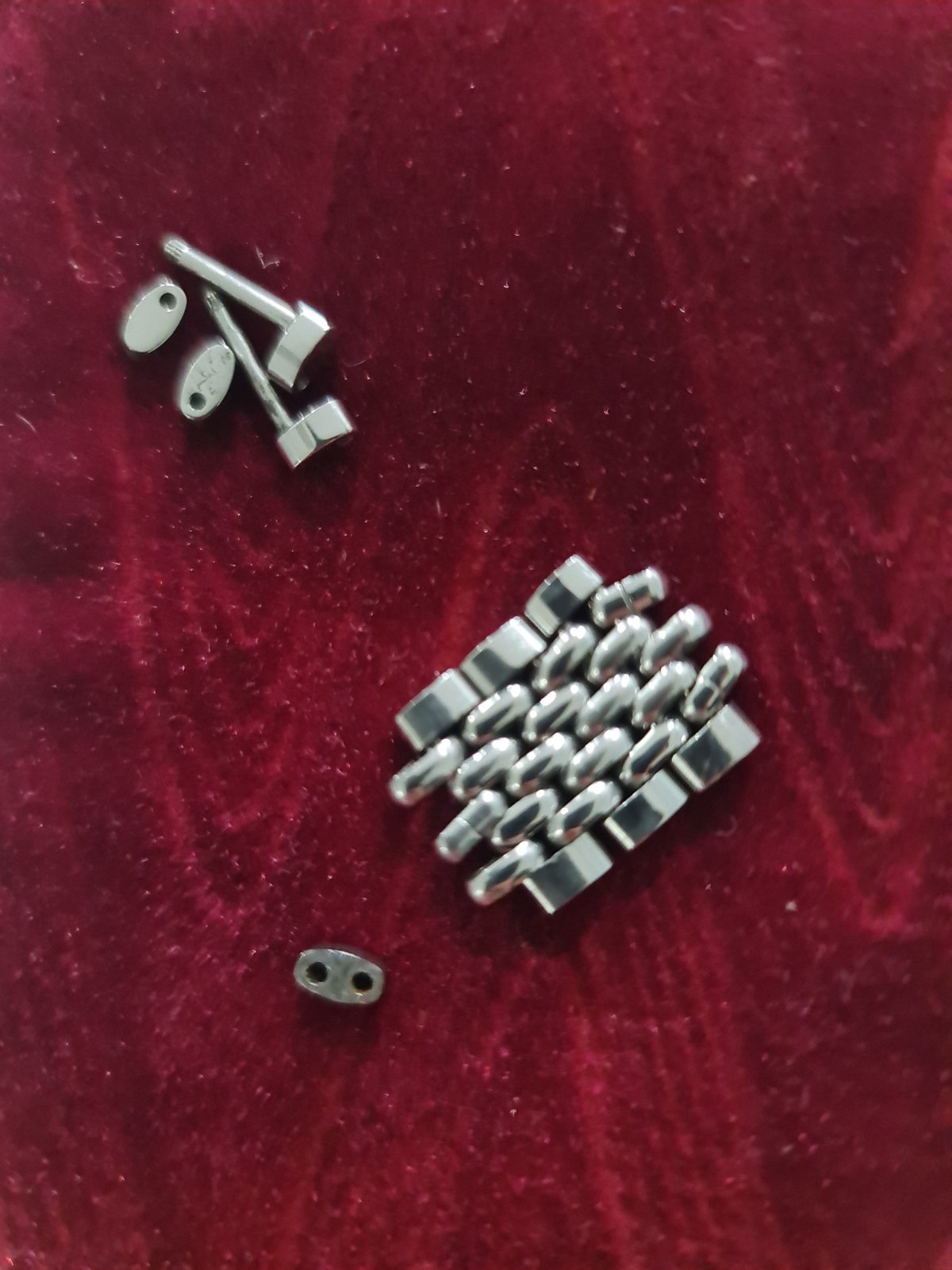

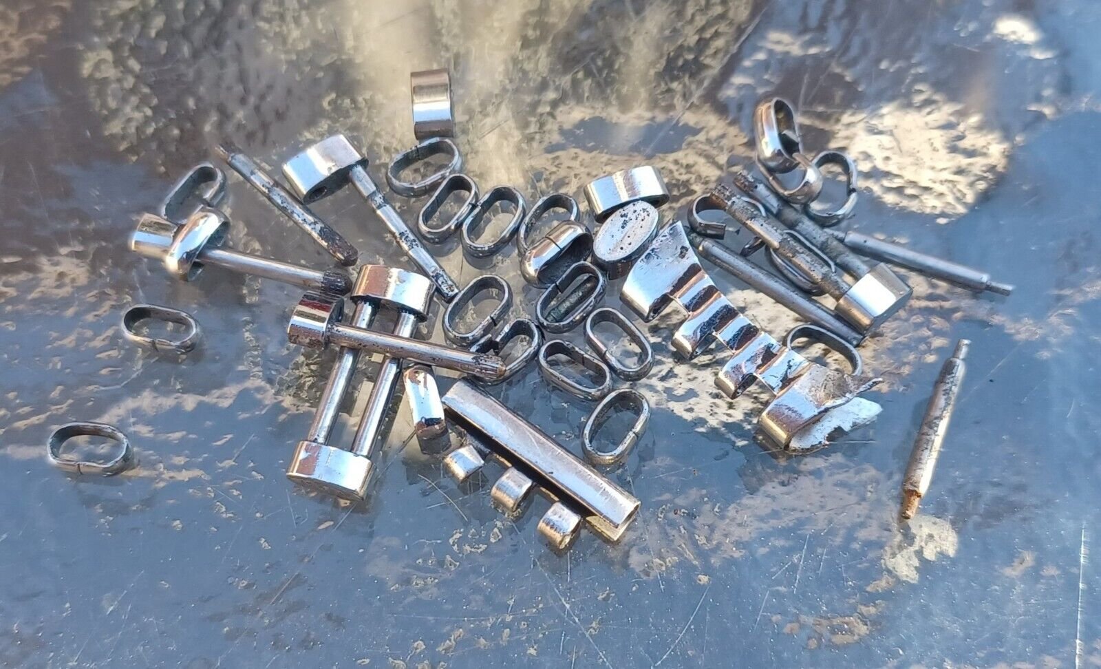

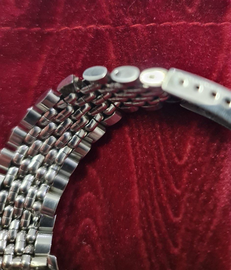

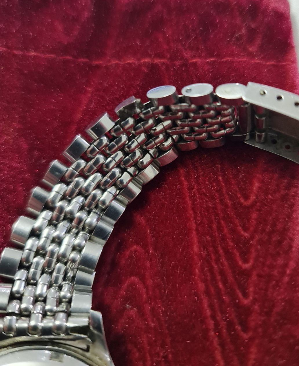

The last 2 pictures show one damaged link on the bracelet, I found a seller on ebay that had parts of a bracelet. see photo:
I bought it knowing that it may not be the right part or size but my rational was "hey i only need 1 link". It arrives a few days later and was better than I though. This is what that pile looks like after putting it together:
9,355
78,308

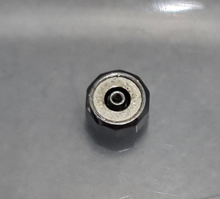

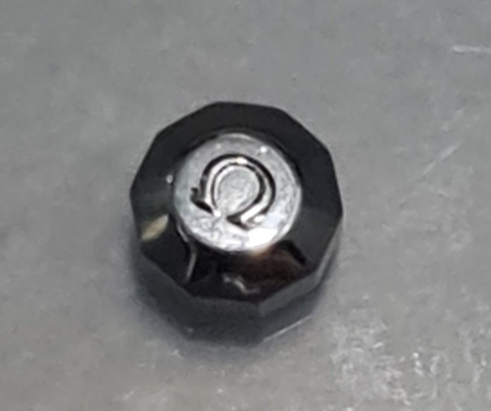

To continue on with this journey, I would have posted sooner to ask for advice if I had figured out sooner that I don’t need photobucket to upload photos (I seriously considered paying their 8 dollar ransom..) So before figuring out the right crown I needed was #4204 I was working on the assumption that all I needed was a decagon crown for 2mm case tube. I purchased one https://gleave.london/crown-steel-omega-st42009/ and it arrived today and it does fit the case tube and will do for now until I can find the so called flat foot 4204 thin crown. Here is what it looks like just on the case tube with out the winding stem.

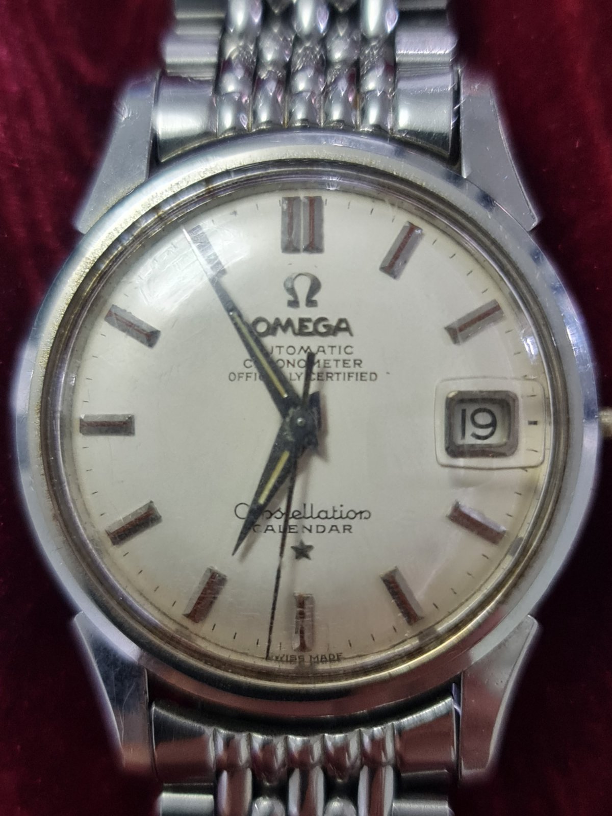

I am also looking for the correct crystal. On one of the charts I saw it looks to be part number 5000 with silver/white retaining ring not sure if prefix is pz or px? when I look it up on eBay I can find the plain ones but not one with the cyclops/date magnifier. I recall reading somewhere that the suffix L indicated cyclops/date magnifier but I am not really sure, any one know what is correct?

PZ for silver tension ring and L is the suffix for the date magnifier. The magnifier was an option though, so if you’re having trouble I’d be perfectly happy to settle
For a crystal without.

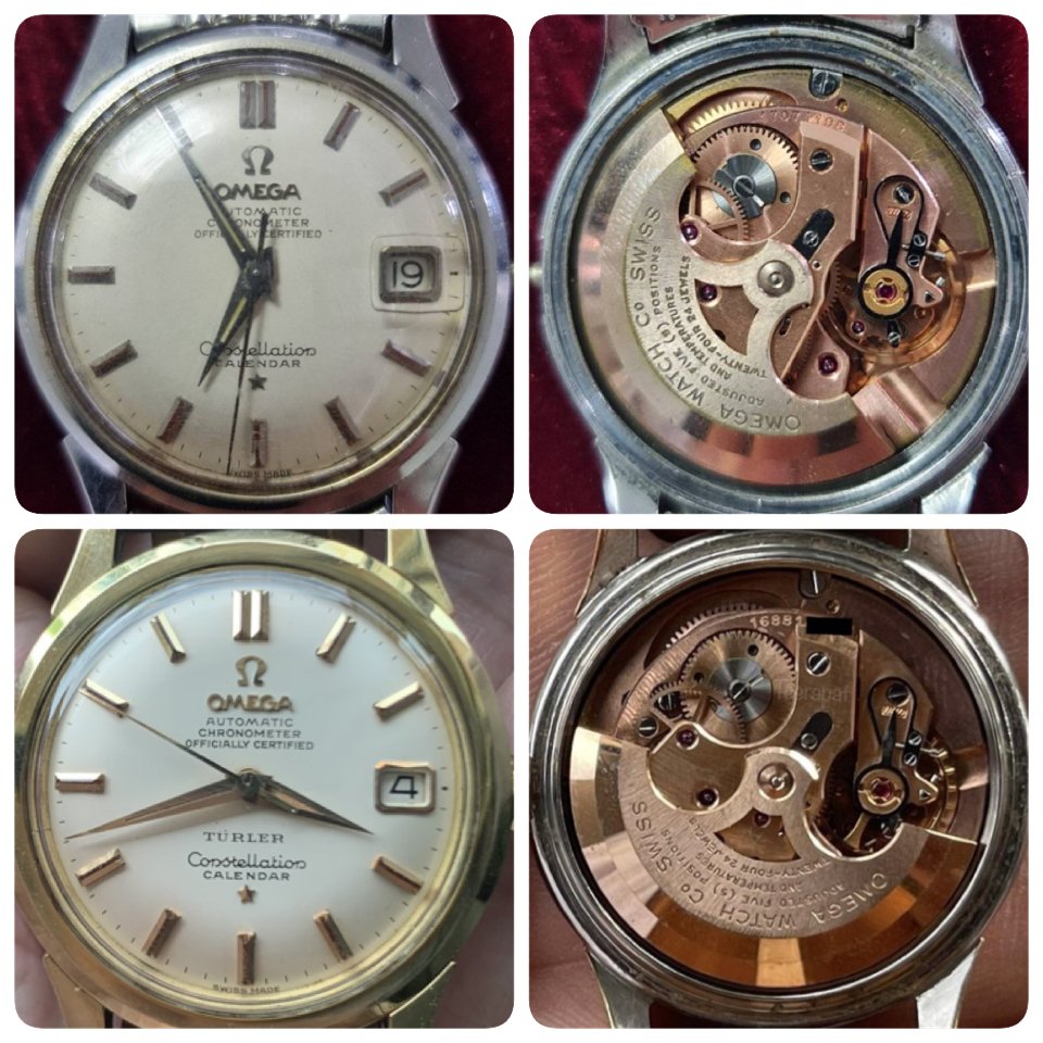

@Custodian914 congratulations , ref.14747 is the uncommon reference with cal.504.
However if you see only the front and movement, they look identical.
Please compare to my watch:
The difference was only “Snap-on” vs “Screw-in” case back (ref.14747)
I am not sure why omega do this?::psy::
In my opinion plus the nice suggestion with Hoi, @hoipolloi the ref.14747 might be the next generation of ref.2887 (which is the screw-in case back of the ref.2852).
The ref.14747 might be the “trial references” before total switching to screw-in case back like 14381 and 14393.
please let me know your thoughts, what might be the purpose of production?😉

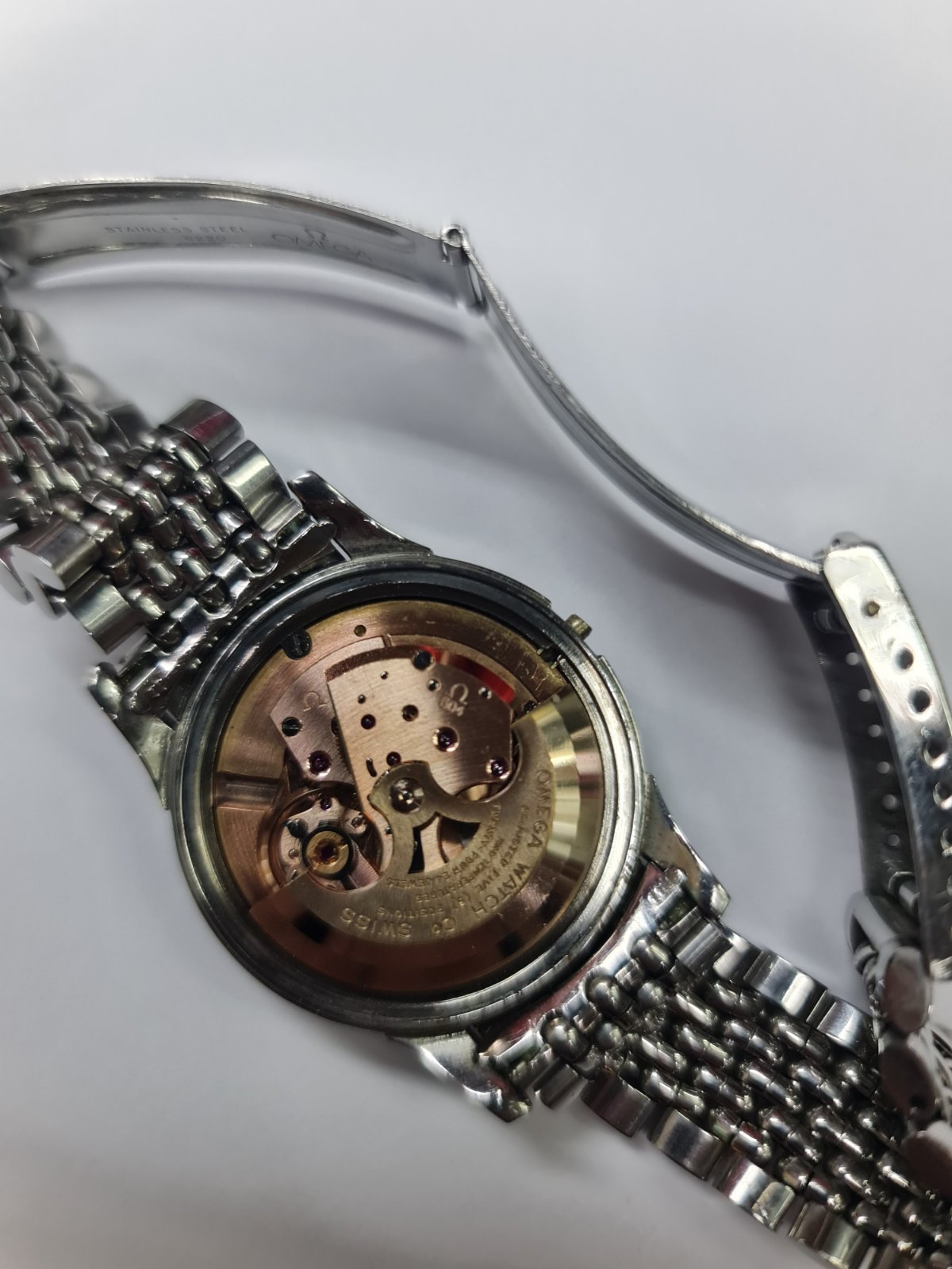

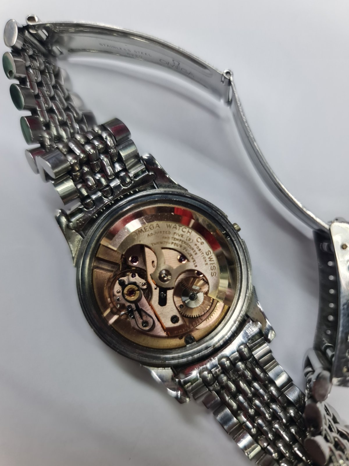

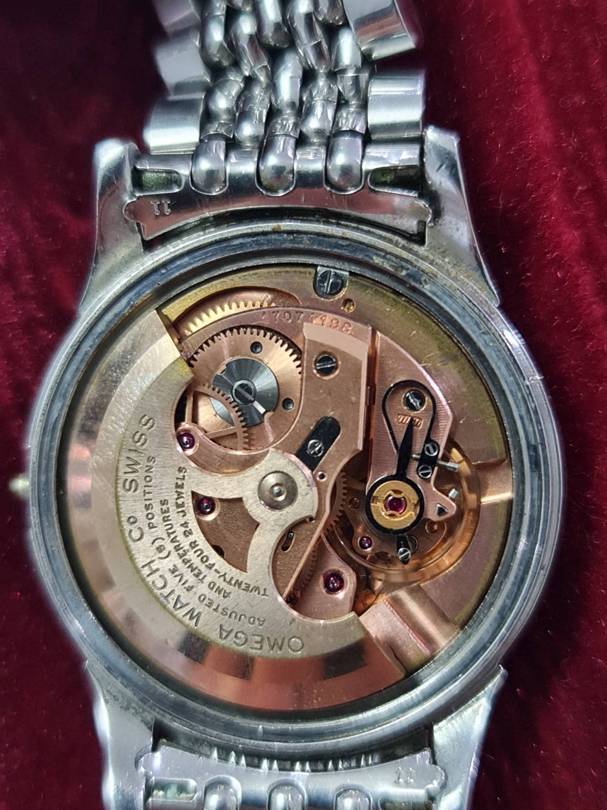

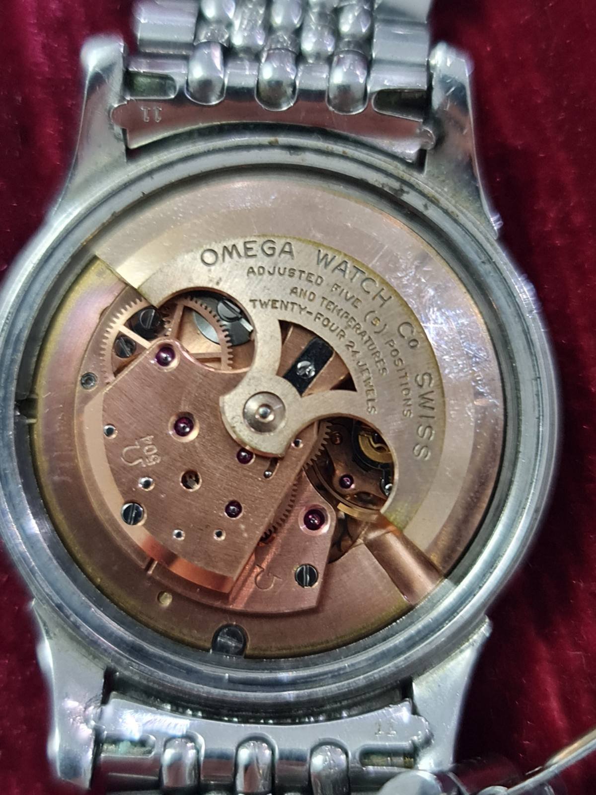

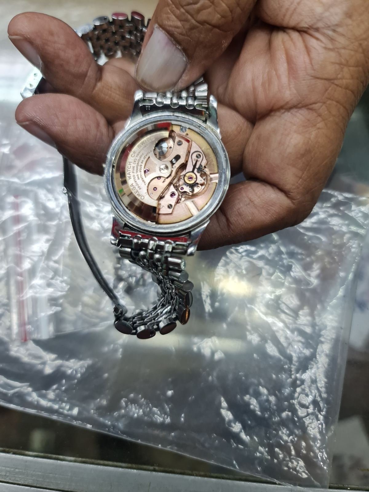

I got the watch back from servicing and the good news is no other parts are needed to replace aside from the winding stem. watchmaker said that all the parts are in very good condition and to comeback when the winding stem arrives for installation. Here are pictures of the movement in its lovely new shine:
I also used Polywatch and fine sandpaper on the crystal and I am very happy with the results, I don't think the pictures show it well enough but scratches are all gone with just 20 minutes of elbow grease.

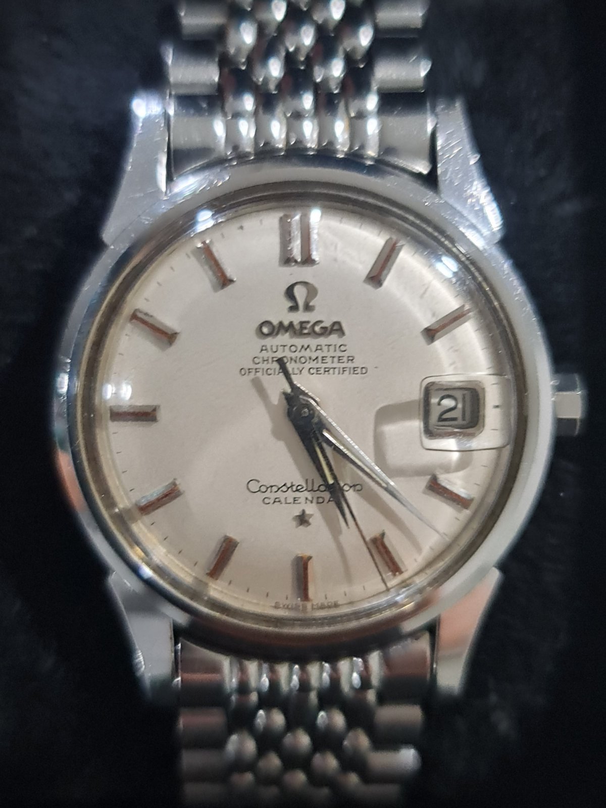

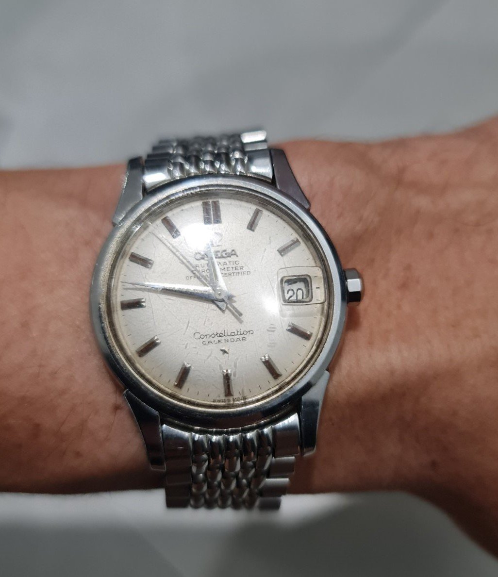

I finally got the winding stem and had it installed. Got to wear it for Christmas eve and day so its been a very merry Christmas for me. hope you are all having a great Christmas as well!
183
576
Although I am not a huge fan of the magnifier, this watch looks great, especially with the bracelet. Wear it in good health and merry Christmas!
