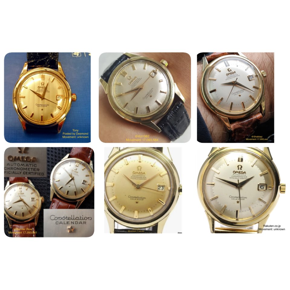

My research found only “6 examples” of reference 14395 with an original dial. Please let me call @Shabbaz and @Banner Roar .😀

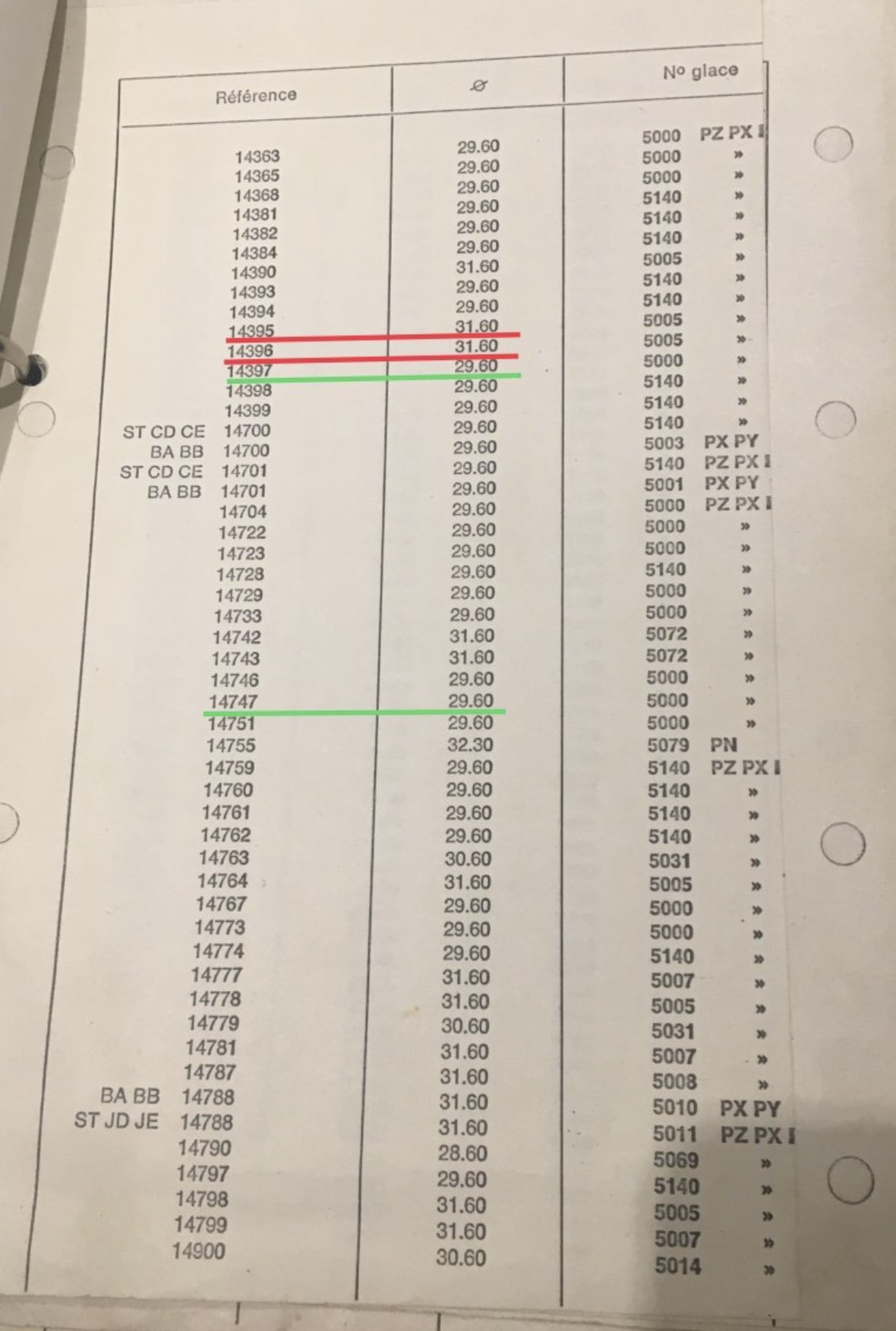

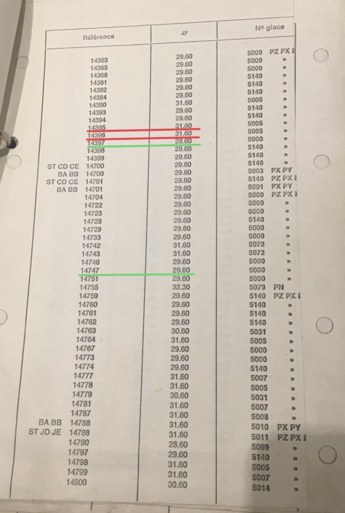

However, I found this “Vintage Omega plexi interchangeability and case reference plexi-case list” posted in this forums by @michael e .
Please be informed that both of the reference 14747 and 14397 used the same size, but the reference 14395 (also 14396) used the larger size.
So, I believe that the reference 14747 and 14397 might not be the jumbo reference.

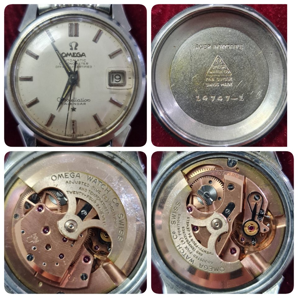

Waiting @hoipolloi to confirm my assumption of his 14397.😁

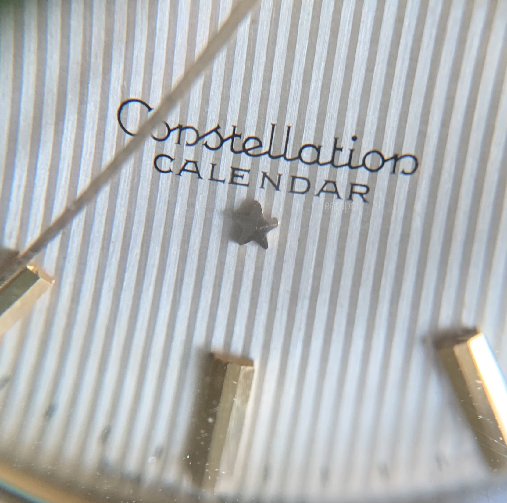

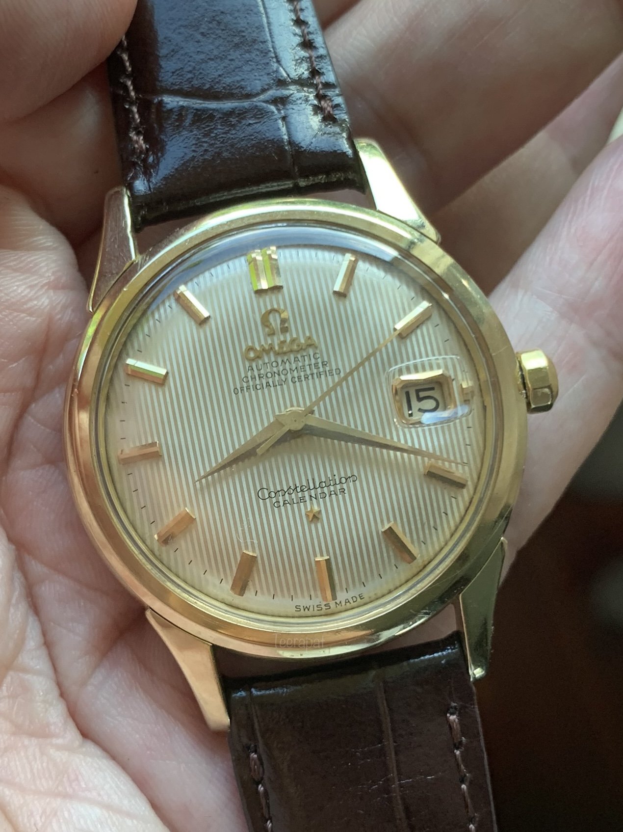

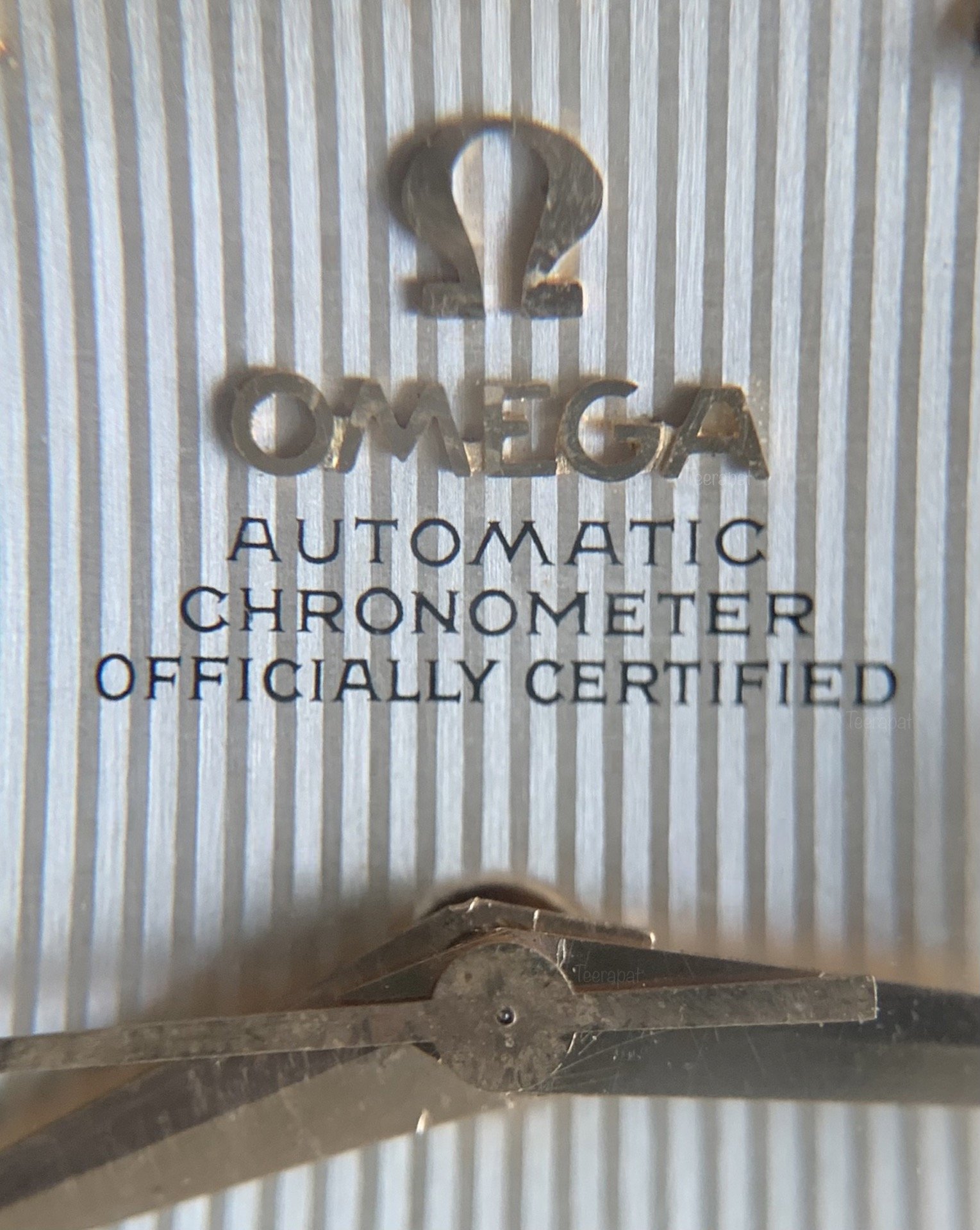

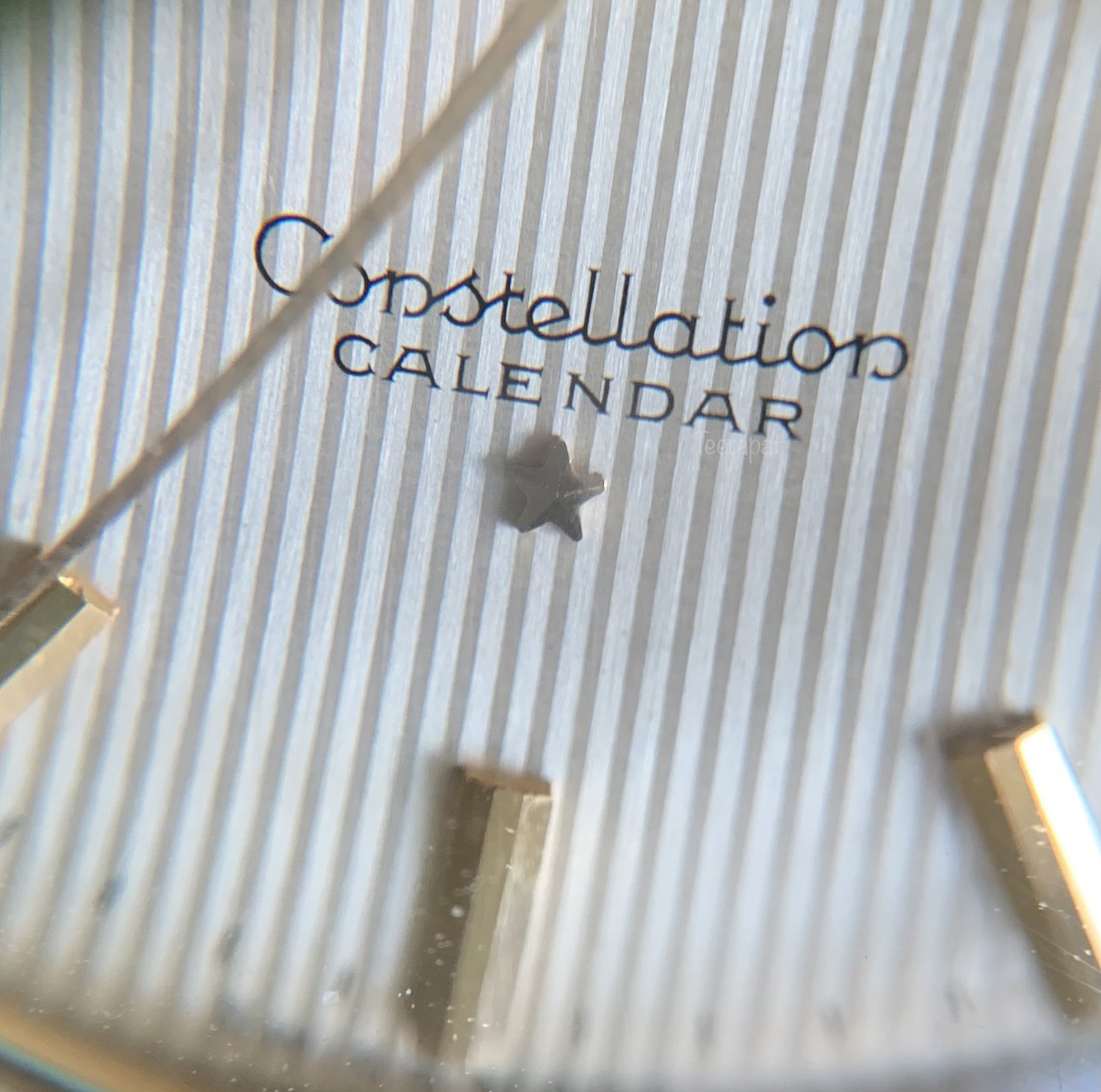

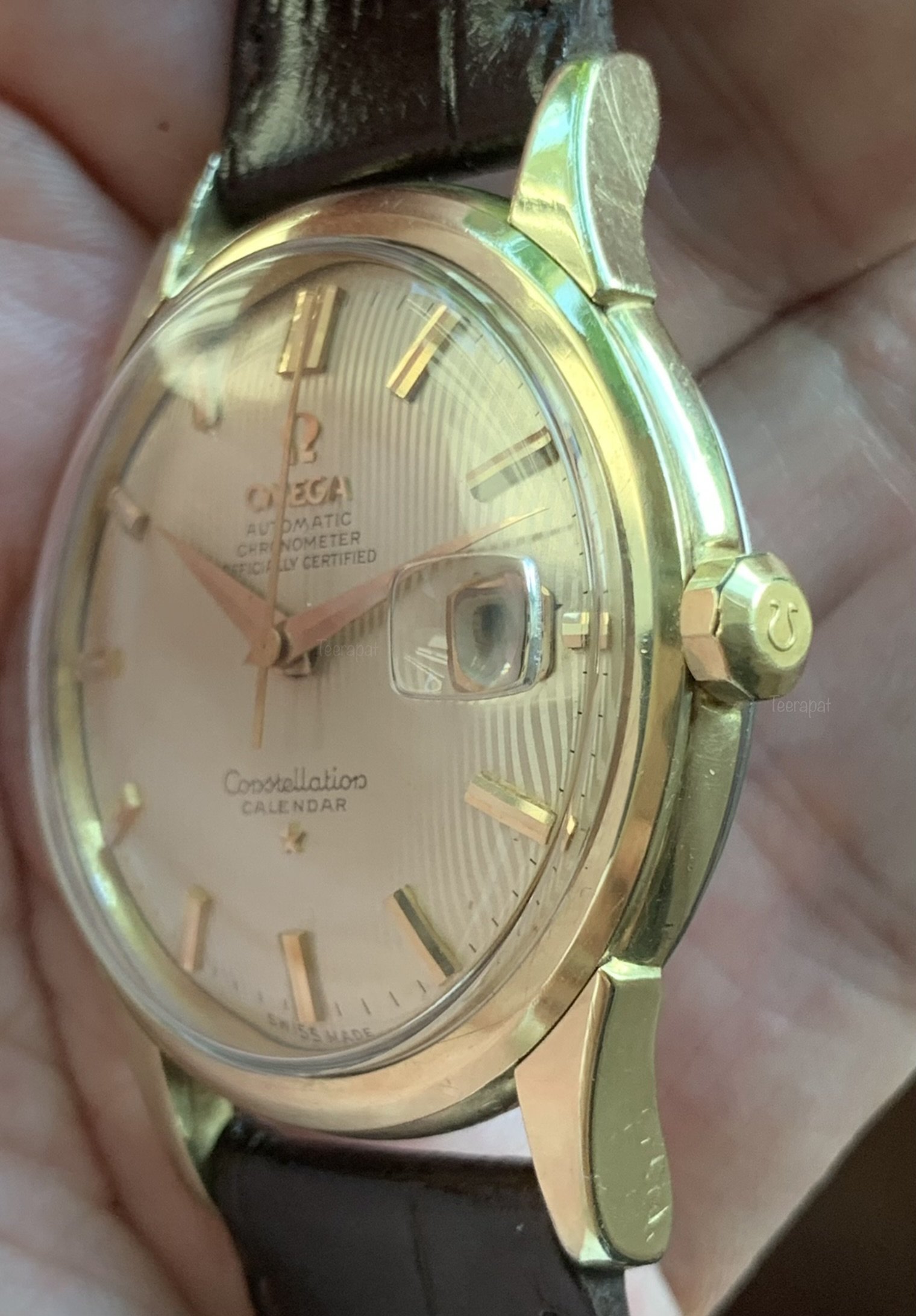

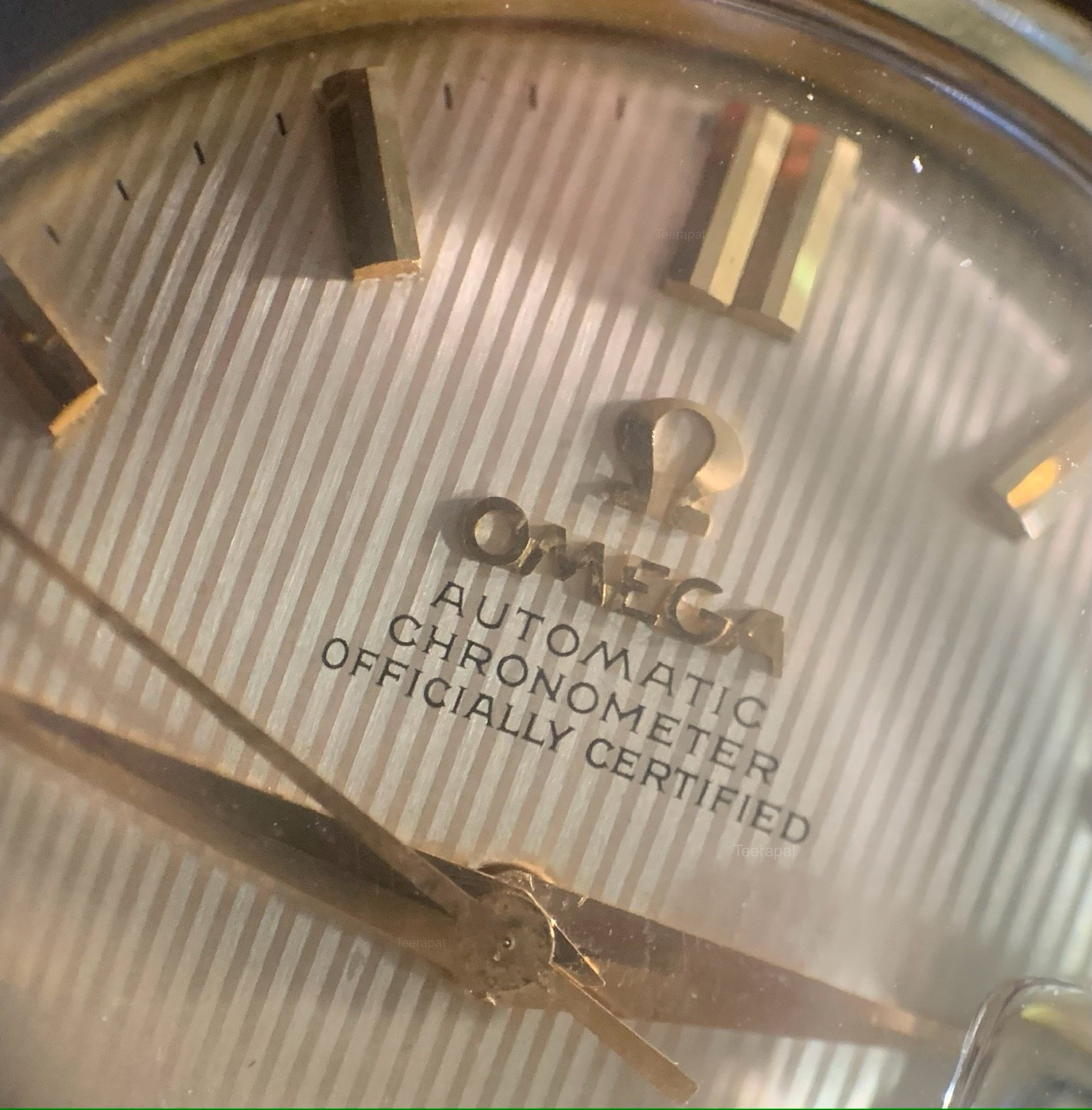

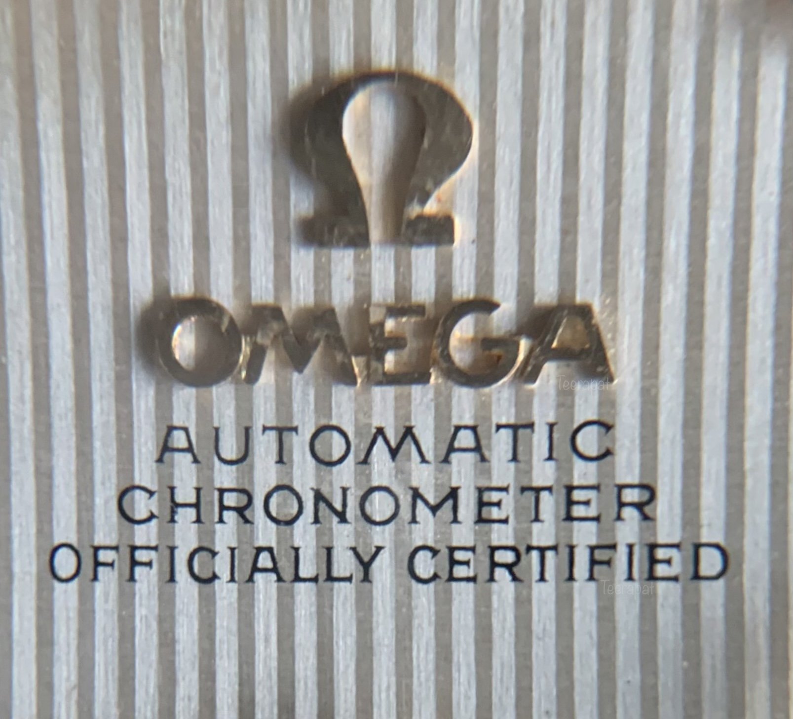

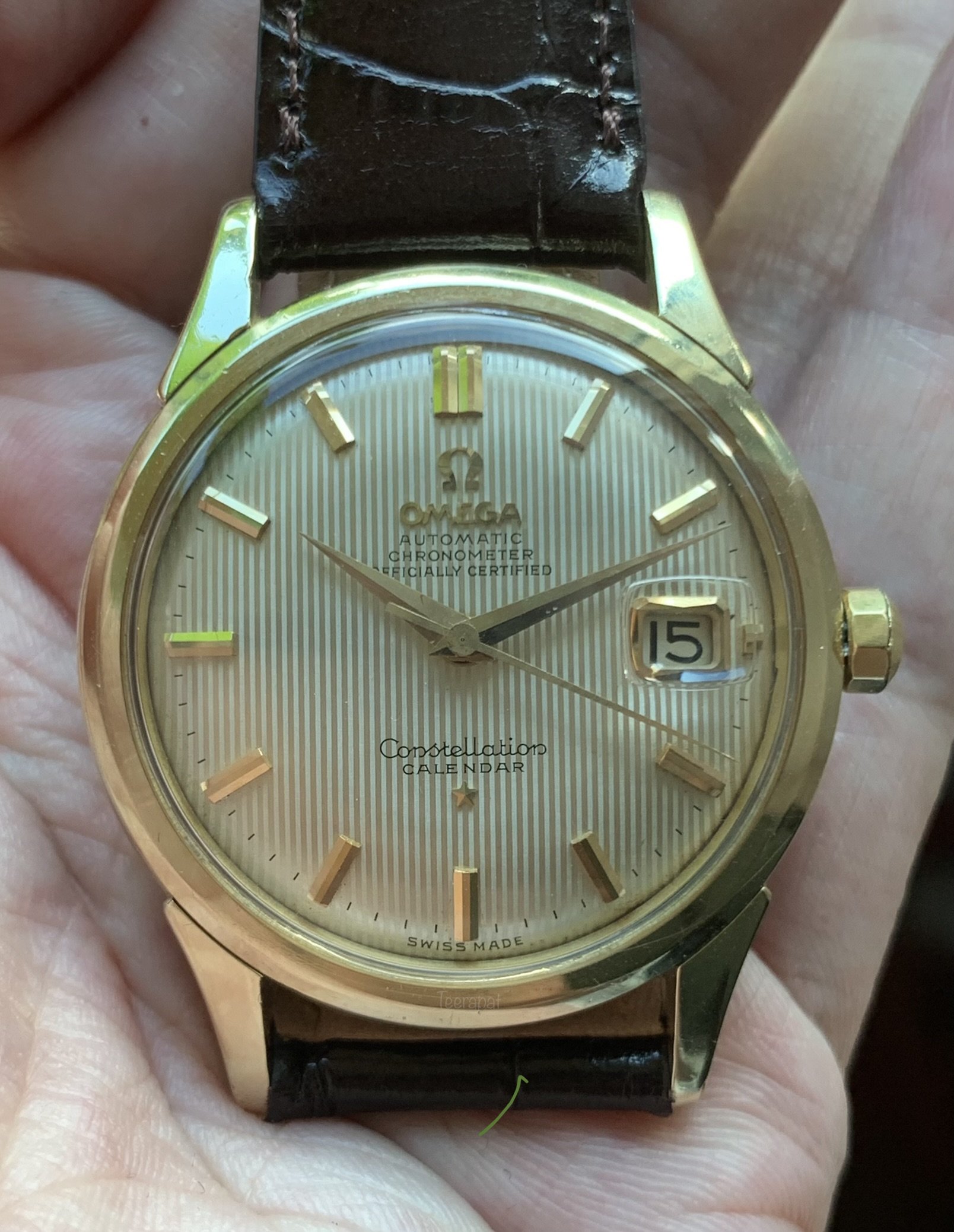

Today I would like to share another one in my collection, the reference 14395 with the “shadow striped dial” pattern (or tapestry dial).
Please note that the only example that I found using the same dial pattern in the jumbo reference 14395 was the example owned by Ko (@Ko1892 ).

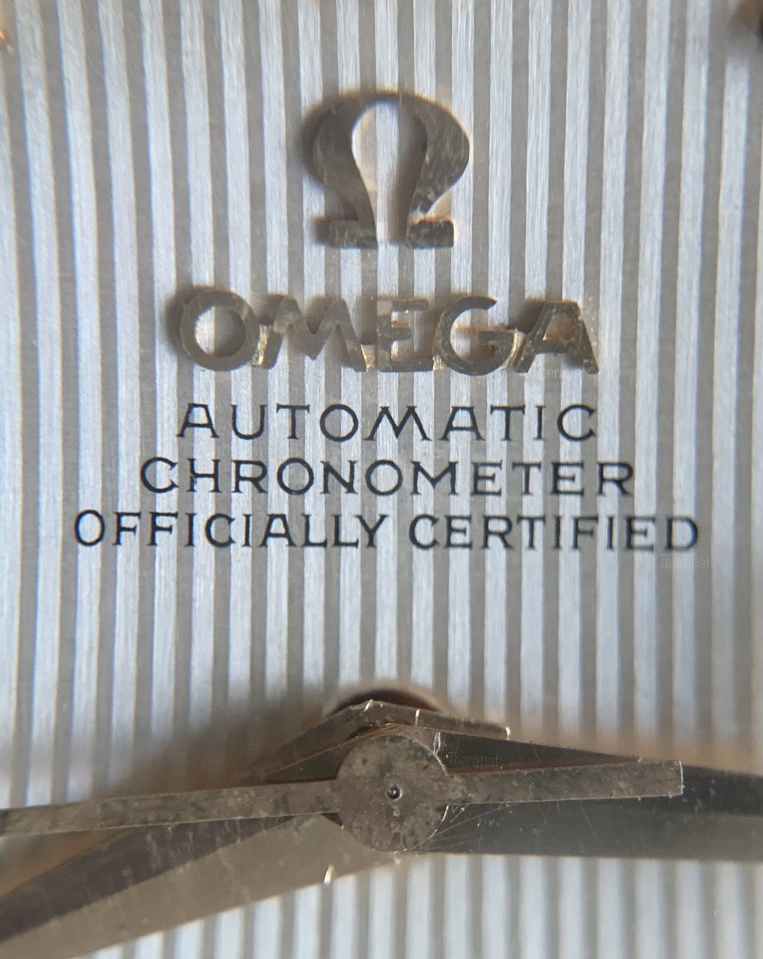

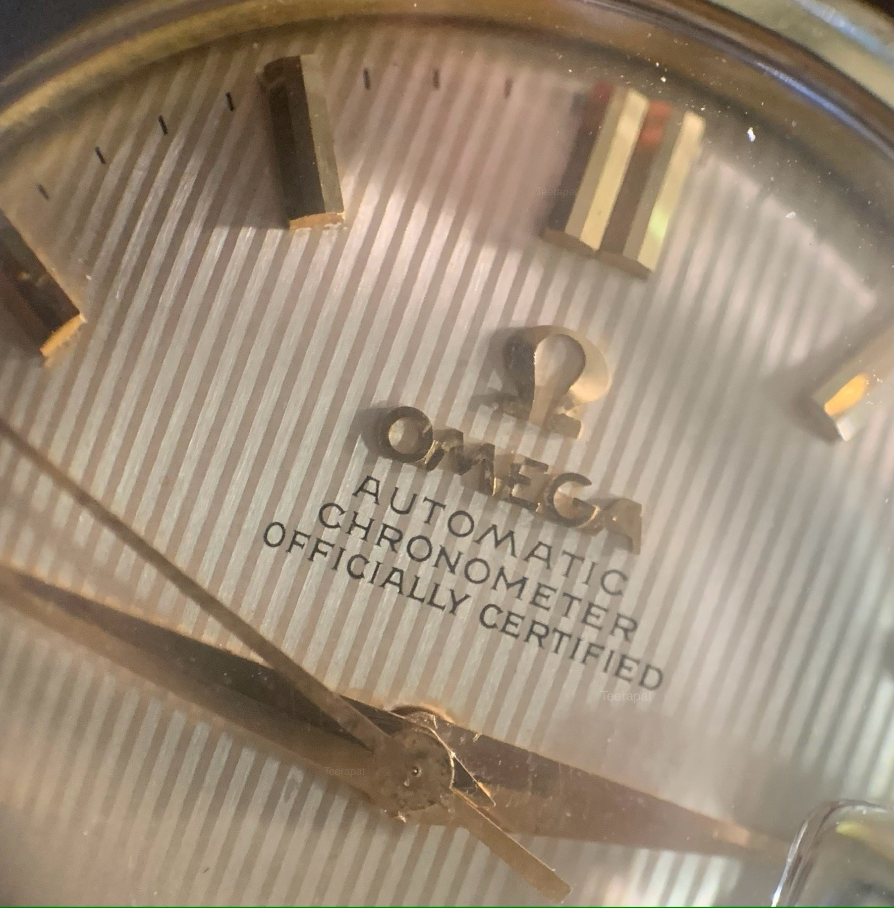

In my opinion, the dial was original, very nice and cleaned tapestry dial, please see the close-up pictures below.

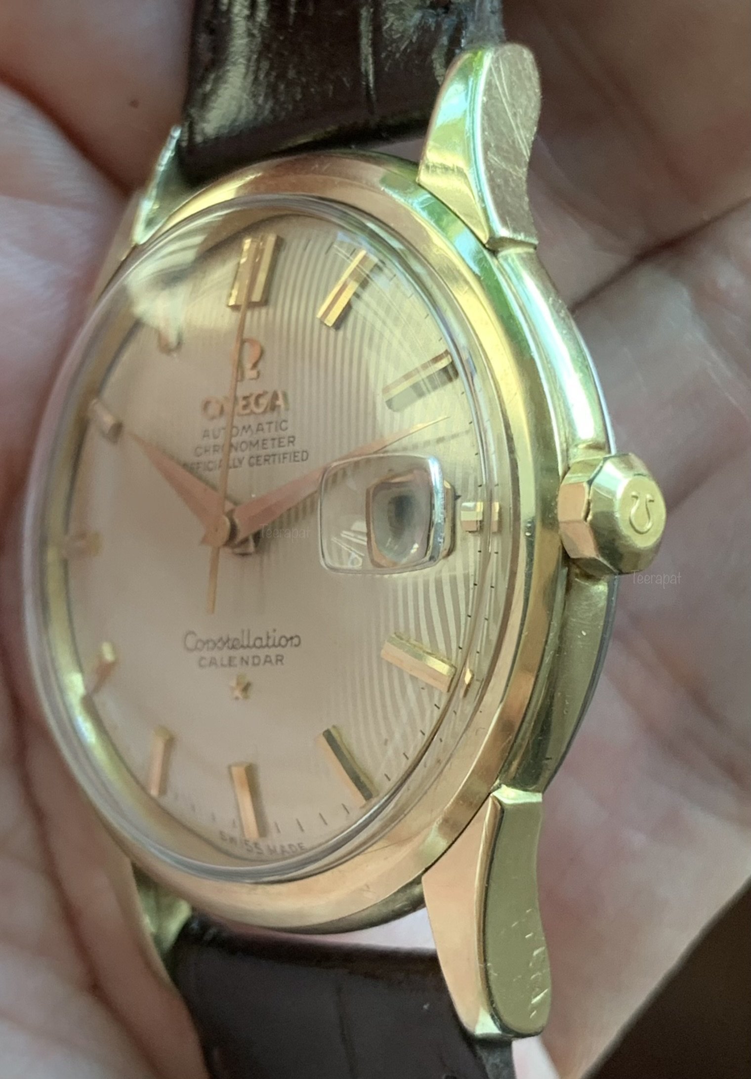

Case was some polished in the past.
The “flat-feet thick decagonal crown” was original and should be the correct crown type for the 14395 and 14396. Some light reflection around the edge of it.
The date magnifying crystal was original too.

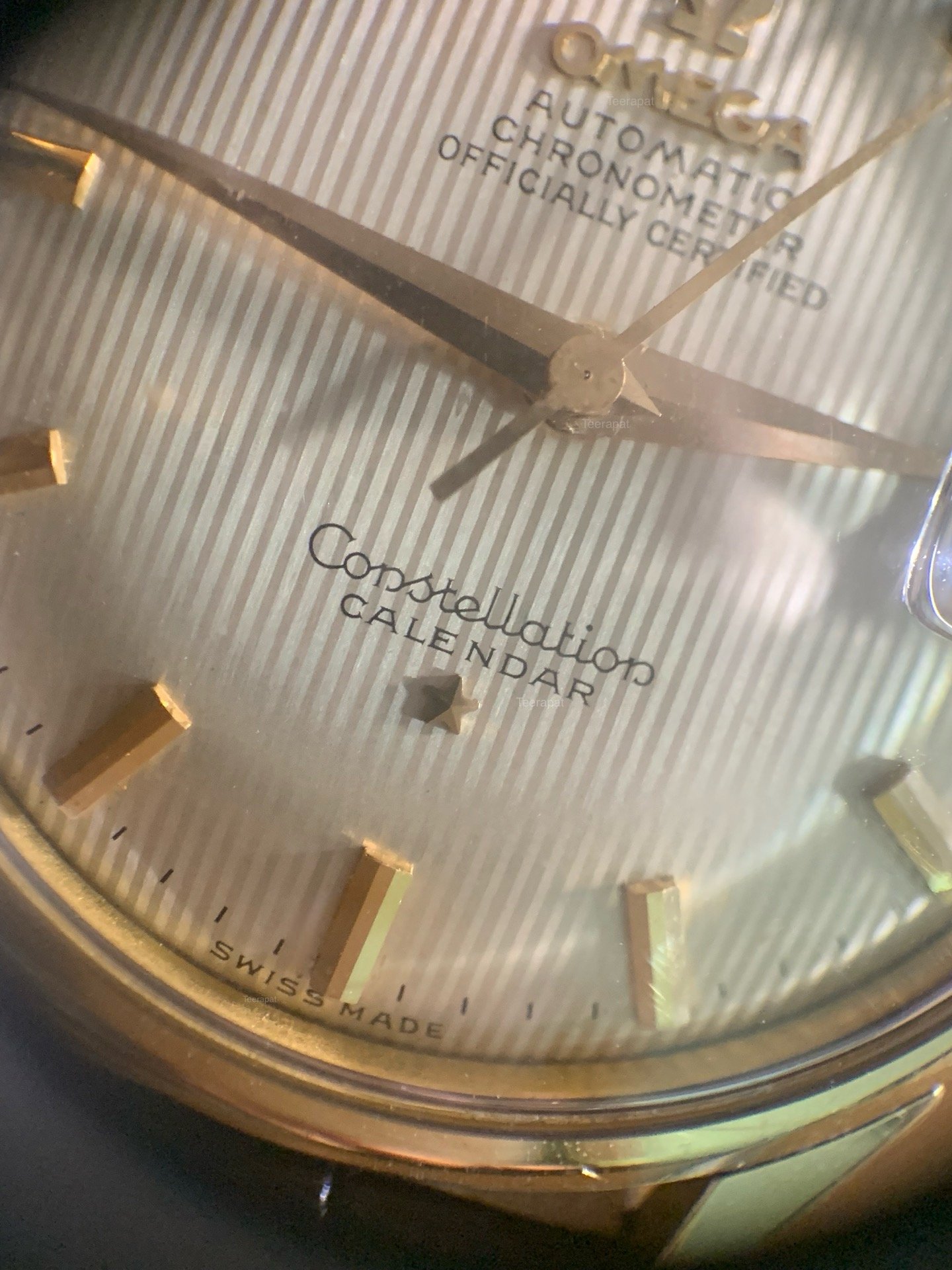

More natural light photography:
More close-up pictures:::psy::

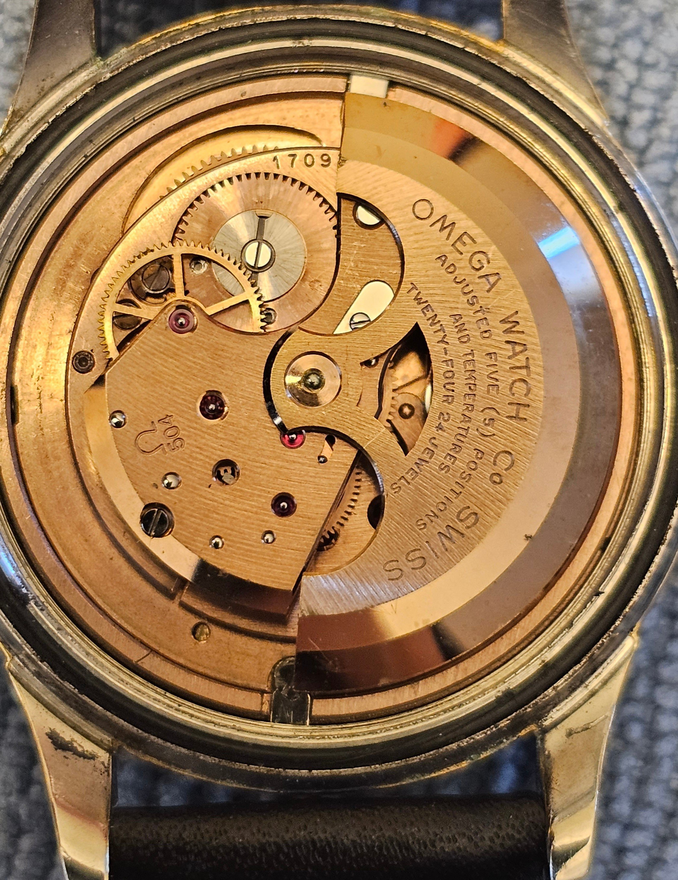

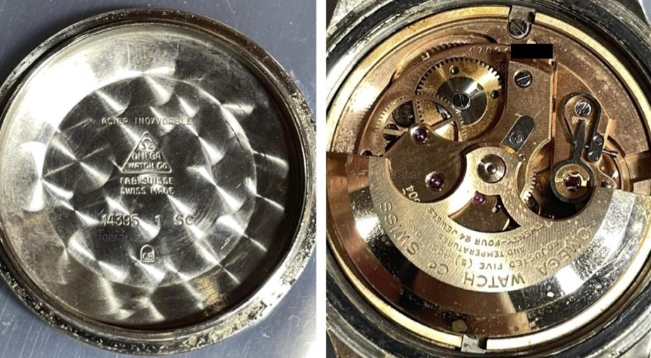

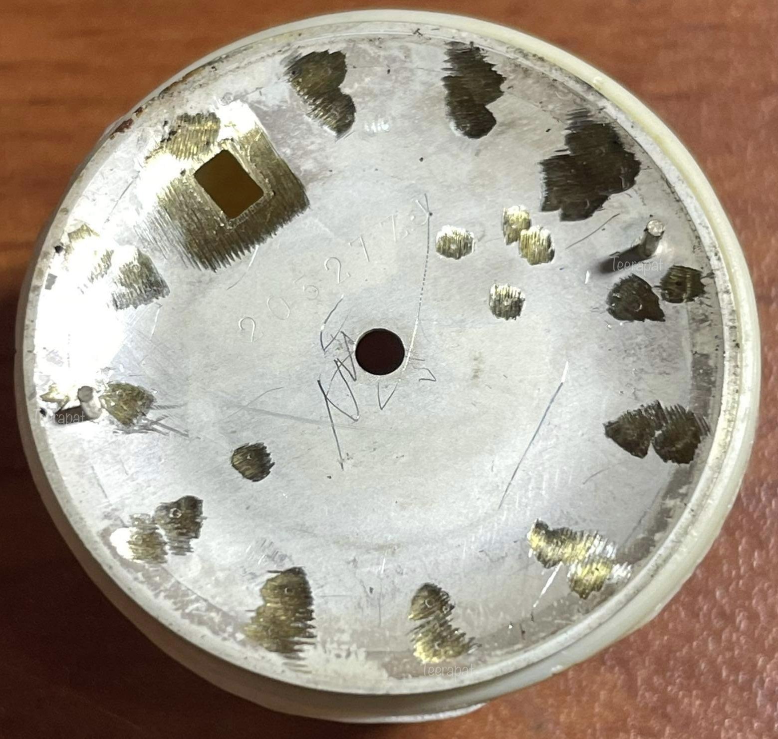

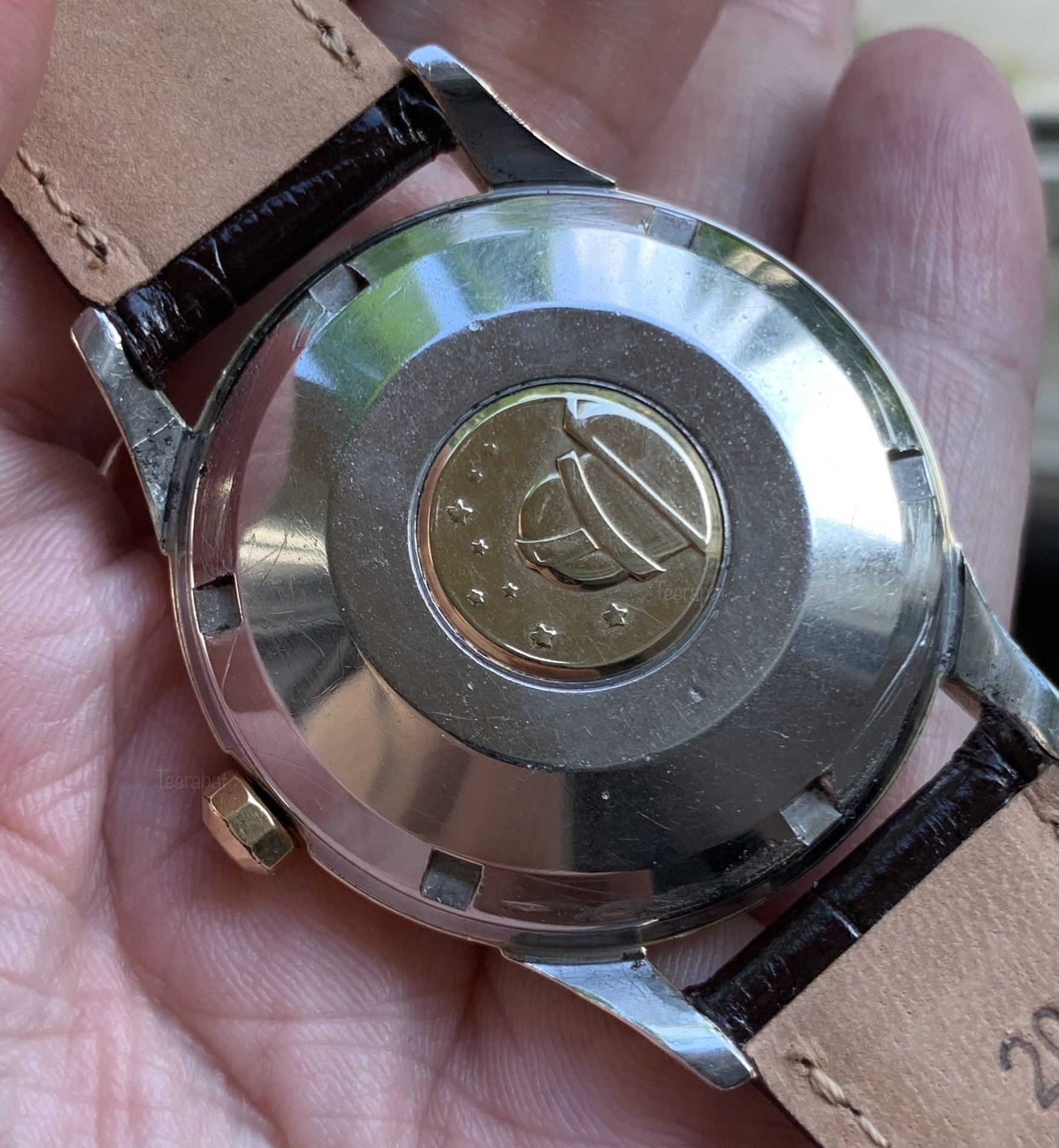

Again, for the uncommon watch I prefer to see the back side of the dial.
Please note that the dial’s legs are still intact, no sign of removed/reattached of the hour-markers.

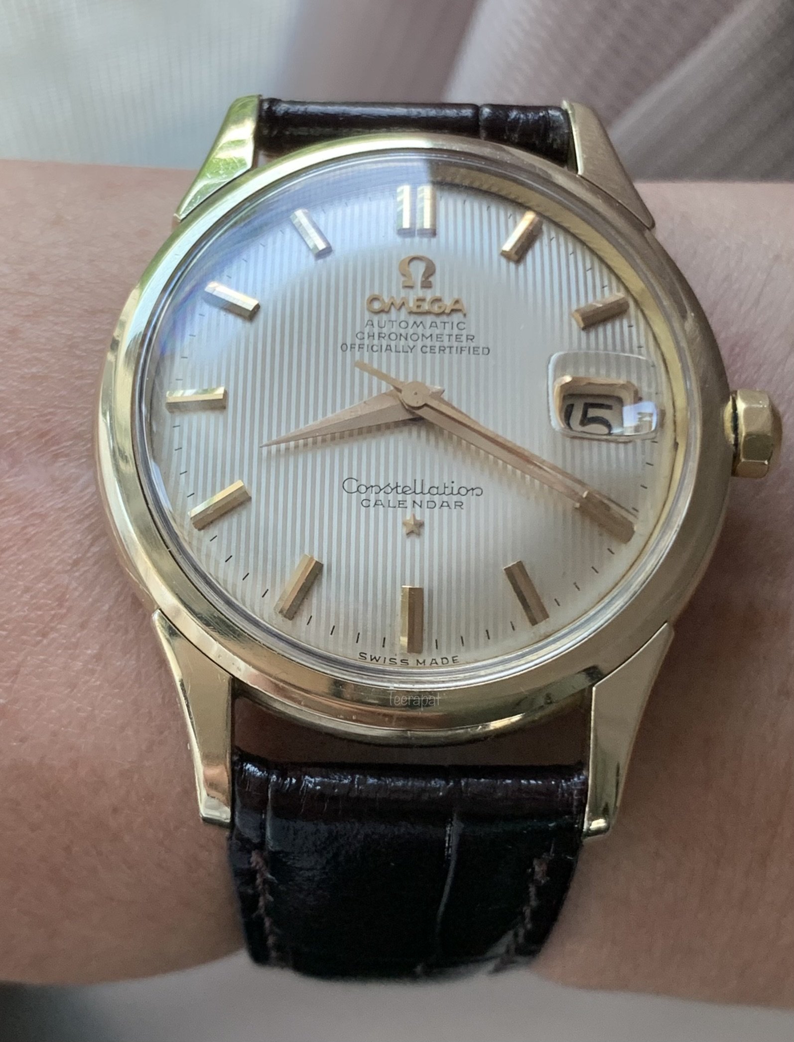

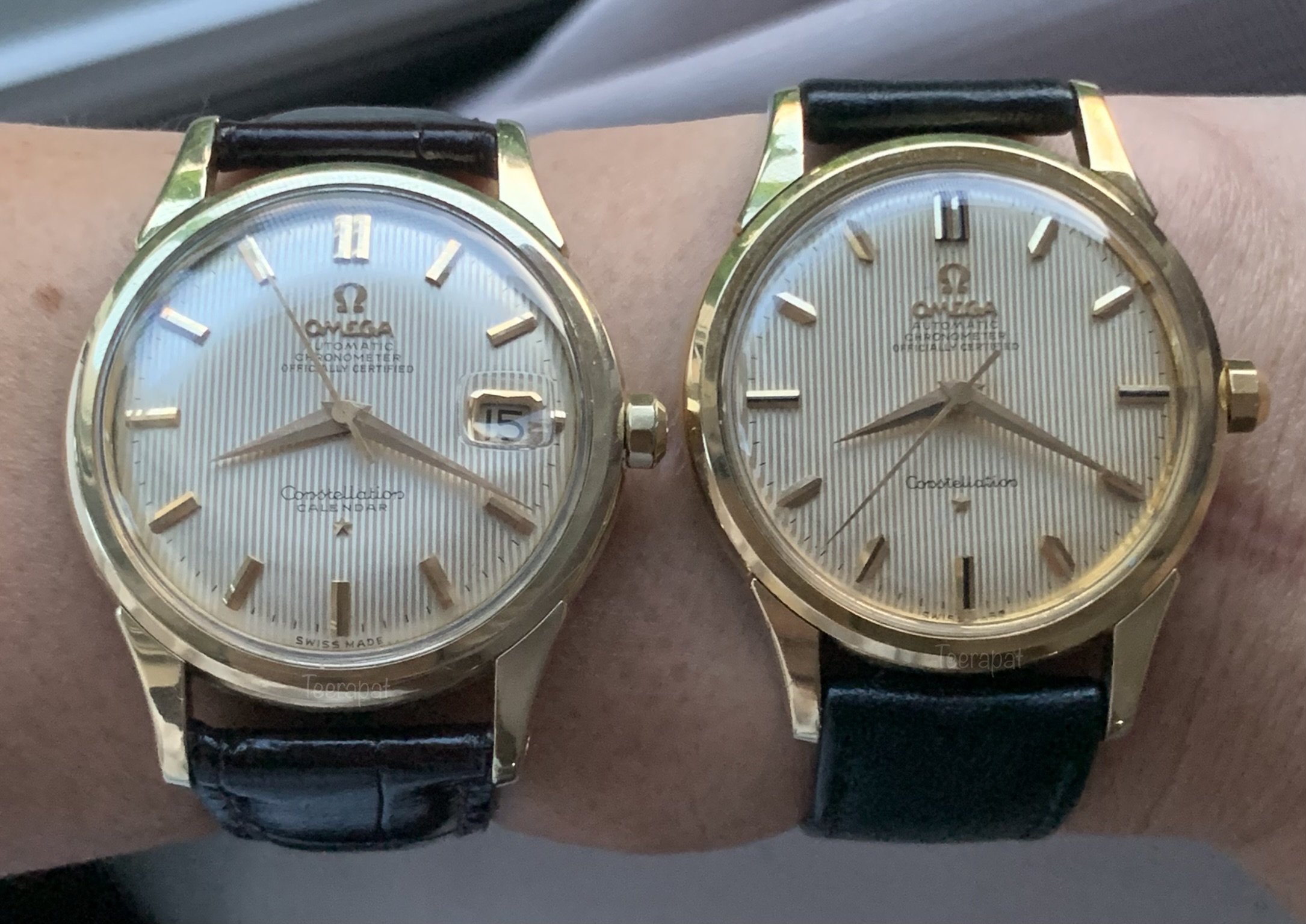

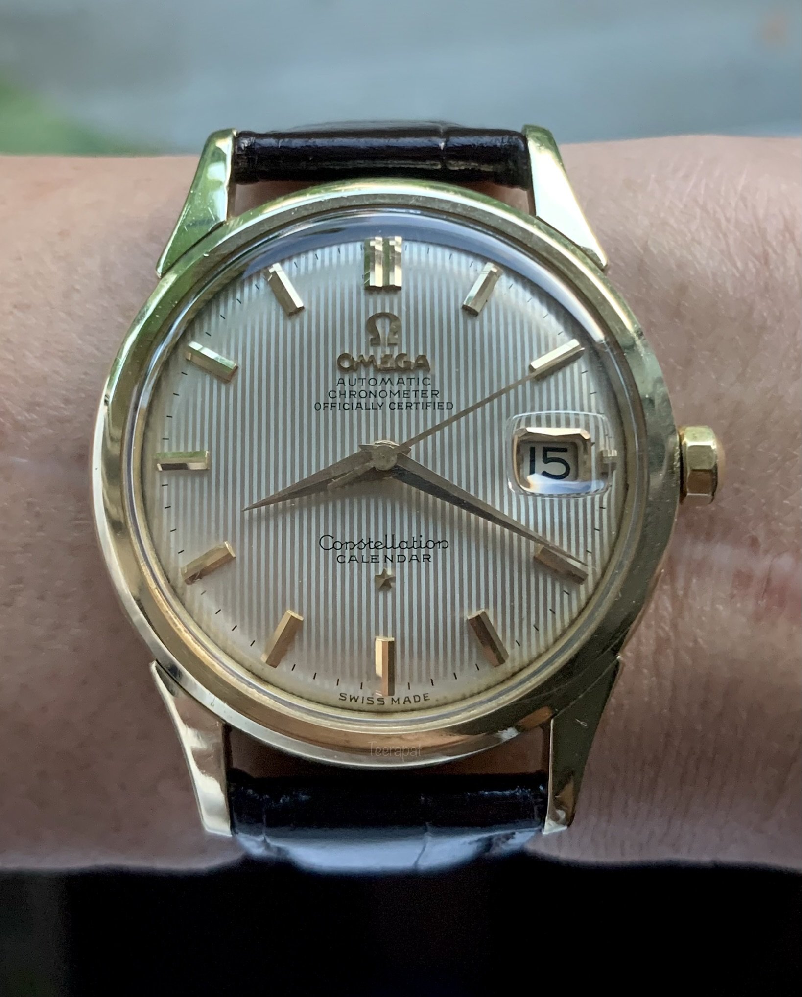

My wrist shot:

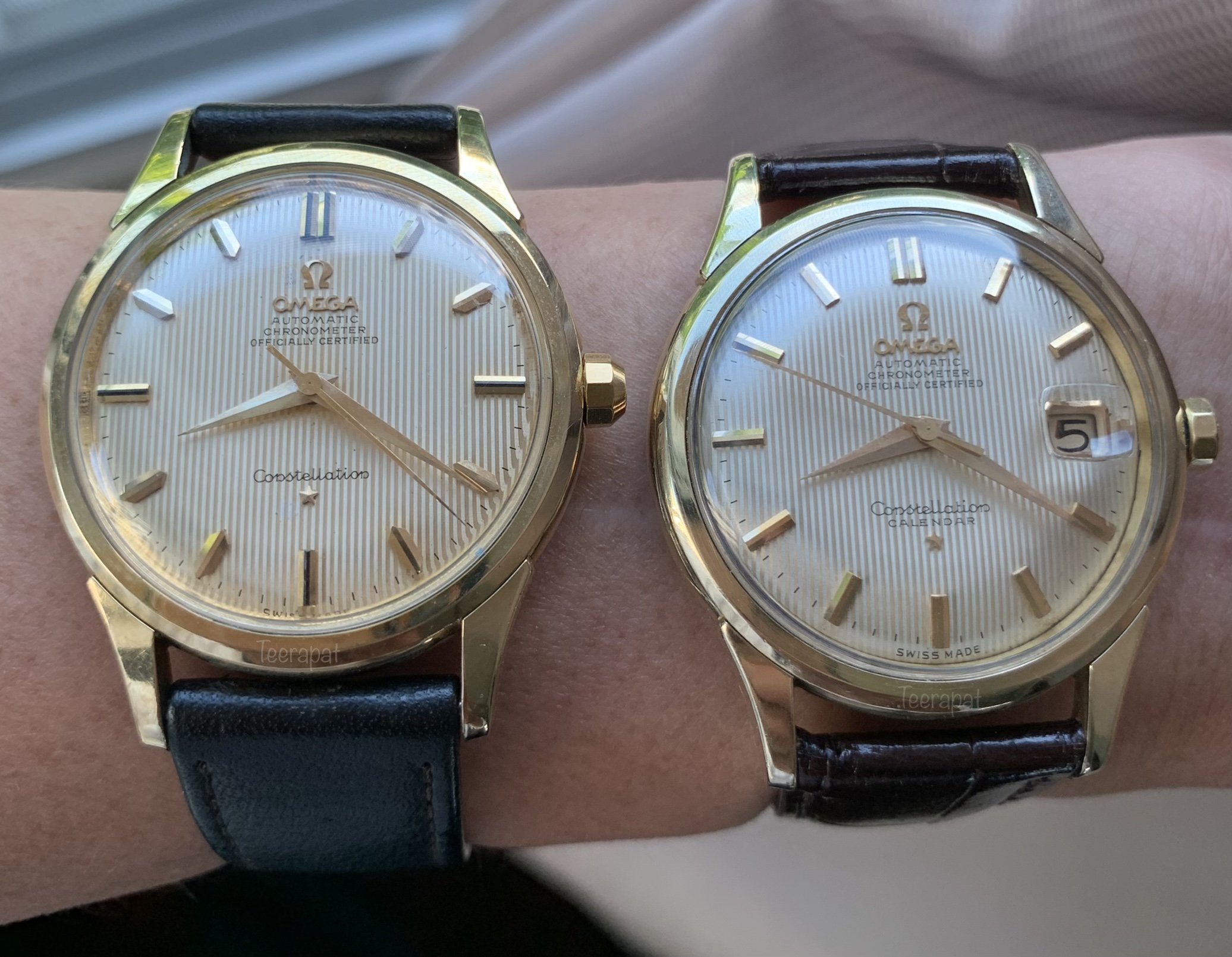

Please note that I already had one of this dial patterns in the reference 14395, however two of them in the reference 14395.
I share just the duo of them here:
My wrist shot again:😀

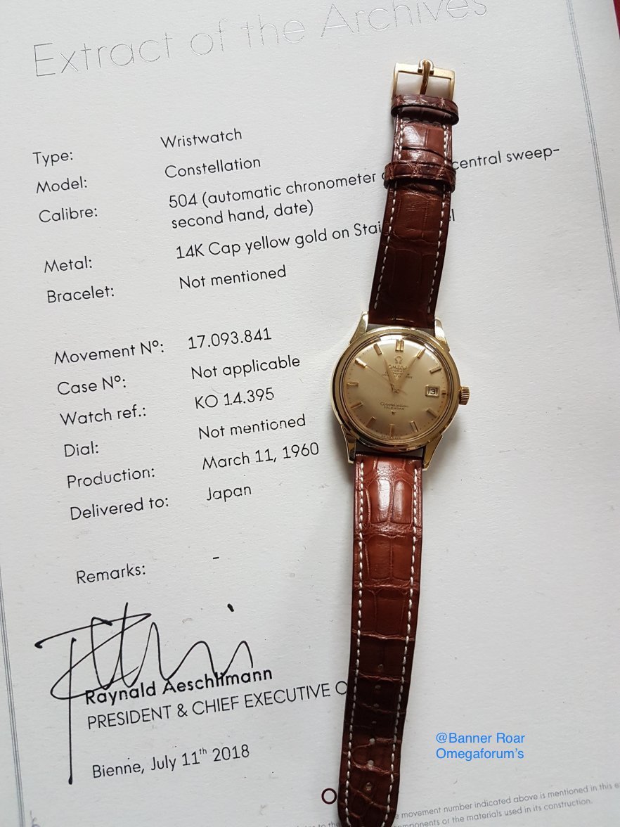

Please allow me to post the movement number of the “6 examples of reference 14395 that my research found.
- 17,093,584
- 17,093,xxx (most likely 17,093,883)
- 17,093,841
- 17,xxx,xxx
- Unknown movement number (for 2 examples)
- 17,091,7xx (my watch)
So, I found a total of “seven examples” in the reference 14395 with an original dial.

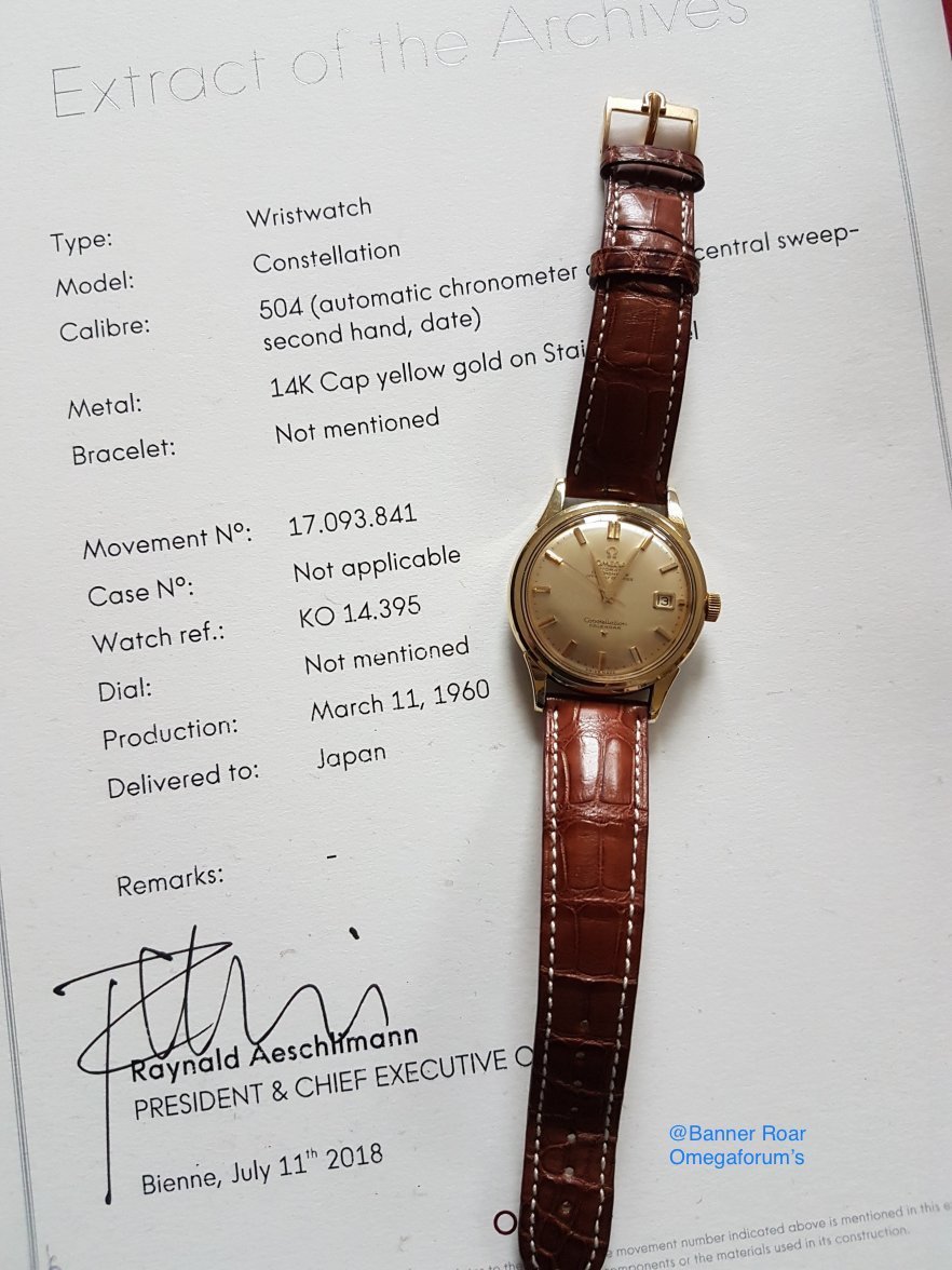

According to the extract (by @Banner Roar), my watch might be produced in February 1960 (or Early 1960).
The movement number of mine was lower around 2000.👍

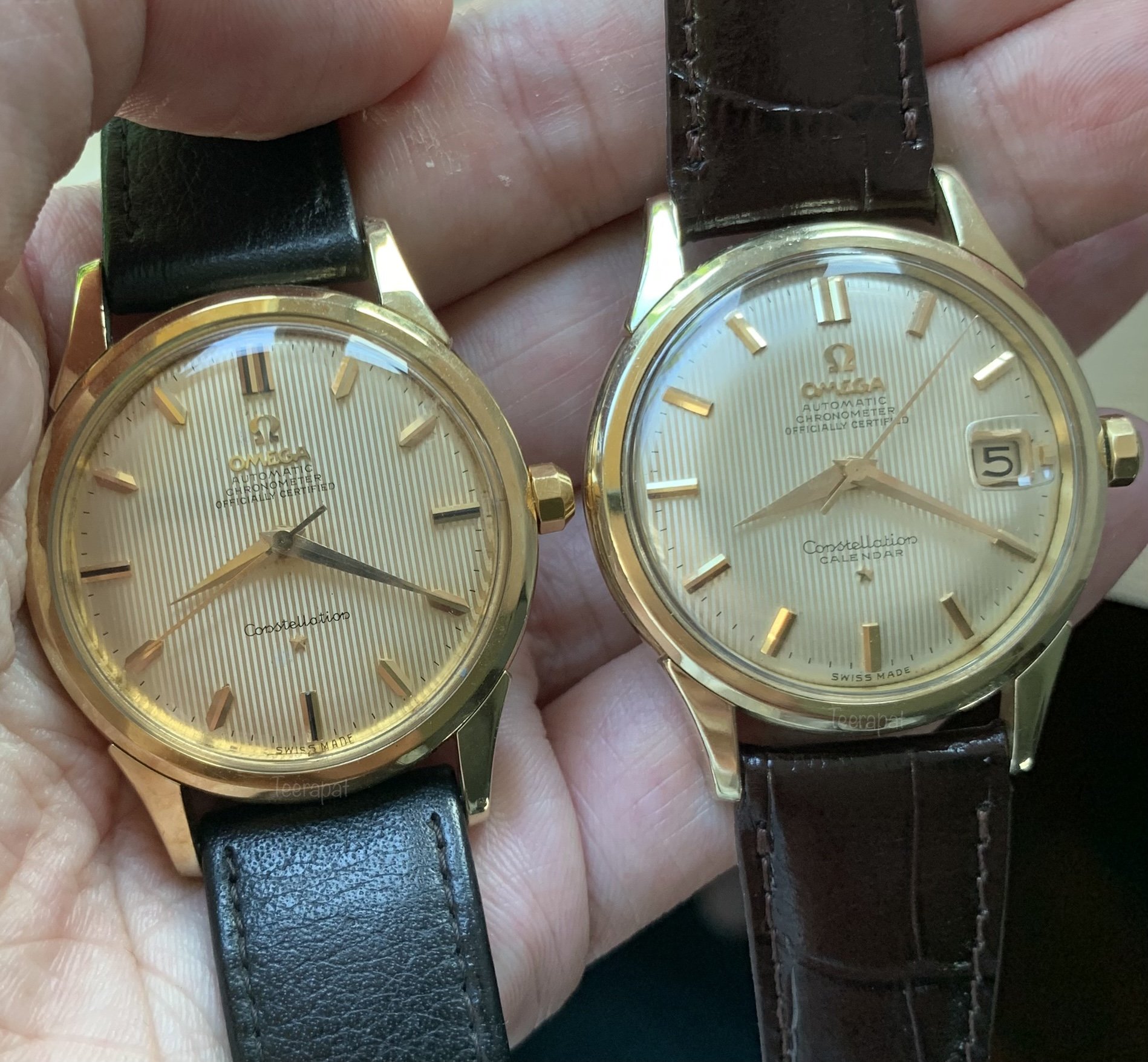

Some of this pattern in my collection.
1,024
4,126

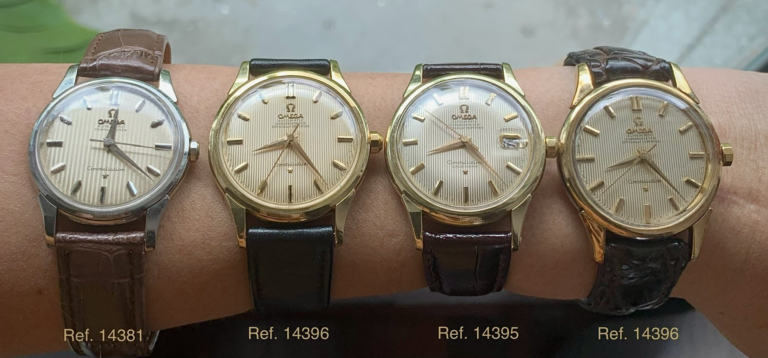

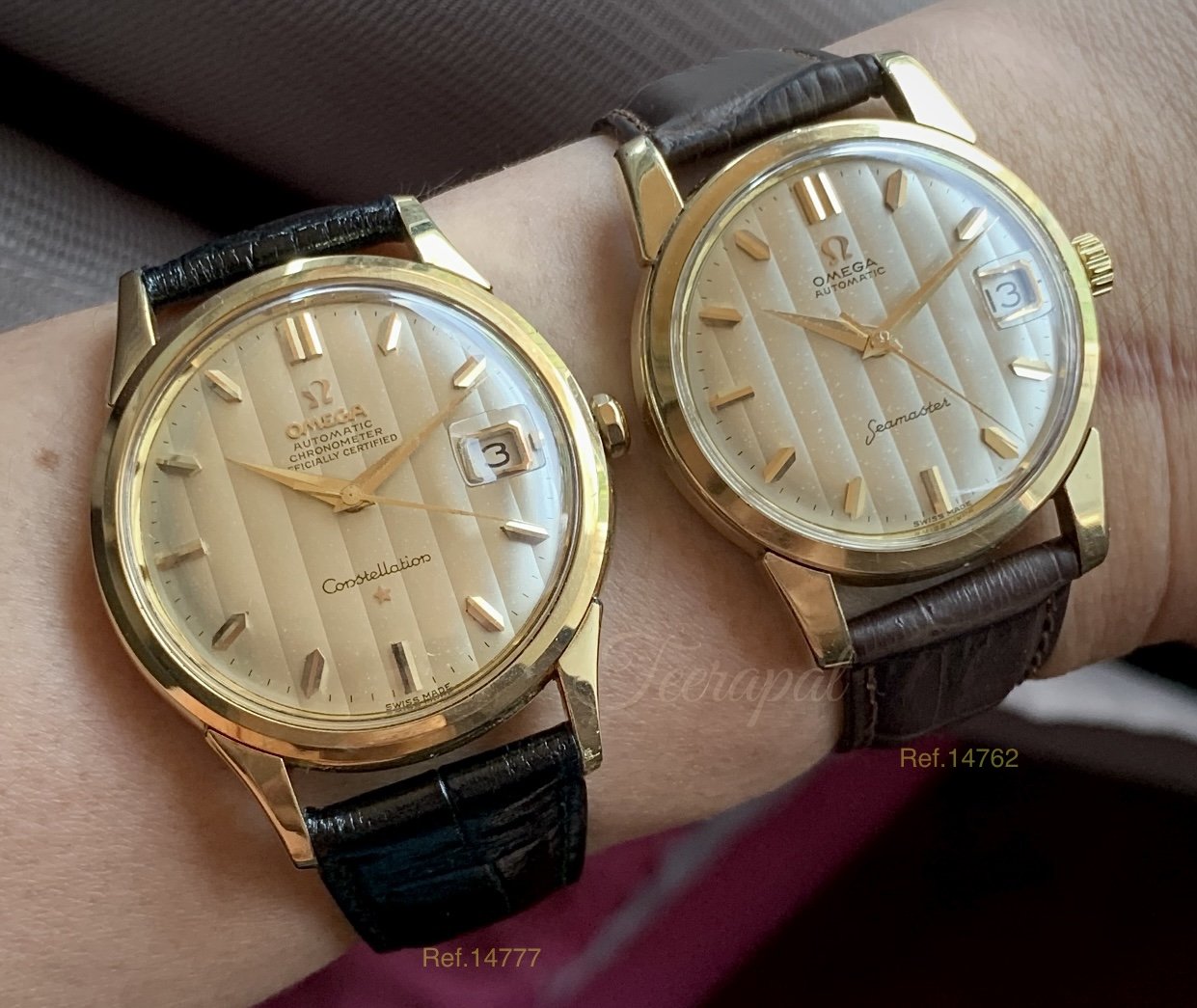

My today wrist shot.
Please note the difference in size between the jumbo (ref.14395 and 14396) and normal watches.
All of them with the small ribbon (or tapestry) dial pattern.

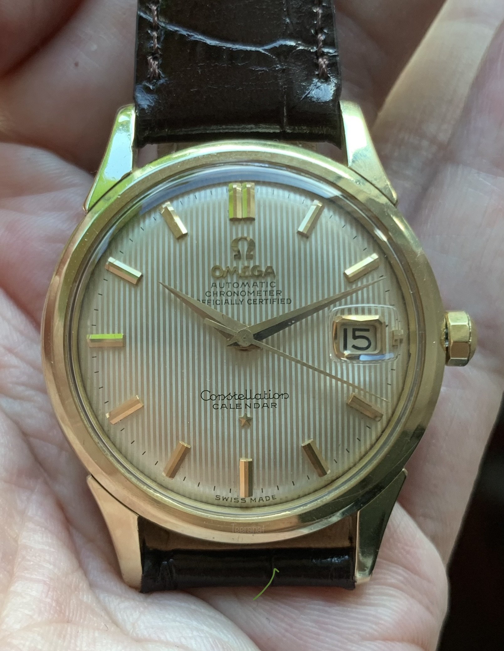

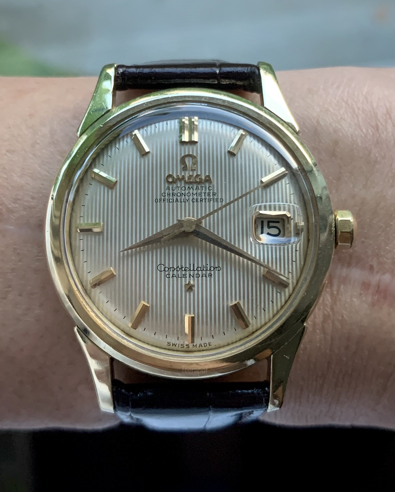

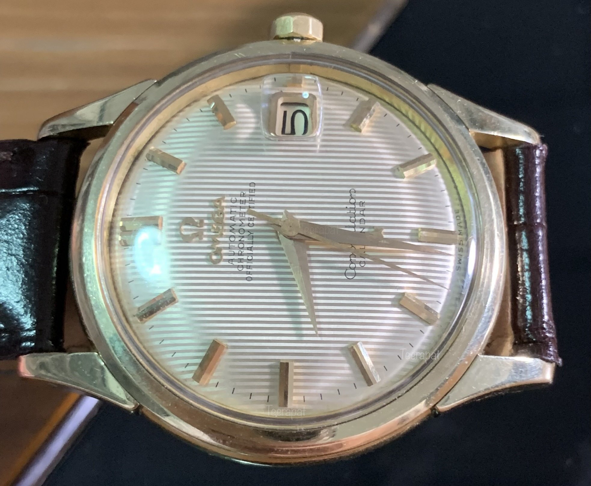

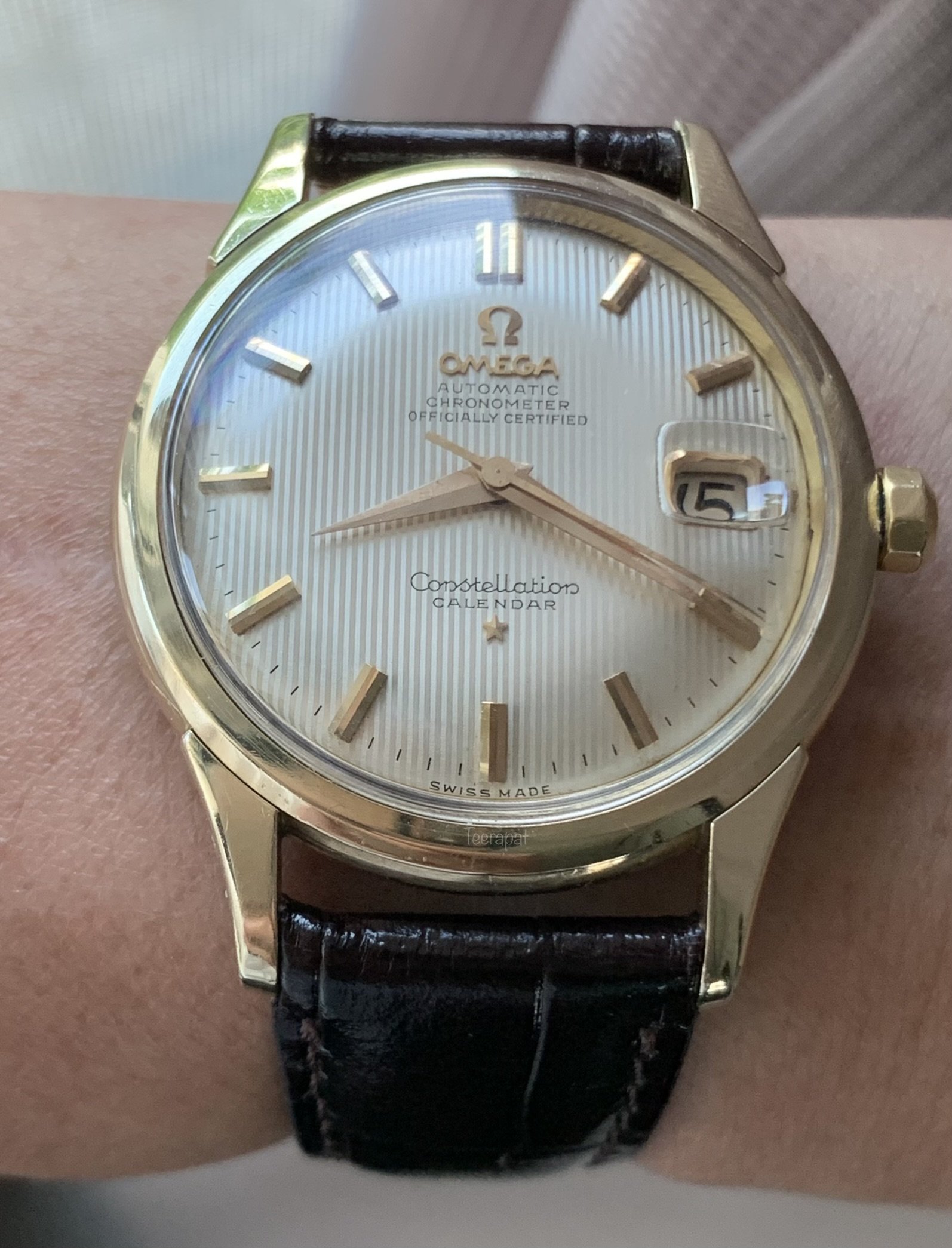

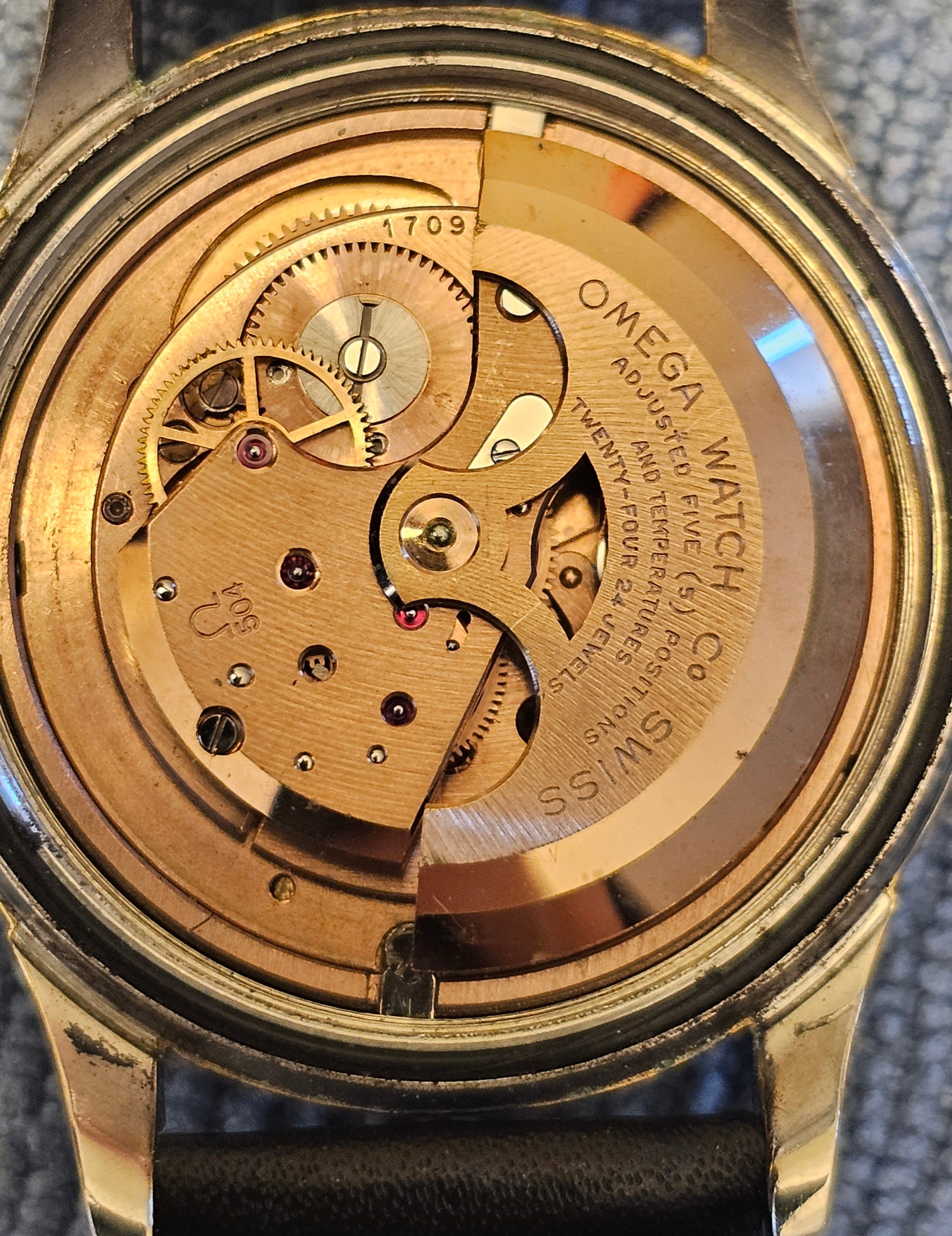

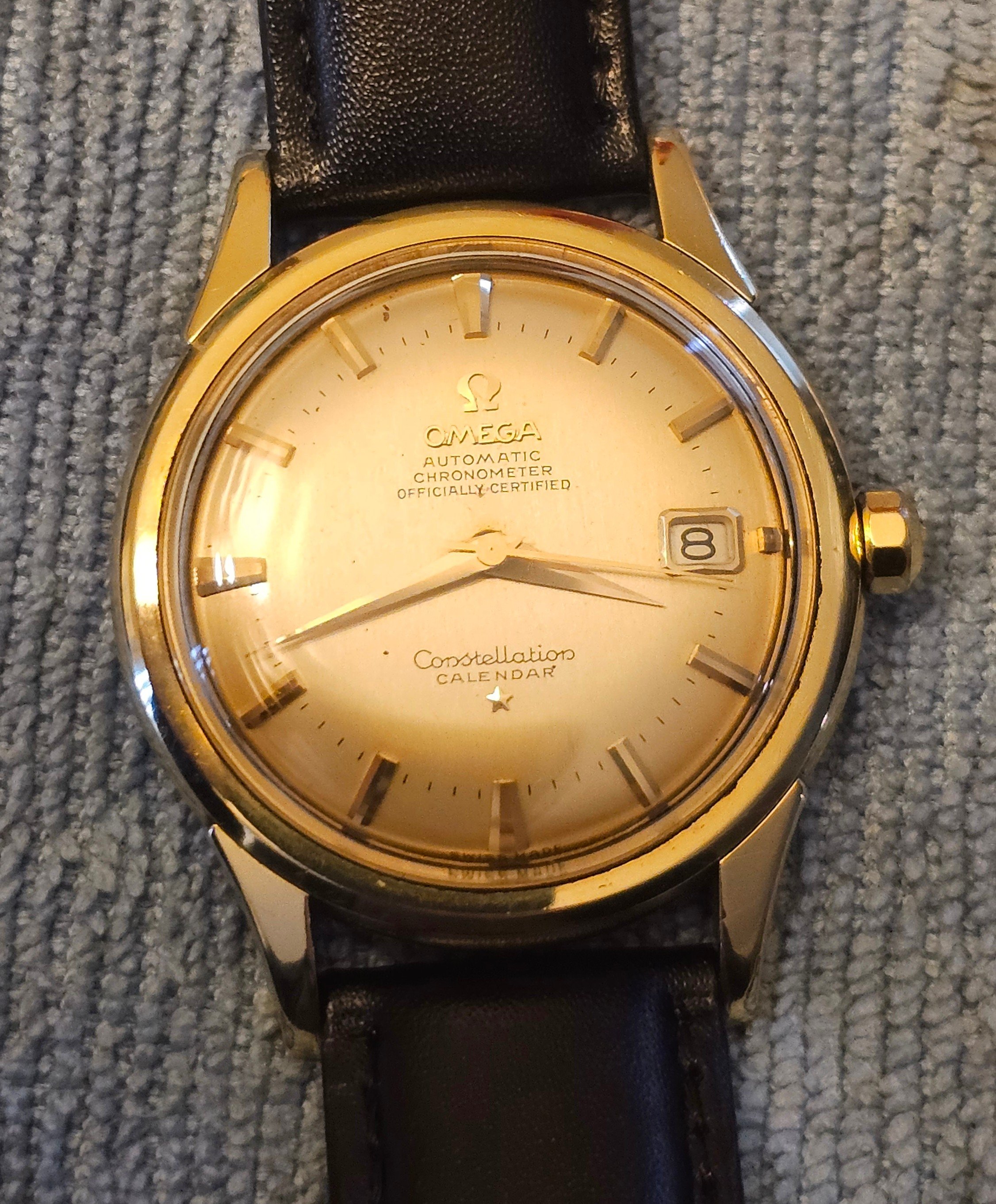

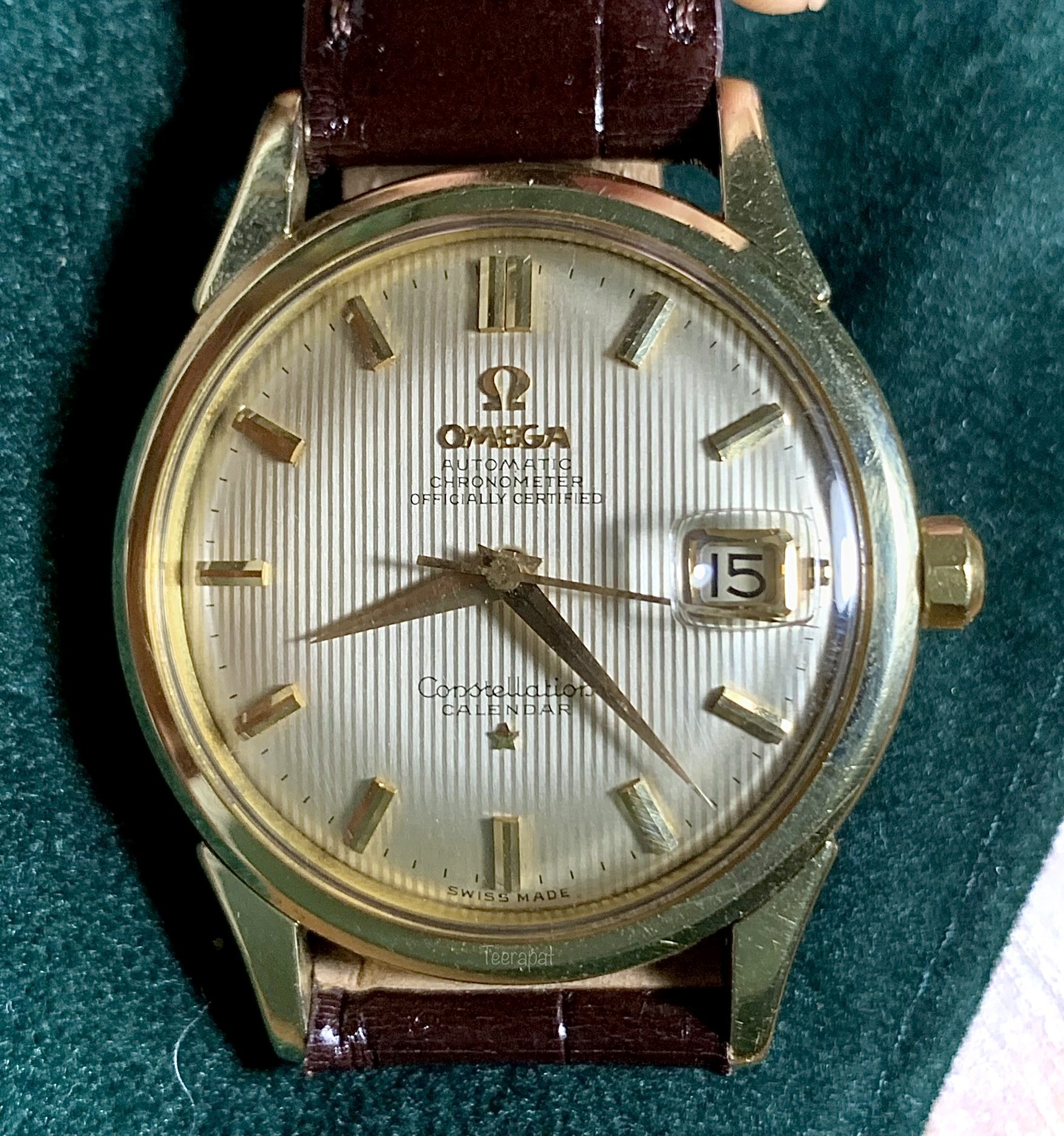

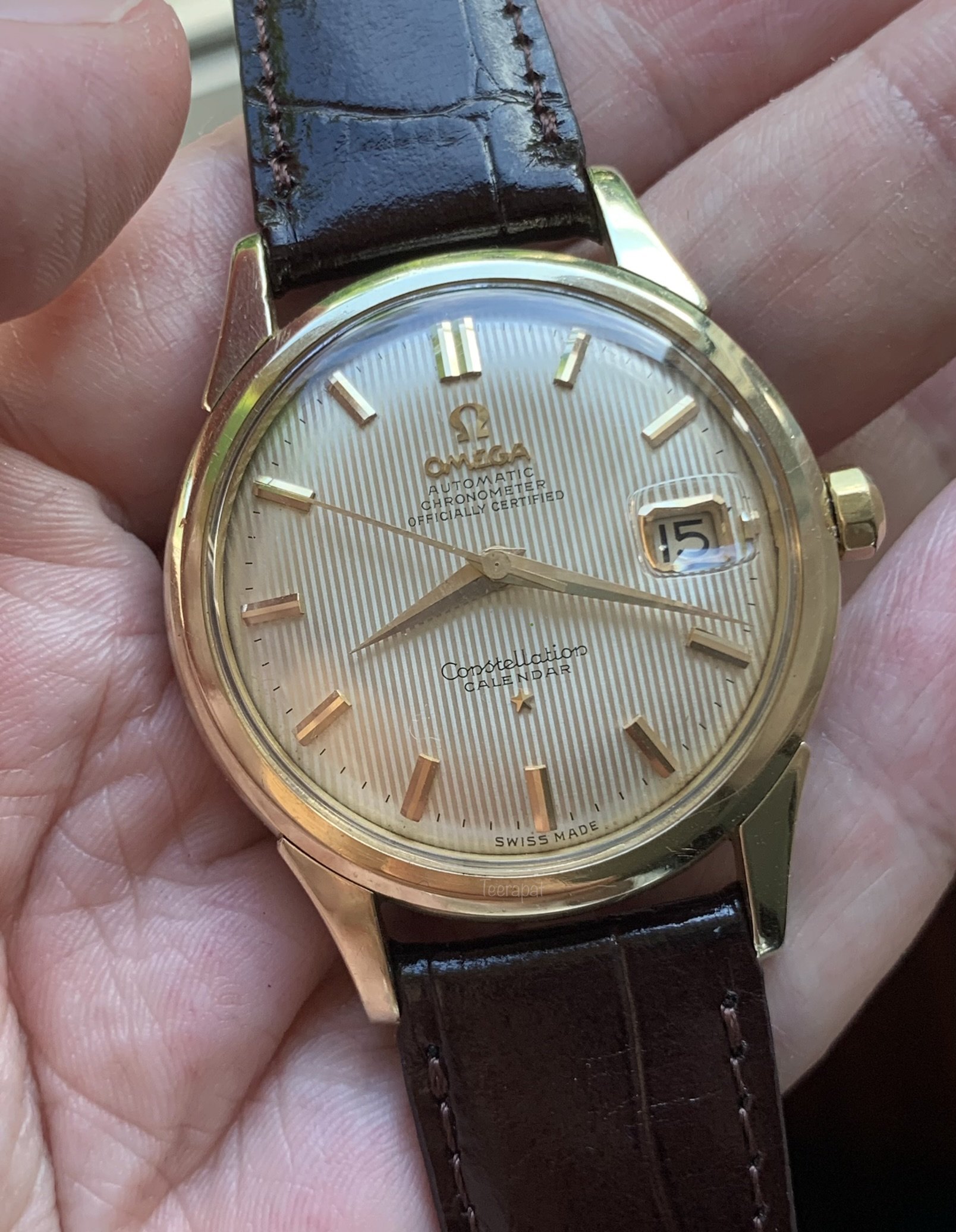

Here is my 14395 serial#170934xx which recently purchased.
1,024
4,126
Thanks for sharing @Barclay191.😉
From the picture provided, in my opinion, the fonts look good but I have a question on the “minute tracks”.
There are some inconsistencies, compared to an example I’ve seen.
Maybe I need to call, @Shabbaz which I believe he owned the same dial pattern with @Barclay191.
Also other people, please feel free to share your ideas.😀

I update the lists of all “8 examples” in the ref.14395.
It might be used as a referencing datasheet.😉
I noticed that all of the known movement number from 5 examples, it will be 17,09x,xxx.

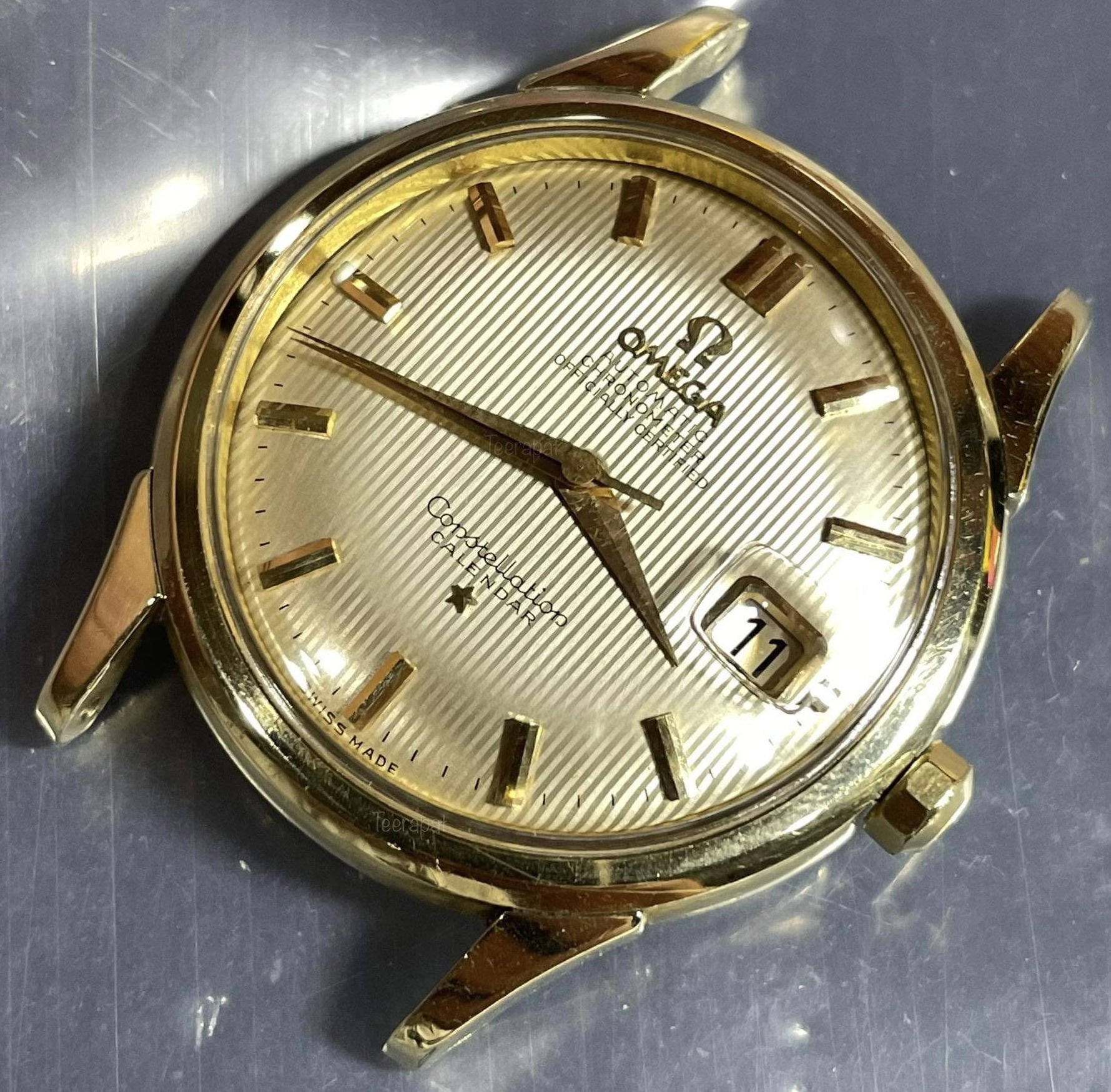

1,024
4,126

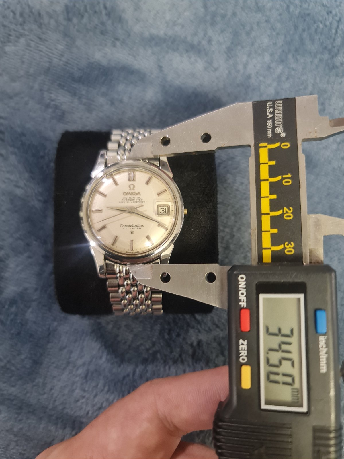

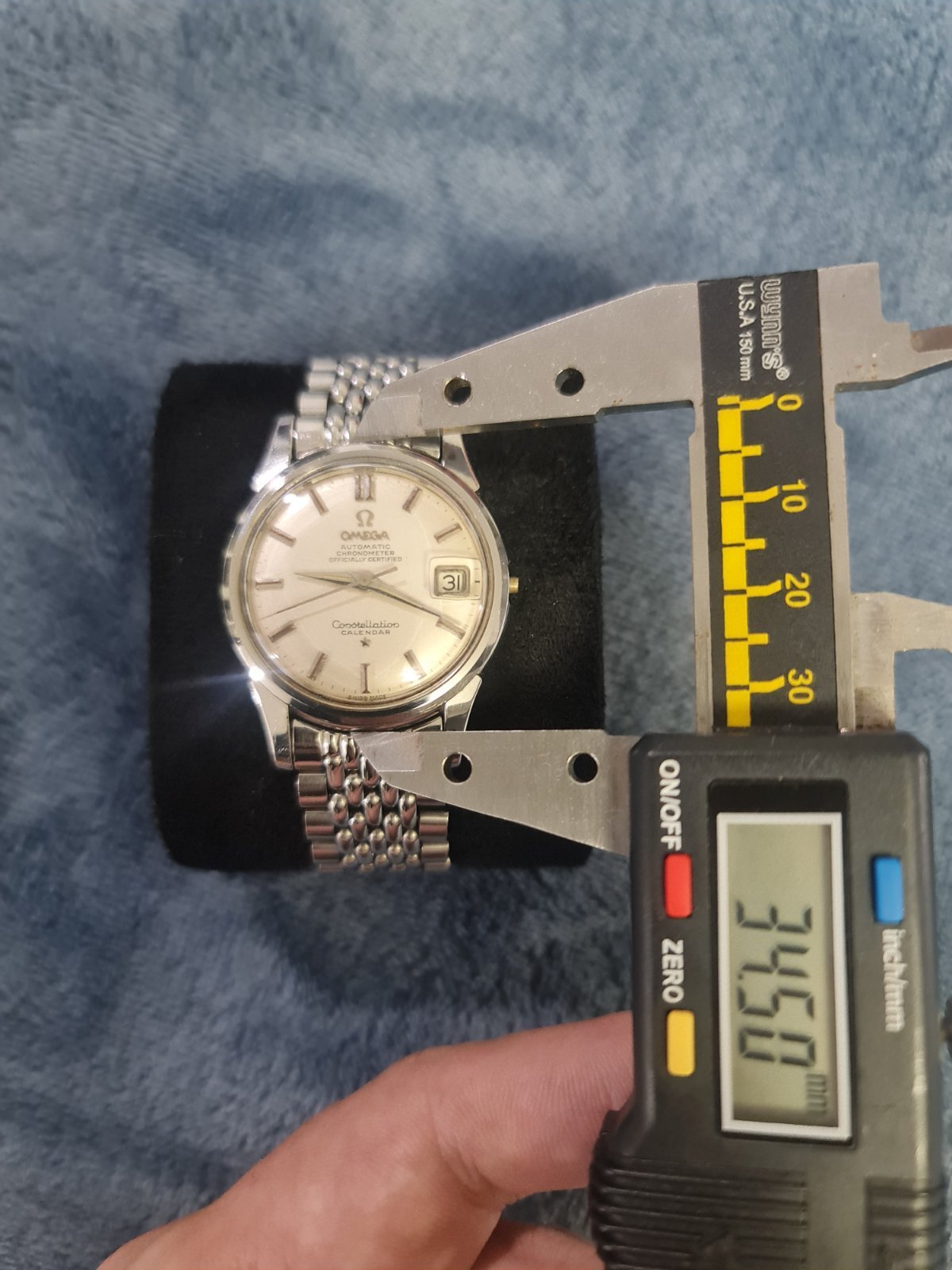

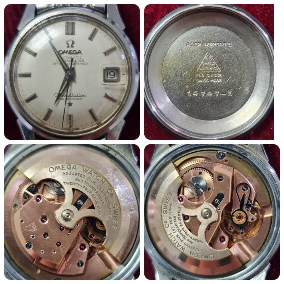

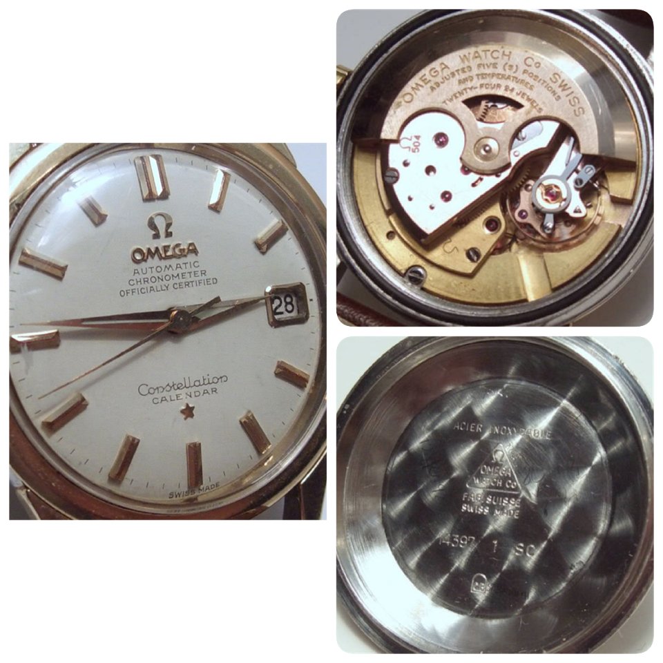

Thanks a lot Mathieu for sending me the image measurement. I mentioned about this watch earlier in my original thread.
Photo courtesy of @Custodian914 .😉
Also, I discussed with Hoi via PM. He mentioned that the case of his 14397 was not the jumbo size.
It can confirm my assumption that “reference 14747 and 14397 was not the jumbo reference”.😀
