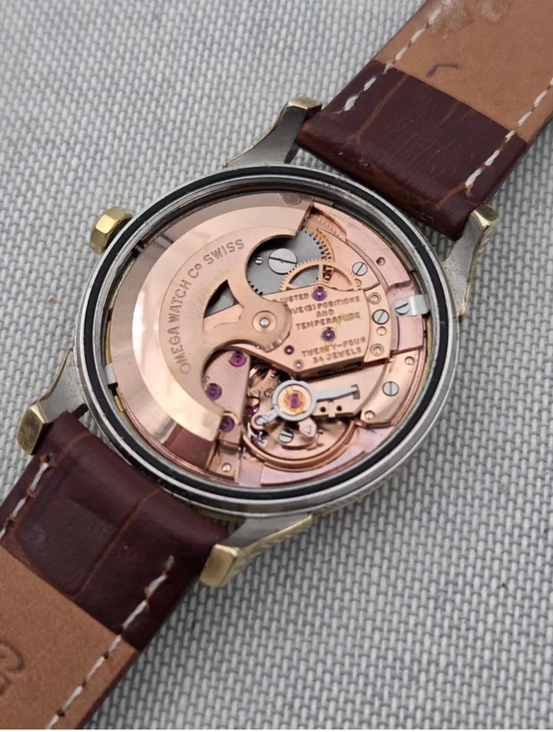

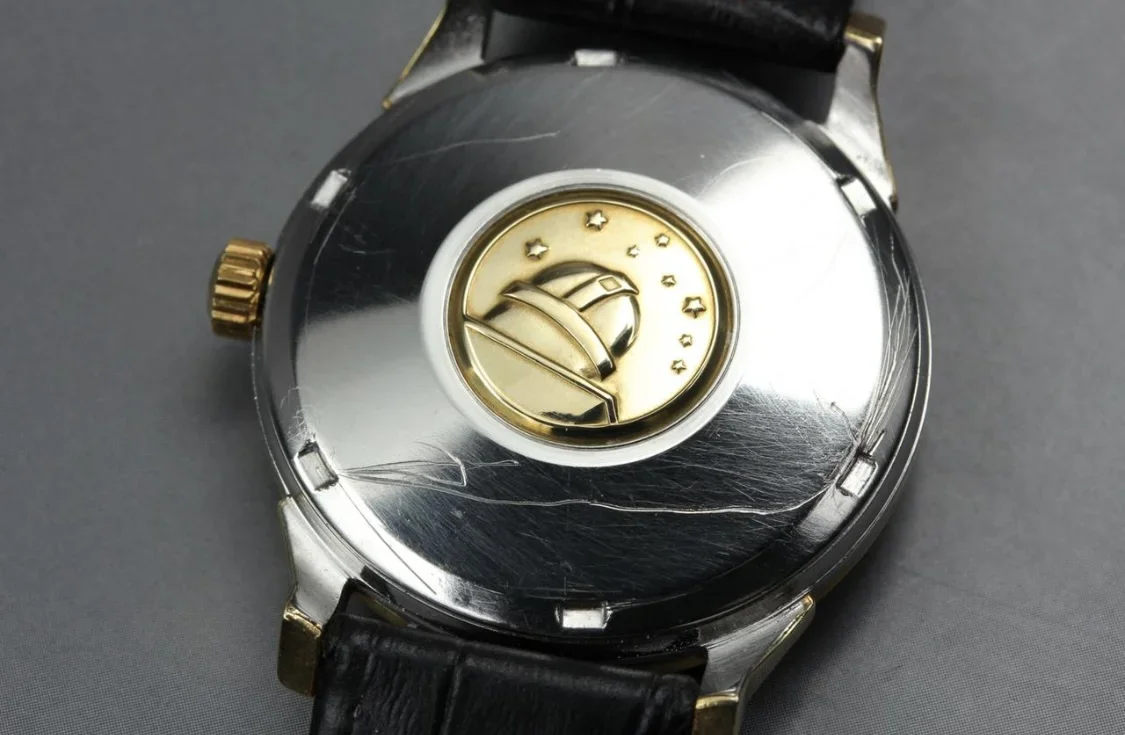

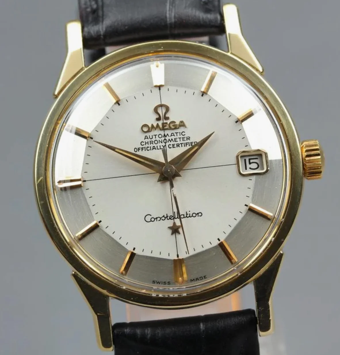

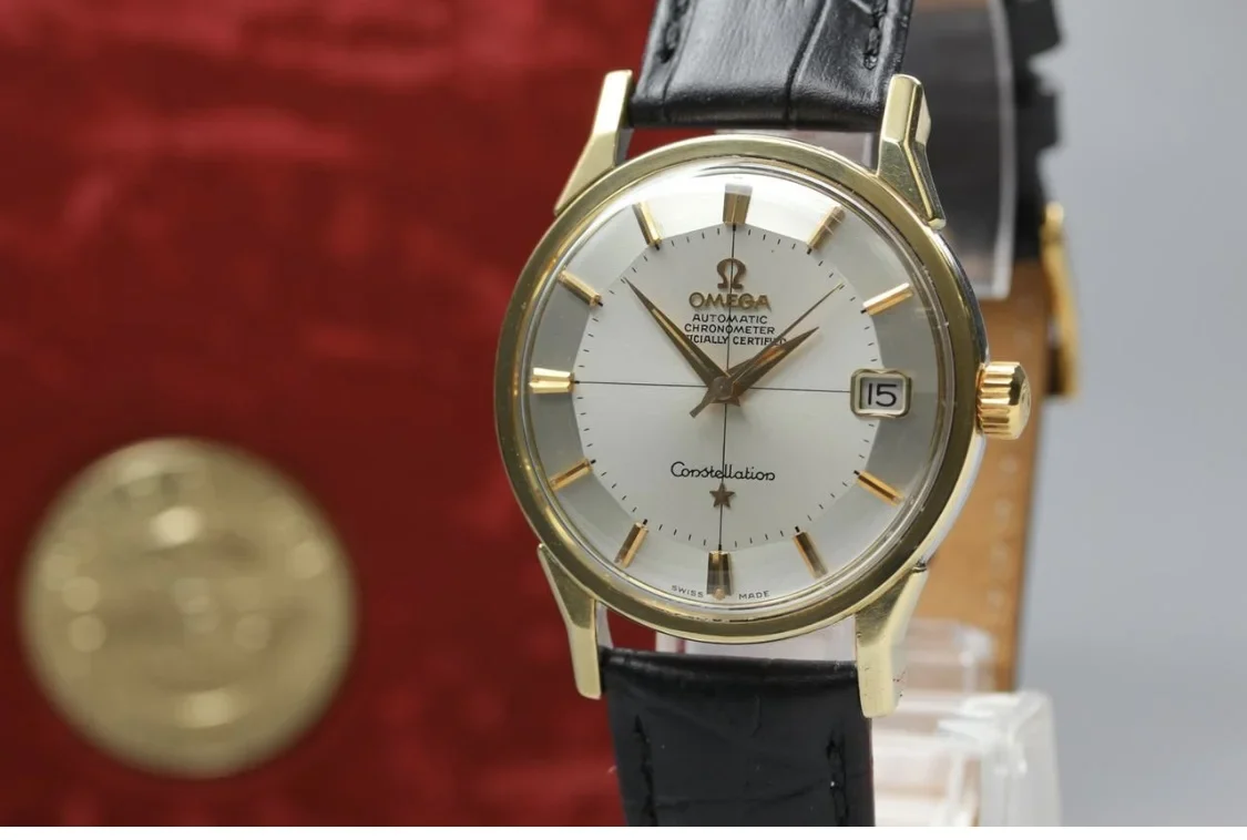

Avoid the presented watch for several reasons:
Price is way too high
Wrong crown
Too much polished - you can see best on the "melted" lug edges

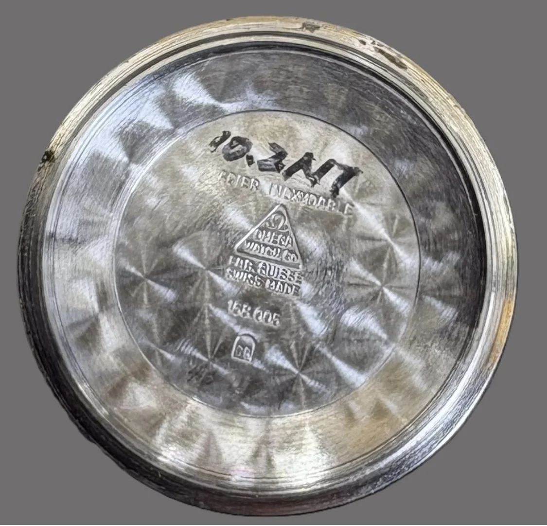

Badly scratched back
Scratches on the movement
You can do much better for this kind of money but you have to be patient until the right one will show up.
These dog leg Connies are not rare...
6,836
10,508
Welcome @Pierre35
@mac_omega is correct to advise you to avoid this watch.
€3400 for a perfect gold capped dogleg pie pan would be an obscene price but for one that is distinctly over polished is verging on a crime.
(BTW the watch appears to be from a Japanese seller, and if so, would also attract import duties as well)
The box is not original to the watch - probably from at least 10 years later.

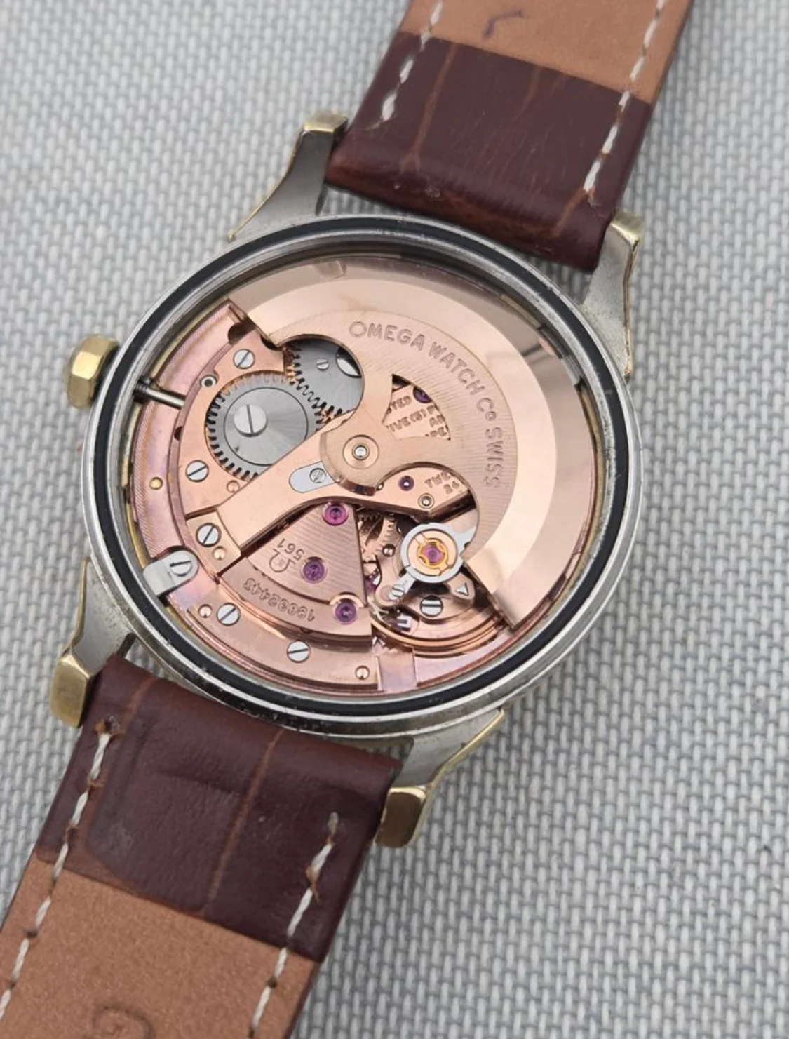

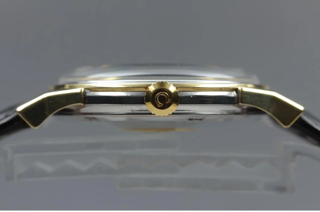

Thanks for the feedback! I don’t see an option to edit my post for the pictures so here they are.

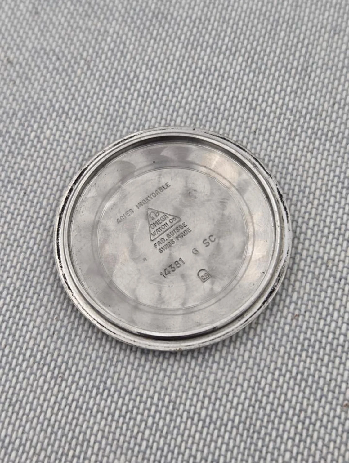

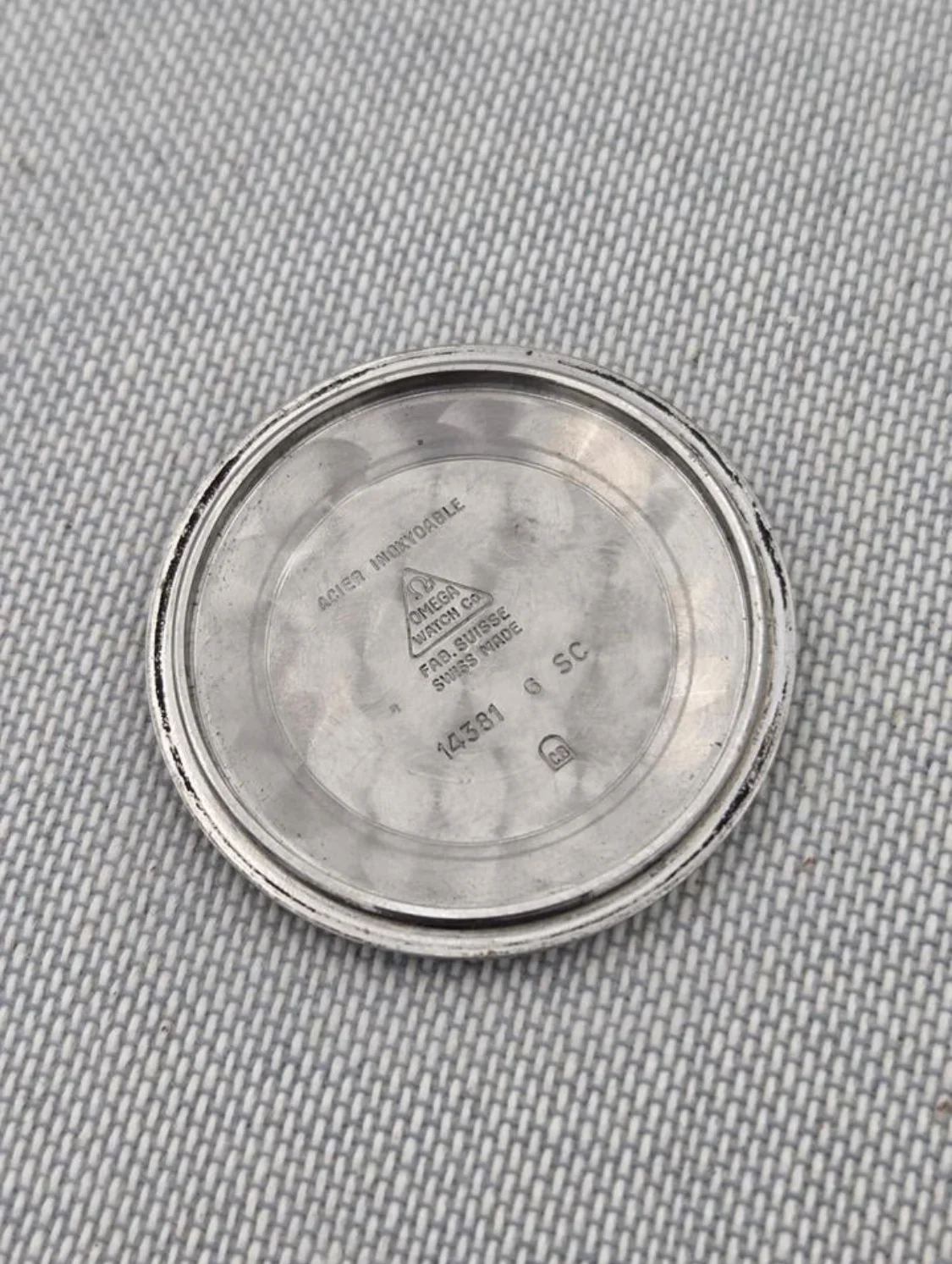

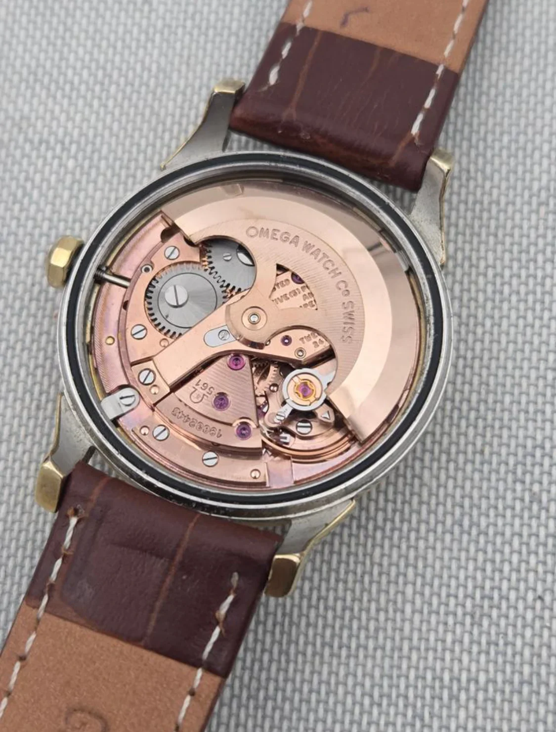

A new one posted on Chrono24 that fits my configuration wish. But too expensive and I have doubts about the dial. The cross hair and the writing looks very thick no? Also the MOY seems a bit too much to the left and the interior of the case back doesn’t look great.
I’m pretty sure I’ll pass this one. But still welcome your thoughts !

Hello @Pierre35
How is the watch described?
You need to slow down and really get into Constellations before you buy anything.
The dial is a very poor redial - most likely a dome dial repainted to look like a pie pan.
The case back says 14381 but the mid case is a dogleg.

It only says “Pie pan dog leg gold cap similar to 168.005”.
Yes I had big doubts about the dial, thanks for confirming !
I didn’t know about the 14381 reference, is it supposed to be for pre dog leg designs ?
This is what I meant about doing a deep dive into Constellation references.
The links @SOG53 posted are ideal reference material.
The 14381 (no date) and 14393 (date) are late lyre lug references.
A dogleg is a dogleg, there are no Constellation references that are ‘similar’.
The caseback doesn’t belong to the midcase and the dial is just awful on this watch.

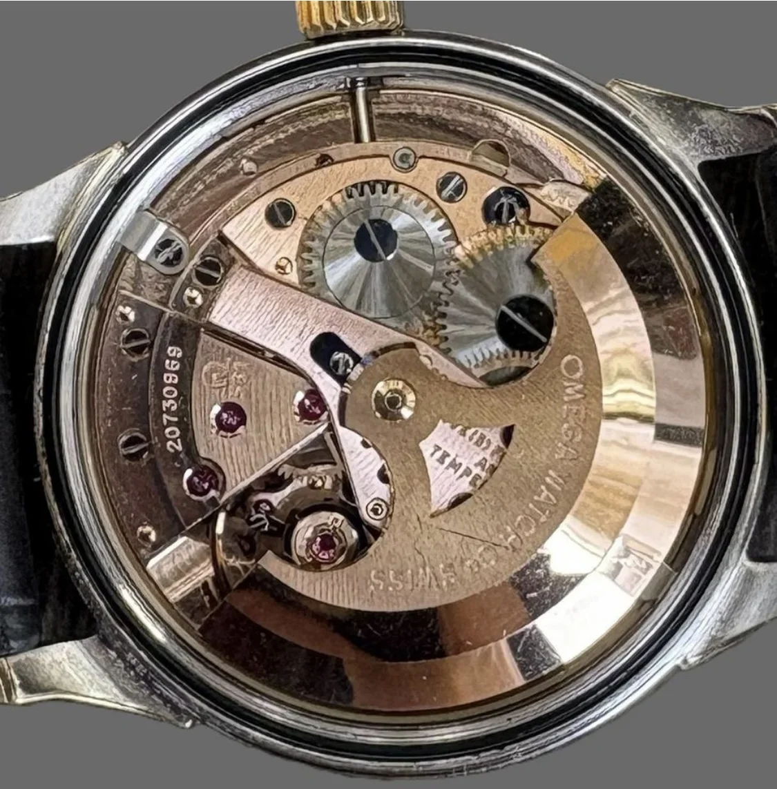

Hi everyone,
I found a new one that fits my criteria.
It’s currently listed ant 3395€.
I can see the legs are heavily polished but that’s the only issue I’m noticing with this one.
And on that regard, is there a way to get them back to their original design?
So here is the (interesting part of the) description and the pictures:
Introducing a beautifully preserved Omega Constellation Pie Pan from 1966 - one of the most iconic and collectible Omega designs of the 1960s.
This elegant Constellation features a stunning silver-colored crosshair Pie Pan dial with applied gold-toned indices and matching dauphine hands. The black inlays provide excellent contrast, while the applied Constellation star and framed date window at 3 o’clock complete the unmistakable vintage design.
The classic gold-capped stainless-steel case features Omega’s distinctive faceted “dog-leg” lugs and the famous observatory medallion on the caseback. Measuring approximately 34 mm excluding the crown, it offers the refined proportions expected from a high-grade dress watch of this period.
Inside is the highly regarded Omega Caliber 564 - an automatic, chronometer-certified movement with quick-set date functionality. The watch has recently been fully serviced by an Omega-certified watchmaker and is performing exceptionally well, with a measured time deviation of only +1 second per day and an amplitude of 266°.
A beautiful example of Omega’s celebrated Constellation collection, combining iconic design, excellent mechanical performance and timeless elegance.
Specifications
Manufacturer: Omega
Model: Constellation Pie Pan
Reference: 168.005
Manufacturing Year: 1966
Movement: Omega Caliber 564
Winding: Automatic mechanical
Movement Serial: 24,788,509
Jewels: 24
Frequency: 19,800 BPH
Time Deviation: +1 second/day
Amplitude: 266°
Functions: Hours, minutes, central seconds and quick-set date
Certification: Officially Certified Chronometer
Case: Gold-capped stainless steel with distinctive dog-leg lugs, very good vintage condition
Caseback: Stainless steel with gold-toned Constellation observatory medallion
Diameter: Approximately 34 mm excluding crown
Dial: Silver-colored crosshair Pie Pan dial with applied gold-toned indices and black inlays, very good vintage condition
Hands: Gold-toned dauphine hands with black inlays, very good condition
Crystal: New Sternkreuz plexiglass crystal (non-Omega original, aftermarket product)
Crown: Omega-signed gold-toned crown
Strap & Buckle: Brand-new black leather strap with gold-toned buckle (non-Omega, aftermarket products)
Box: Brand-new red Omega presentation box
Service & Warranty
The watch has recently been fully serviced by an Omega-certified watchmaker.
The watchmaker is a qualified professional with a journeyman’s certificate and has completed advanced training with the Swatch Group, the owner of Omega. As an Omega-certified watchmaker, he has access to Omega’s official parts portal and follows Omega’s service guidelines, using genuine Omega parts whenever replacements are required.
A one-year mechanical warranty is included from the date you receive the watch. The warranty covers problems with the movement, timekeeping and other mechanical functions. It does not cover water damage, impact damage or damage caused by improper handling.
6,836
10,508
My heart bleeds for anyone trying to buy a dogleg pie pan in this market.
The price of this watch is utterly ridiculous.
The lugs have lost so much definition that I’m surprised that the gold cap hasn’t been worn through - and essentially, to all intents and purposes, is no longer a dogleg case.
Unfortunately, you can’t reinstate dogleg lugs successfully without it looking artificial and especially not on a gold cap case.
Definitely keep looking for a better example.

Yep, gold cap cases generally have a softer look due to the cap being formed over the substrate, but this one is melted butter soft!
I agree, keep up the hunt.

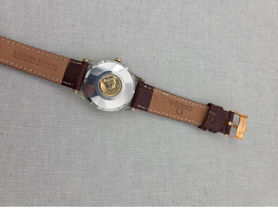

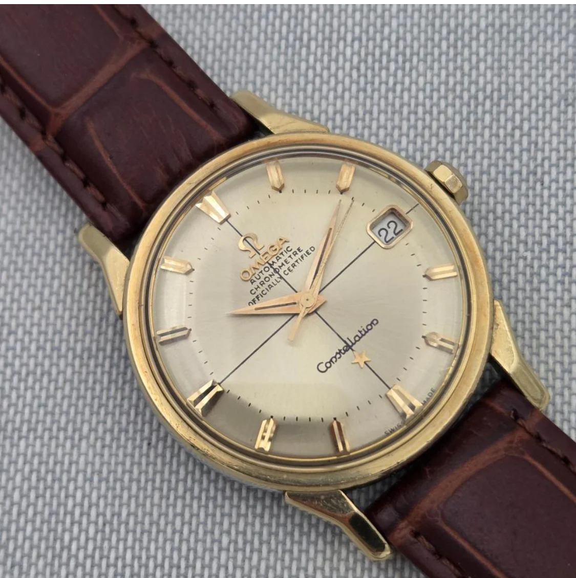

Thanks guys for your answers! I was about to give up on finding decent dog legs but I just found one that are much better looking ! Even if, is I’m correct, the crown is not the original one.
Regarding the price, I think it has gone up a lot lately, and the “normal” price range you guys probably got your models or used to see is just gone. Maybe it will drop one day but I wouldn’t wait for that to buy the watch. I’ve been on many websites now and I don’t see (just) decent looking dials under 3k unfortunately…
Anyway, this one is from Japan and listed 3100€.
3,681
8,015

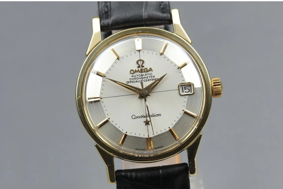

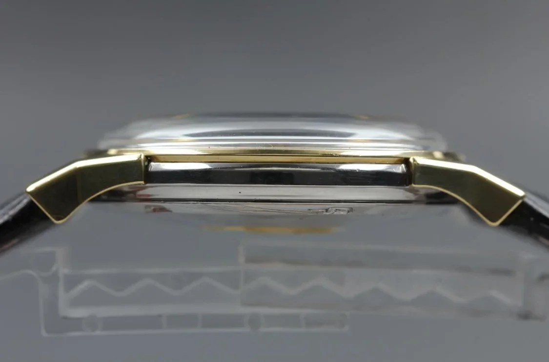

Look at this one to see what good gold cap case looks like.
Your new example has good dial, but lugs are soft, crown not original. Coming from Japan you will also pay import fees.
I would not spend that amount on a gold cap date version with soft lugs. Don't buy an "OK" watch for top money.
42
20
Great great watch, that I haven’t seen in a month of research. But maybe I’m being to impatient…
How regularly would you say you see some in that condition ?
Really appreciate your advices not to rush, I would have made a mistake otherwise!
6,836
10,508
A gold cap dogleg in the condition of @gbesq ’s is a very uncommon beast indeed.
