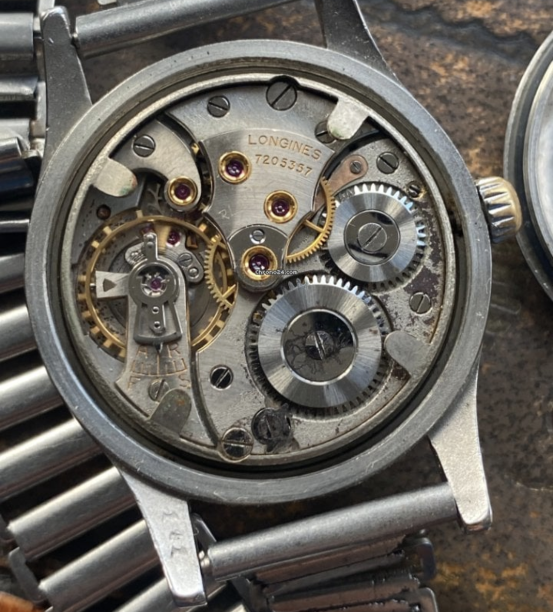

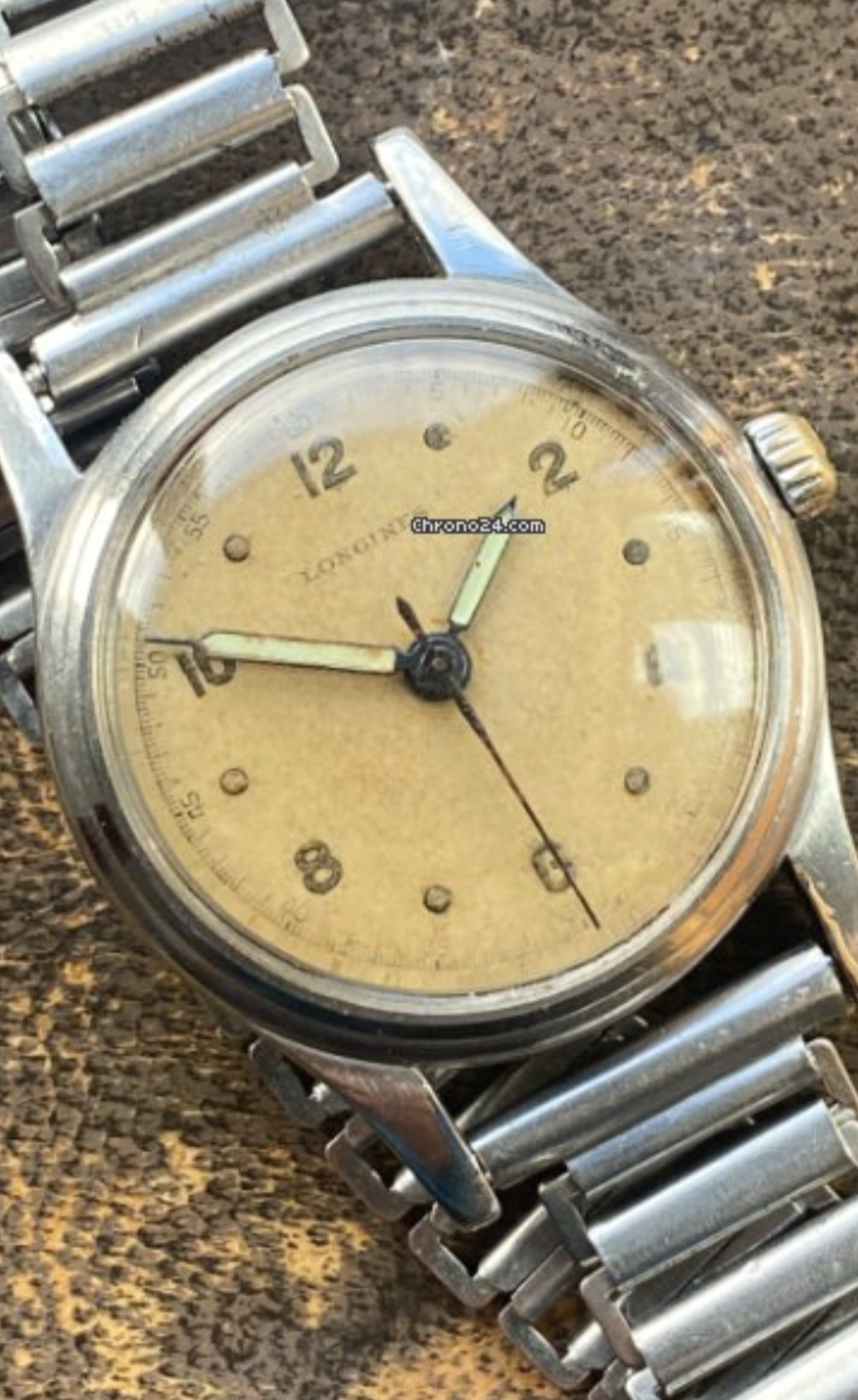

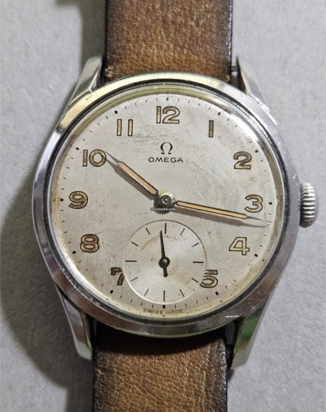

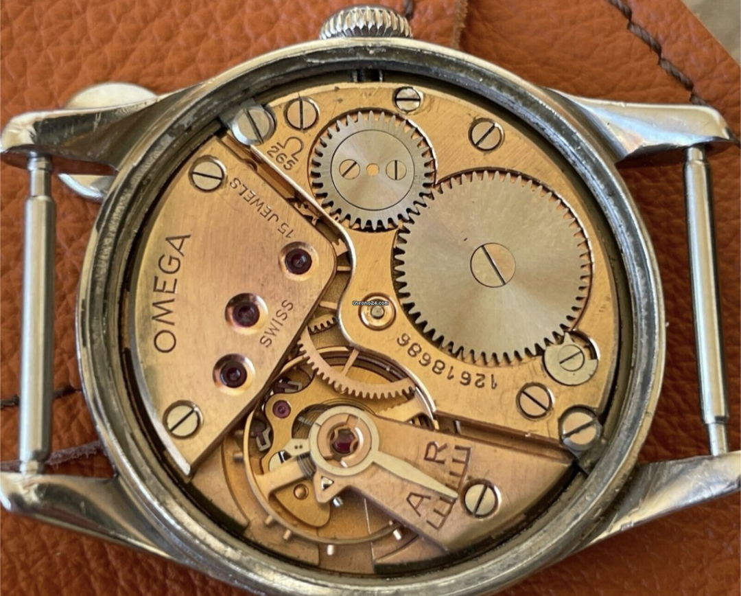

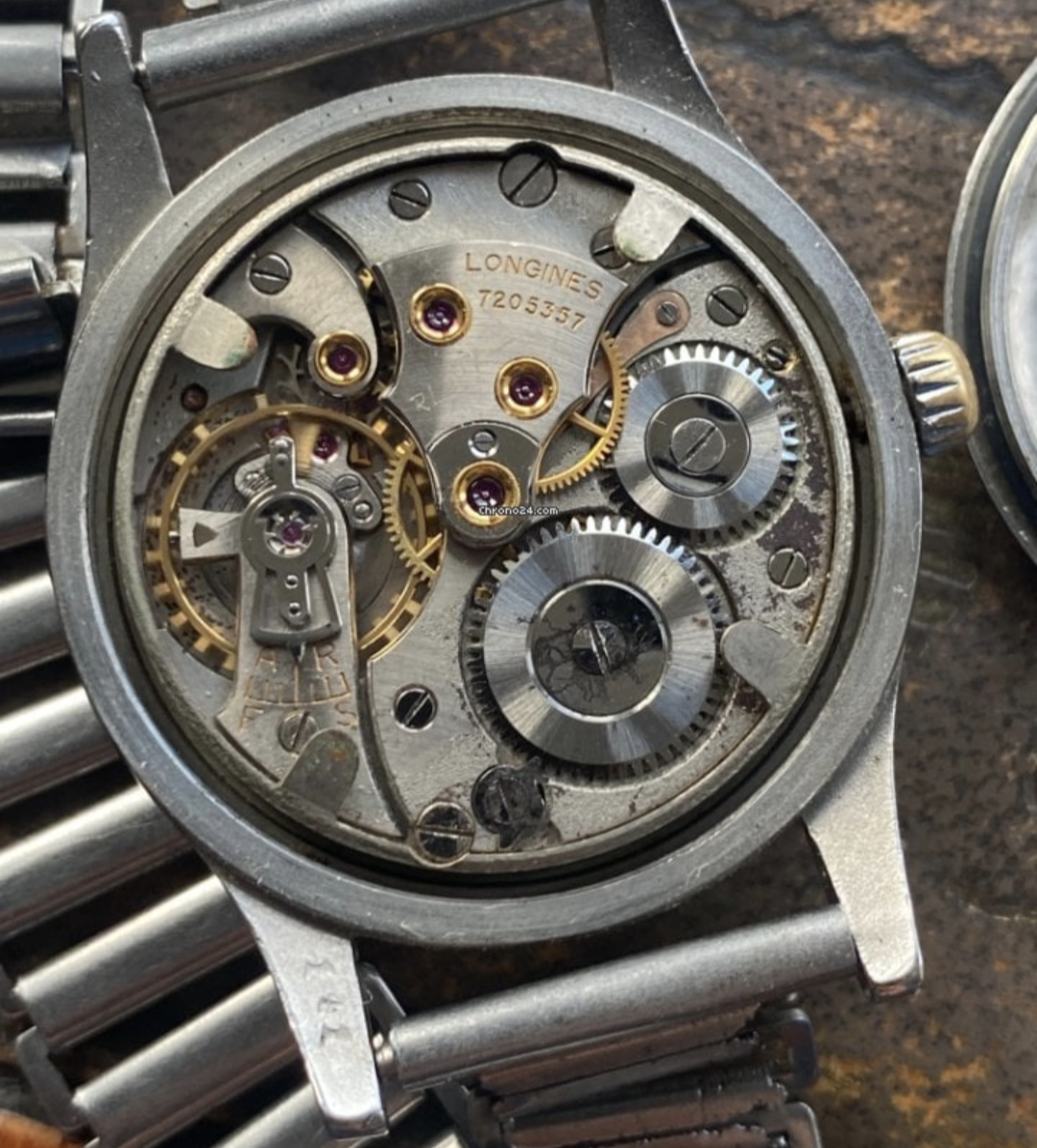

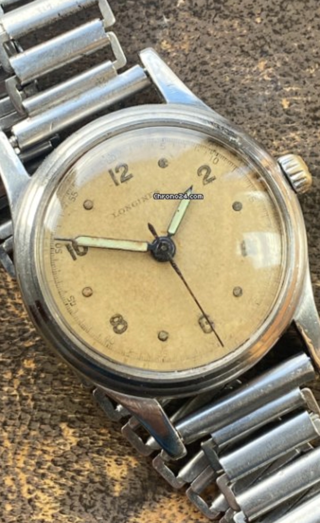

Movement appears to have seen some moisture, which is never a good thing. The dial is very tired and the hands have been relumed.
I'd be a pass for me.
How long have you been searching/how many watches have you looked at thus far?
BTW just about any watch that has MILITARY in the description, isn't.

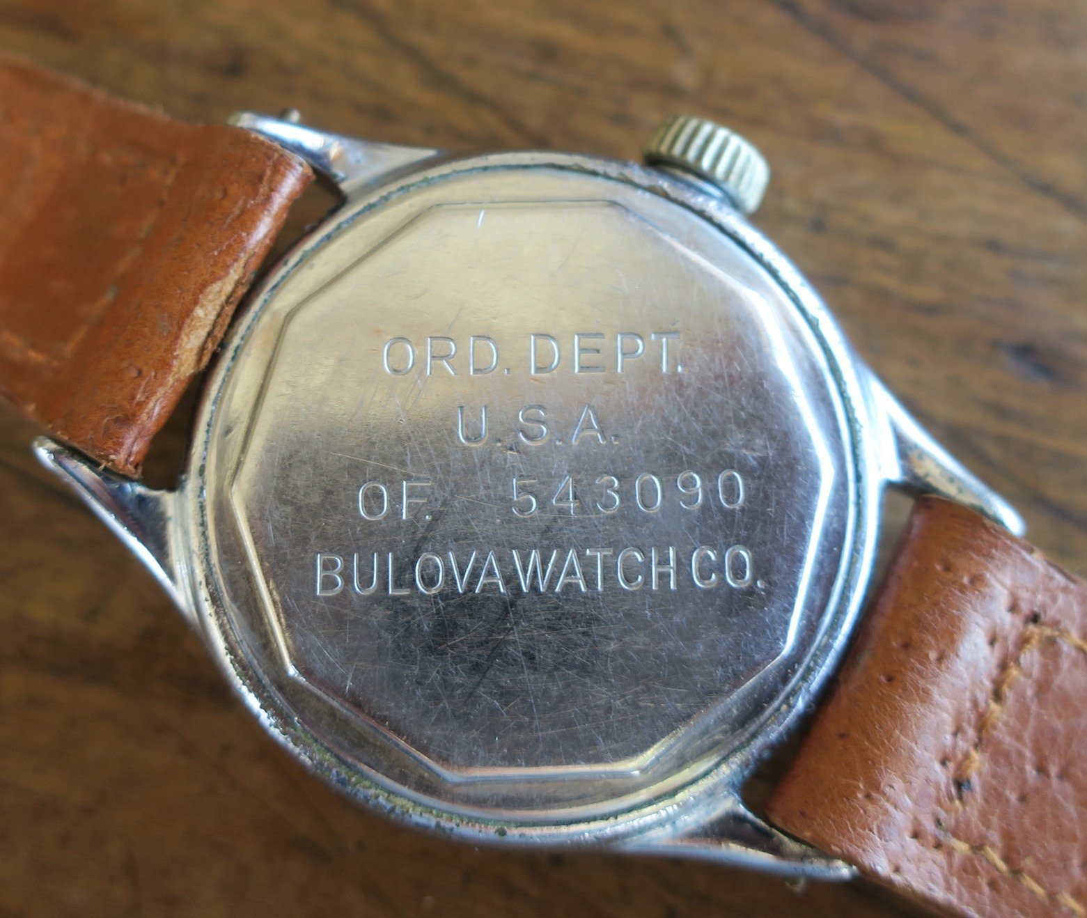

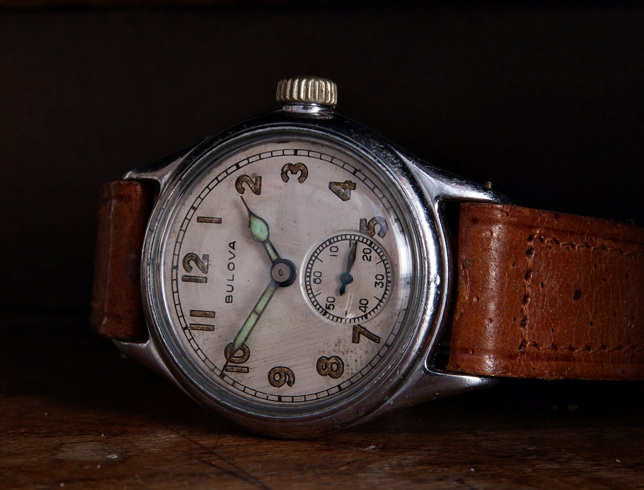

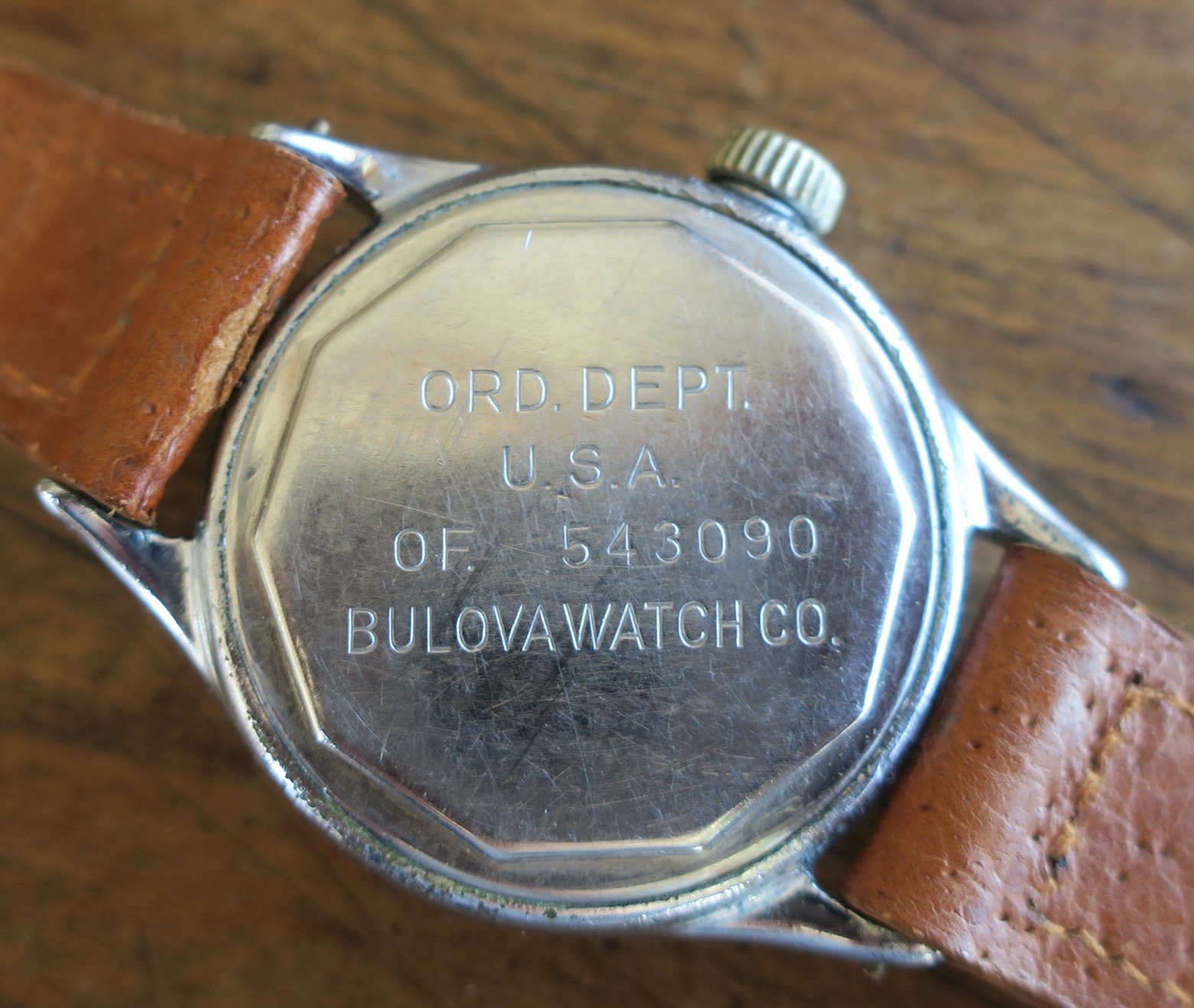

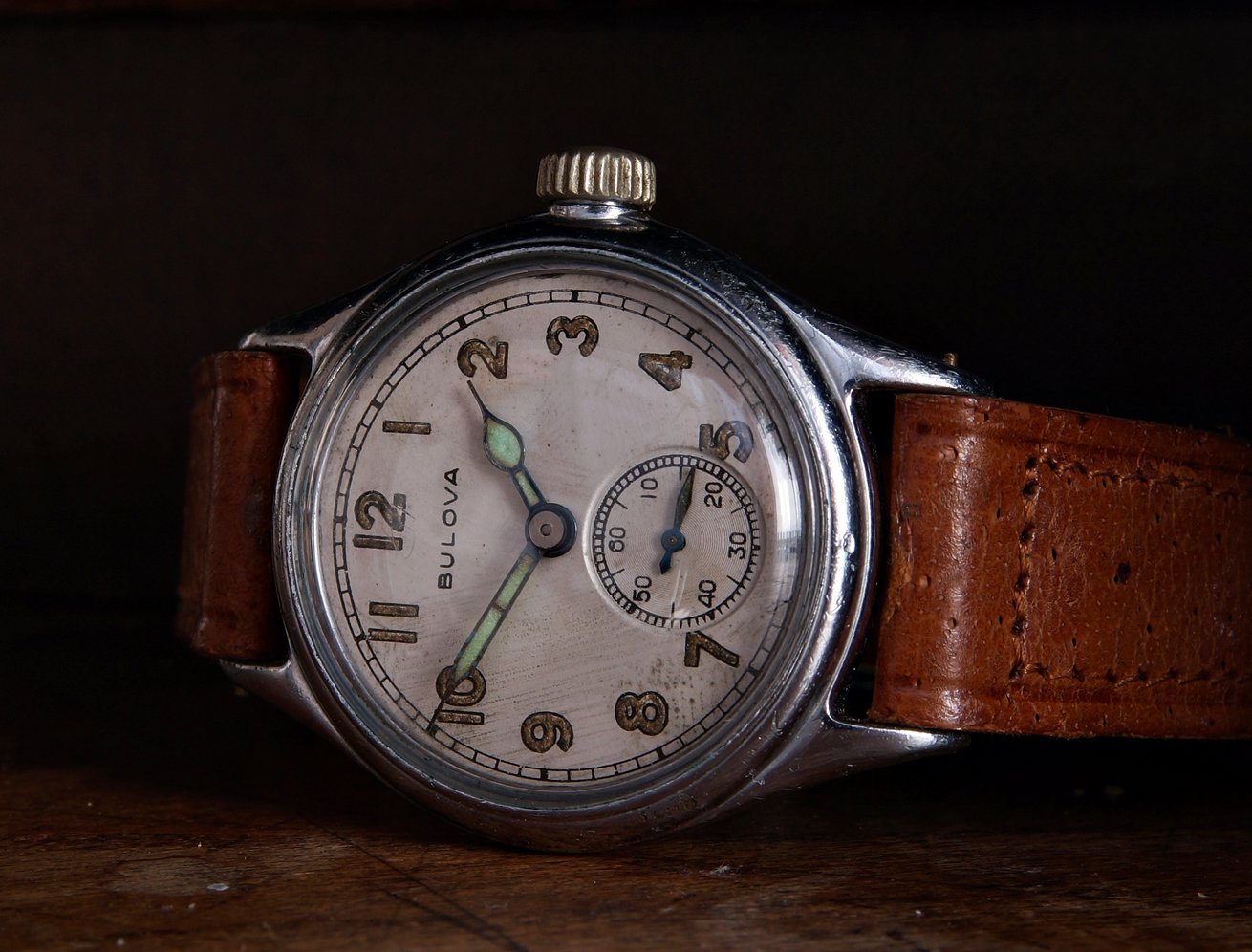

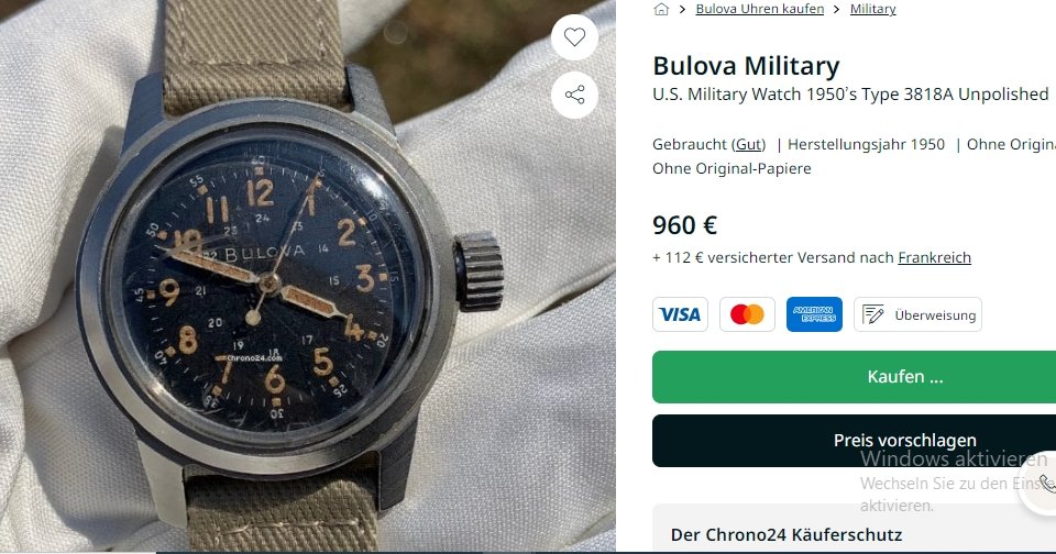

Hi, this is my "military" BULOVA as an example: all original but the hands relumed (with radium!) No fixed spring bars but "mil " (caseback) . 32 mm diameter. Chromed case. Maybe BULOVA is an "entry" into handwound mil- watches
43
15
Looks awesome!

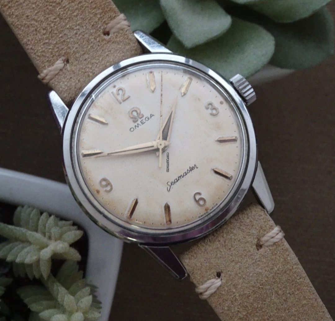

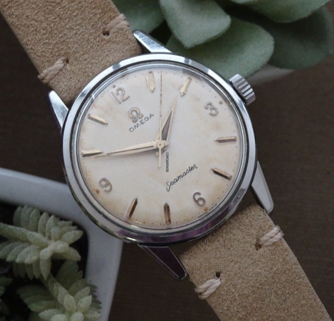

Whilst they don't fit with the military theme the other watch that has caught my eye is the Seamaster with the 12, 3, 6, 9 dial. I'm not entirely sure what the reference should be but I like those too

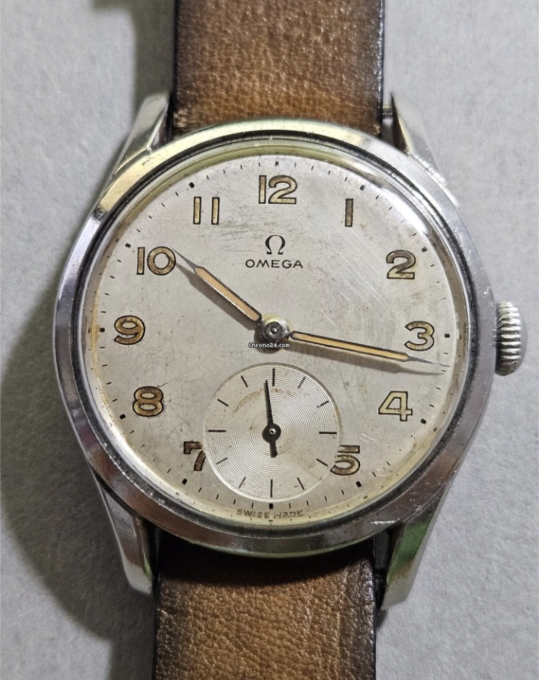

What do you guys think of this one? I've managed to find some details online and I've found a couple for sale
