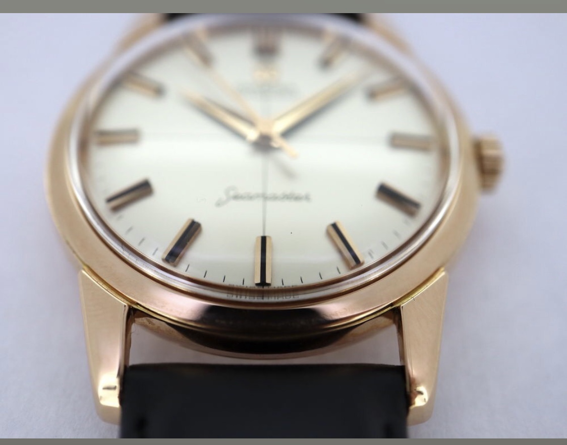

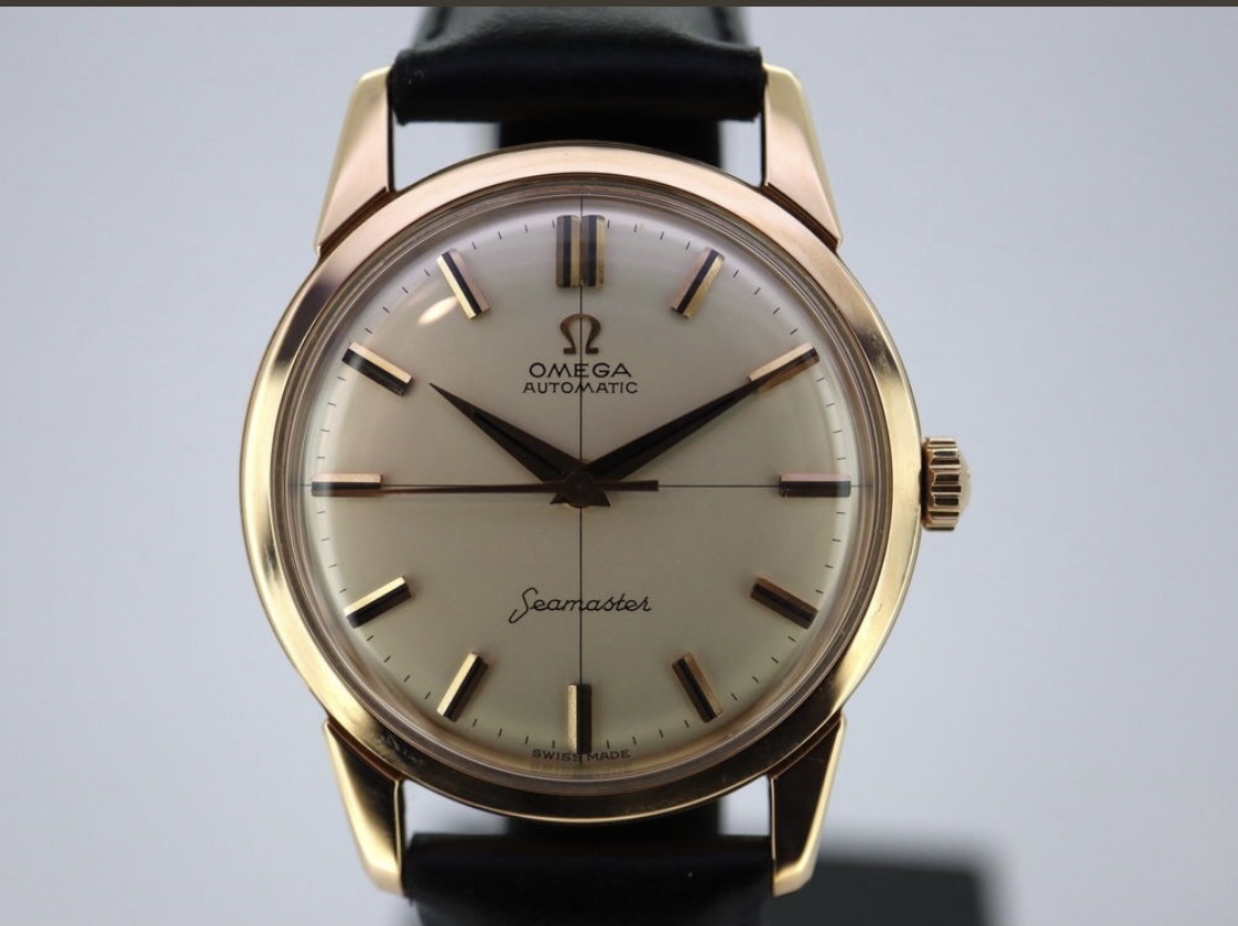

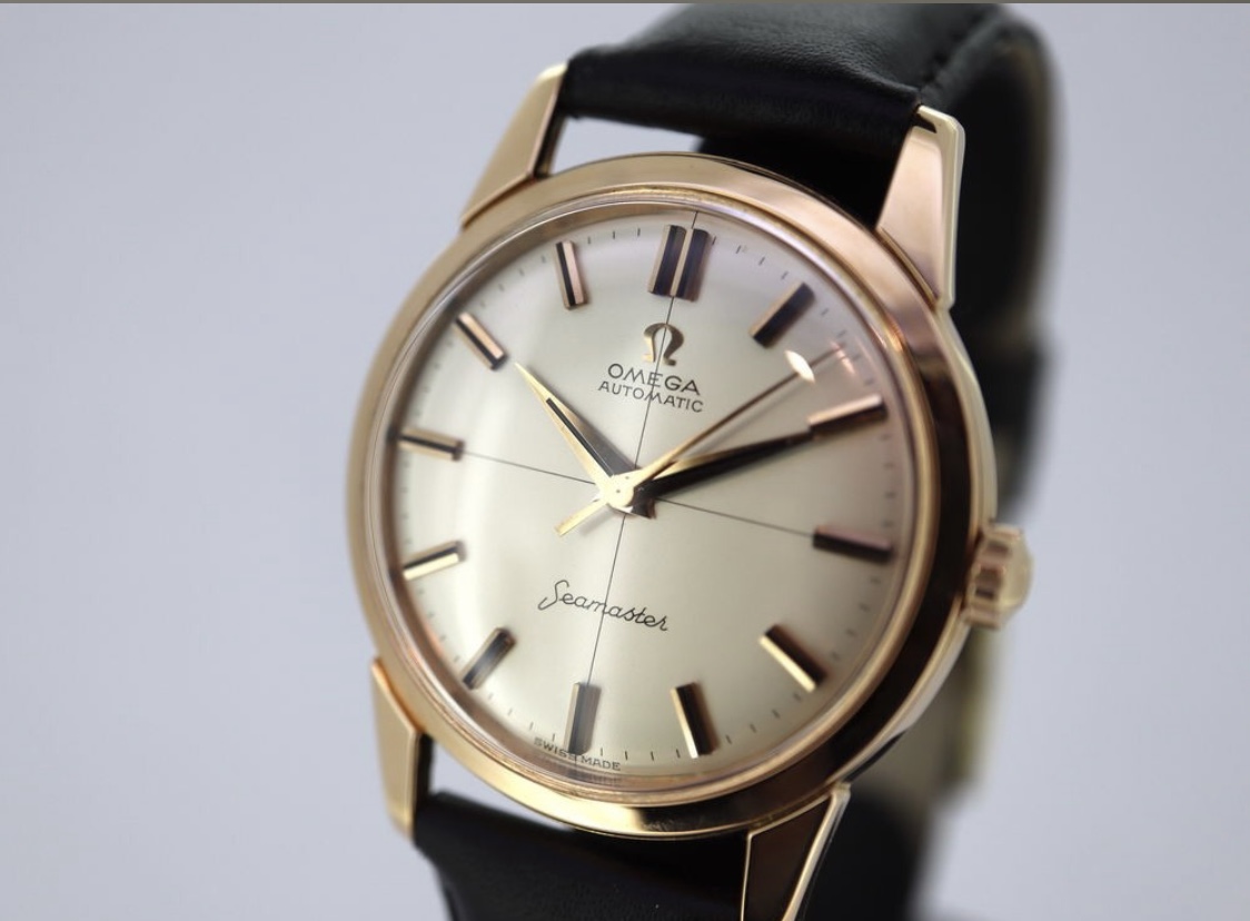

Hey OF,

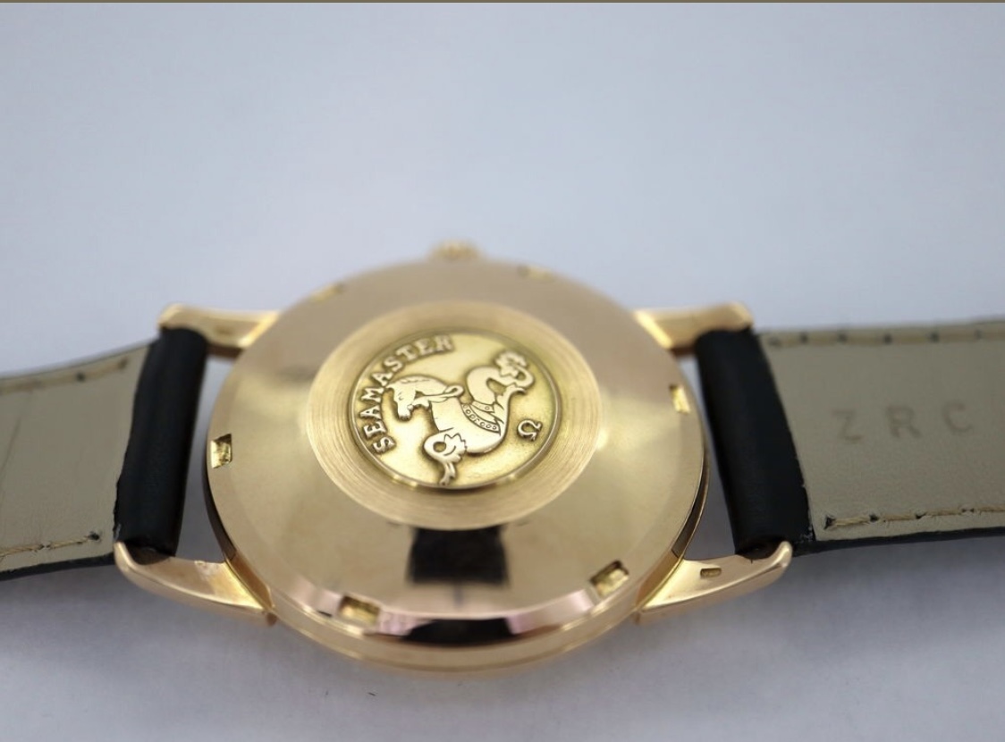

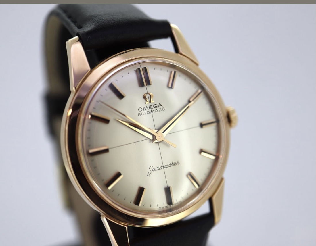

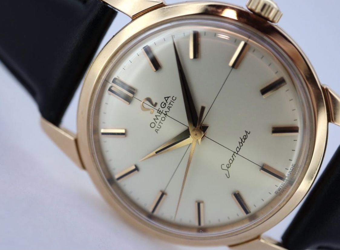

I’ve recently gotten into vintage Omega watches, and have spotted a model in my local vintage watch store. He is asking ~$3500 USD for it: being a 1963 Omega Seamaster in 18K rose gold that has recently been serviced and is running +/- 10 seconds/day.
Couple of questions:
- Is it worth the asking price ? If not why
- How good are rose gold vintage Omegas in terms of durability, and would this be suitable to wear on a daily basis
- Is this a redial or Frankenwatch ? I’m somewhat certain it’s a redial given it’s pristine condition, regardless how good of a redial is it ?
- What sort of accuracy is acceptable with recently serviced vintage movements such as the 552?
Any other tips and advice on what to look out for would be greatly appreciated. Apologies for the lack of knowledge, slowly beginning the journey into vintage Omega!

Hi and welcome here!
For me the dial looks original, so not a redial even it looks so good
No indication for a frankenwatch but only an extract from the archive could give a definate answer
Serial number dates the watch to around 1963 which is coherent.
Case looks quite soft due to polishing

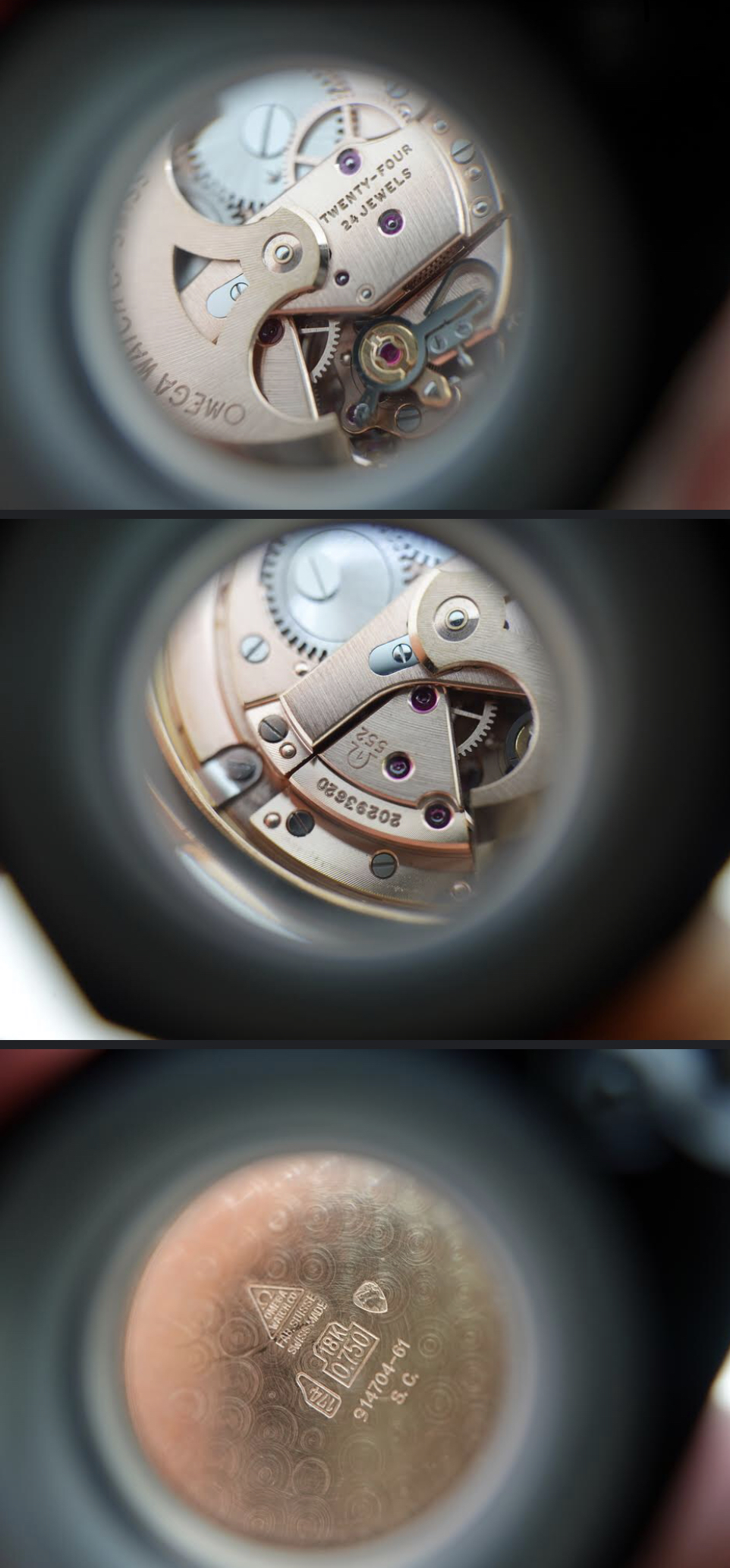

Movement looks clean and in good shape, 10 seconds per day is OK IMO
I'm not familiar with this reference but 3500 $ seems too much
Hope that helps

552 movements are generally regarded as rock solid, easy and inexpensive to service and easy to get parts for if needed. The same can be said for the date version, cal 565.
The price seems high, particularly for a well polished case but then, I tend to go for steel or gold capped models in the $500-1,000 range.

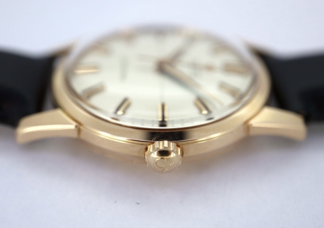

Gonna agree with the sentiments above. Looks all original and the lugs have been quite polished (which would be a deal breaker for me). These 18k rose gold cases aren’t exactly super common, but that’s quite a premium to pay when similar watches in SS and GF can be had at a fraction of that price.
As to your question on this being a daily wearer? I suppose that’s a matter of taste, but speaking for myself, this is a very dressy watch, and one that was meant to be worn for such occasions.

These are not common and that is a very good example.
Not long ago, there was an exceptionally good yellow gold/black dial Seamaster, similar vintage, for sale here in Canada. The asking price was around $2200 USD, and it sold for less.
I thought the buyer of that one did very well. This one is beautiful, but the price is a stretch. Try an offer.

Can yellow gold and rose gold co-exist as original ?
Asking for a friend.
I was just gonna ask the same. Looks like YG hands - and if they’re incorrect, finding correct RG ones is gonna be hard. Very hard.
Either way, the price is absurd. Polished, dealer-prepared watch for a hefty premium - I’d pass.
Regarding every-day wearability: The movement is great and there’s no reason to not wear it regularly, but I’d avoid water, including rain.
