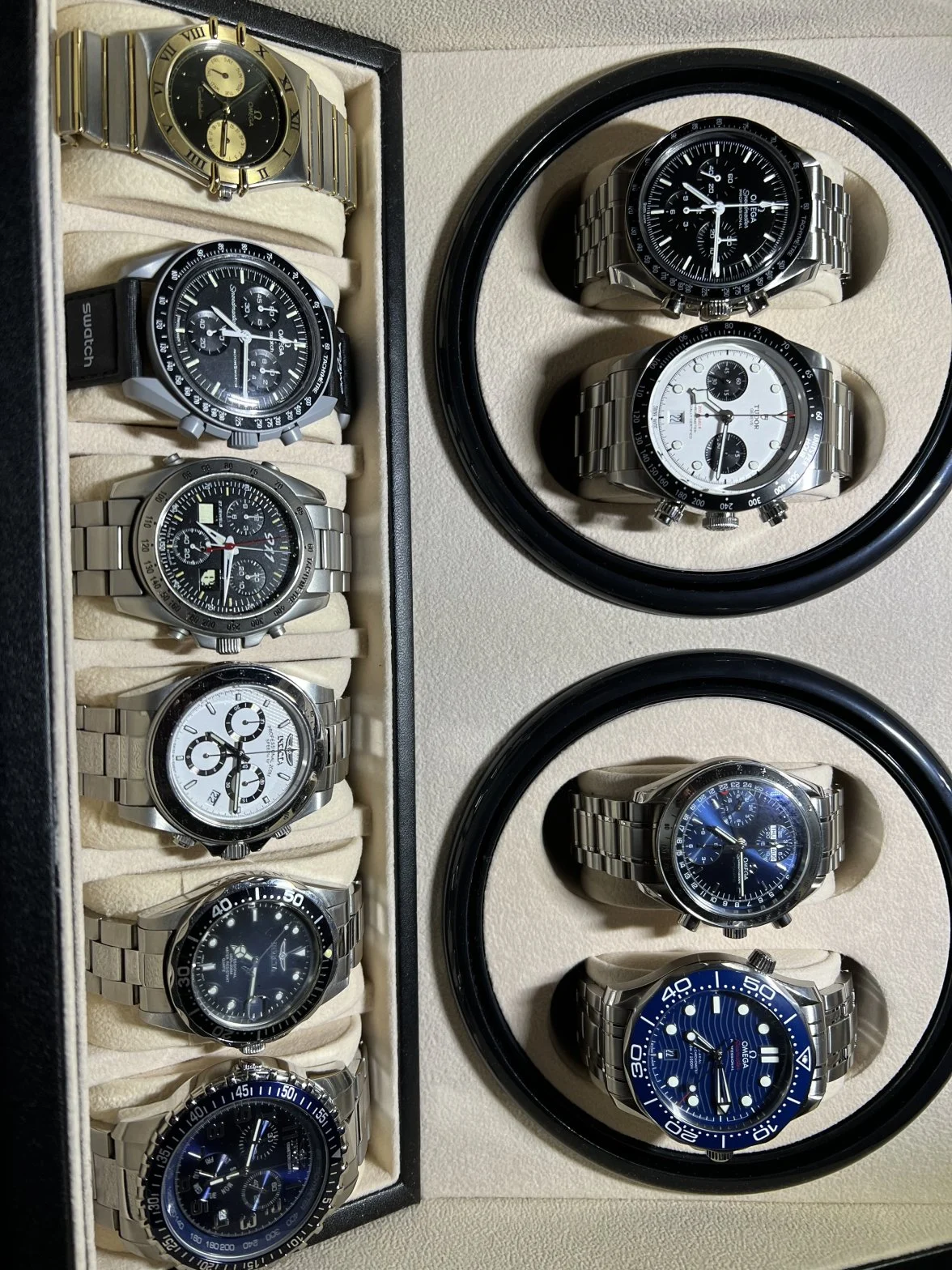

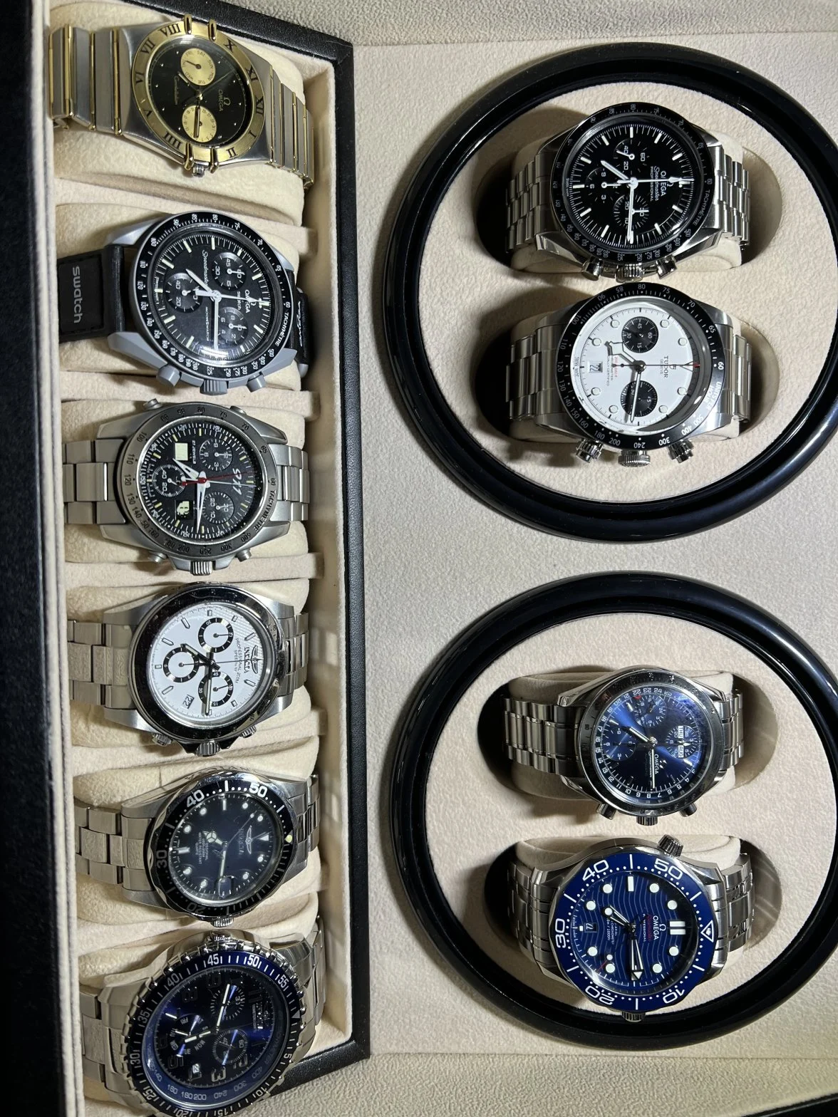

Welcome, and here's my watch addiction. I had/have the same winding problem, but seem to have solved it. The white one on my wrist is the new 3861.

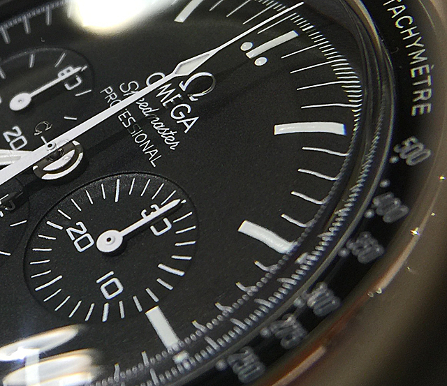

To be clear, the act of getting a tube of polywatch will not make the scratch go away 馃榿

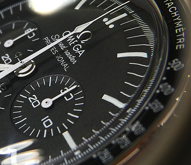

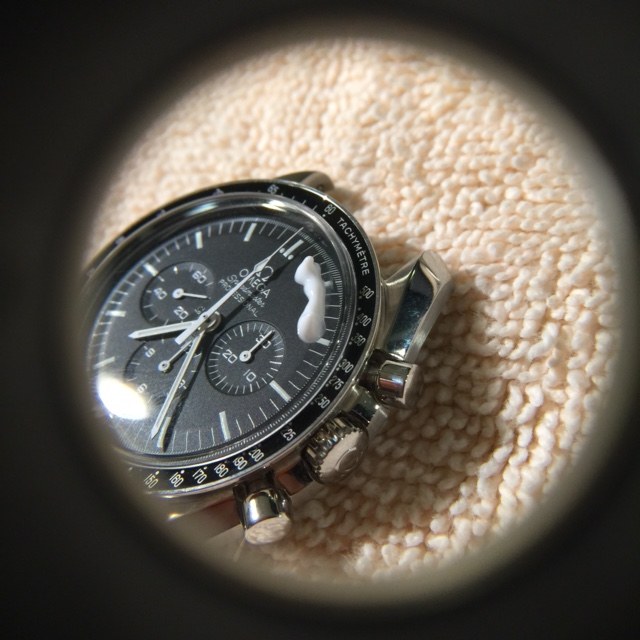

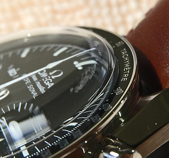

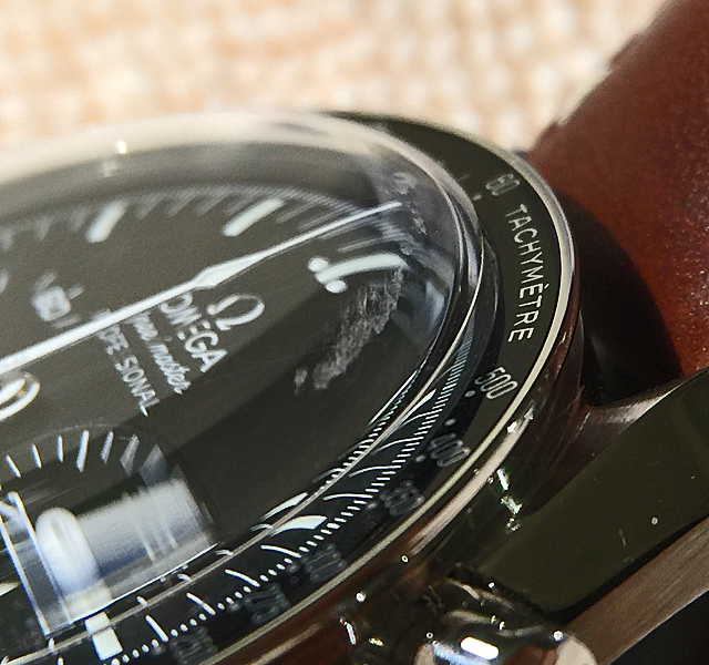

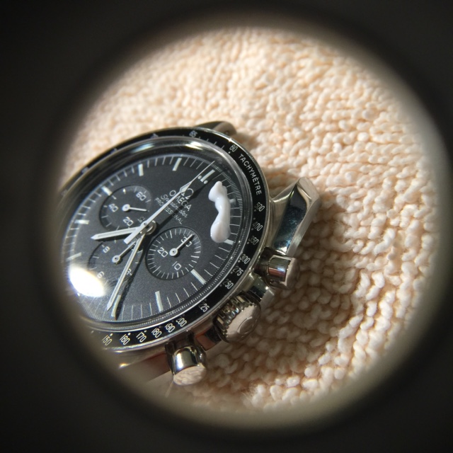

You do need to squeeze a bit of Polywatch cream from the tube onto the watch crystal, and rub the cream with a piece of cloth, with moderate pressure, over the damaged area for a couple of minutes.
I never cease to be amazed at how effective Polywatch is at erasing really nasty scratches. Here are some photos from one of my Polywatch experiences:
Before...
...Polywatch squeezed onto damaged area...
...and after a couple of minutes of rubbing with a clean cloth, Voila!
