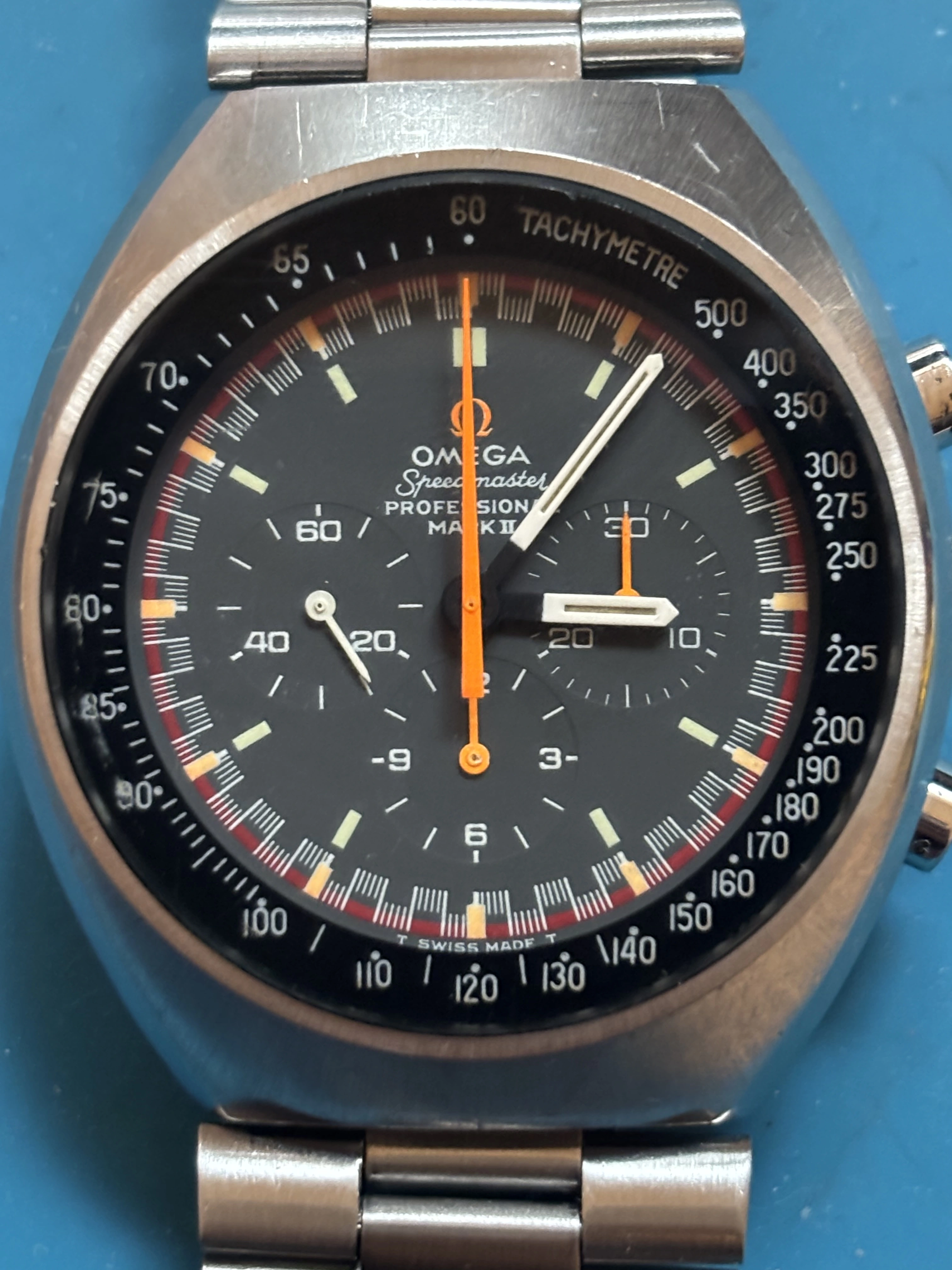

I just picked up this gem (please excuse my dirty mat)

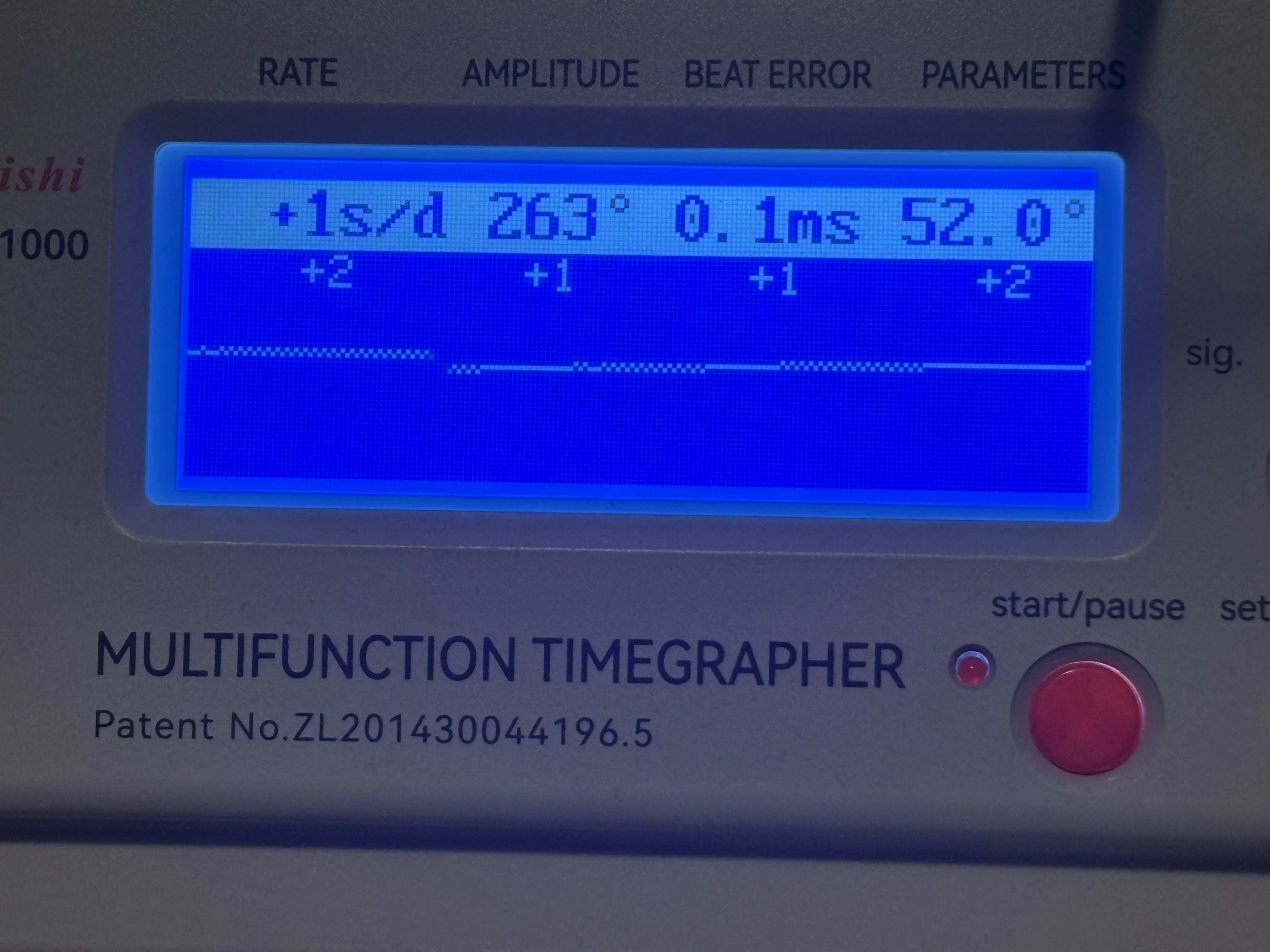

With decently healthy beat, consistent with a relatively recent overhaul.
The crystal was not replaced and has some chips and scratches but appears serviceable after a cleaning but I will still likely replace it in the next few months.
The case back gasket seemed ok, but did not strike me as new
This gets me to the pushers - I’m new to omegas but have quite a few Seiko chronographs. The pusher gaskets there are always hard and need to be replaced. Is that also standard for Omegas? I took a quick spin on the web and candidly did not see many options OEM or other (I’m find with other from a reputable seller).
Should I prioritize replacing the pusher gaskets (and if so I’m very open to hearing about retailers) or is it a nothingburger given the pusher design.
I never submerge any vintage watch unless everything on the outside is screw down so this is more of an incidental water hazard I’m trying to avoid.

Just FYI the lift angle is 50 on this movement so the amplitude you see there is artificially high by about 10 degrees or so, so if that is horizontal full wind, it’s pretty low for any sort of recent service.
