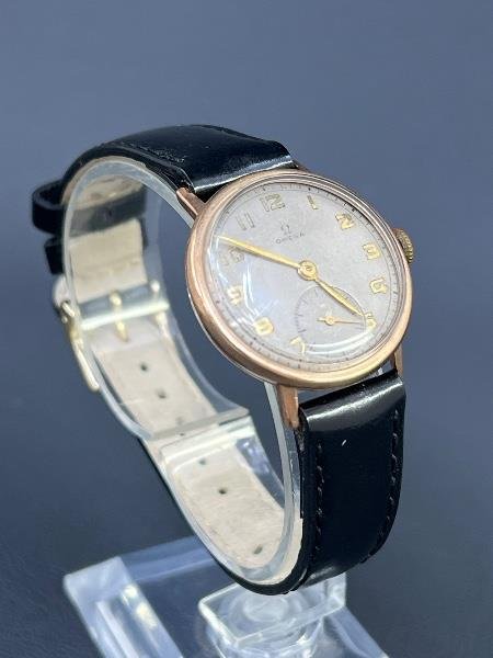

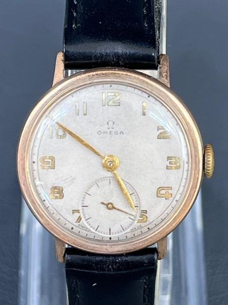

Hi all,

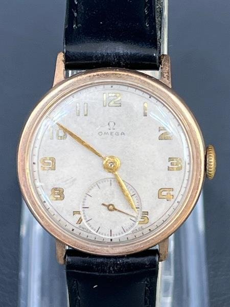

I was hoping someone might be able to shed some light on this watch, it's condition and maybe an estimated value?
From what I can gather it's 1944 and possibly a CK2162 (from what I can find on the web). It's a watch I'm considering buying as I really like the look of it but I would just like to find out a bit more about it.
If anyone could please help, it would be appreciated.
Thank you in advance xx

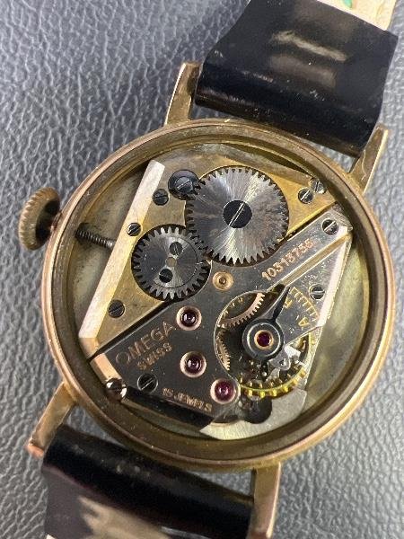

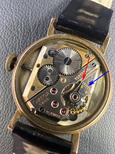

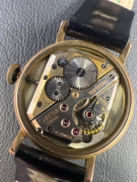

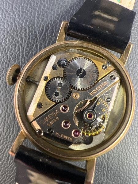

Will need much larger clearer photos of the dial to properly evaluate.
The position of the regulator are is concerning, it should be at the blue position indicating the watch needs at the very least a proper servicing.
Also note this is a very small watch, ca 30mm or less.

I have been informed that the watch runs but that it may need a service so hopefully its nothing to sinister with the regulator. I don't even know what a regulator is , I know nothing about watches but I saw this one and just fell in love with the style.

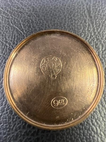

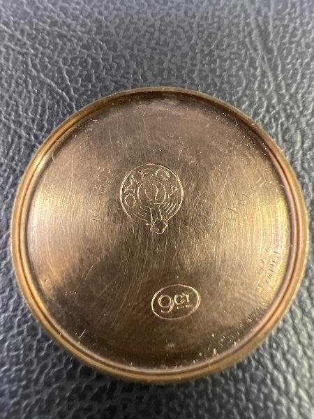

It's not a CK2162, which would be a stainless Swiss-cased watch with a completely different movement.
This appears to be a nationally cased Omega, possibly from the UK or a commonwealth country. I don't see a casemaker's mark. 9K gold means that the case doesn't add much value, it's quite small, and needs a service. So you should be cautious with how much you pay for it. Also, it's a bit hard to tell from the photos, but I have the sense that the case may be pink gold, but the hands are yellow gold? If so, that would bother me. As for condition, the dial looks a little mottled and faded, but not bad overall. The lugs seem to be chewed up, suggesting the possible use of a bracelet with spring-loaded endlinks.
If you address these questions (size, color mismatch of hands, etc.), maybe we could start to give you an estimated value. It would be very helpful if you would indicate the asking price. The more we have to go with, the more we can help you.

It's not a crazy asking price, but given the condition issues, the size, and the need for a service, I'd probably be more comfortable in the $300-$400 AUD range. Figure you may need to invest another $300-$500 AUD for repair/service in the near future. And then if you tire of it, you certainly won't get your money back. That said, I'd only buy it if I really liked it, because you never really know what you are getting into with such an old watch.
These small watches can be hard to sell. While they were men's watches at the time, they are really too small for almost all men these days, and relatively few women collect vintage watches.

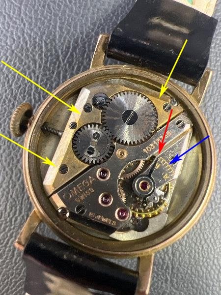

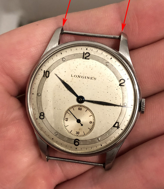

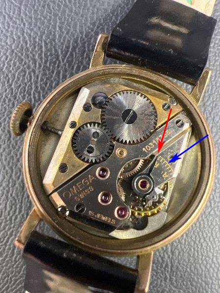

The regulator is used to adjust the time keeping, it should be centered (blue arrow). A = advance (faster) R = retard (slower). While on the subject of the movement we should address the overall condition, which doesn't look good, note the mismatched coloring of the plates, yellow arrows indicate the loss of plating on this bridge which should match the color of the other side of the movement, not a good sign.
One other thing to note is the watch appears to have fixed lugs, this is where the strap attaches to the case. Most watches have removable bars "spring bars" enabling one to easily remove/replace the strap. Fixed bars greatly limit the number of available straps and the ease with winch they can be changed.
I actually think @Dan S pricing at $300-$400 AUD range is a bit optimistic, I's say more like $150-$250 AUD.

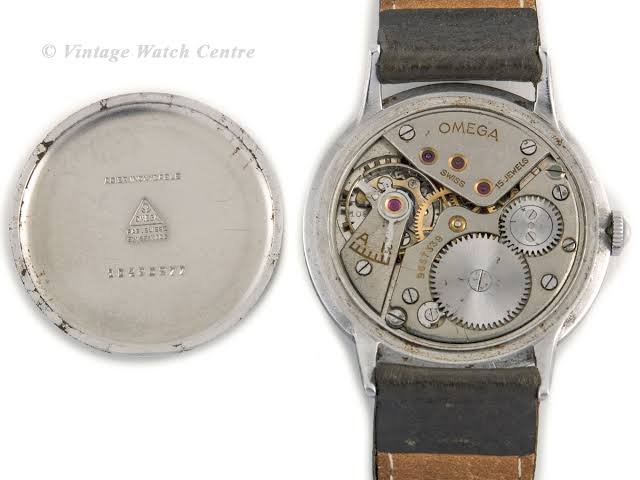

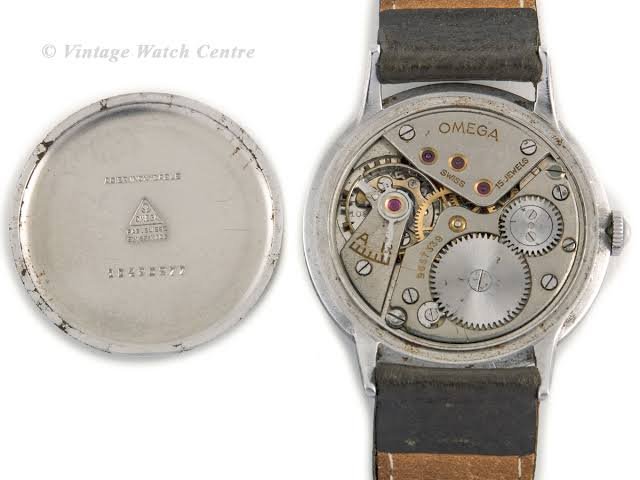

I also ran it by another omega collector and he noted that the internal workings didn't seem to fit with the watch style.. he seemed to think that it has likely been modified from an originally square watch (as the workings are rectangular and not circular).
A comparison photo is attached.
I'm not sure about the internal working side of things.. but after your advice and learning a bit more, I think I just need to pass on this watch.
If anyone ever comes across a similar design that is genuine, please let me know.
Thank you again for your advice and guidance! It's greatly appreciated
Xx
13,493
31,814
A completely incorrect assumption and very amateur. The caliber R17.8/302 was used in many round Omegas.˜
