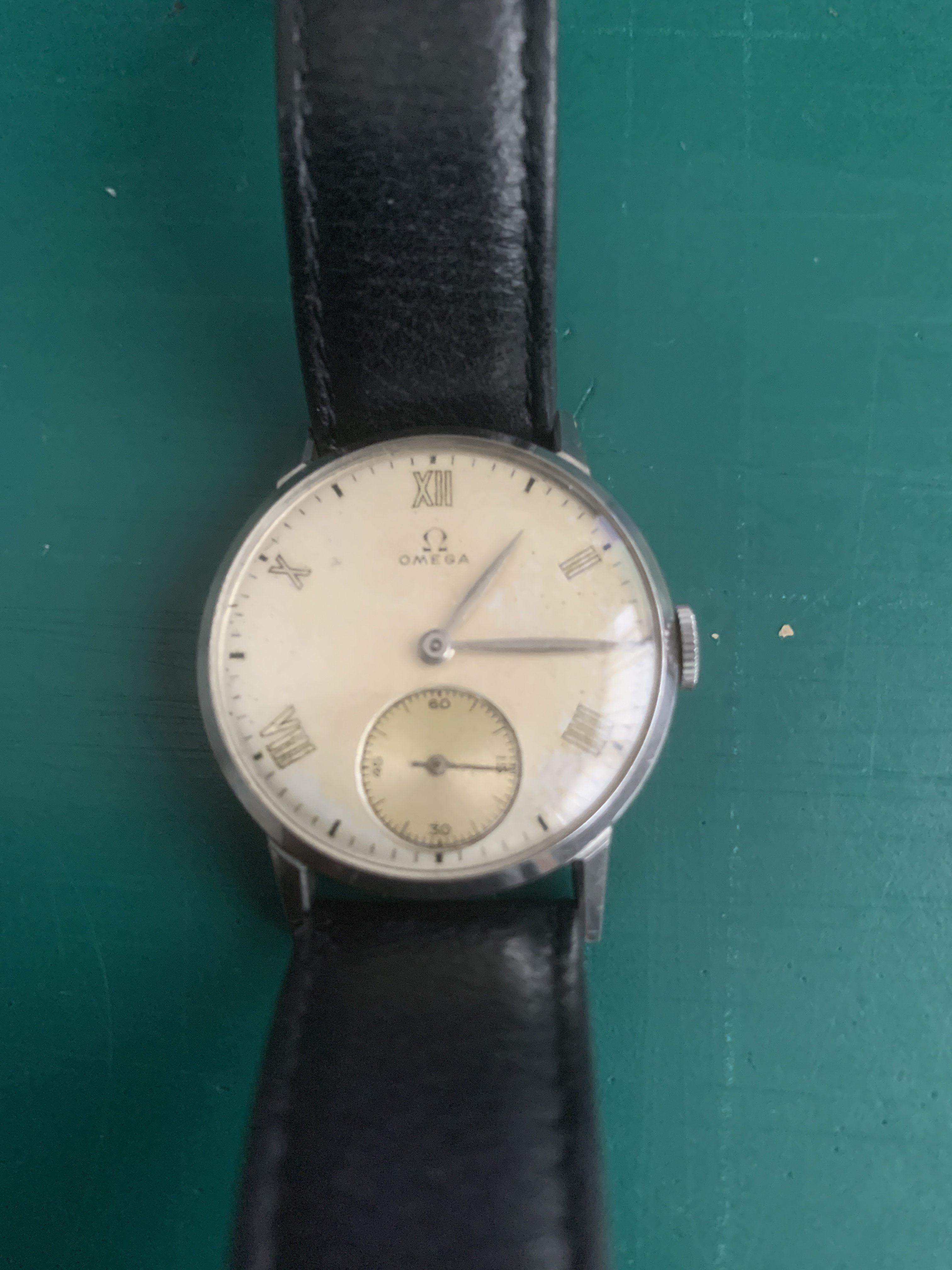

I have a passion for watches, now I'm retired getting more of a collection together. Help me identify this Omega. which I purchased back in the mid 1980's I think for £30. Not cheap but I thought then it was worth it. What's your thoughts.

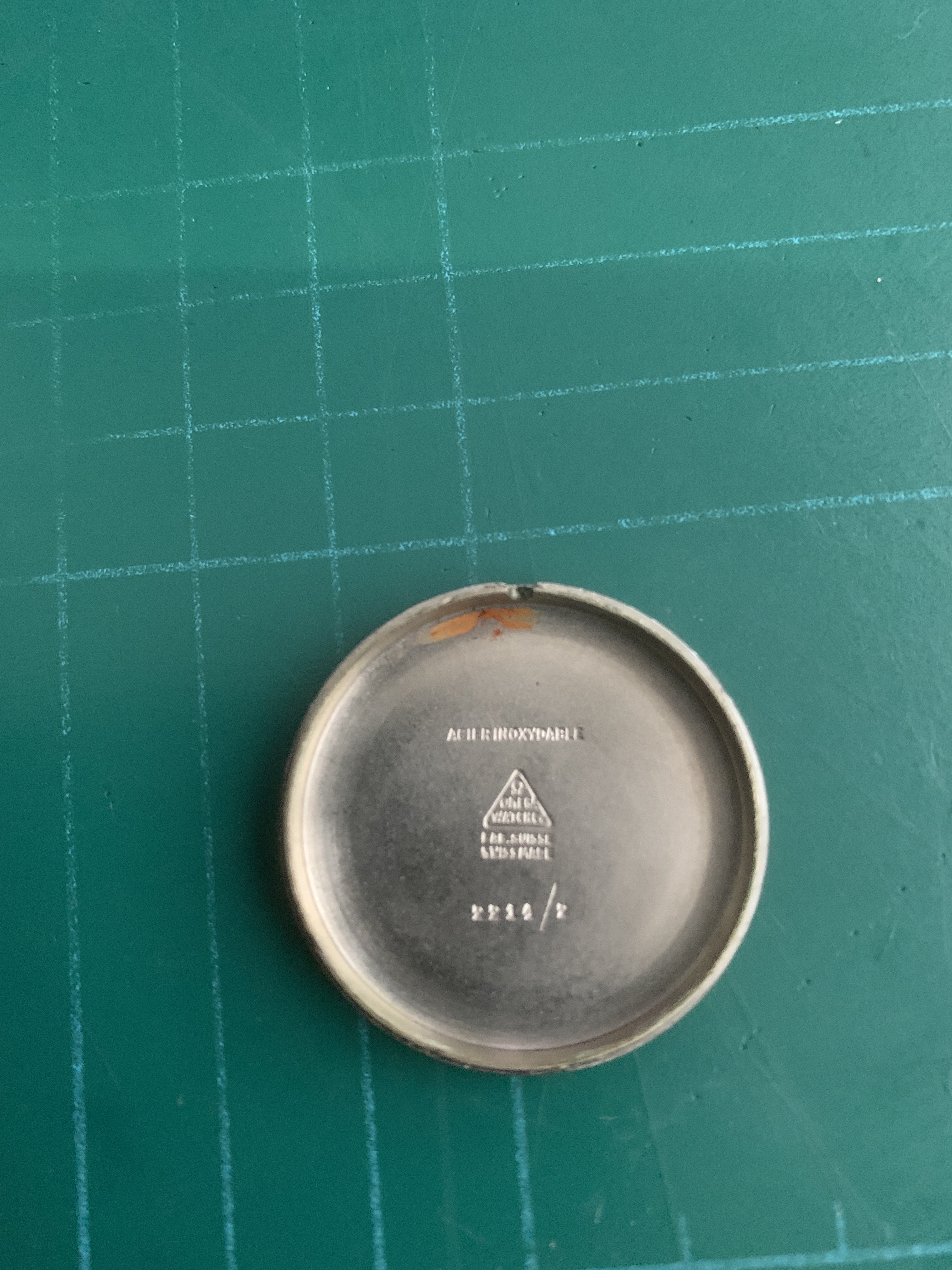

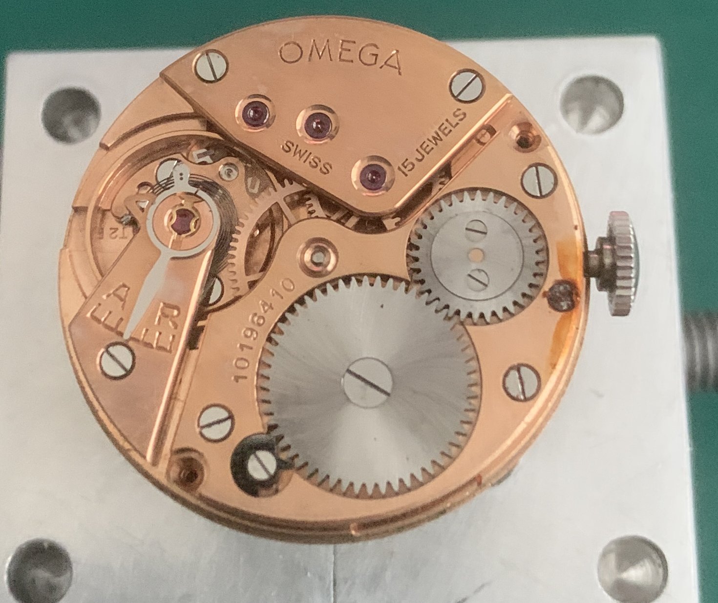

You have a Gents Omega Watch, reference 2214 which was introduced an about 1940. Your movement is a caliber 30T2 PC AM, which was introduced in 1941.
30 - approx diameter in mm
T2 - second iteration of the base caliber
PC - shock absorber
AM - anti-magnetic
The serial number dates to about 1944.
There's been some water ingress but it can be cleaned up during a service where any parts affected by rust should be replaced.

Thanks for the quick response, I got the date right with my own research which is encouraging, but your other information is fabulous information. I'm in the UK and have a watch app that I use to check timekeeping whilst wearing the watch. Over the week I wore it, it lost 3.5 seconds a day roughly. I thought that was quite good, but would appreciate your thoughts. Also I think I should look at getting it serviced; I play with Seiko's at the moment, but wouldn't touch this. Have you any idea of value, was my £30 well spent?

I never really wonder about how much I paid for any watch. Some I probably paid too much, some I got for a bargain.
I think £30 is well spent though.
Your watch looks all original to me.
Probably a good idea to get it serviced if you intend to wear it though, the under dial side may have some rust which could have bits propagate further into the movement. The 30T series movements are easy to work on, but if you're not confident let a watchmaker do the job.

Your watch apparently dates to the same time period as one I have only your watch has a much nicer dial. This old photo shows the movement as received. I need to take a better photo.
The upside.
