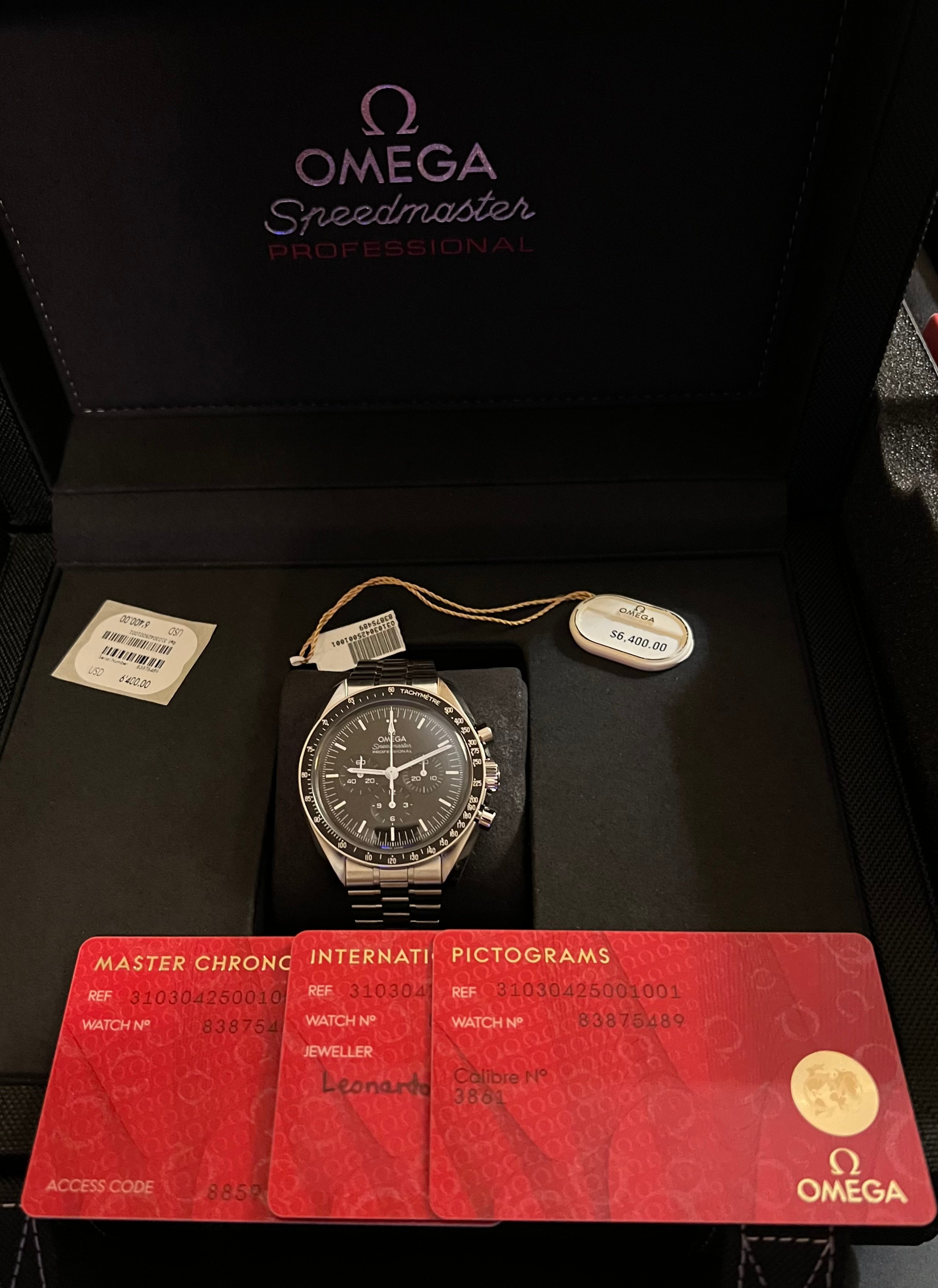

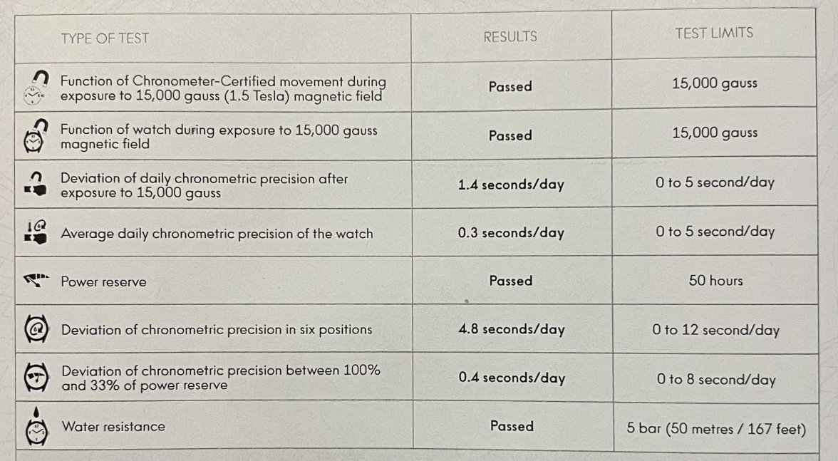

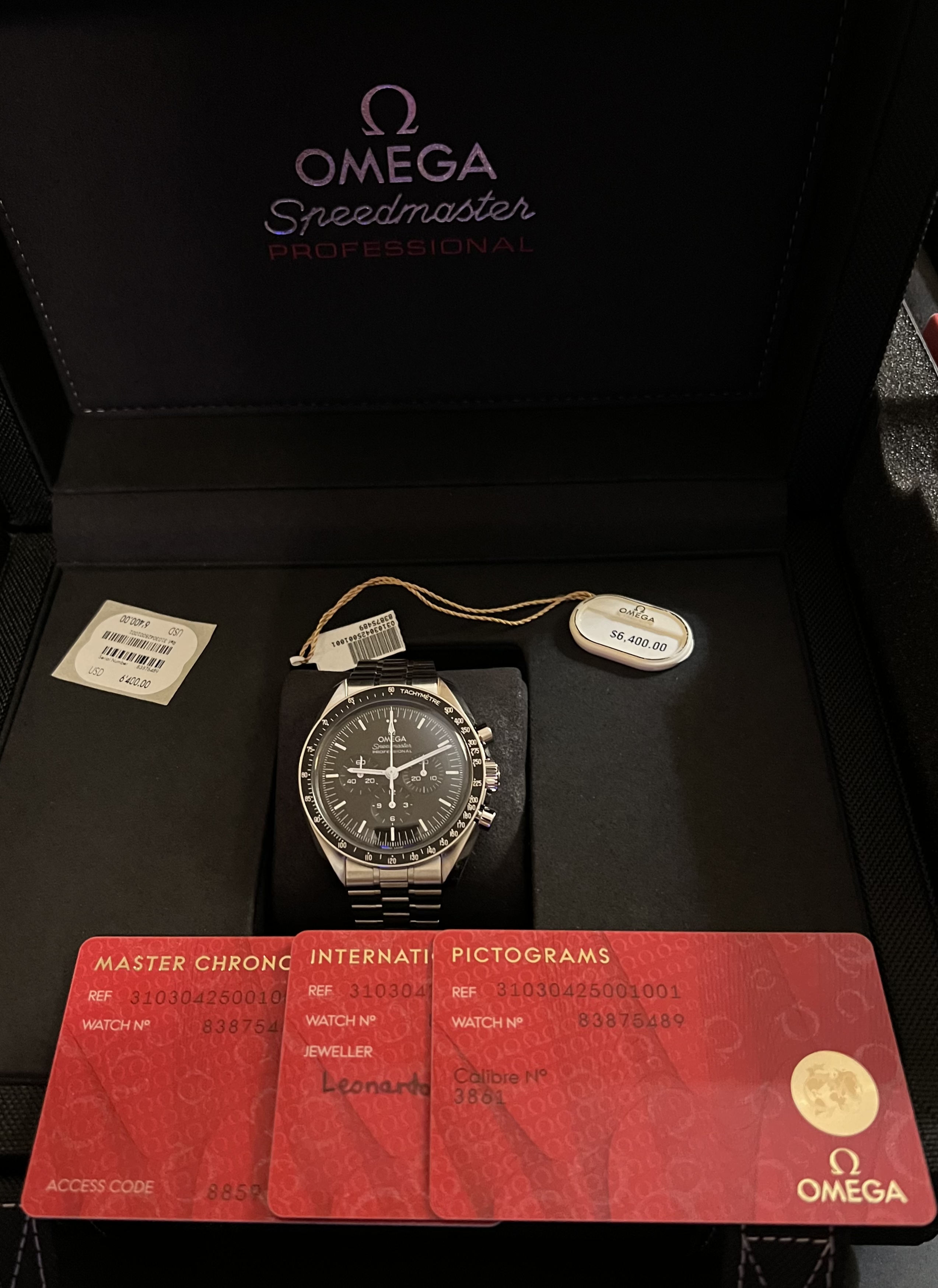

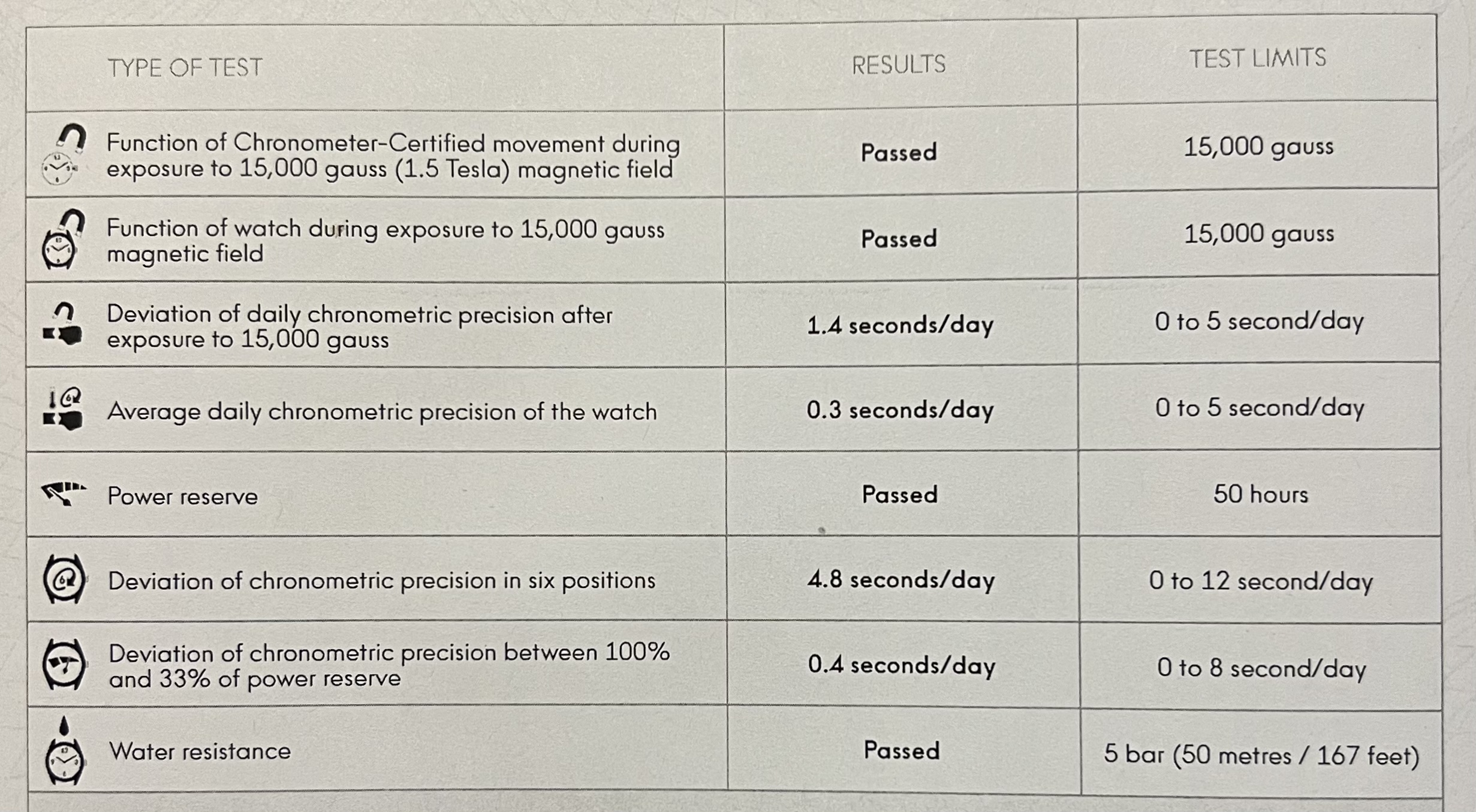

Here are a couple of pics, one of the watch and one of the METAS test results. I have comparing the time per the watch and the NIST website every night for the past week and the watch has been consistently running about a second fast per day. I know this is not very scientific but I believe it gives me an approximation within a second or so of accuracy. This has exceeded my expectations. I am used watches with unregulated ETA movements. This Speedmaster keeps time as well as a basic quartz watch. Keep in mind I have a desk job so I don’t move around as much during day as a lot of people. Also, I take a few seconds to wind the watch everyday.
