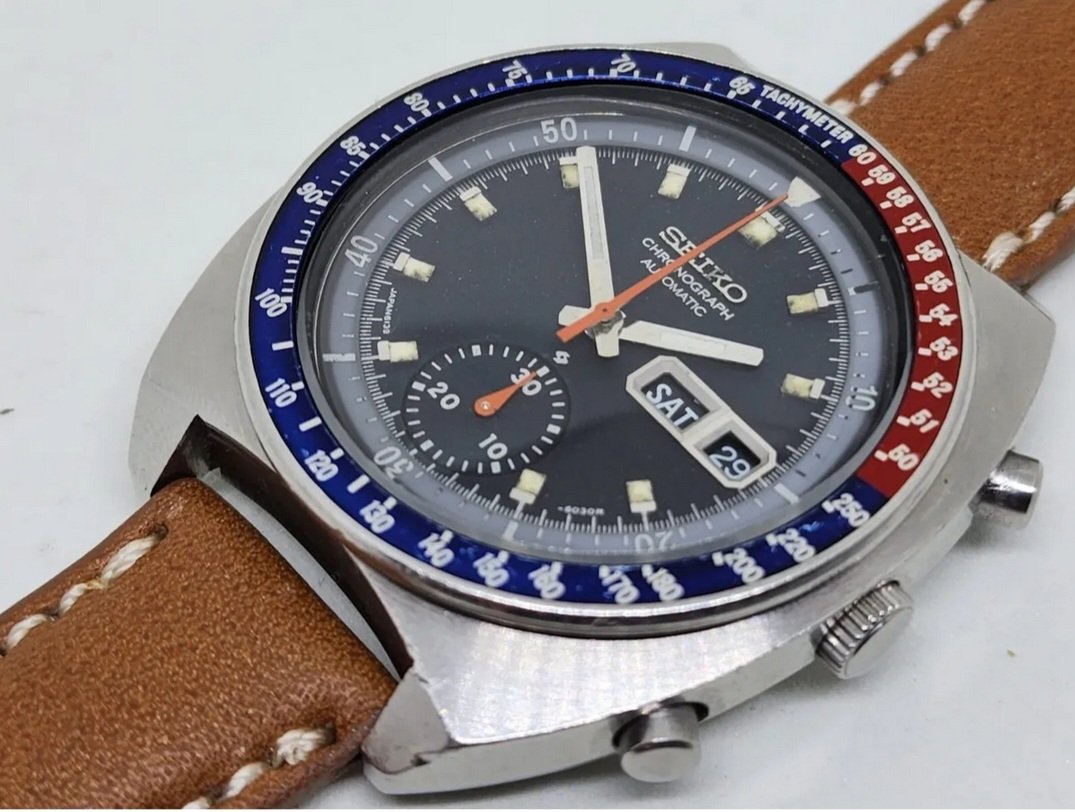

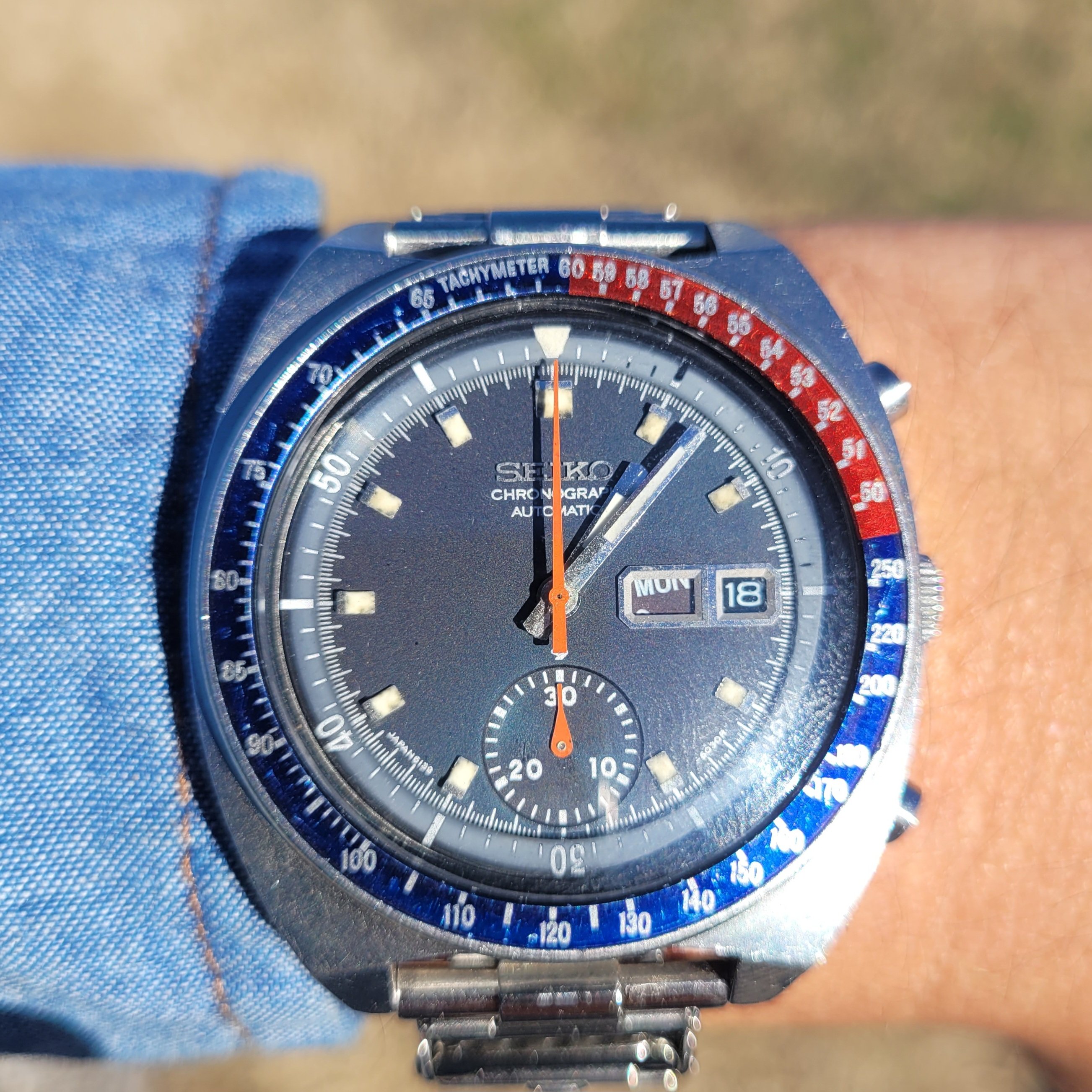

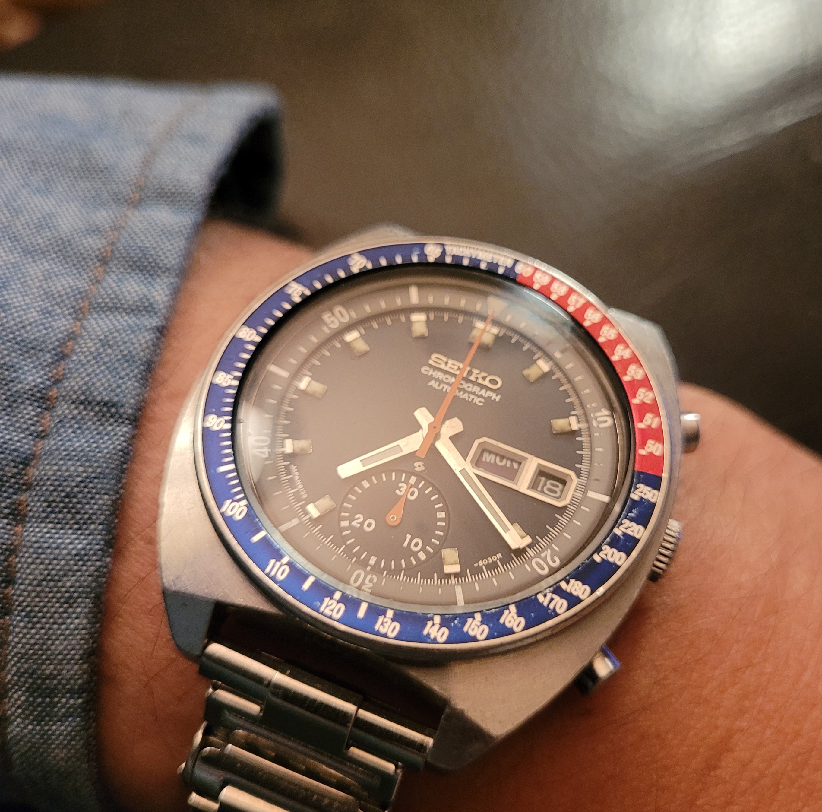

I decided to buy a chronograph awhile back and after some research decided that the 6139-600x series was the one for me. I bought this one on Ebay from a Venezuelan seller, and he claims it was recently serviced. The watch arrived today and I am mostly happy, it runs great and everything functions correctly, but the day is not properly aligned. It was before it shipped so, I am guessing it took a shock somewhere between Venzuela and Oklahoma. The first is a shot provided by the seller, the second two are from today. I've never serviced a chronograph, so I'll be sending this one off to my watchmaker after the new year.

Did you try pushing in the crown a few times to try to reset it?
Nice sharp case edges. These are very fun watches. I like how interactive they are, turning the internal bezel, pushing in the crown for day and date. Plus historical movement. Nice choice. Congratss

If the push to advance the day/date method doesn't work, there is a reasonable chance the day wheel is a little loose on the metal star attached to the back of it. Your watchmaker may be open to removing the hands and dial and correcting this issue (with a punch or little dab of glue).

The crown appears not to be correct. It should be flush with the case and slightly dimpled.

I was curious about the crown because most of the examples I've seen had divits and set flush instead of being domed and protruding slightly. I'll ask my watchmaker if he has the correct crown when I send it in.

Only the early watches had the dimple at the crown. This changed some time around ‘70-‘71 IIRC. As for the day not being aligned try shifting the hour and minute hands to around 0630 hrs and use the crown to quick adjust day and date to the day prior to the day and date you are setting to. Then manually advance the hands to the correct time/date etc. This doesn’t always get them aligned but it can. The alignment often screws up when date etc are quick changed in the forbidden zone. Good luck.

A misaligned day is a common issue with the 613x series. The day wheel (made of very thin aluminium) has a cog staked to the underside.
Over the many years these watches have been in use this cog can become loose and slip round. The only solution is to remove the hands & dial, remove the day wheel, re-align the cog (a tricky process) and then re-stake (fix) the cog in this corrected position. This is doable but requires great care as the day wheel is VERY fragile and easily ruined.
All 6139-600x models should have a dimpled crown that sits flush (or almost flush) with the case edge. The nature of the day/date quickset on these models makes them more susceptible to stem fatigue (and breakage) - something which is significantly accelerated with rust (caused by a failed crown gasket).

The crown/stem assembly on these has four parts - the stem, the crown, a small gear that slides on a rectangular portion of the stem, and a spring that keeps the gear in the correct position. What often happens with 6139-600x is that the crown unscrews and the spring and/or gear gets lost. If you see a 6139-600x with the wrong crown, there’s a decent chance that the assembly may be missing a part or two; if that’s the case, the day or date advance may not work properly.

Well, the stem is a mess in this watch, it's missing parts and that is why the inner bezel doesn't turn. My watch maker didn't even get into the messed up date wheel. The watch is bone dry with no signs of using been serviced in years.

Sorry to hear. The photos appear that your watch has incorrect crown, it should be recessed and barely visible on frontal view, and dimpled. I’m sure your watchmaker can sort it out. Good luck and hope it gets resolved easily! These are really nice watches for have a few and enjoy wearing them.
