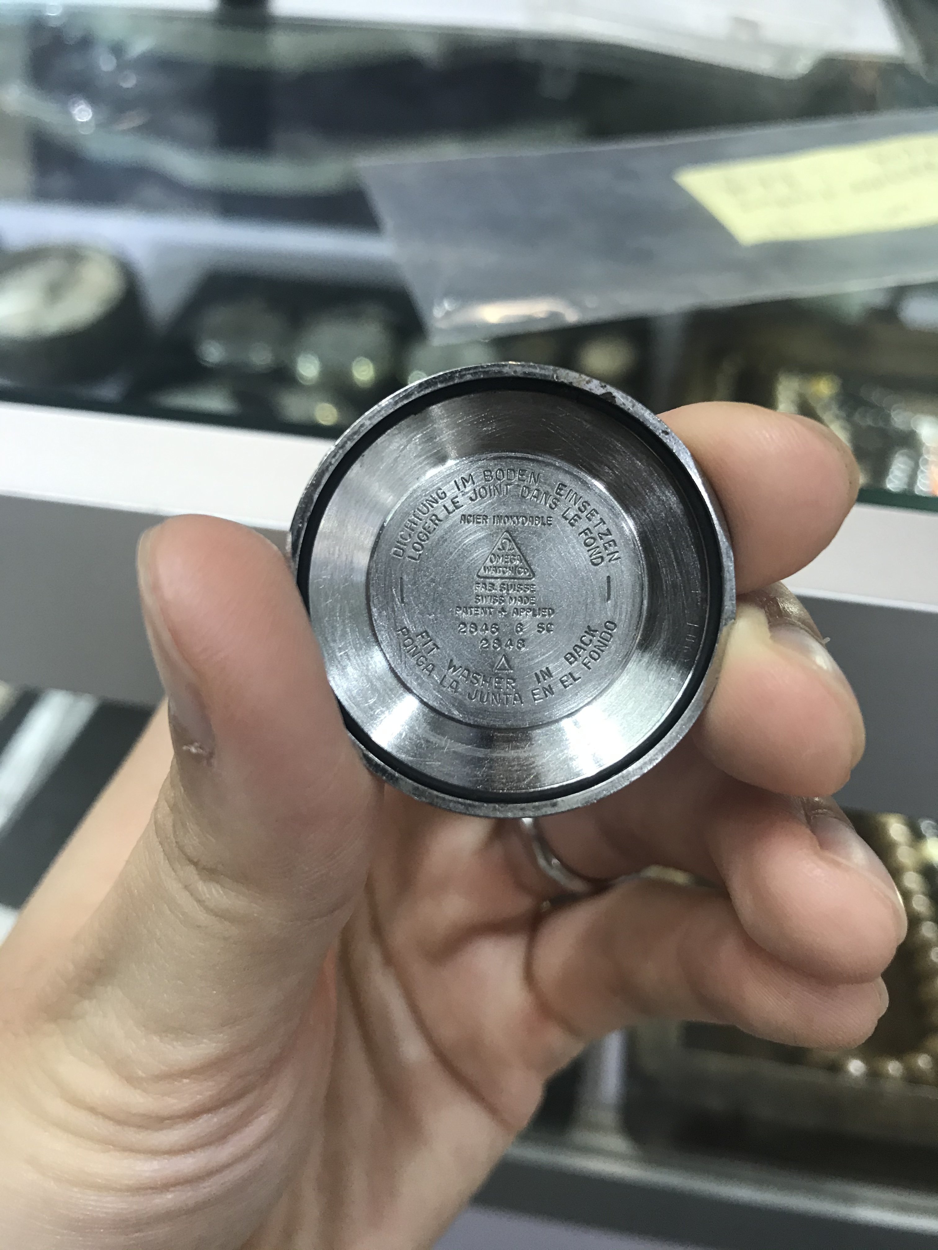

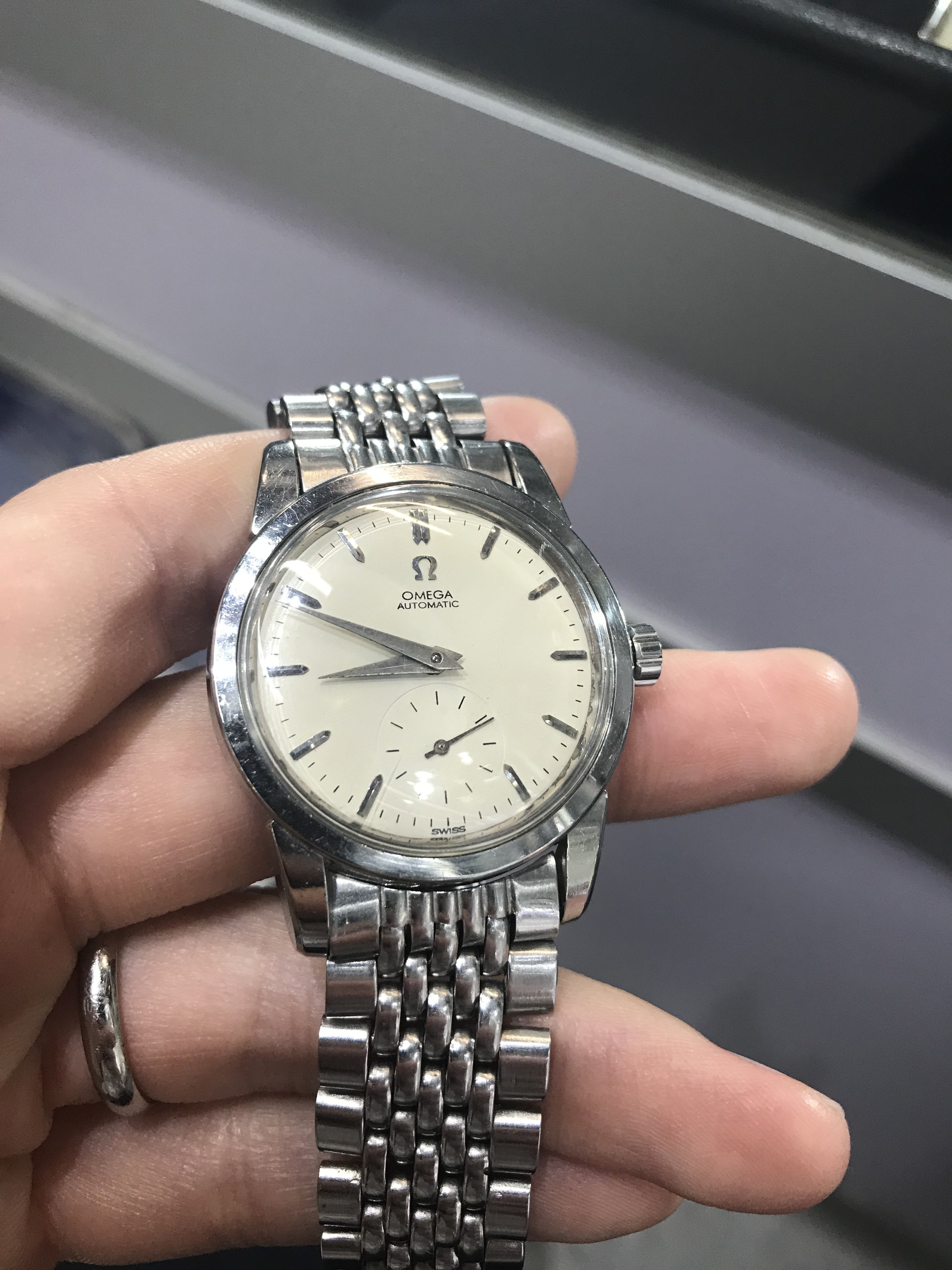

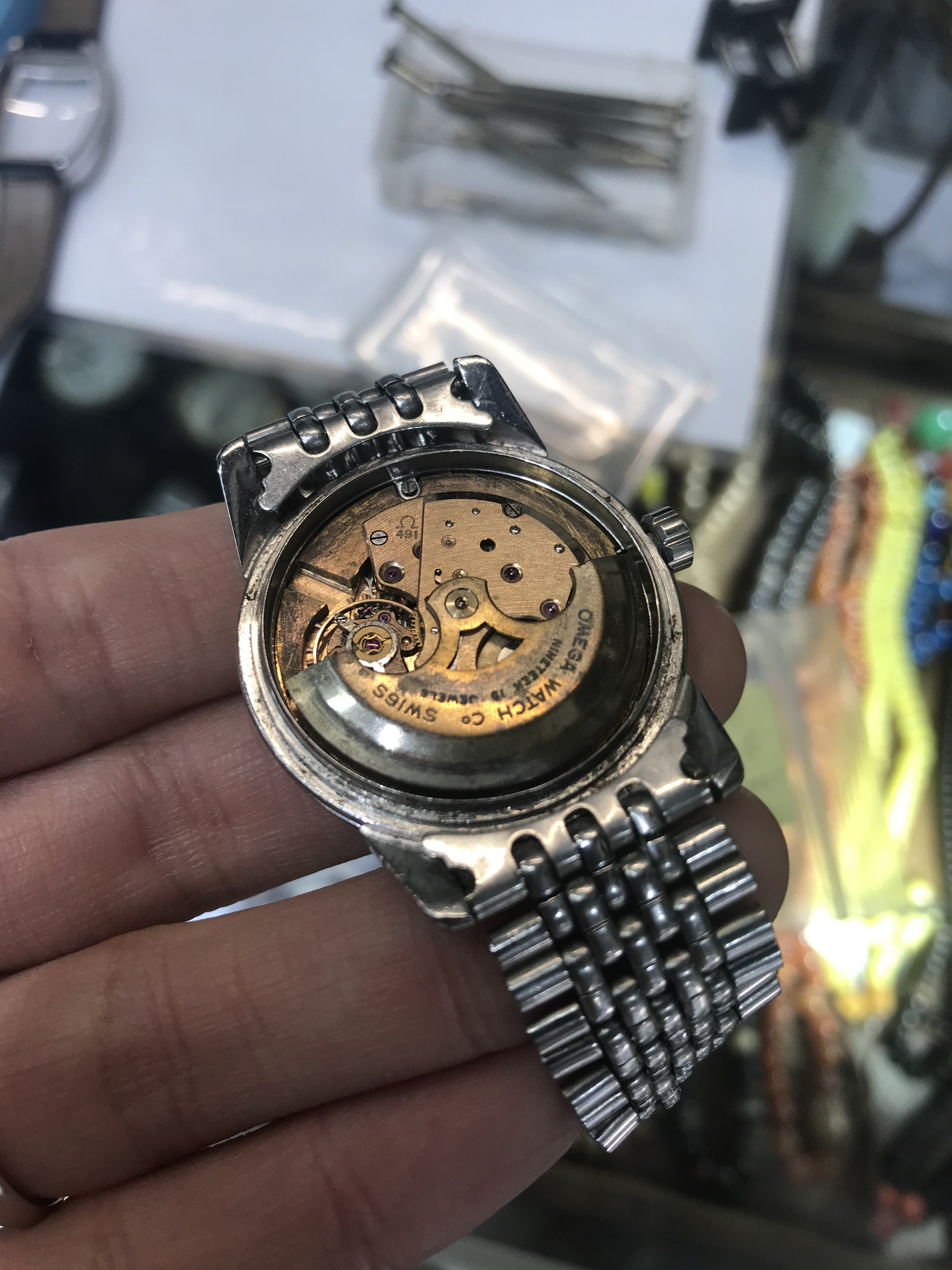

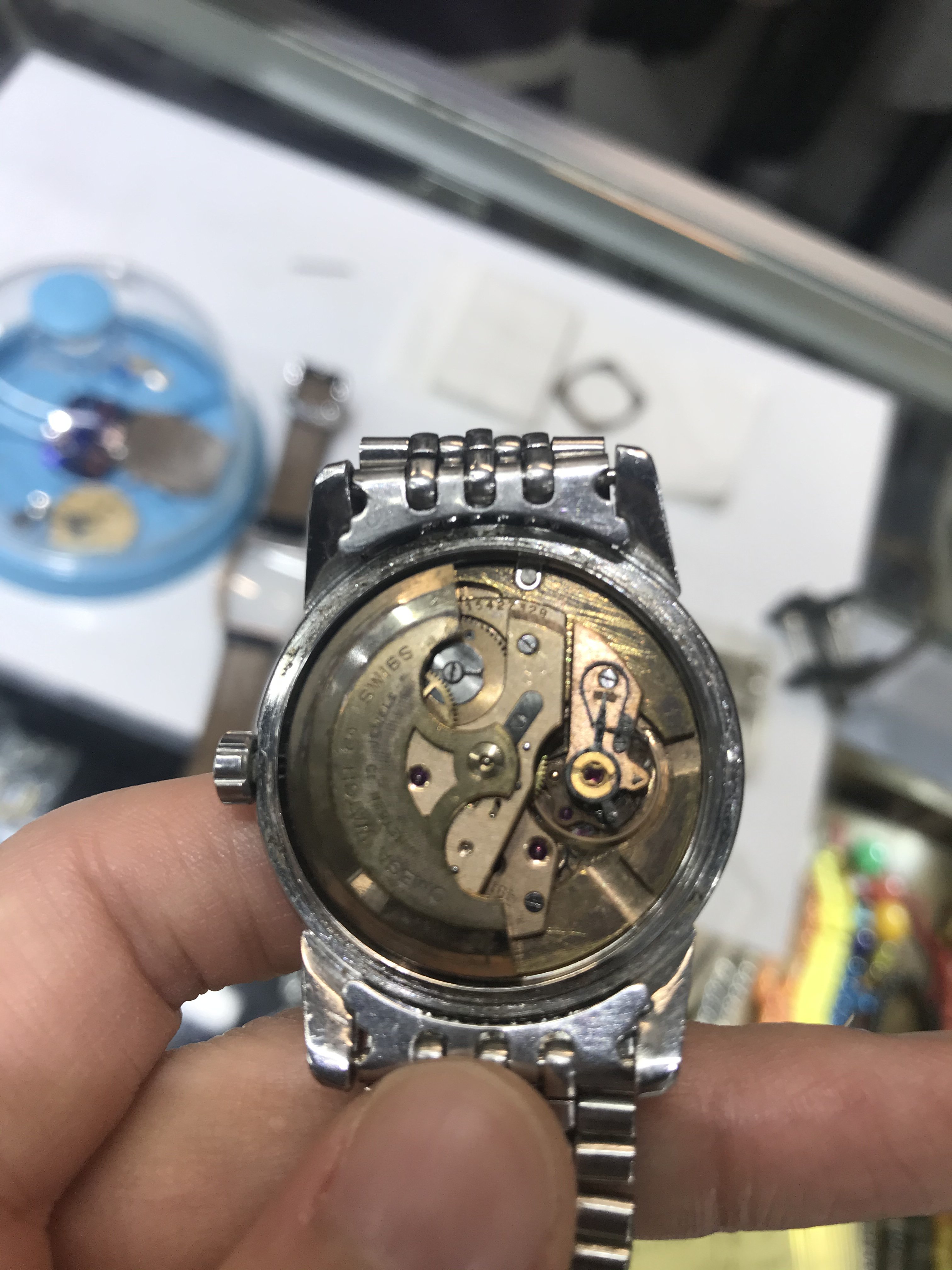

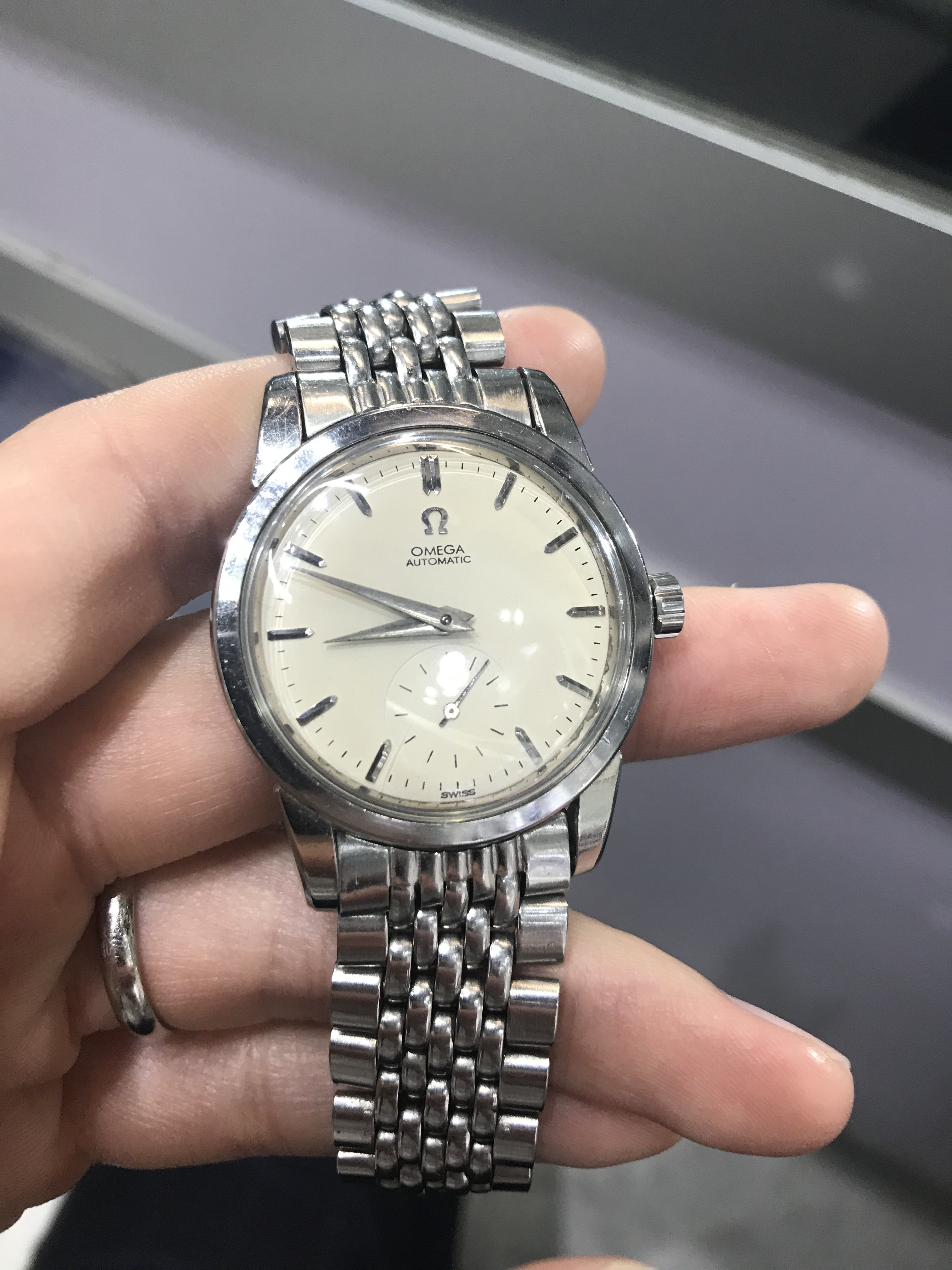

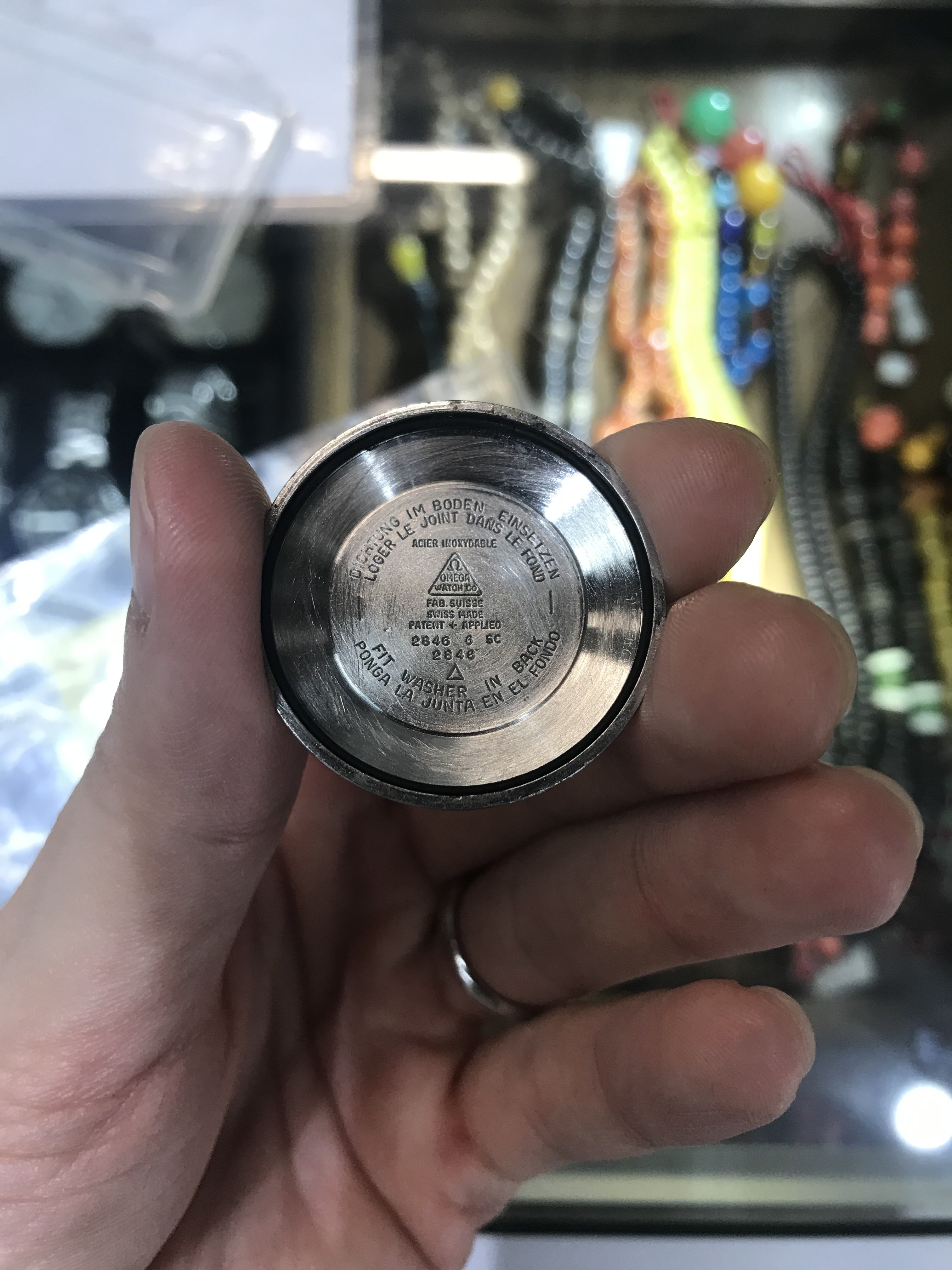

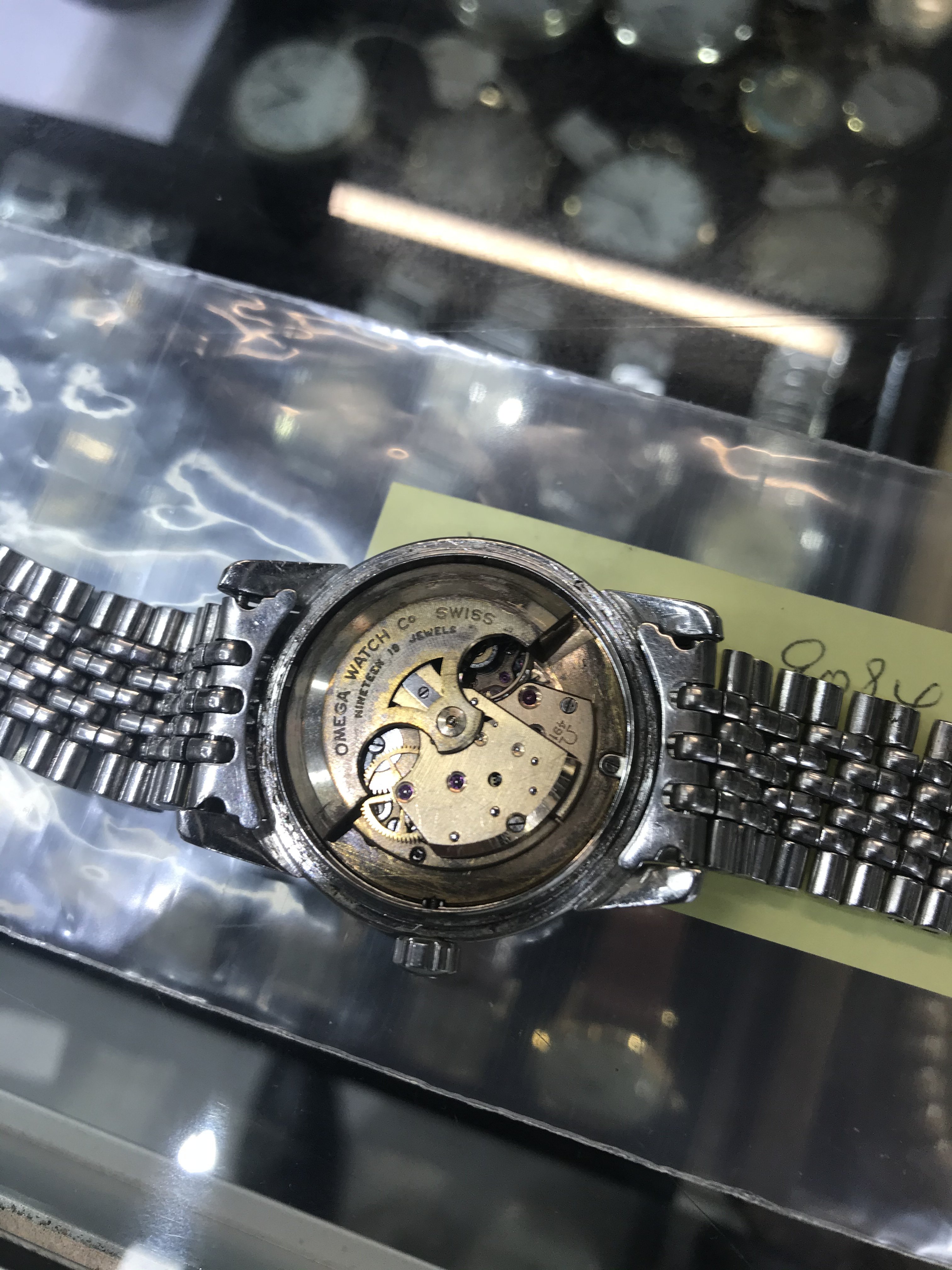

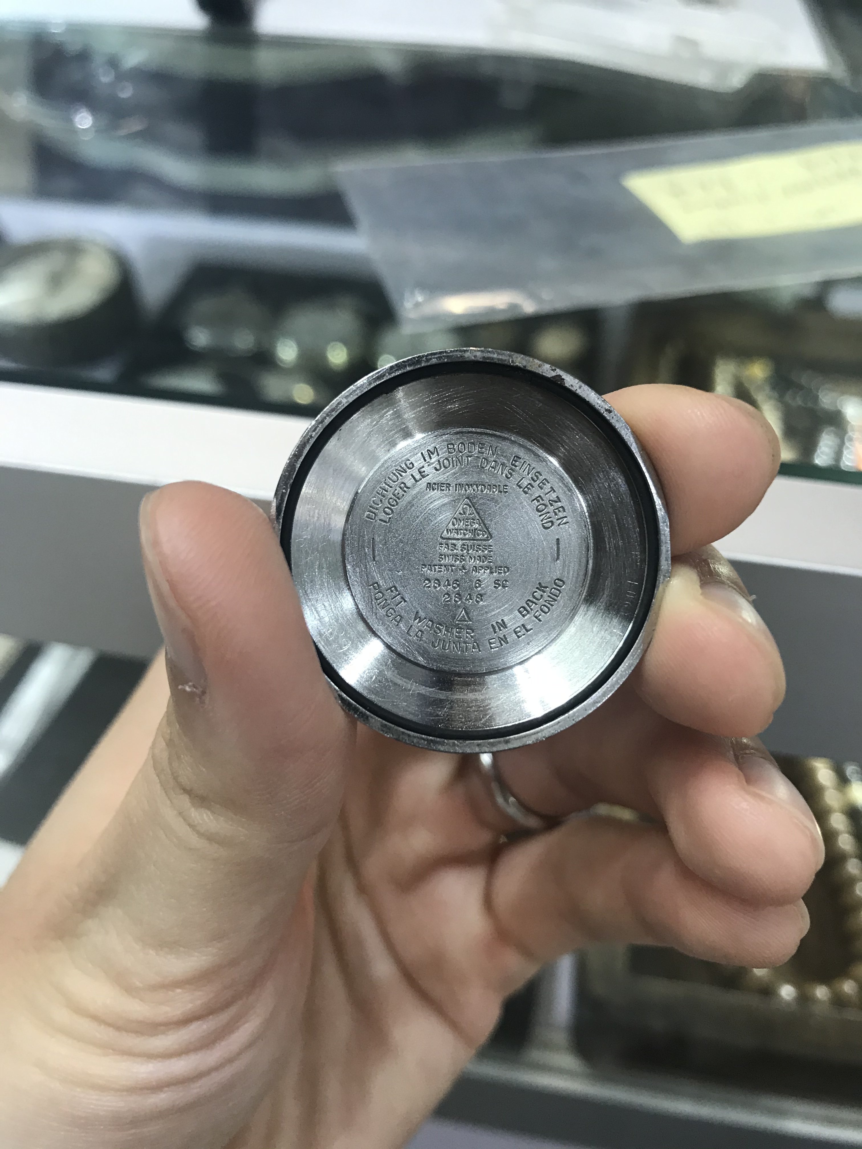

Hi all, I have bumped into a very good looking cal 491 unsigned Seamaster with a sub second. It looks great on wrist but I doubted it is redialed/ reprinted. I would like to seek you guys’ expertise about the authenticity of the watch; and if it is reprinted/ redial, does the work done reasonably and justify the price tag of USD500 for the purpose of daily wear? Many thanks in advance
260
673
The dial has been reprint. Movement looking tired. I suggest you to move on and find a better one. For $500 you could get a much better example than this. Just keep searching.
Goodluck
10,804
16,814
Redialled 2848. If you want to know the tell, it’s the style of font. That type of lettering wasn’t seen until much later than the 1950s. Search and compare with others 2848s that is if you can find a pic, the double case marks fool people into misidentifying the 2846 and 2848 models.
