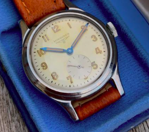

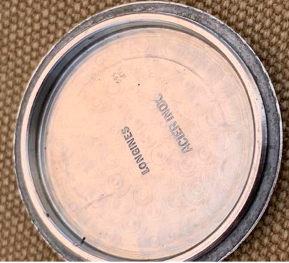

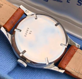

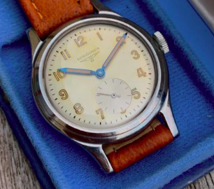

Dear OF members,
I'm interested in the below watch. I was just wondering if you could help me with a little check of it.
I like obviously the look, patina, blued hands... Browsing on OF it seems similar to some models (MN etc) I have seen reviewed by some of you.
- It is from 1945 (not specifically military linked to, at least no mention on the casings nor by the seller)
- it is 34mm

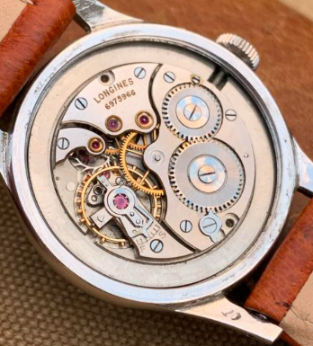

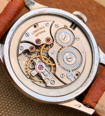

- the movement is a 23M.
- The main difference I can spot is the logo actually : in the ones I have seen reviewed from this period and this style, there was no logo whereas here you have one.
To the knowledge of the seller (which I have no reason to be doubtful), all is original (including the crown unsigned).
But what do you say ? Does it seem all legit to you ?
The price is a little high, will not see my money back if I had to resell but I really like it.
Thanks for any lights you can put on this one 😀

Logo came in in 1942
https://wornandwound.com/182-years-long-meadows-history-longines/
( I have seen this watch before I believe. The pictures anyway- no sure when or where )

I keep gathering 'facts' (I checked the number of the movement and it does correspond to 'approximately 1944' according to the nice ressource I found thanks to OF : https://vintagewatchresources.com).

It’s been on sale at least since early september, and the reason why it’s not selling I suspect is because the dial’s been transplanted.
Longines archive indicates its dial should be black and grey.
Movement serial 6'975'966 was invoiced 28 décember1945 to Terrasse, Sweden.

Oh great ! Thanks @Syrte : I'm very happy not to have bought it yesterday 😀 I was hesitating over the price but what a relief to have avoided getting a non original watch... which would have spoiled most of the pleasure to wear one. Merci !
