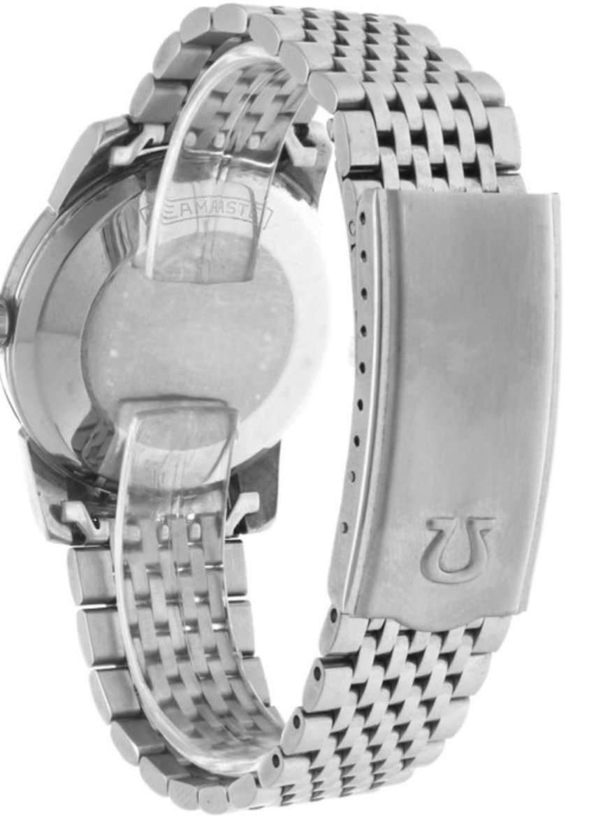

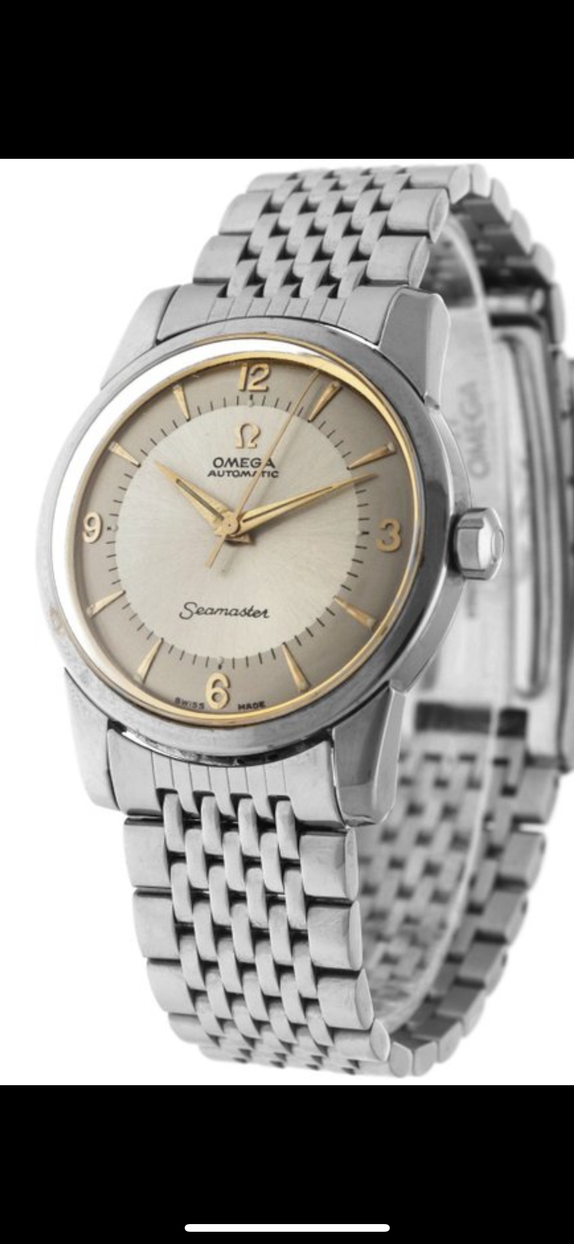

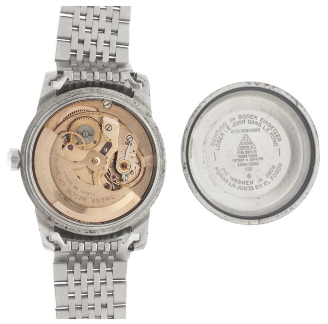

Need help with this 1950s Seamaster 34mm
13
Can you tell if theres something off?
The seller says it has a service dial, but is it still considered genuine? I’m also wondering about the bracelet if it’s factory or replacement? The watch is from 1956, I believe.

Not a service dial, a refinished (and not very well) dial. Kills any collector value. Bracelet if genuine is from a later watch.
If you haven't already purchased this watch don't.

The bracelet is about as genuine as the dial finish.

This isn’t a watch to start a collection with. It was likely a complete mess a couple of months ago and has been redialed and polished to make it look ‘presentable’ for sale.

It’s not the model I’d avoid, it’s this specific example due to the extensive and poor refinishing.
The best way forward is for you to try and pin down a style and era (ie time only, silver dial from the 60’s, or gold plated from the 50’s). Members can then help advise on suitable references.
