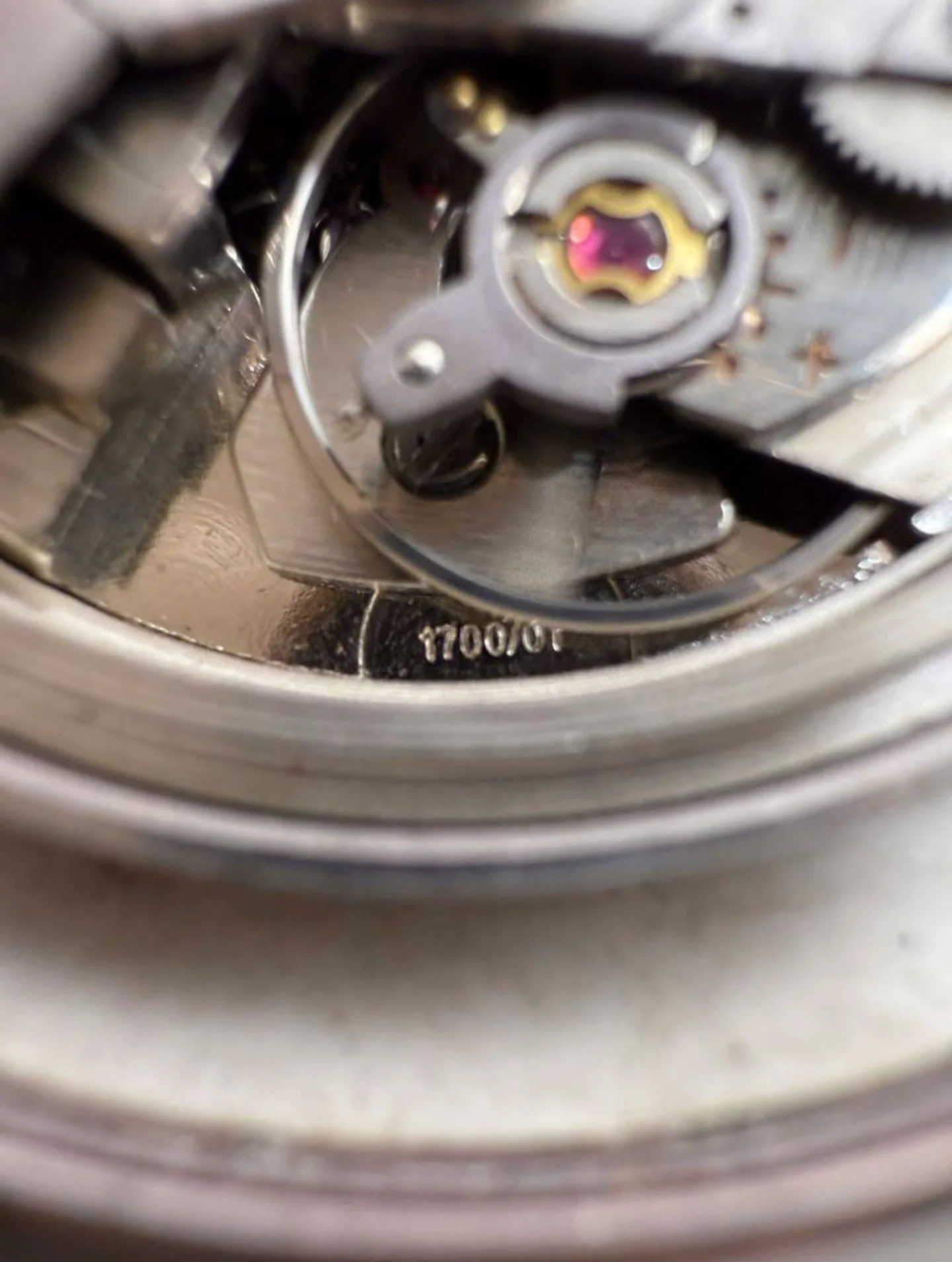

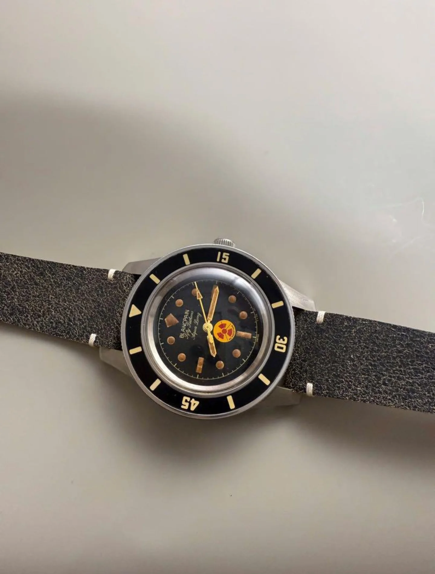

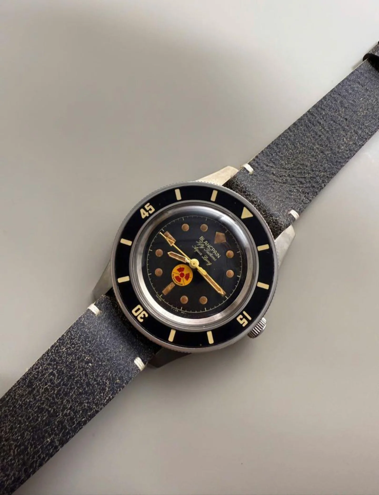

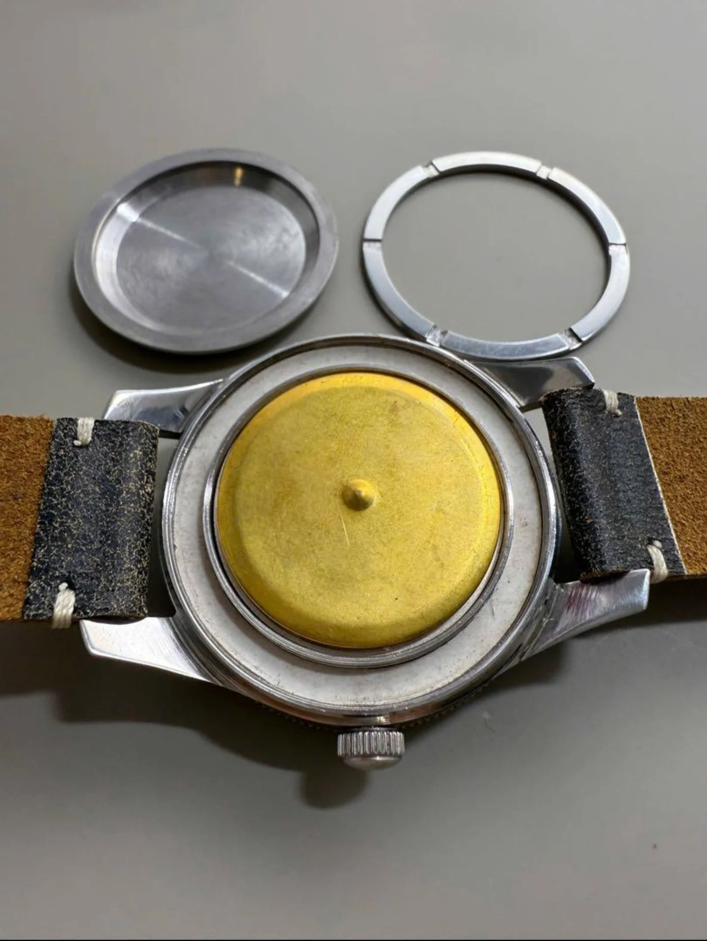

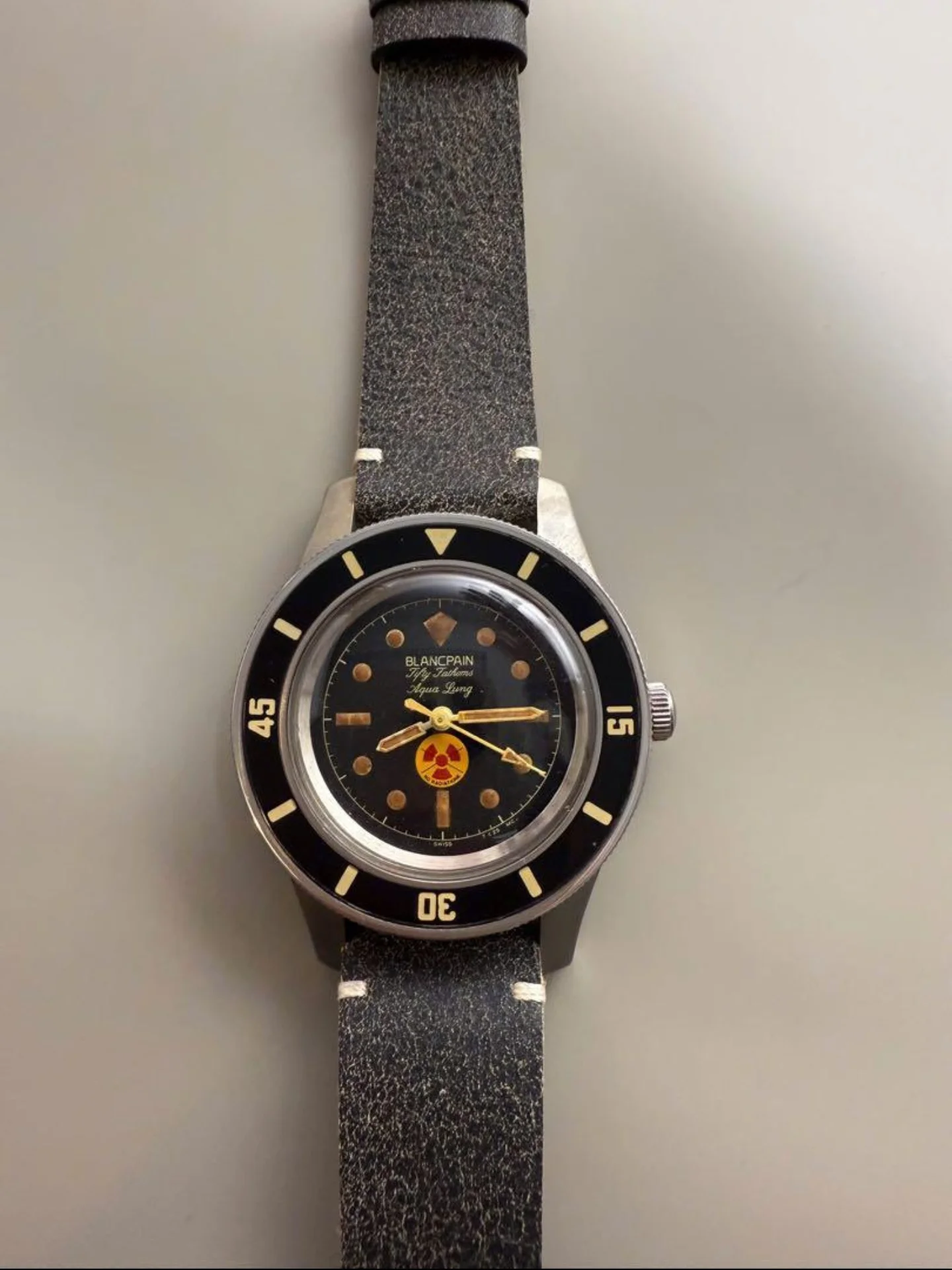

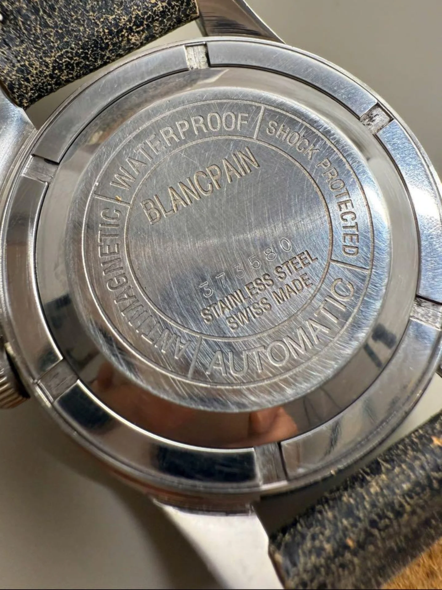

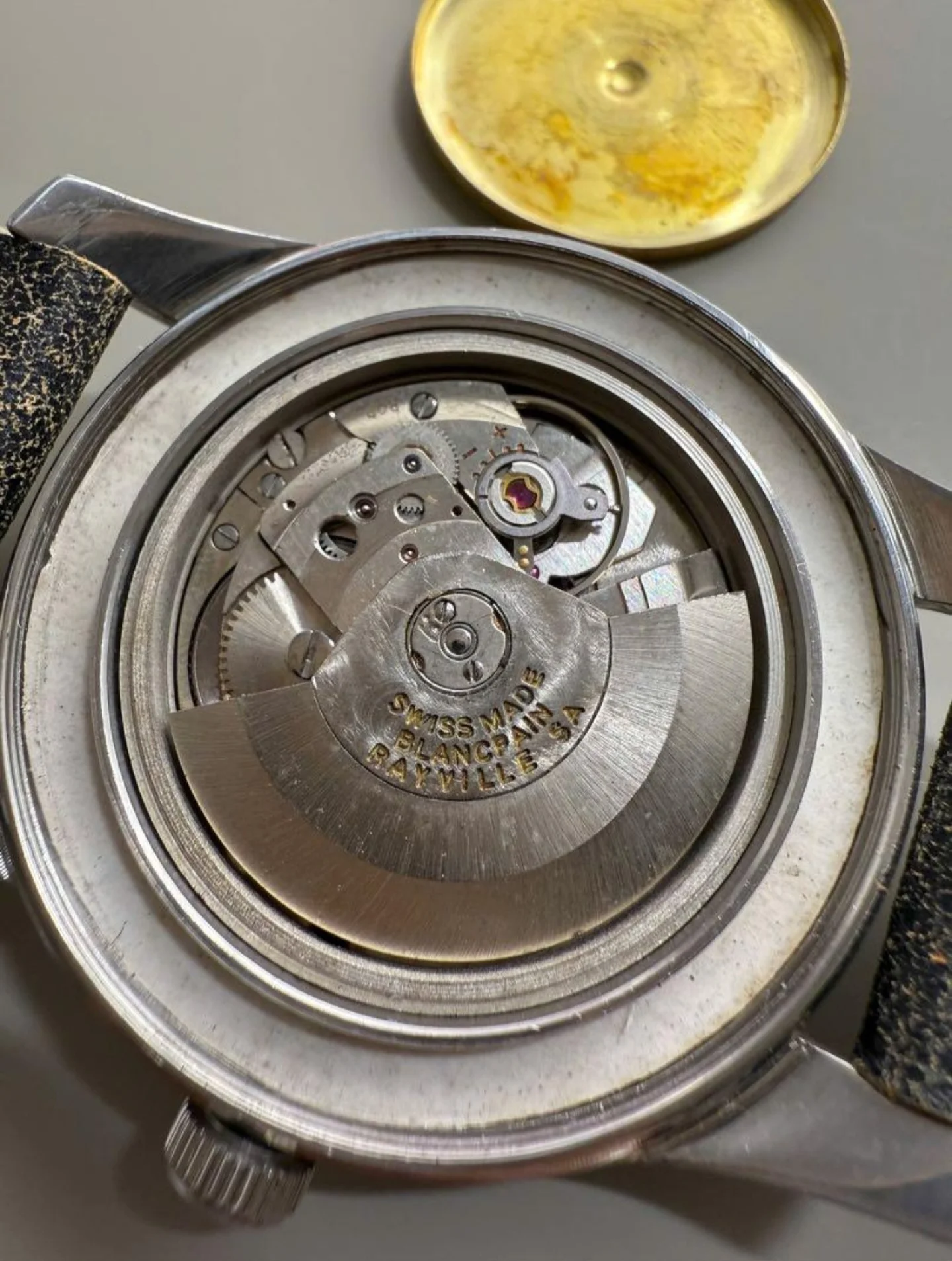

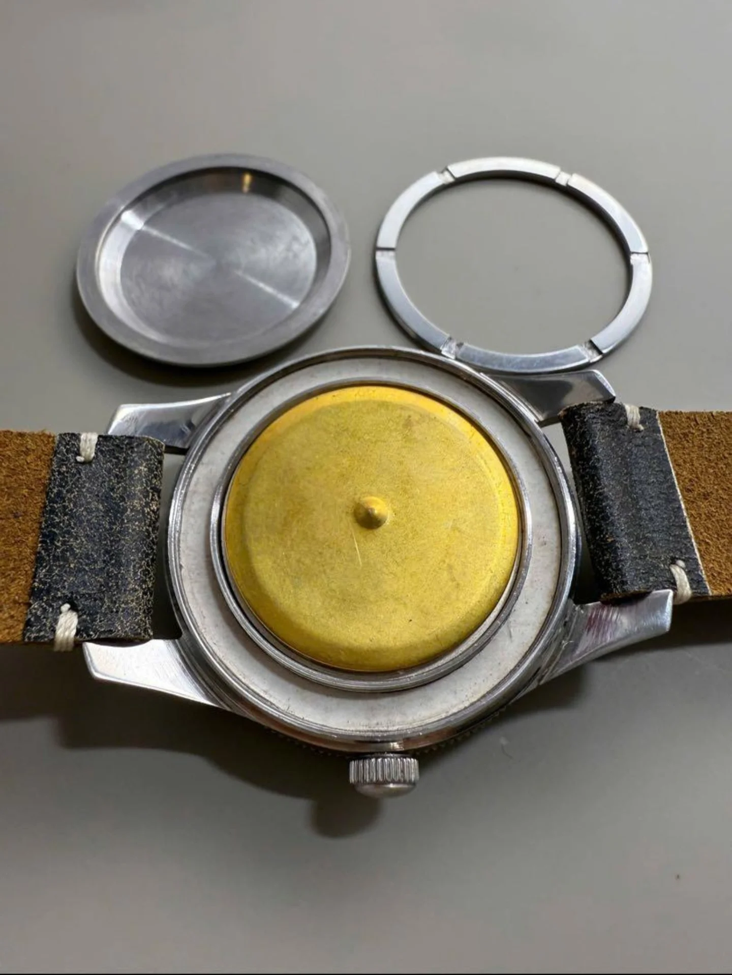

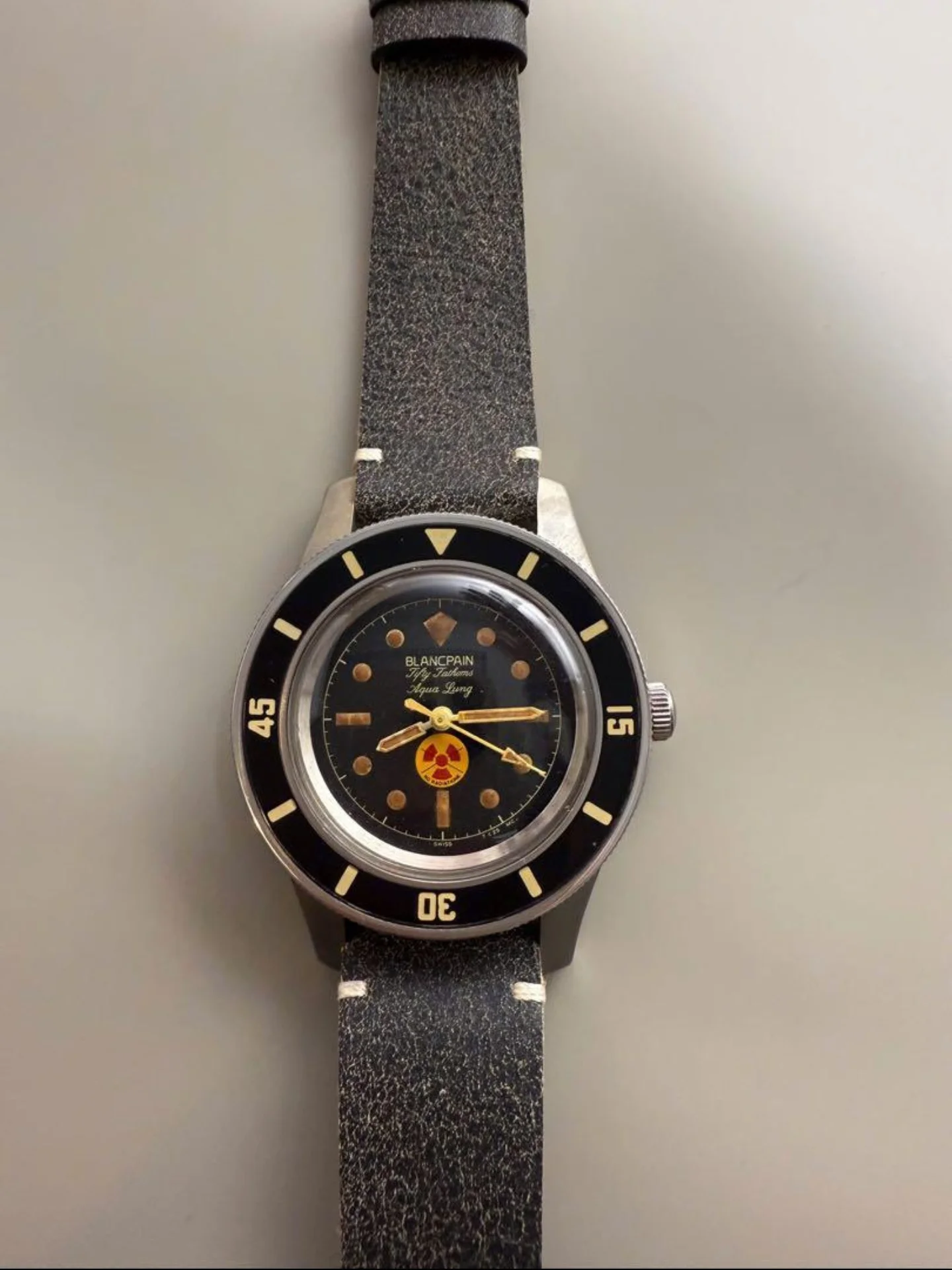

Recently I stumbled across someone selling vintage Blancpain Fifty Fathoms, since I don't know much about this vintage Blancpain, I have 0 clue on how to spot a fake one. Luckily the seller is brave enough to share detail picture of the watch. Would be grateful if you guys can help me on this one, since if it's real , this will be the first Blancpain I get.

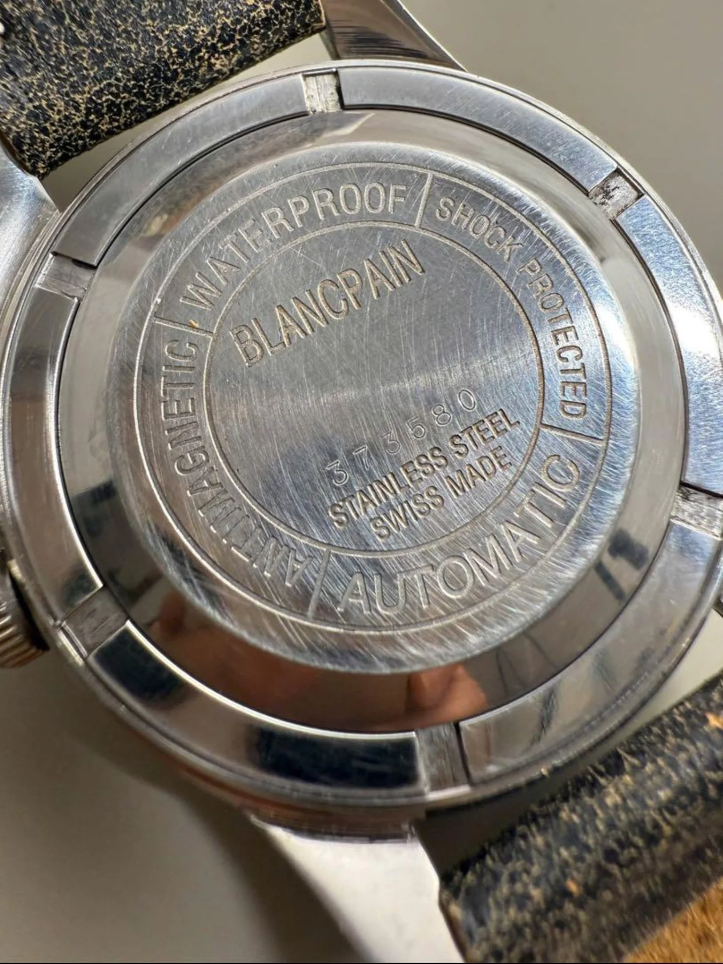

The only thing i know about vintage blamcpain is the movement is supposed to be uttilitarian with few to no frills and the case back supposed to have a janky setup like this one. Other than those 2 I'm completely in the dark here. Would appreciate it if some one can help me with this one. Thank you

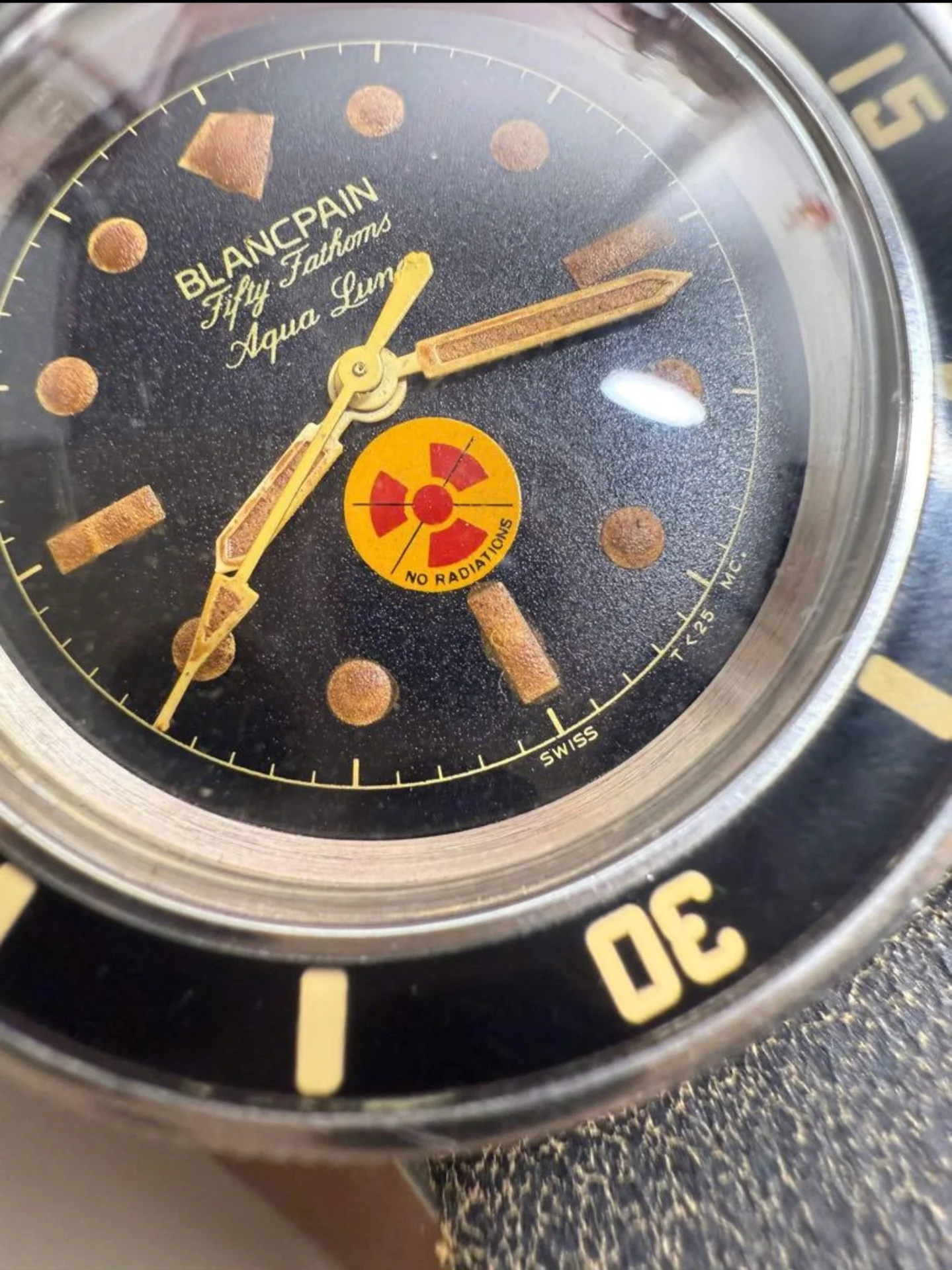

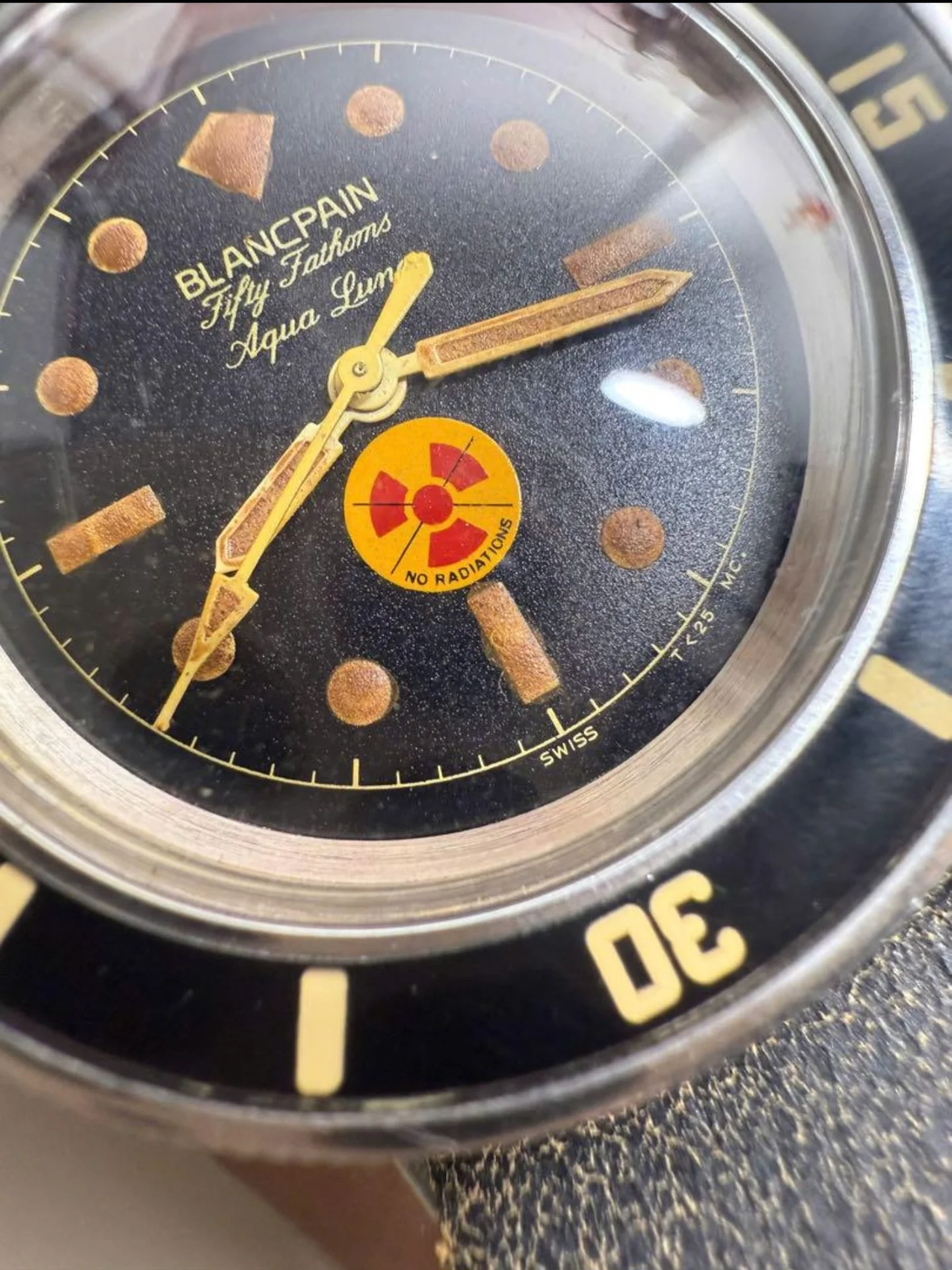

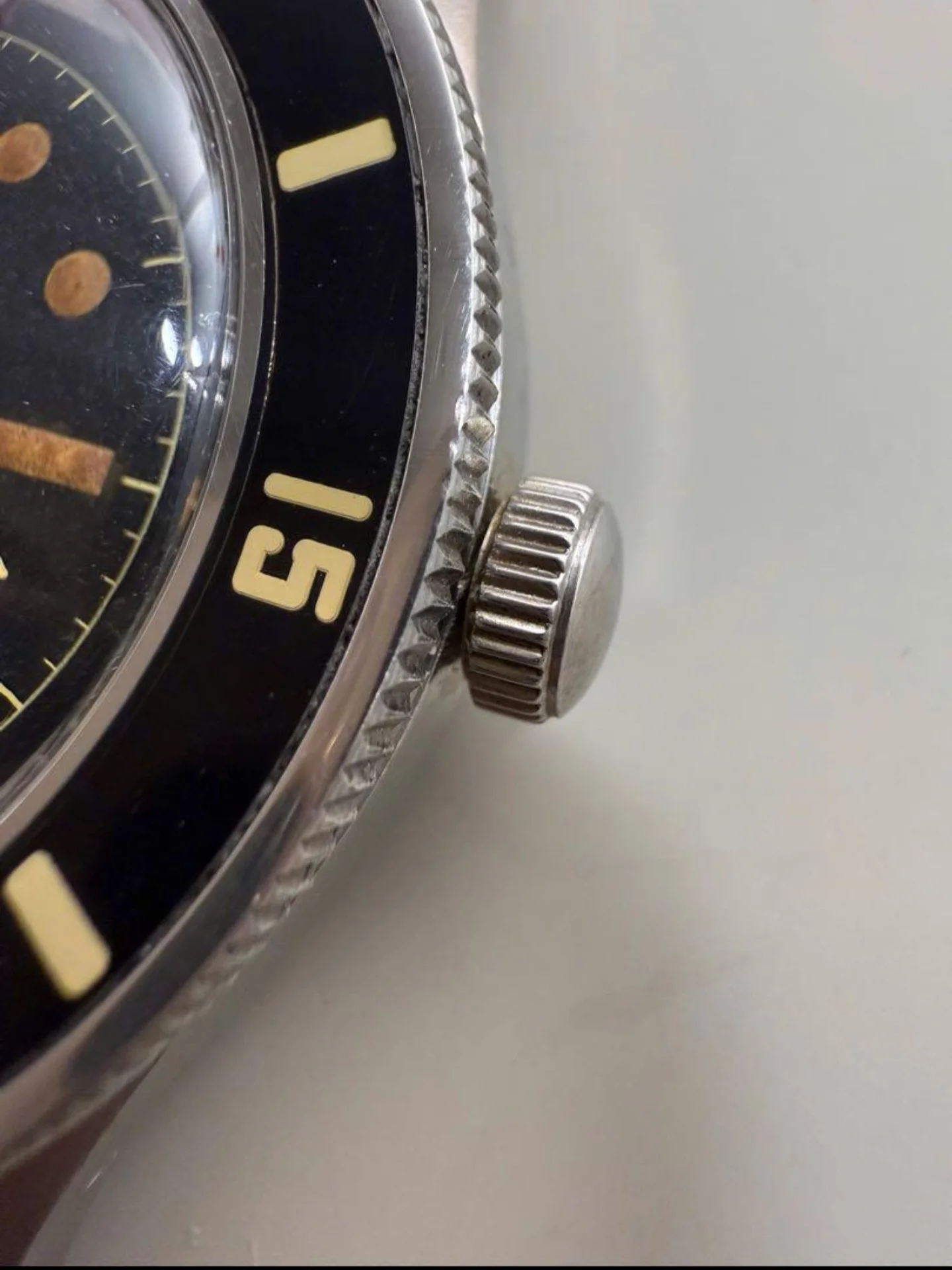

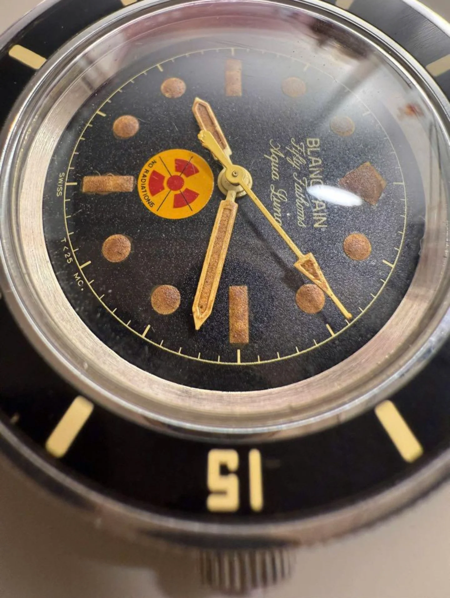

Looks like someone attempted to stabilize the lume plots? And painted over the front of the hands as well.
I am no expert on these, but just on general principles I'm suspicious of the bezel. So I'd suggest comparing that to other examples.
24,843
55,270
A few minutes research also suggest that the hands are incorrect. I think you need to do some research and make careful comparisons. Perhaps what I thought was an attempt to stabilize the lume was a sloppy effort to age the lume. It's possible that the watch is largely fake, proceed with caution.
Thank you so much for the quick reply, yeah I also have little bit of suspicion about the dial and the bezel. Would take your respond on my mind next time i come across another one. Thank you !
