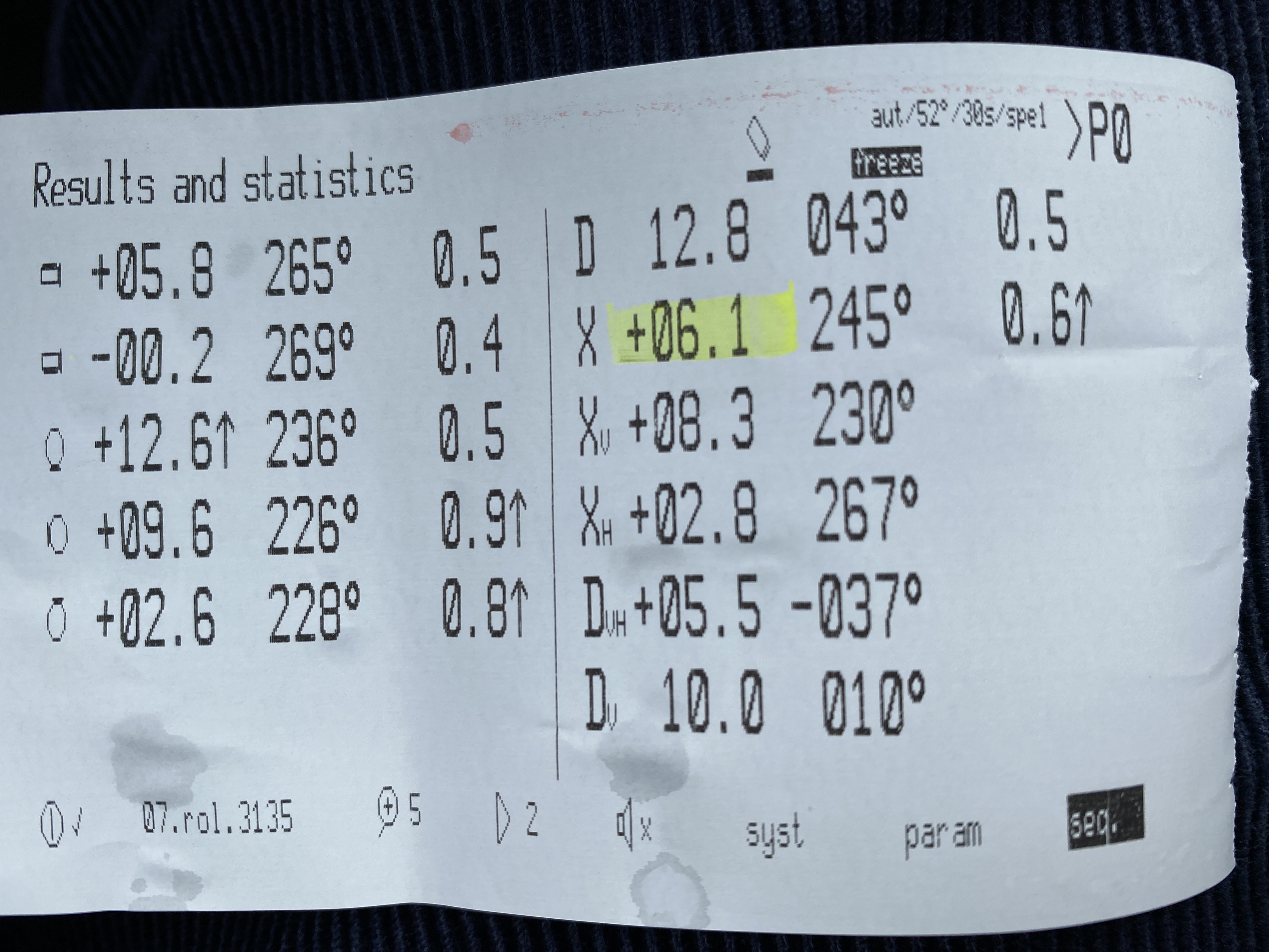

Hi folks,
I’ve been given the opportunity to purchase this watch circa 1996-2002. Bracelet looks great and nothing major on the case. Sorry no pics. I was too excited and it didn’t cross my mind. However we were able to put it on the timegrapher and he said the amplitude is pretty decent and might need a service in 2 years. Watch comes with no box and papers but does include a 2 year warranty. I am debating whether to get this or a new 1861... or wait longer for a 3861. Can someone comment on the readouts below. Seems like the average +6spd is pretty good for a 20yr old watch.
Thanks.
30,293
78,216

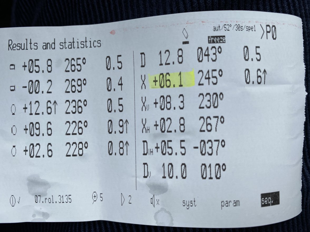

Not sure who did this check, but they have used a program for a Rolex 3135, which has a lift angle of 52 degrees. The 1861 movement has a lift angle of 50 degrees, which means the balance amplitudes shown, which are already a bit low as they appear, are actually lower than what is shown.
The chances that this movement requires a service are high, so I would account for that in the price you are willing to pay.
Thanks @Archer that is a great catch. The guy who ran it isn’t necessarily a watchmaker but I’m assuming has some experience at the store which used to be an Omega AD. They are asking $5250. I am drawn to it because of the display caseback with a hesalite front.
Do you think a minimum service would be lubrication or a complete replacement of the mainspring? Probably an impossible question to answer without seeing the watch. Was wondering if that was something I could negotiate before the sale.

A proper service will include replacement of the mainspring and any worn parts.

You say you were there when they put it on the timegrapher. So this is the printout for the watch you want to buy but the machine setting is for the wrong movement. Condition and price always determine the value of the watch. You say that watch has a 2 year warranty. Curious to know when the watch was last serviced and by whom? What does this warranty cover. There are so many watches for sale with box and papers, and may have been serviced by Omega, or the watch may be due for service and that should all be part of the negotiation.

Yes I was there and he took the watch and went back to put it on the timegrapher so technically I wasn’t physically there seeing it. Now if this mistake was intentional or if he used as different watch..well that’s a whole other issue. However my interactions with them so far have been professional and pleasant. They claim they do not know the service history. And I have not asked about specifics on the 2 year warranty.

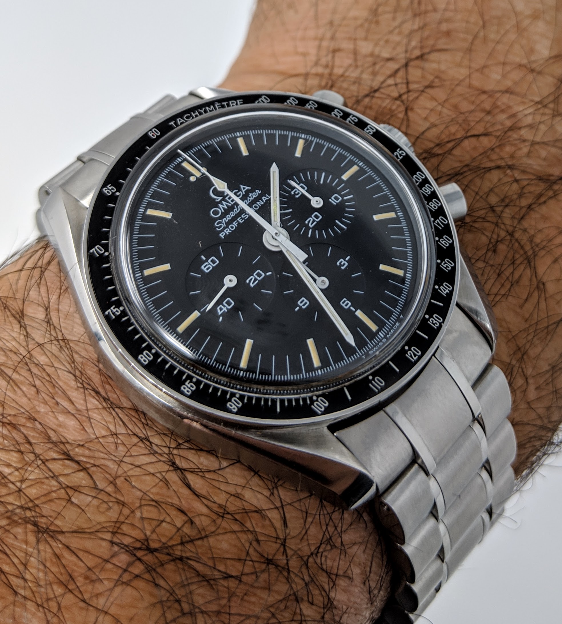

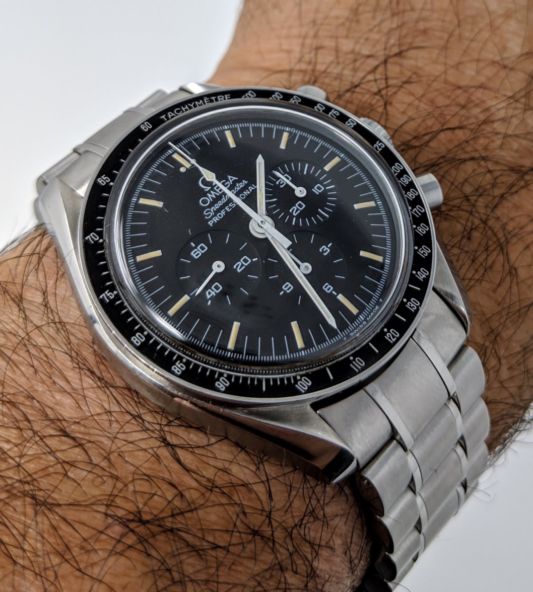

Here is my 3572.50. it's tritium. Markers are more of a creamy color vs the luminova, which are more of a greenish white color.
234
153
Great looking watch! That endlink looks like its coming off?
