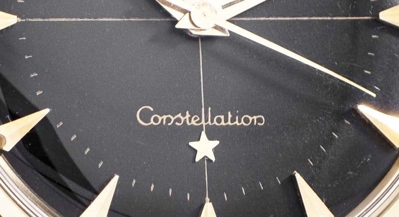

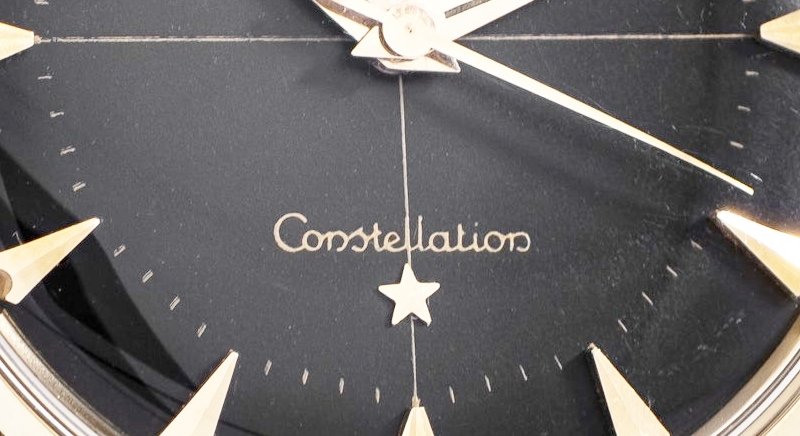

If you need more ammunition for the seller,
The minute marks are very poorly done, random lengths and alignment, sloppy, too close to the centre, 11 and 1 misaligned, 3 is missing completely

Semantics. They can say it was redone correctly if the all the words are present, spelled correctly, and generally in the right places. What the experts are saying is that the printing is not accurate. A really good re-dial can take careful inspection to identify, this isn't one of those.
Overall, I don't think that the seller misled you. And TBH, they rely entirely on inexperienced buyers to sell watches like these. Buyers who have the idea that it would be cool to have a vintage watch, but want it to look new and shiny. There are plenty of buyers in that category.
There is no reason to argue with the seller, if you don't want it, it seems that they have a return policy. If you feel you need to explain your reasons, you can just say that you misunderstood what was meant by "restored." People with experience understand that to be a euphemism for repainted, but I've often seen inexperienced people think that it means the dial was cleaned. If they want fewer returns, they can be more upfront in their descriptions.
The minute marks are very poorly done, random lengths and alignment, sloppy, too close to the centre...
Thank-you!! I wish I had you on the phone with me LOL. They were really aggressive in their argument, and said that "splitting hairs does not matter."

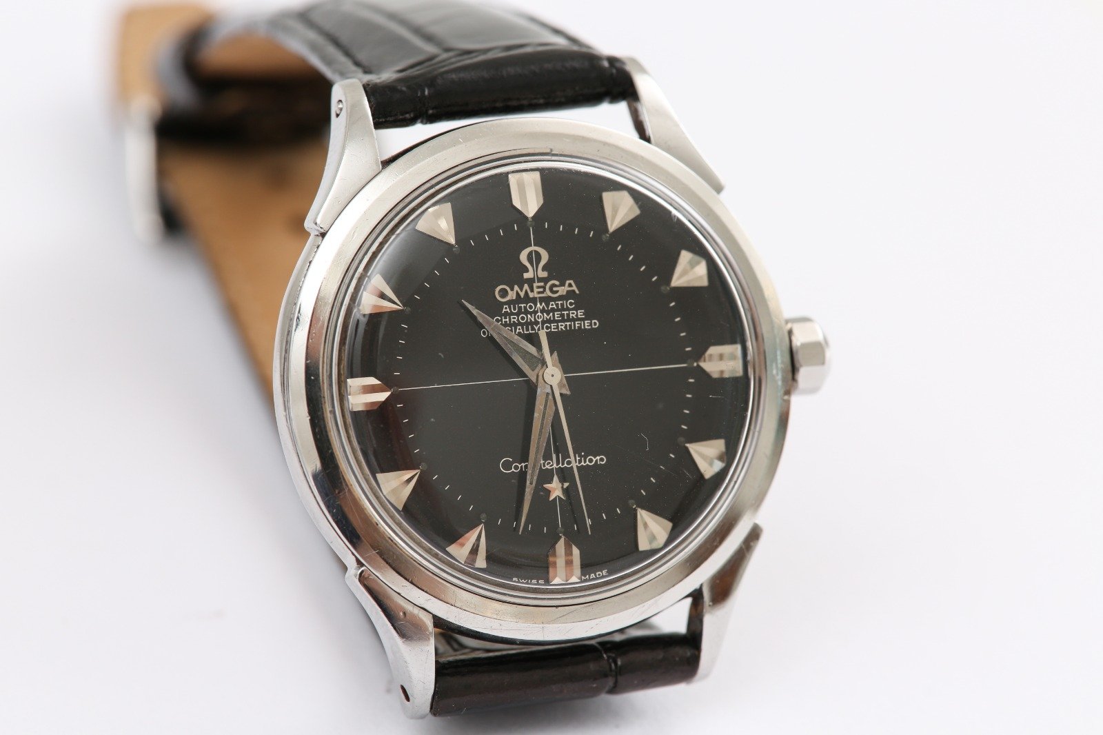

Authentic black dial Constellations are quite uncommon. You will need to be very patient, or pry one out of the strong hands of a collector. Silver dials are easy enough to find.

again: just take a look at the star and the horizontal cross-hair: can this be Omega-quality?

Most of constellations with black dials in that period were "gilt" dials.
You should learn what a gilt dial is before buying one.
