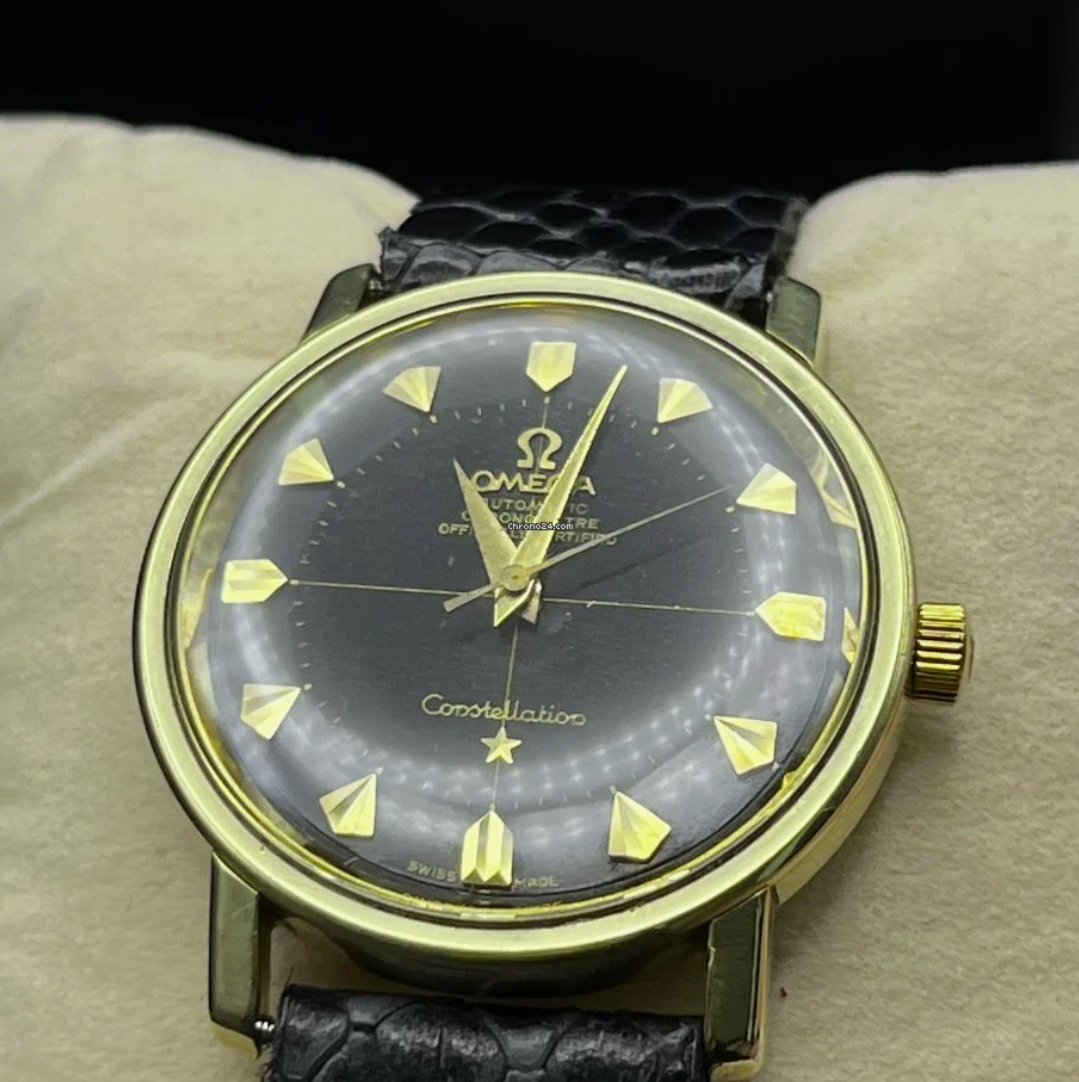

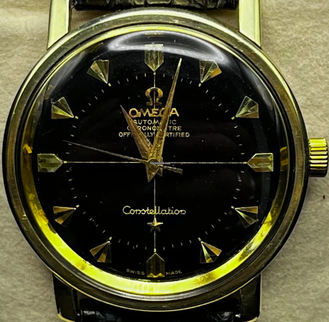

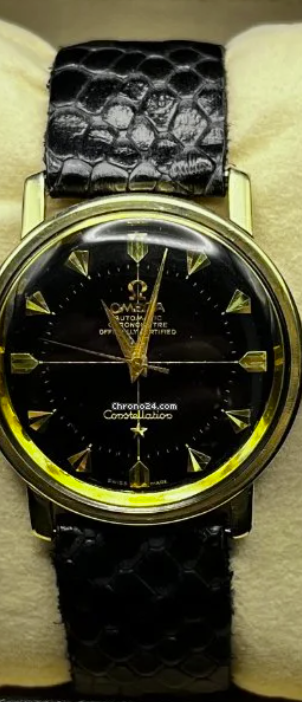

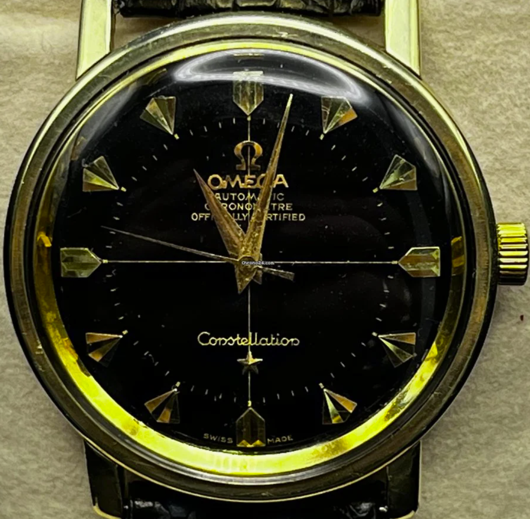

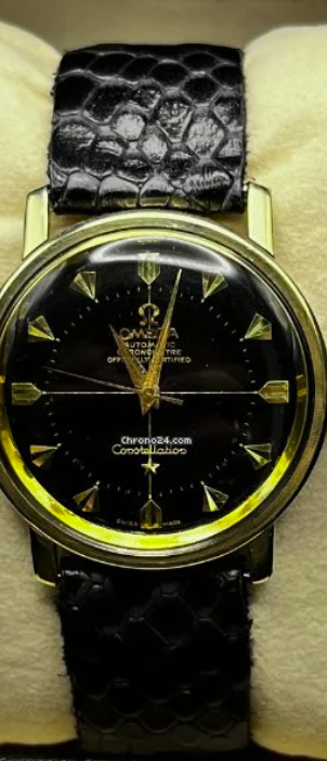

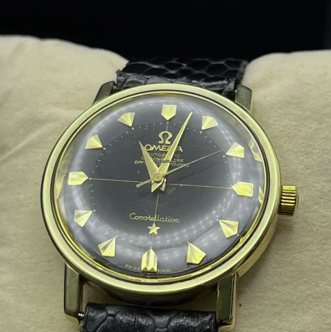

Okay guys,
I got burned by the last watch purchase (thankfully got a refund) and you all really helped me verify the authenticity and my ideocracy from the last purchase, to which I vow to not make the same mistakes ever again...
Thoughts on this watch? Is this a beauty, a fake, or Frankenwatched?
29
5
To add, it seems to pass the M O Y test!! I just learned about this today, all of you are immaculate humans teaching me about the art of watches. I am so psyched.

-re Chronometre spelling was used until the late 50s, ~58 or so. The watch in question is from about a decade later…
There are a few more issues, that alone is an easy tell-tale sign for you though.

@MtV they are saying that this watch is coming from 1956, do you have any reference of about a decade later? I show one from 1957 that looks exactly like this, they're saying it comes with a certificate of authenticity - what are the other tell-tale signs though?

Wrong case as said
Over polished case
Sloppy minute marks, see the alignment with minute marks and indices
Font has no serifs
No space between l and crosshairs
Wrong crown
E in made looks poor
It’s a jungle out there.
Always a bad sign when hands are covering the text, they are hiding something.

@blopkinz
it's all good advice above.
To be fair, you did at least ask if the watch is a beauty, fake or Franken.
It is not quite a fake - although it is purporting to be something it is not and could never be.
It is indeed a frankenwatch and definitely not a beauty.
And definitely not worth $3,660 😲
https://www.chrono24.com/omega/omega-constellation-pie-pan--id28460119.htm
The advice about research is very pertinent here.
The advert says it is ref 2852.
The 2852 did indeed come with arrowhead dials and the spelling of 'chronometer'.
However, 2852s had lyre shared lugs not straight lugs as on the watch in the advert.
(I've pasted the link because the info is so bad folks might want to avoid the seller altogether)
The case looks like a late 60s 168.010 that only came with a flat dial (as opposed to dome dial)
So it is a put together watch.
So, you need to familiarise yourself with the different case references and which dials those references came with - this will make it easier for you to know when someone is having you on.
BTW the case is in incredibly poor condition (there are no stars at all on the medallion!)
The price of the watches you are looking at is going up but the actual value is going down.
This is a parts watch - probably worth $200-300, for the movement (assuming it is a constellation movt) and a dodgy dial.

Wow. There are a lot of bad deals out there, but this one is indeed overpriced by a factor of >10. Ambitious.
