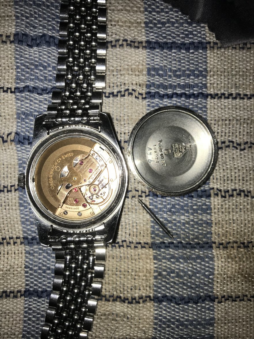

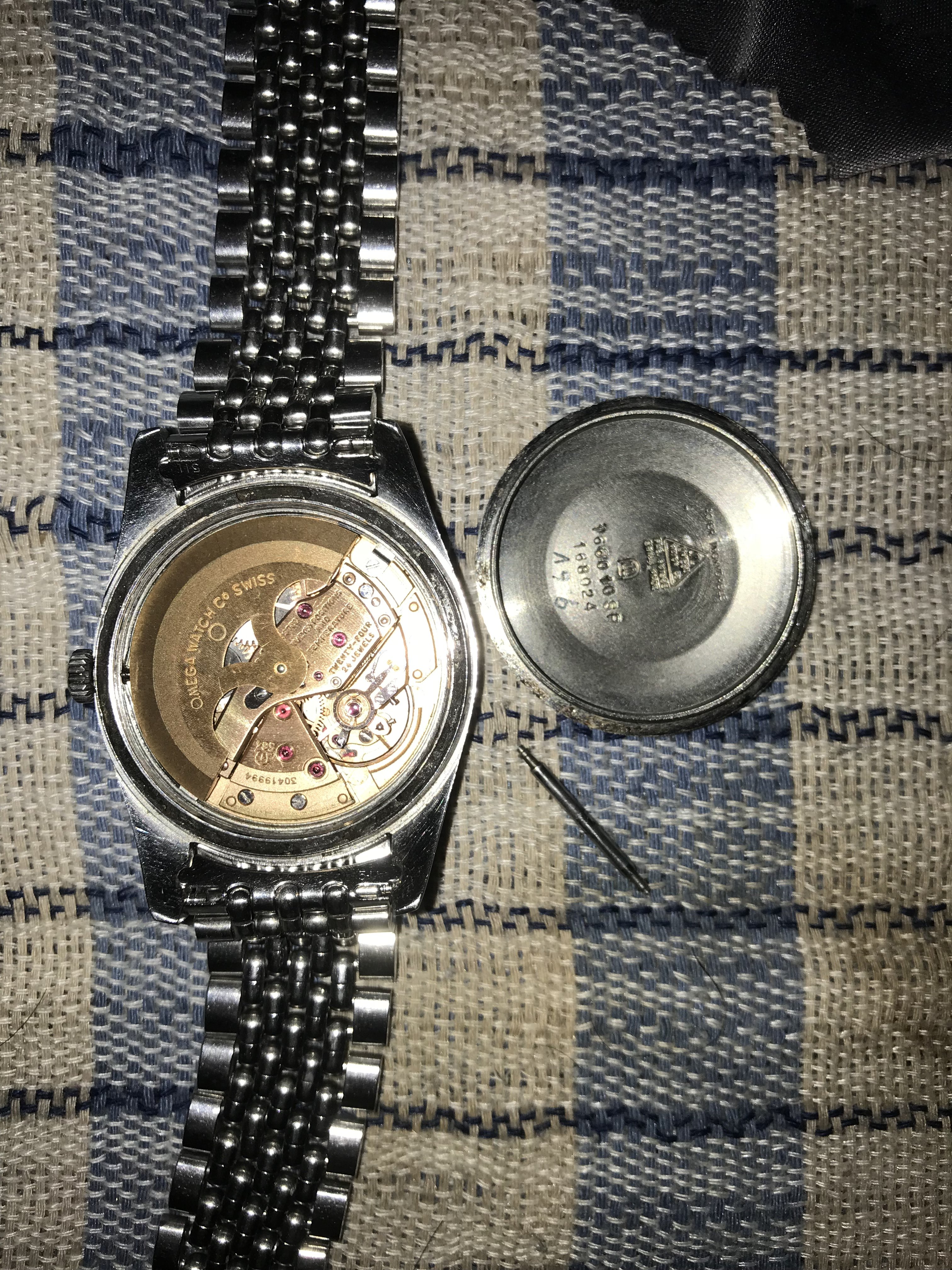

Need advice on authenticity of a Seamaster 166.010, cal. 565
284
334
The 565 quick sets by pumping the crown from position 2 (time set) to position 3. Your watch probably has a 562 - the same as the 166010 I sold here. It (semi) quick sets by cycling between 9pm and midnight as the seller says. There is a link in my sales listing to the service document I made for that watch and you can compare the movements. Your one is desperately in need of a service but, it might come up okay. I think those are jewels that your seeing next to the "24 jewels" writing - they are just very, very dirty.
If the BOR is in good condition, $600 doesn't seem too unreasonable (a bit high but the BOR could be worth $150 on its own) although, expect to add at least half that for a service/parts. Depends on the dial really as if it is spotted badly then I'd steer clear. The problem is these sort of watches with dirty/neglected movements can be real money pits so, you're taking a big chance...

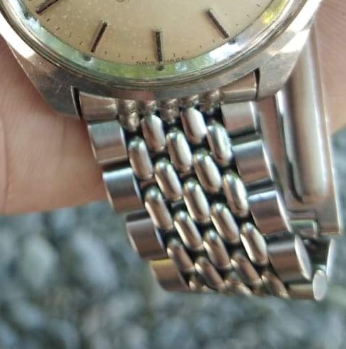

Some thoughts on the BOR of the OPs watch:
I think a full length 5 row BOR has 22 elements (without end links)
9 elements are south at 6 (2 with holes)
13 elements are north at 12 (3 with holes)
When buying a watch with a BOR make shure that full length is displayed in pictures. You should have at least 20 left!
On the OPs watch the short side of the BOR only has 6 links (instead of 9), none of them has a small hole.
The north side isn't displayed at all in full length.
So it could be that the bracelet is too short,
I think it has been messed with at the short side in a way

Good point. I have a BOR on at the moment and it's 8 & 12 - pretty sure I have two spare links in the parts box so, the one on the OPs watch does appear short and without any holes for the removable link as shown on the short side.
Definitely need better photos of the BOR as well - vintage watches are a minefield!

OP imo should pass on this one. After he's done with this one he's in it for at least $ 900. Not a good idea... Especially with a mediocre dial...

The seller says there are 18 links on the BoR, 7 down, 11 up. It is fine for my small wrists but, with the dial being in the condition it is in, i think it would be better for me to wait (and pay) a little more for a better specimen.
Thanks for all the help guys, especially the input on the BoR. Very much appreciated. I am glad to be here 😀

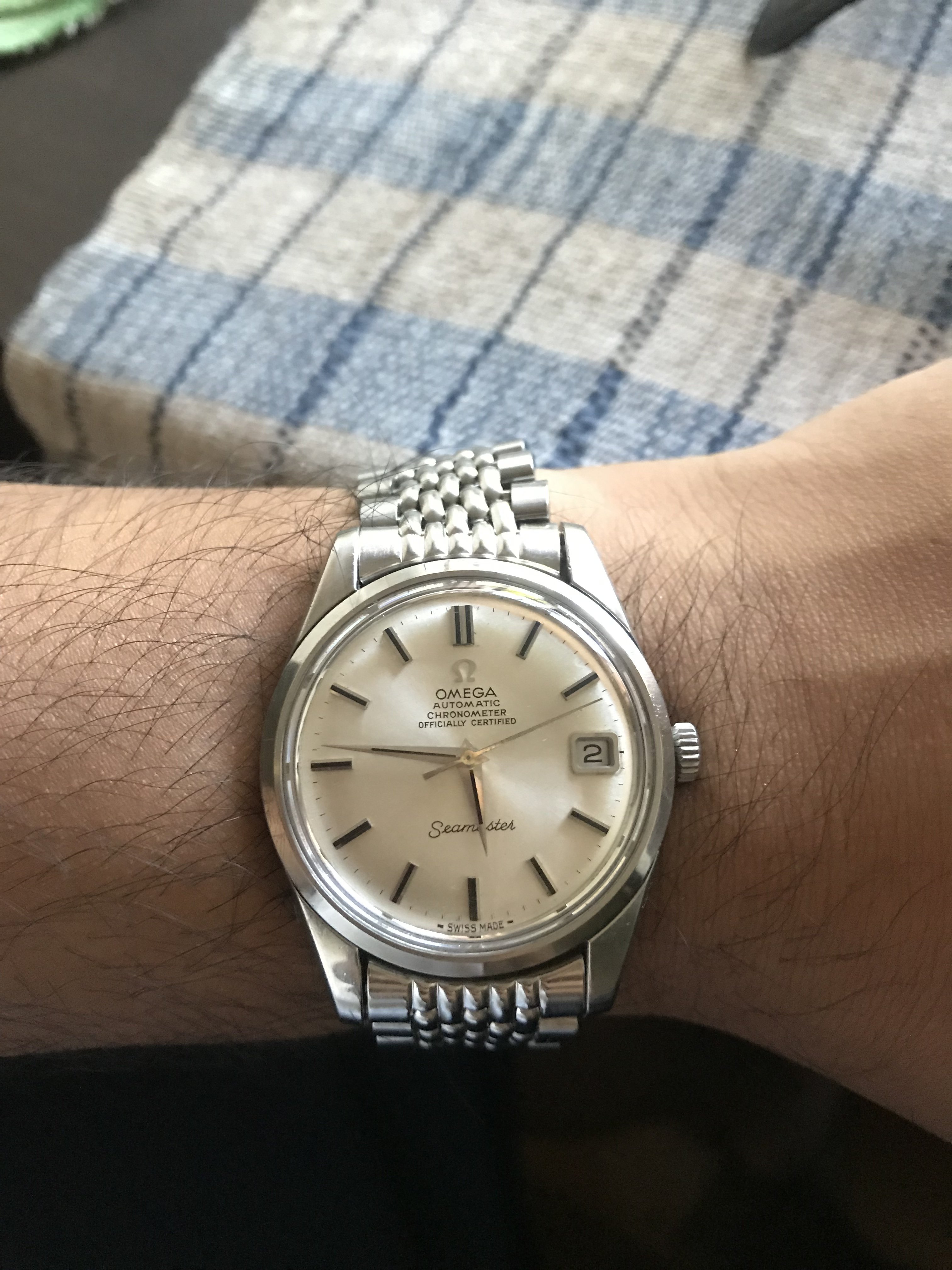

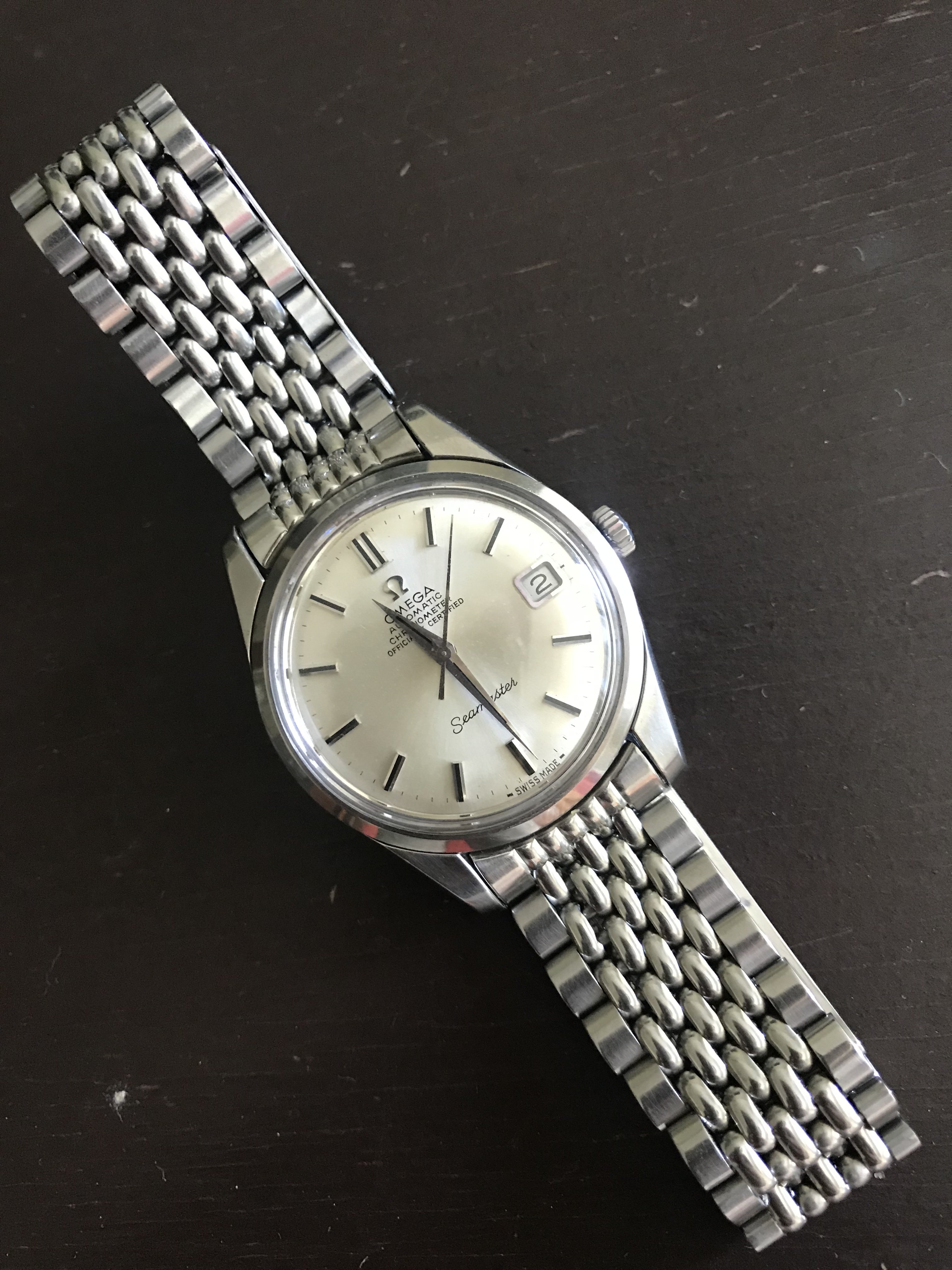

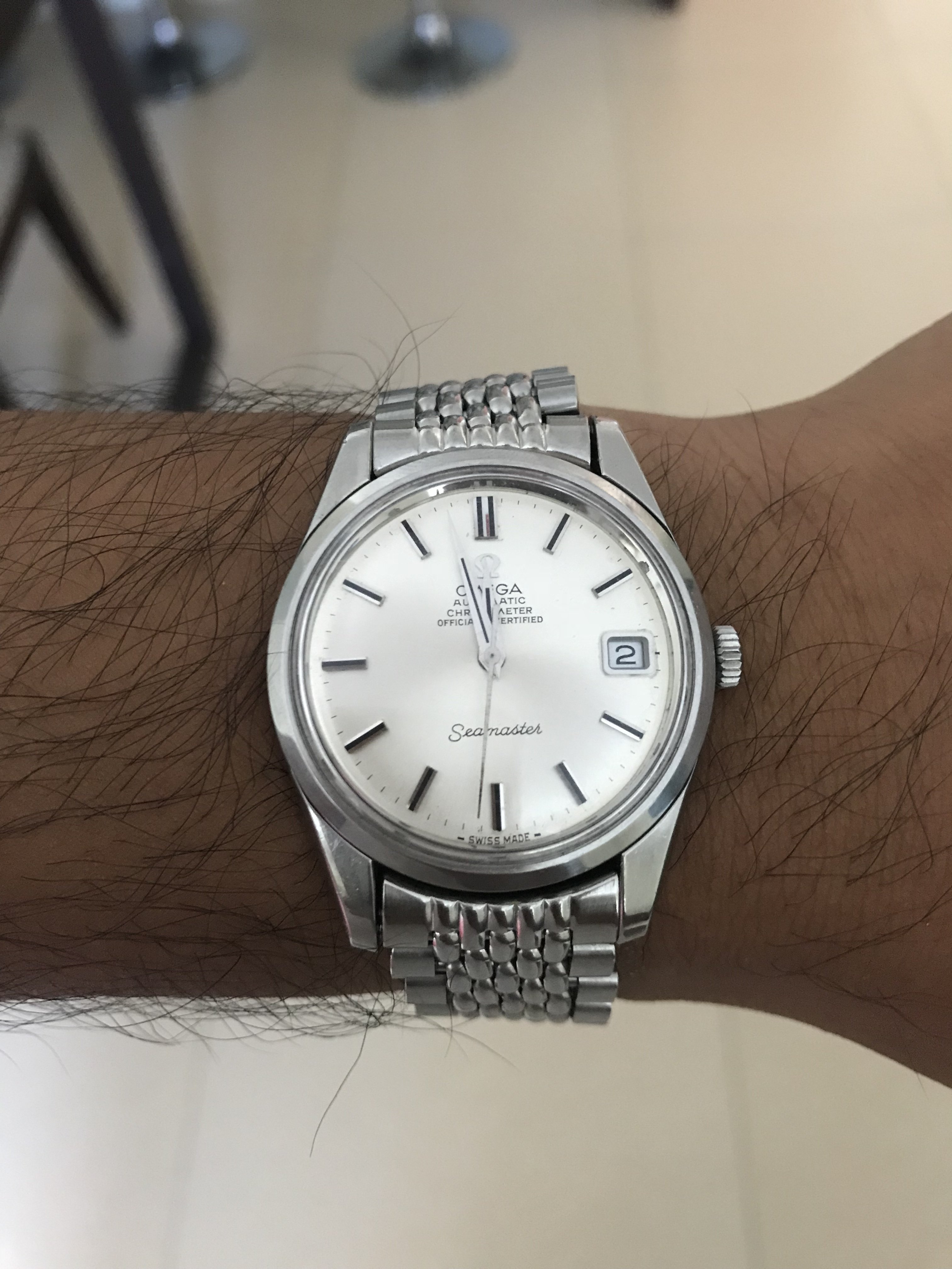

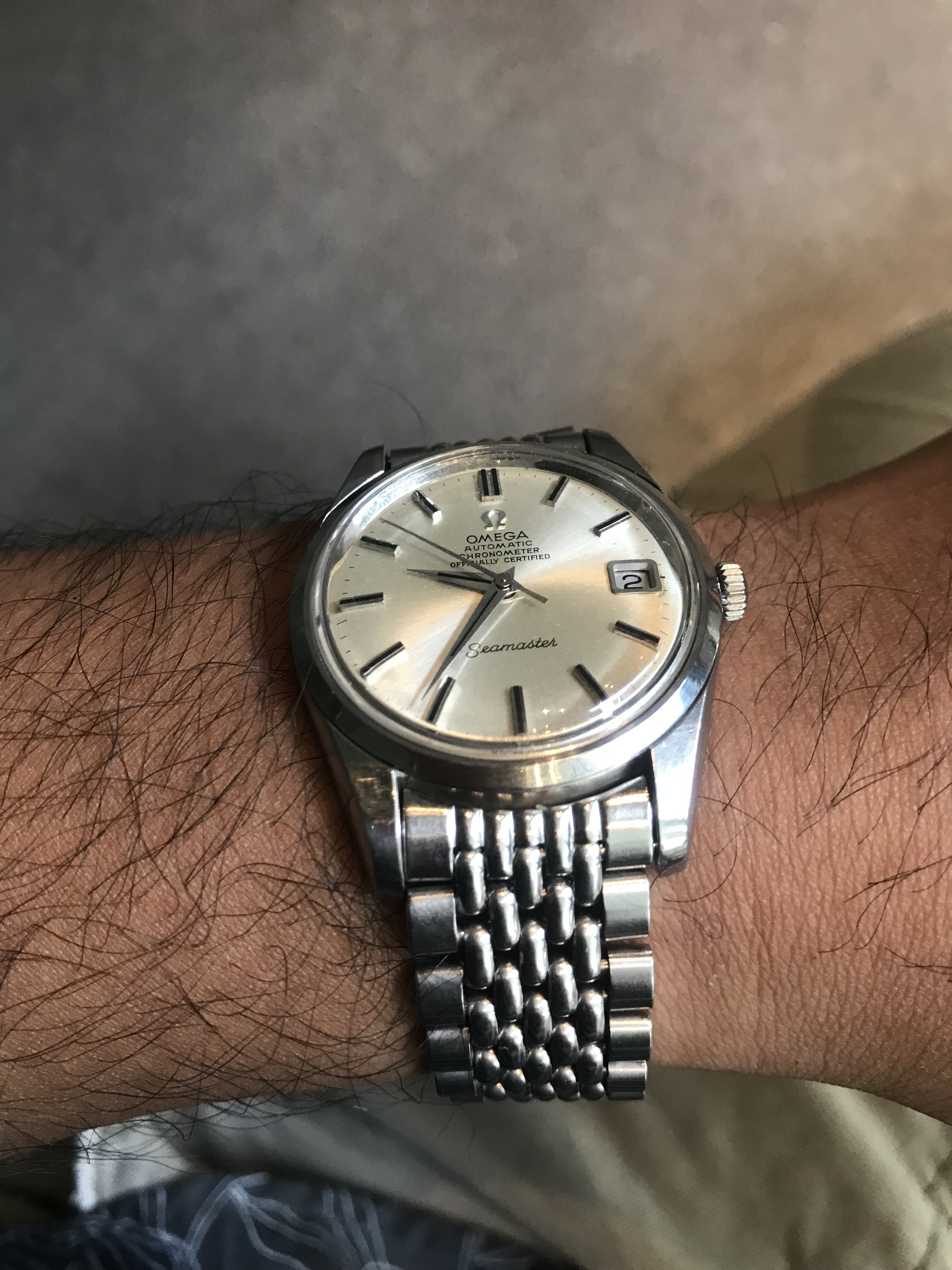

Hi, all. I thought i’d post an update on this. Finally got my hands on a 60s Seamaster, and it is not the 166.010 cal. 562/565, but the chronometer 168.024 cal. 564.
I’ve been observing it for a little over a week and it is consistently running +/-2 a day after a full overhaul. Date quicksets by pulling the crown to the 3rd position. No bubbling on the dial (unlike the one in the original post). There appears to be a little smudging on the far border of the framed date window but I don’t mind it too much. The watch came with a beat up signed crystal with cyclops but my guy had it replaced with another signed crystal. Would’ve preferred one with the cyclops, but eh. The edges look sharp and the case is unpolished: it has a vertical brushed finish on the sides (I’ve read from another post here that these were original?) The inner caseback is imperfect but looks correct.
And, of course, the BoR: 7 down, 10 up, with 3 links sitting in the (AM) box. With my 6.5 wrists, I really don’t mind just having 20 links. Unless the last links attached to the clasp are counted, then this watch has 22 links. 1036 clasp, No. 12, #511 endlinks.
Conclusion: I am happy that I took OF members’ advice to wait and pay a bit more for a better example. It was a hard wait, but everyone’s advice was gold and I think this was worth it.

Thanks. The difference came to almost $300 but that included shipping, a new crystal, and a complete overhaul. And it’s the chronometer version, too.
Then there is the intangible stuff, like building a relationship with someone who has a good watchmaker, who can give me good leads on future buys, and who can source original parts for me. 😀
