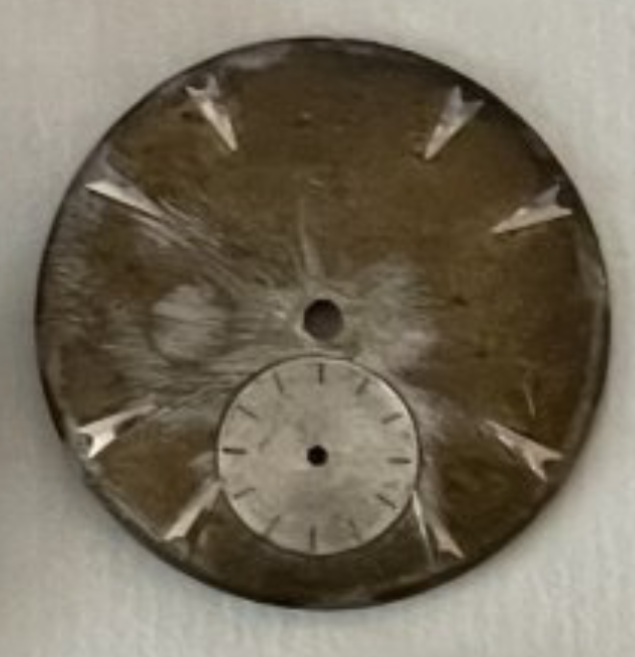

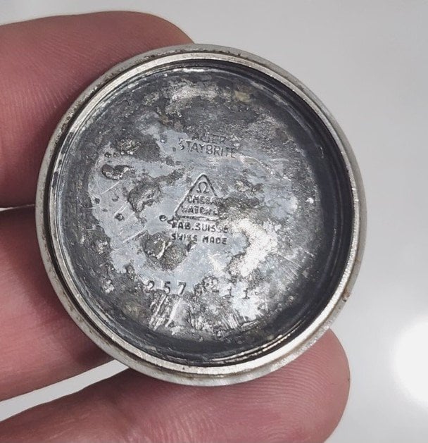

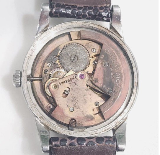

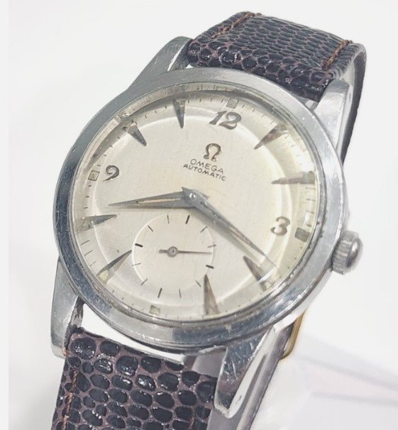

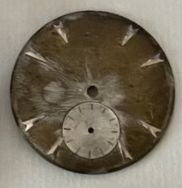

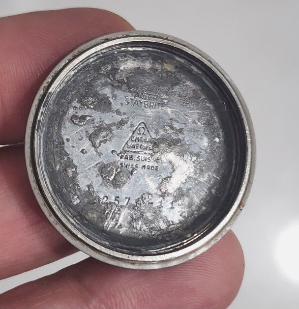

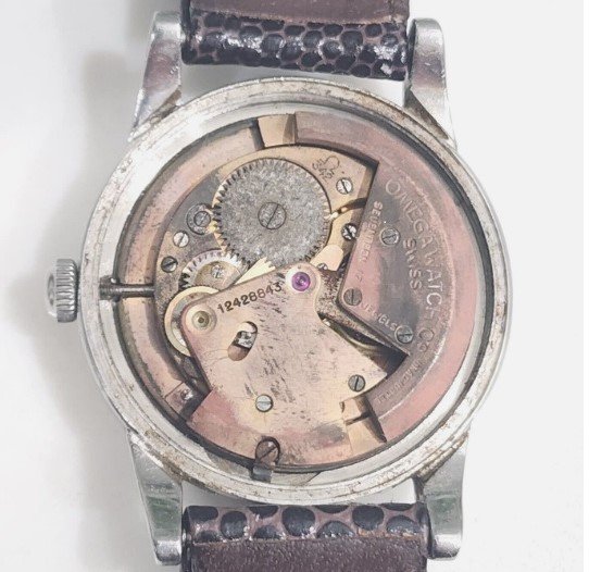

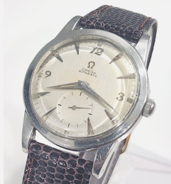

Good Day, I am looking for a watch to buy for parts to correct the watch I helped to destroy when young (see first post https://omegaforums.net/threads/vintage-omega-automatic-342.171159/ ). I have found one on-line that has the dial I'm looking for but the movements show rust. The seller says "is fully operational and functions as intended". The seller is asking $700 for the watch. I would give a link but not sure if that is proper so instead I posted pictures. I am not savvy enough to know if the price they are asking is a good price but I feel the rust it is showing is suspect for the price. I can offer a price but for what it is I only want to offer a fair price. In my last post I showed the watch I have that is in pieces, some pieces are missing, some are a little rusted and broken. Do you think by looking at the photos that I could take the needed watch pieces, clean and install them on my watch? Second question, what would be a fair price for a watch in that condition? Thanks

It’s a bad redial, you don’t want that dial. Or the rest of it. Keep looking.

You are saying that you don’t know much about anything when it comes to vintage watches and you are asking if we think that you can buy a watch for parts and install the parts into your nonworking watch and make it all work? Does not seem realistic to me. Sorry.

Per DON, Movement is in poor condition and best you just replace it. You have the majority of the parts
Mainspring barrel is missing the mainspring and arbor
Clutch lever and spring missing
Rotor ratchet click spring missing. Have the arm and appears the screw
Rotor arm missing a screw. See two
Balance bridge arm out of position. Quick fix

Neither is particularly clean, but both are far better than that $700 rusty mess you were looking at.

He needs a dial too.

I am sure he can repaint it in the auto body shop. Might even have the UV lamps to set the paint.
I suspect a lot of redials are done with autobody and other heat setting or UV catalised paints. Especially the listings from india with the bright colors.
1. No
2. That watch is terrible. Keep looking
