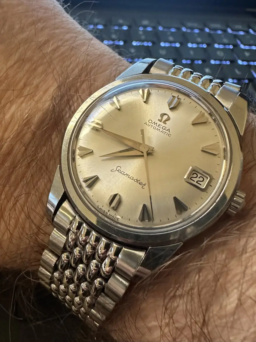

It would look like these photo. I am in the USA, but if you are able to post to some of my other members, I have contacts in Germany, UK and Japan, and others who can ship it to the USA. Let me know if you have anything that works and thank you very much for checking.
2,677
3,151
If you have any way to estimate the crown width that would help too, C-Case's have similar crowns and this crown is definitely thicker than the regular C-Case crowns - I am guessing the width could be higher too - by width I mean a number like 4.5mm to 5.5mm - even 0.1mm matters quite a bit, for example C-Case's are 4.7mm and 4.5mm looks comically small etc. - If you can find the size, or measure the cutout, that would help a lot too

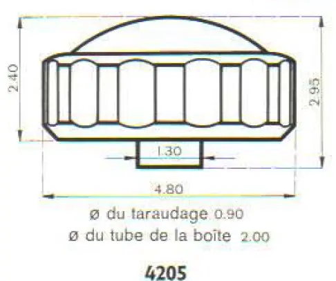

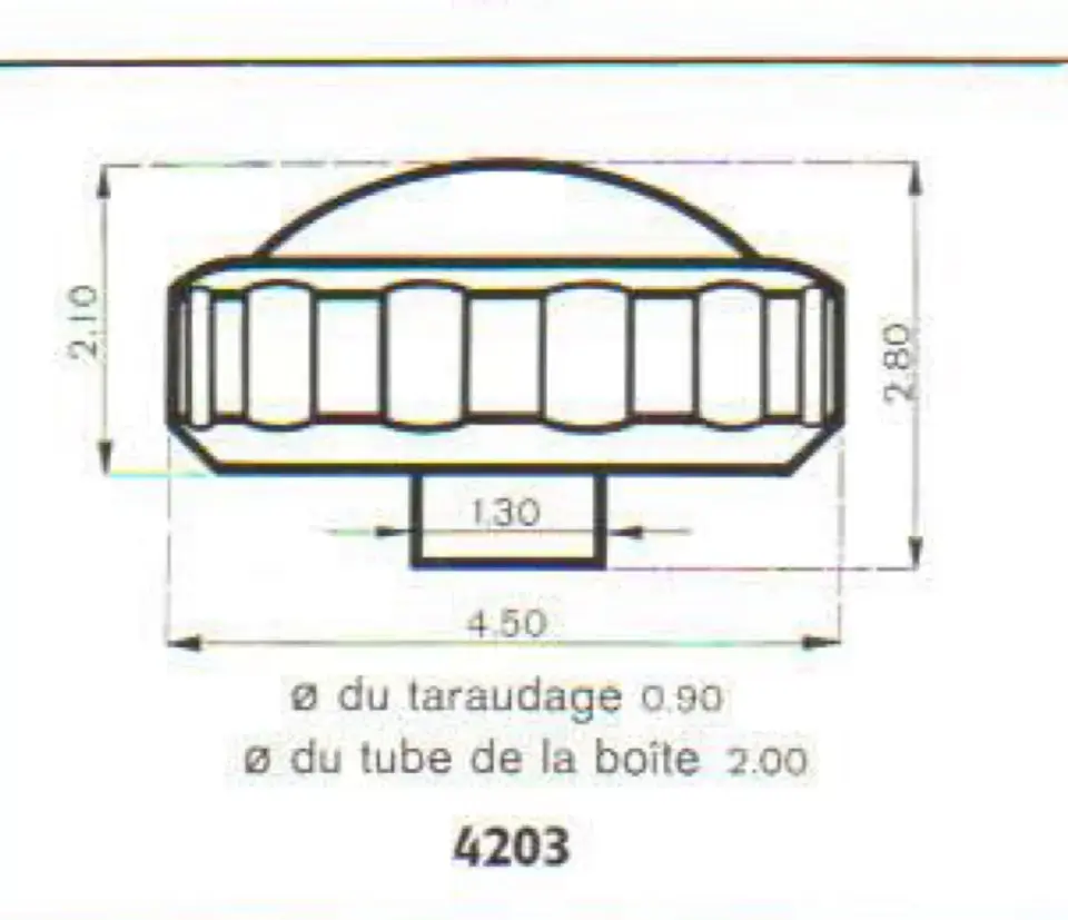

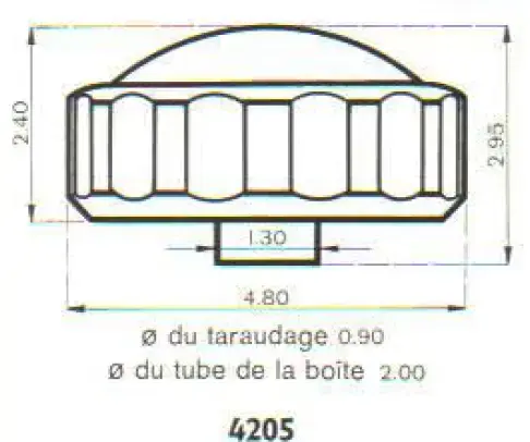

I think the 4203 crown is the thin one and the 4205 is the thick service scalloped crown.
This is from another thread:
