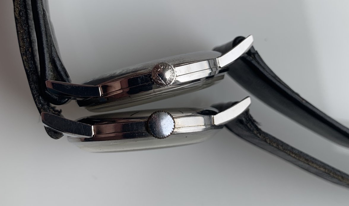

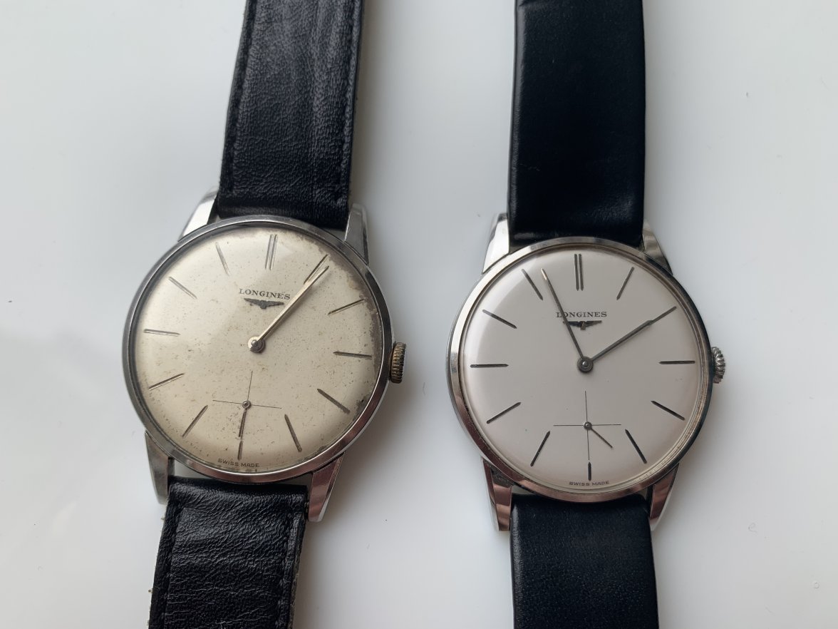

Here are a couple of 30Ls, both ref 8888. Not sure which is the original crown....
7,142
57,586
I'm gonna posit that the unmarked crown is aftermarket timjohn. The marked one looks like the one on my 30L
Love the 8888's! One of my favorite Longines references and one of the most elegant dress watch designs ever conceived. My ref. 7163, has the same type of dial (with the etched indices), which is what drew me to it. That button-style crown seems to be the correct style for that type of 30L dress watch.
